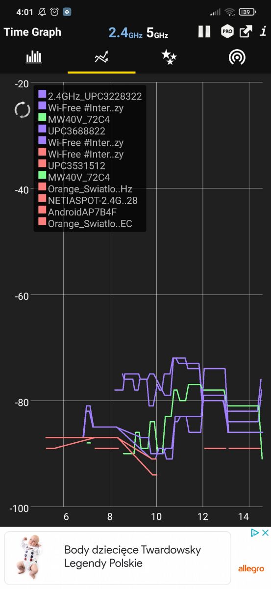

    Connect Box UPC Router Issues: Slow WiFi Speeds & Stability in 50m2 Apartment (500 MB Plan) Connect Box UPC Router Issues: Slow WiFi Speeds & Stability in 50m2 Apartment (500 MB Plan) Connect Box UPC Router Issues: Slow WiFi Speeds & Stability in 50m2 Apartment (500 MB Plan) Connect Box UPC Router Issues: Slow WiFi Speeds & Stability in 50m2 Apartment (500 MB Plan)
    This is what I was able to do with one of the given apps. I did the test in the place where there is the biggest problem with wifi. In the same place speedtest.pl showed 15.7 mbps and 18ms ping

    @grejfrut12
    At 2.4GHz, everyone sits on standard channels, i.e. 1, 6 and 11 - and these are always the most heavily loaded, because they are set by default (and rightly so, only wifi networks can then be only 3 pieces and not their multitude).
    Try to change to a different channel than those indicated earlier.

    @KOCUREK1970 Thanks for the answer - I changed 2.4 GHz to channel 3, and 5 GHz to channel 48 - I'll test it and if anything else I'll get back to you
    EDIT - I can already see that it's not good, and it's even worse, e.g. on a phone located 5 meters from the router (although there is a wall and a door) - there are full lines of wifi range, suddenly it drops to 0 and switches to mobile data, for a few seconds back to wifi

    _cheetah_ wrote:
    @grejfrut12
    Which are your networks?
    It's Armageddon on 2.4, try setting the channel selection to Auto.
    my networks are those whose name starts with 2.4GHz_ or 5GHz_
    As it was on auto, it also interrupted, although probably to a lesser extent than with the channels set manually

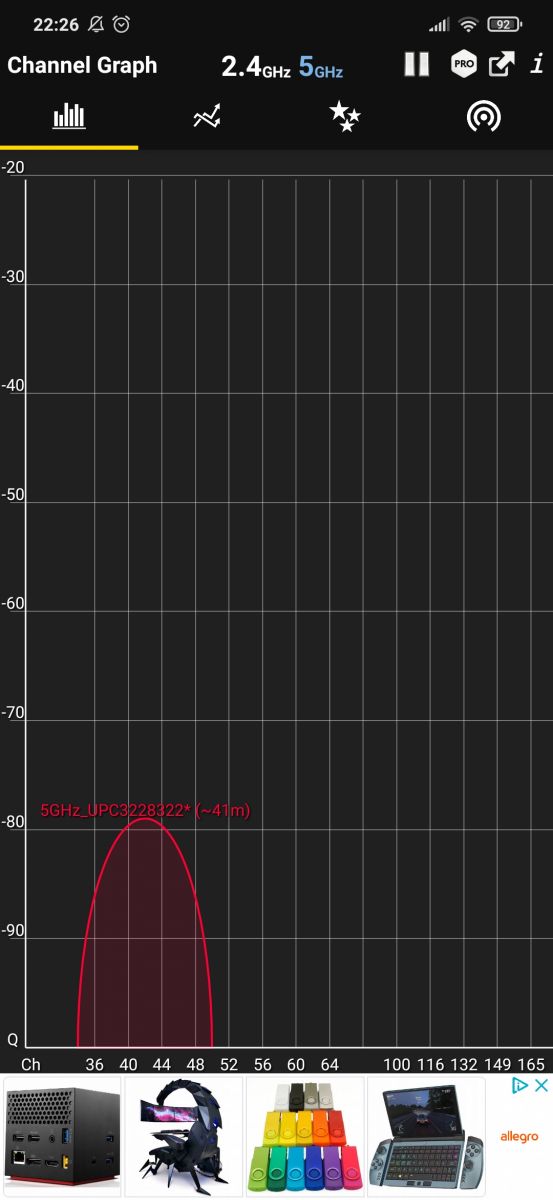

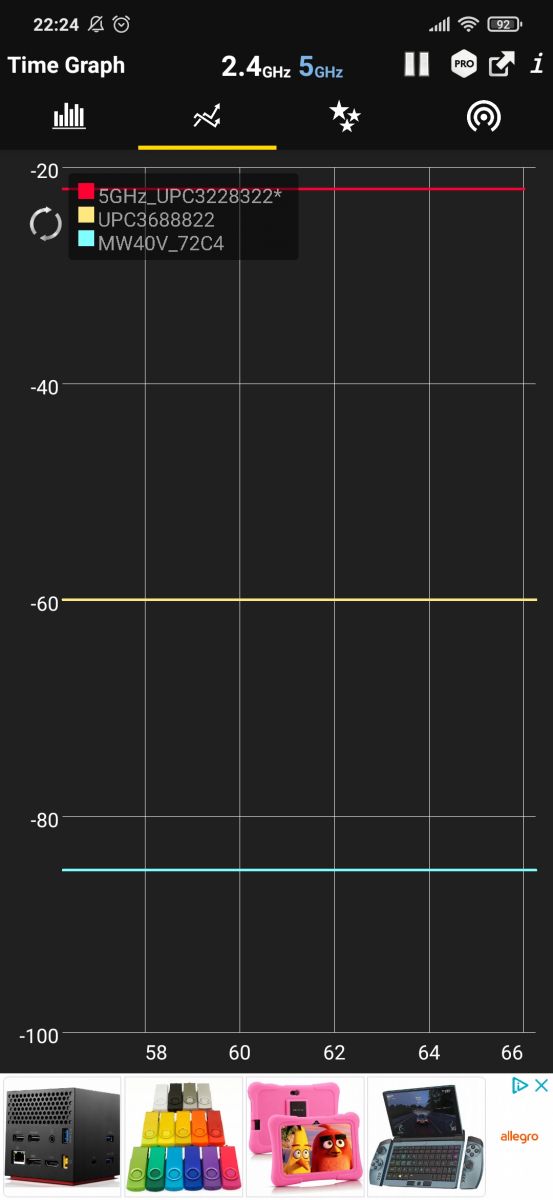

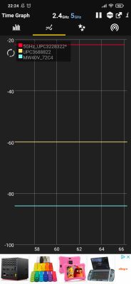

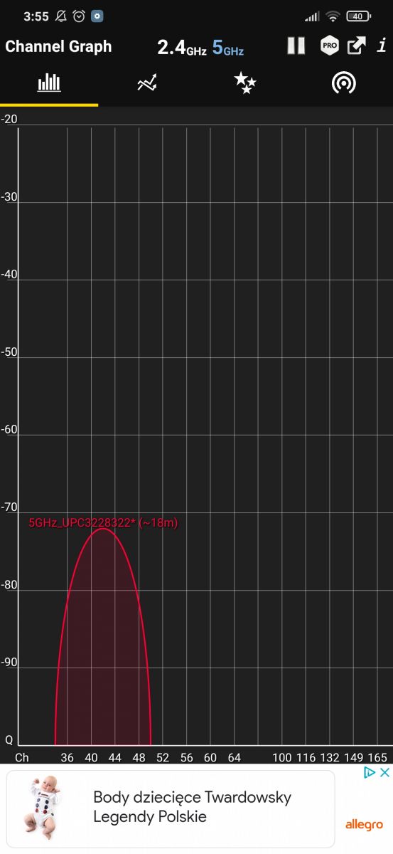

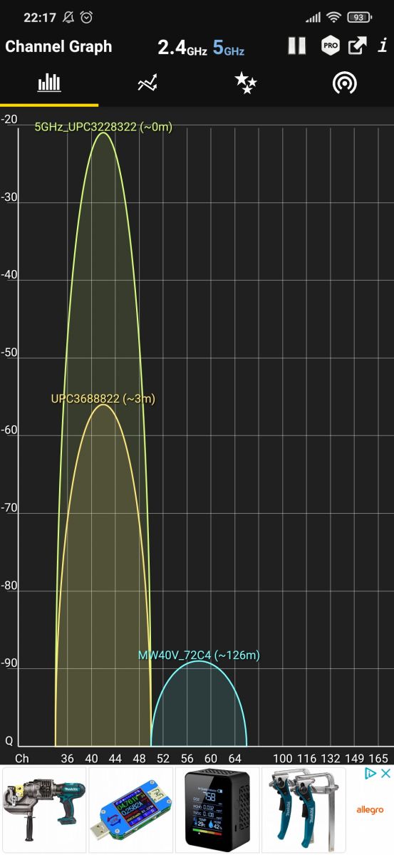

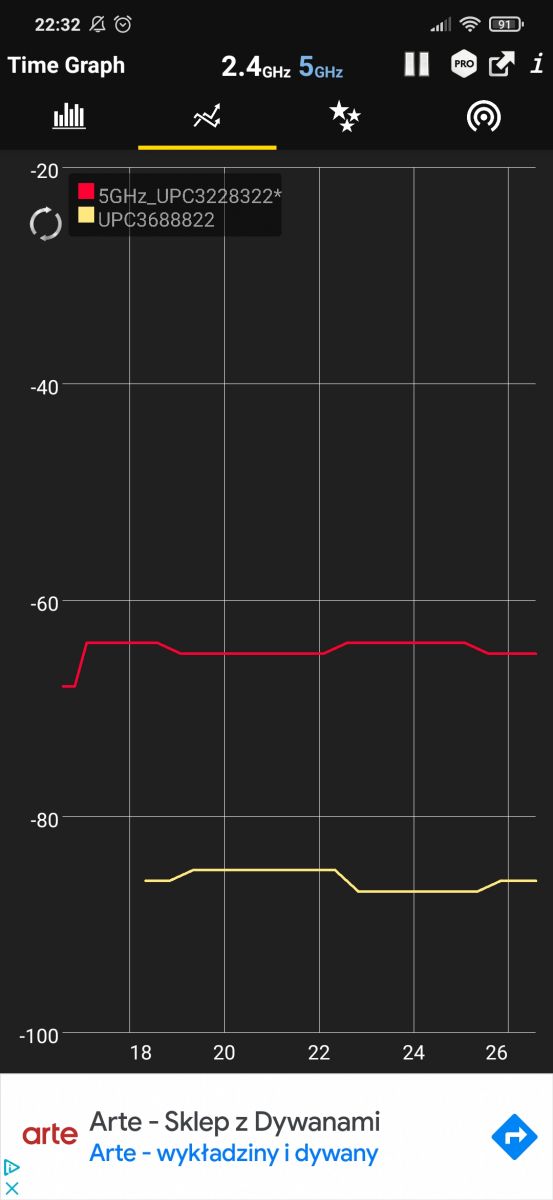

    I am attaching screenshots of the test.
    I did the test next to the router (first 4 screenshots) and in the room where the internet works the worst
    Connect Box UPC Router Issues: Slow WiFi Speeds & Stability in 50m2 Apartment (500 MB Plan) Connect Box UPC Router Issues: Slow WiFi Speeds & Stability in 50m2 Apartment (500 MB Plan) Connect Box UPC Router Issues: Slow WiFi Speeds & Stability in 50m2 Apartment (500 MB Plan) Connect Box UPC Router Issues: Slow WiFi Speeds & Stability in 50m2 Apartment (500 MB Plan) Connect Box UPC Router Issues: Slow WiFi Speeds & Stability in 50m2 Apartment (500 MB Plan) Connect Box UPC Router Issues: Slow WiFi Speeds & Stability in 50m2 Apartment (500 MB Plan) Connect Box UPC Router Issues: Slow WiFi Speeds & Stability in 50m2 Apartment (500 MB Plan) Connect Box UPC Router Issues: Slow WiFi Speeds & Stability in 50m2 Apartment (500 MB Plan)
