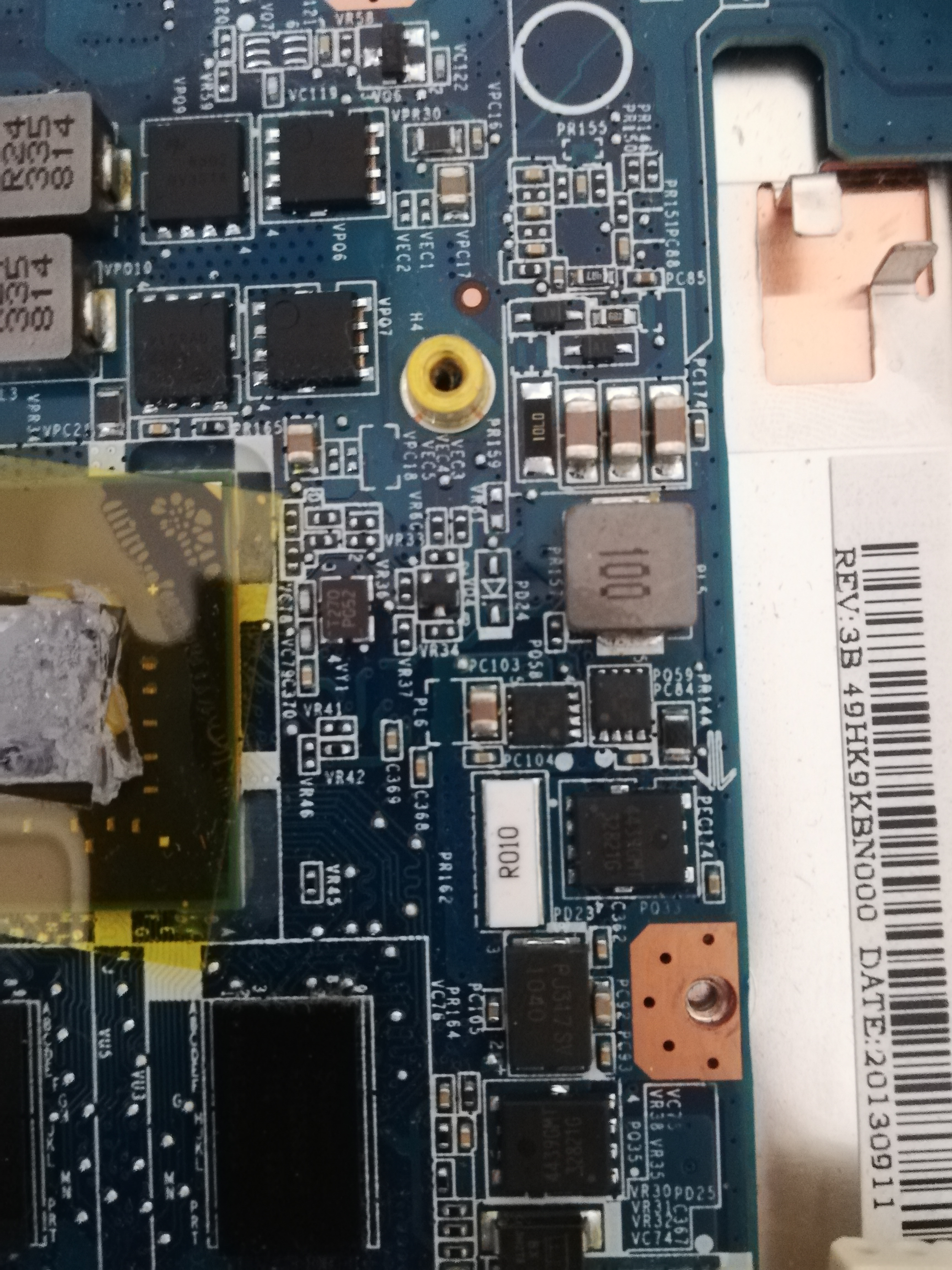

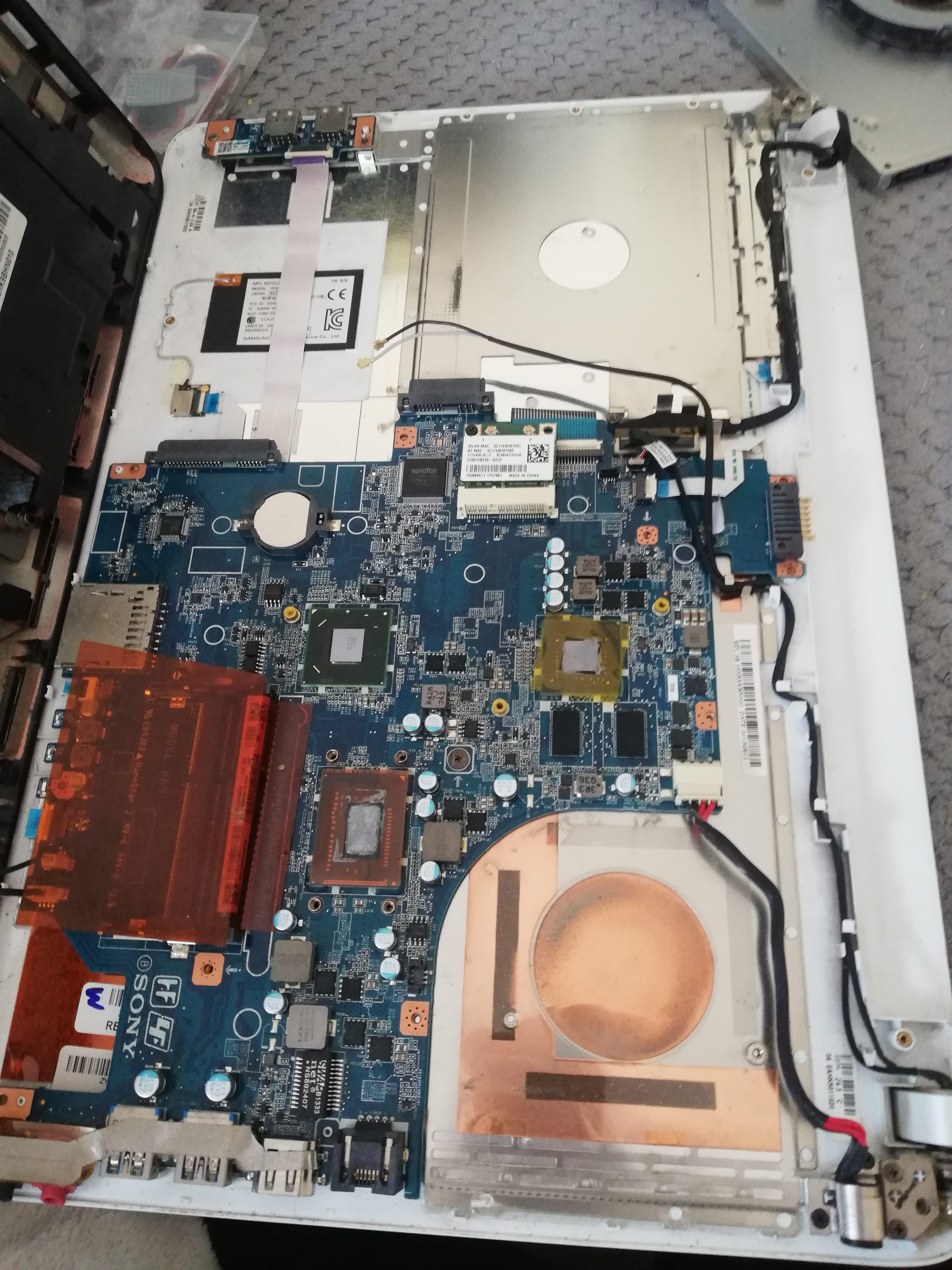

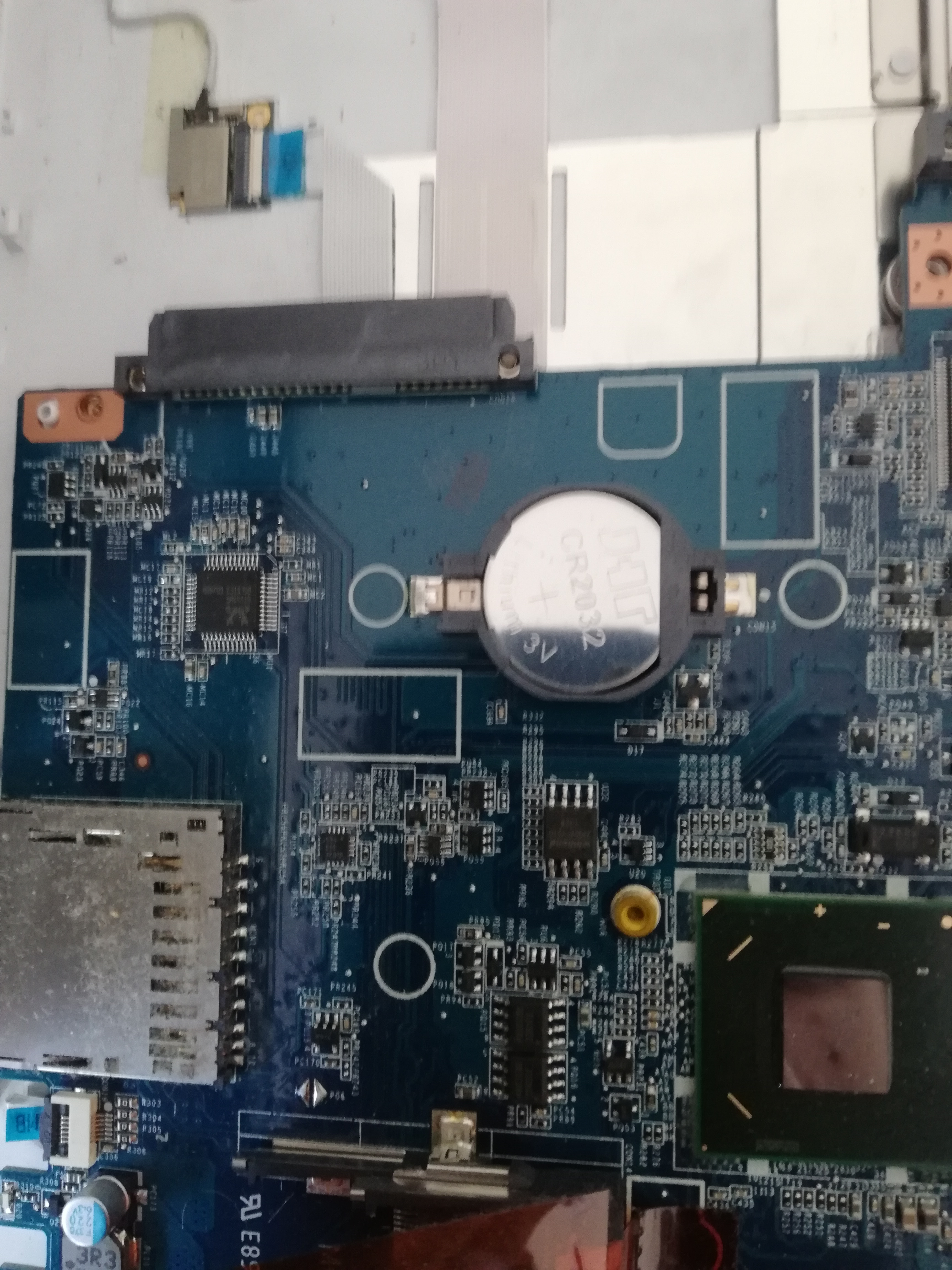

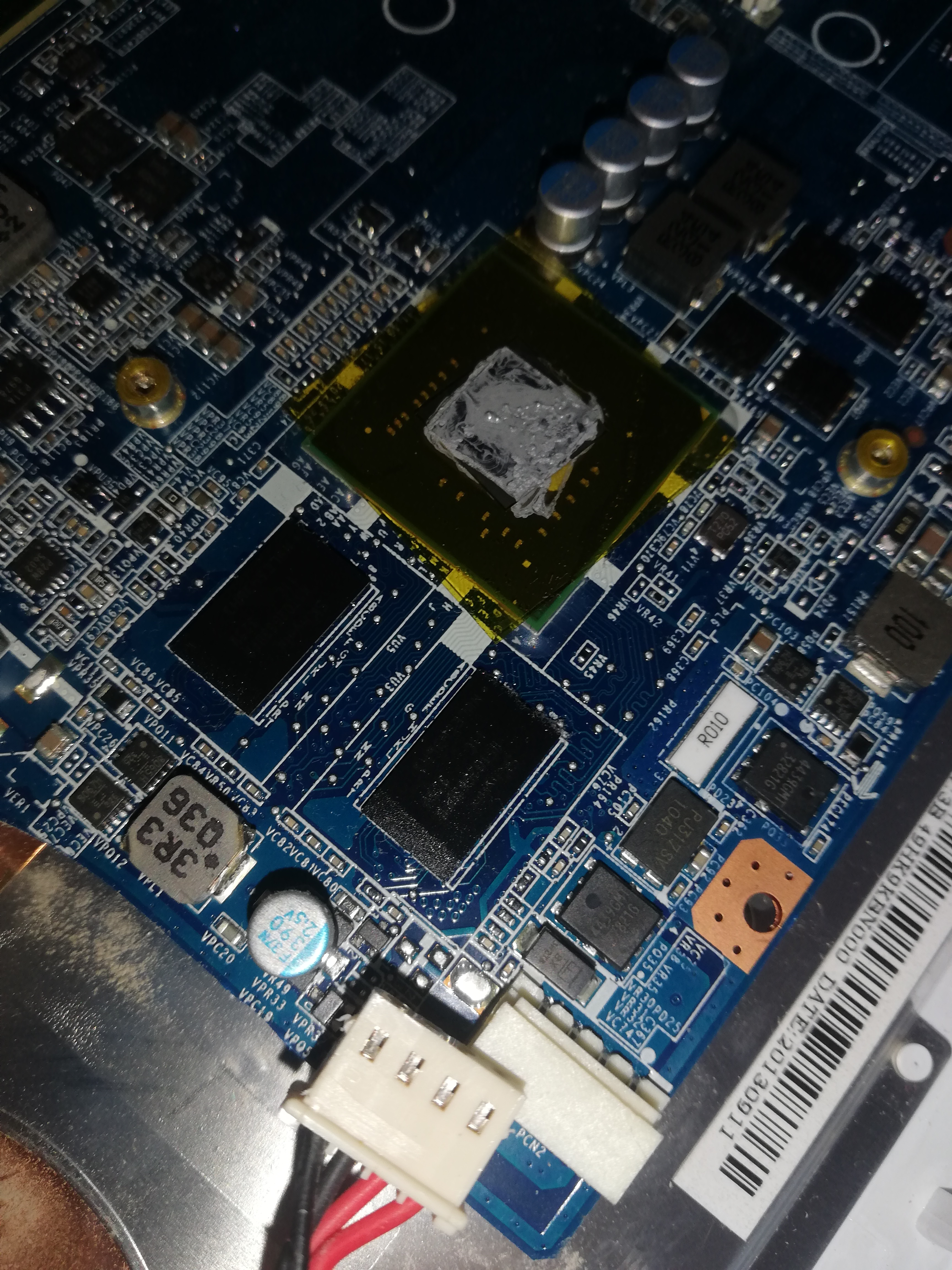

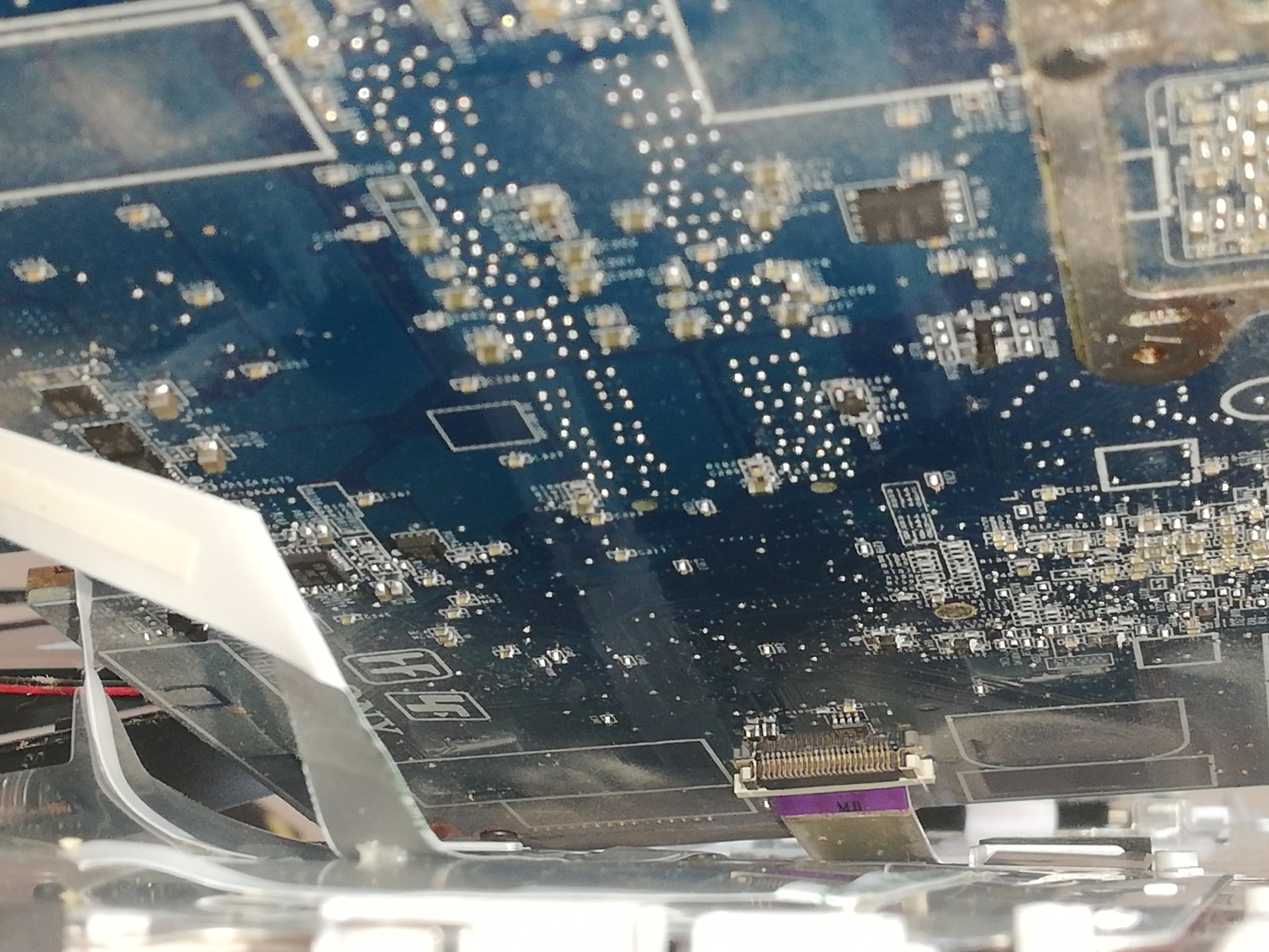

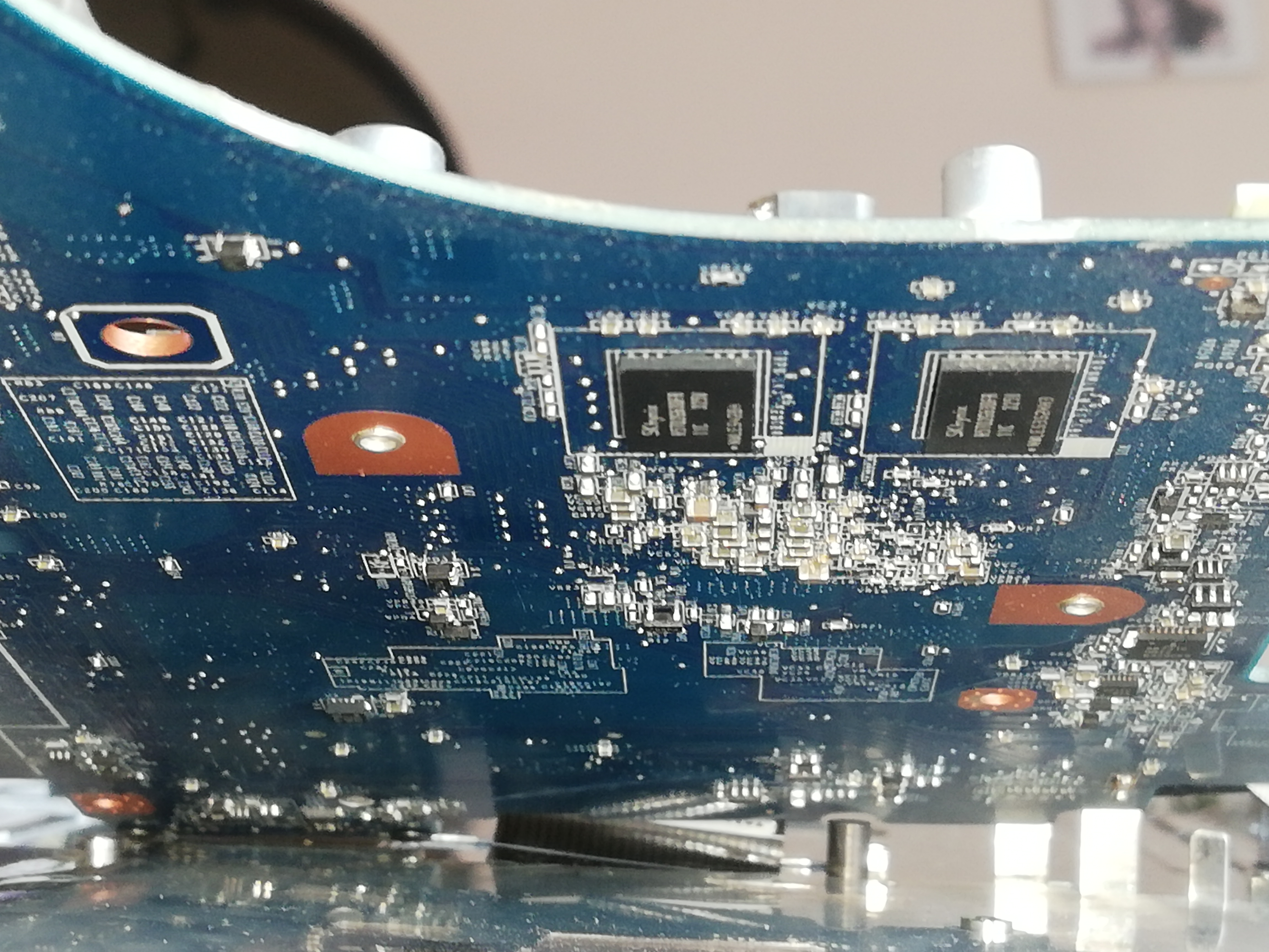

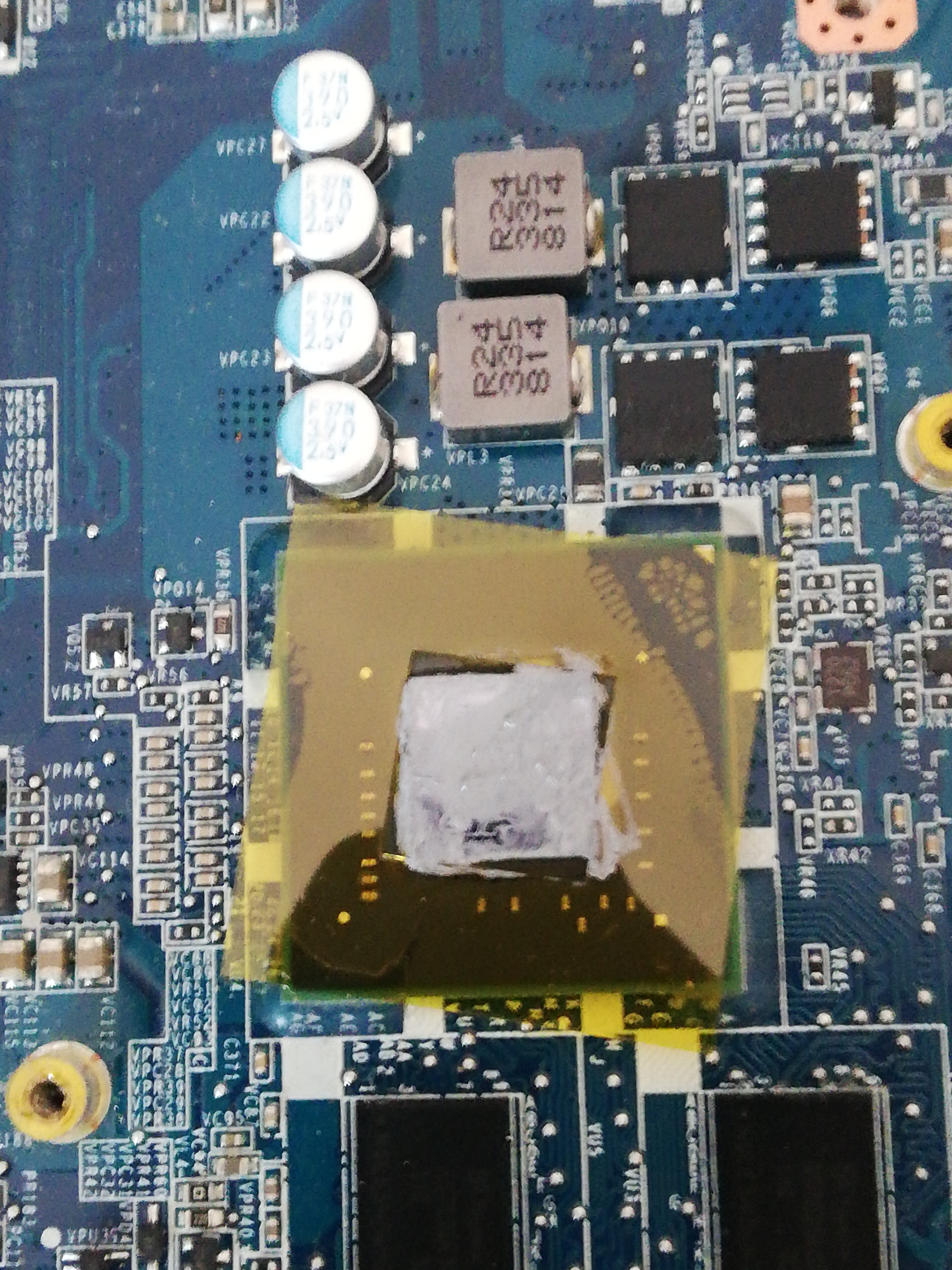

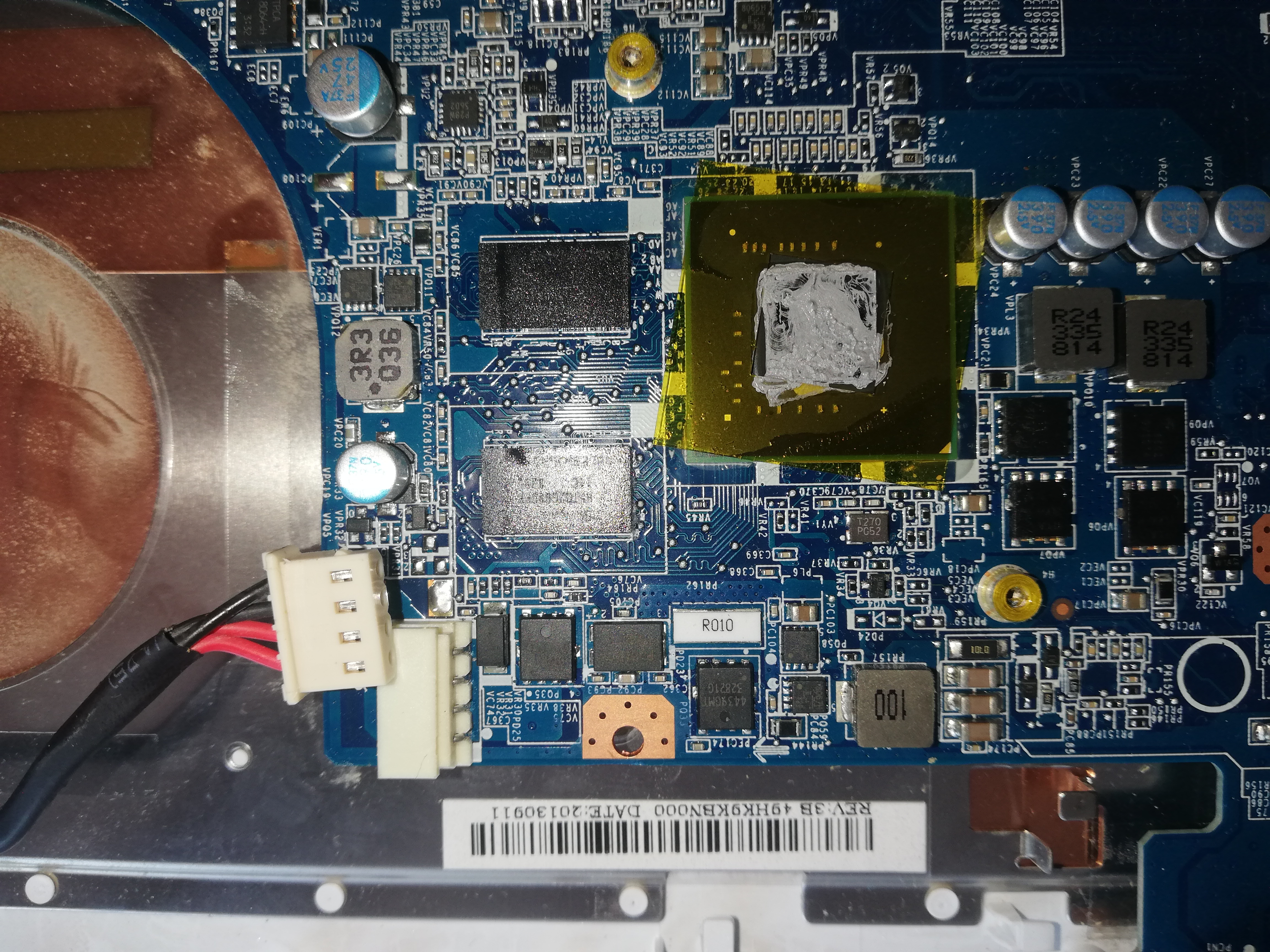

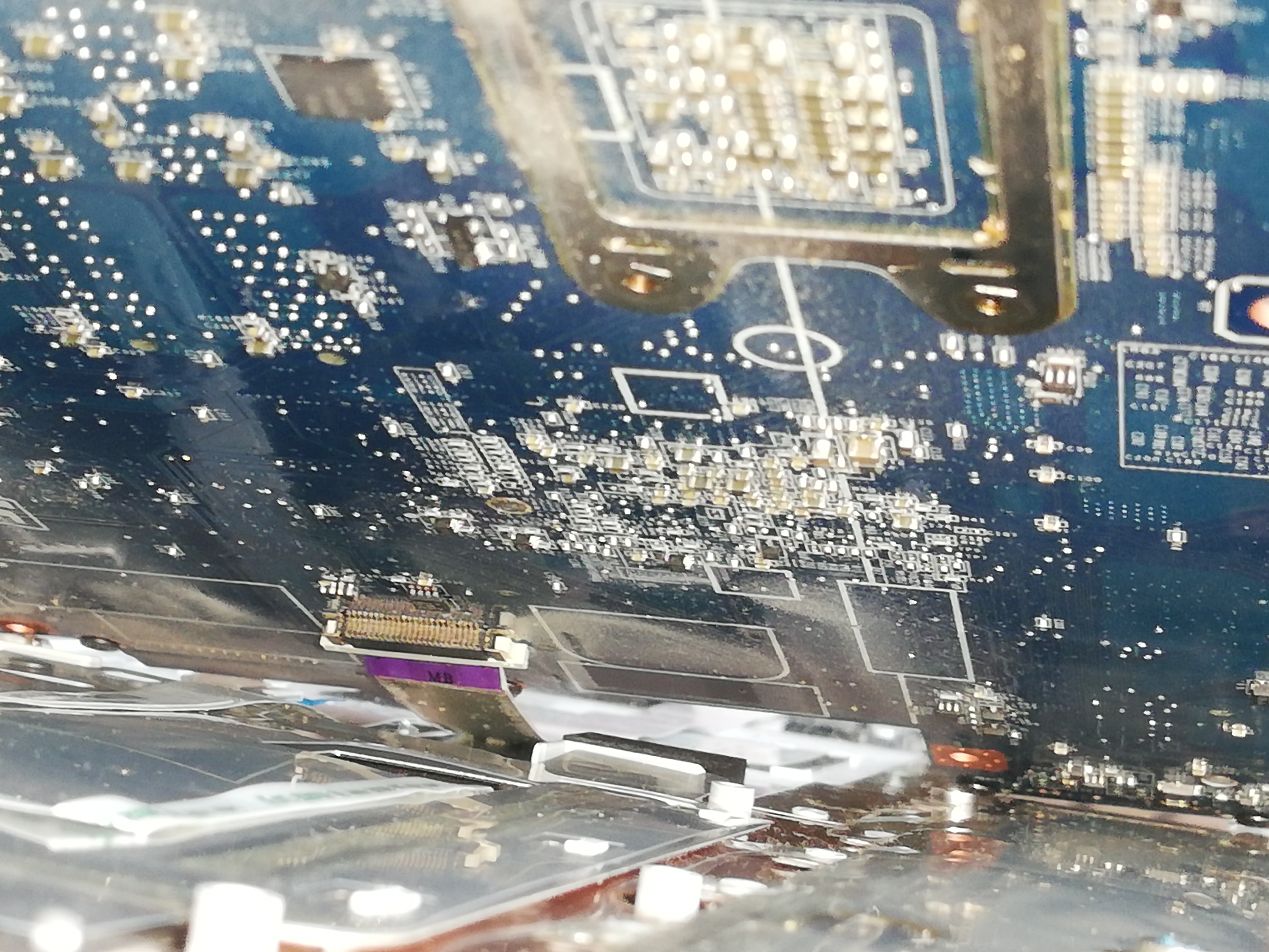

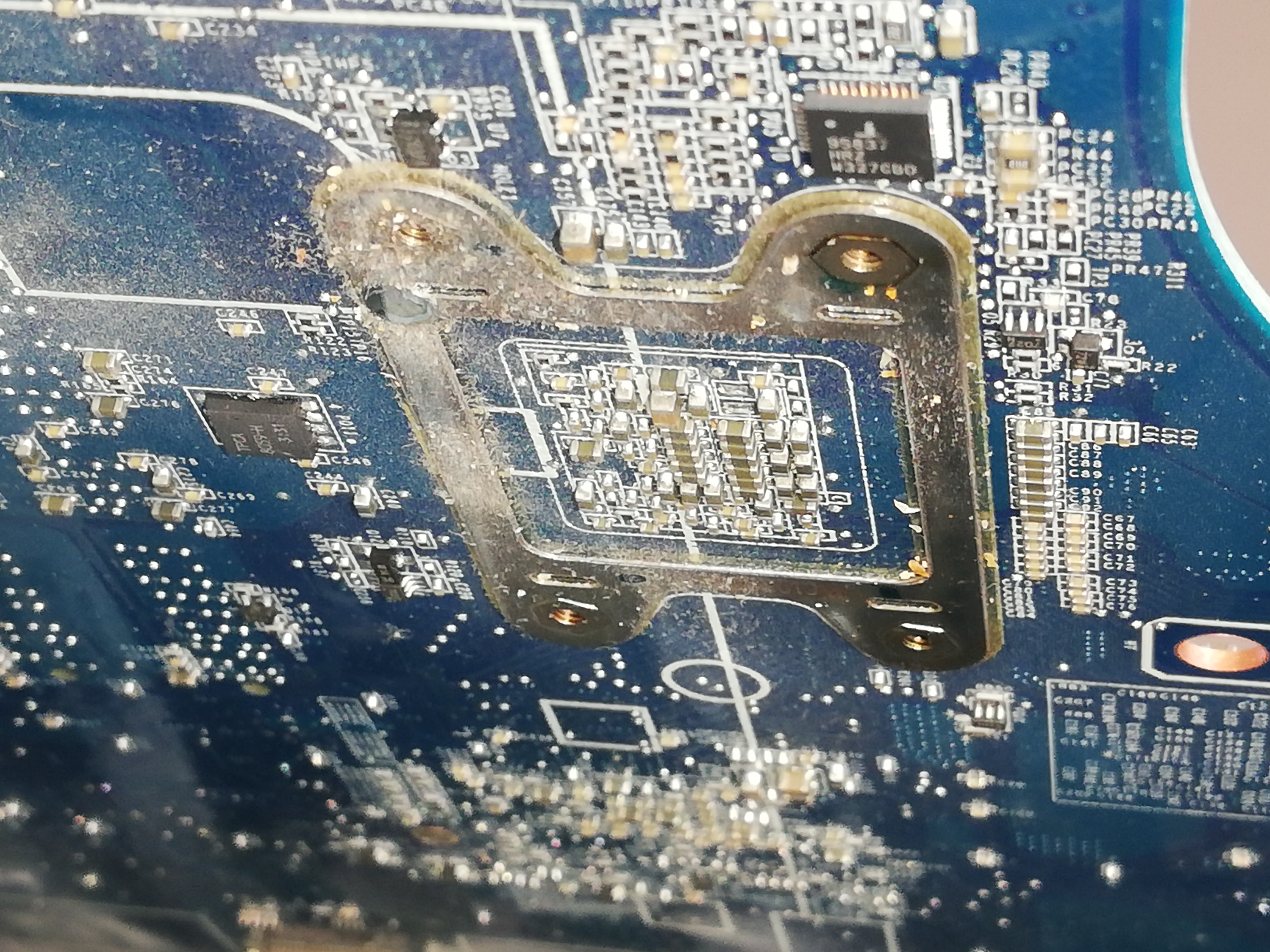

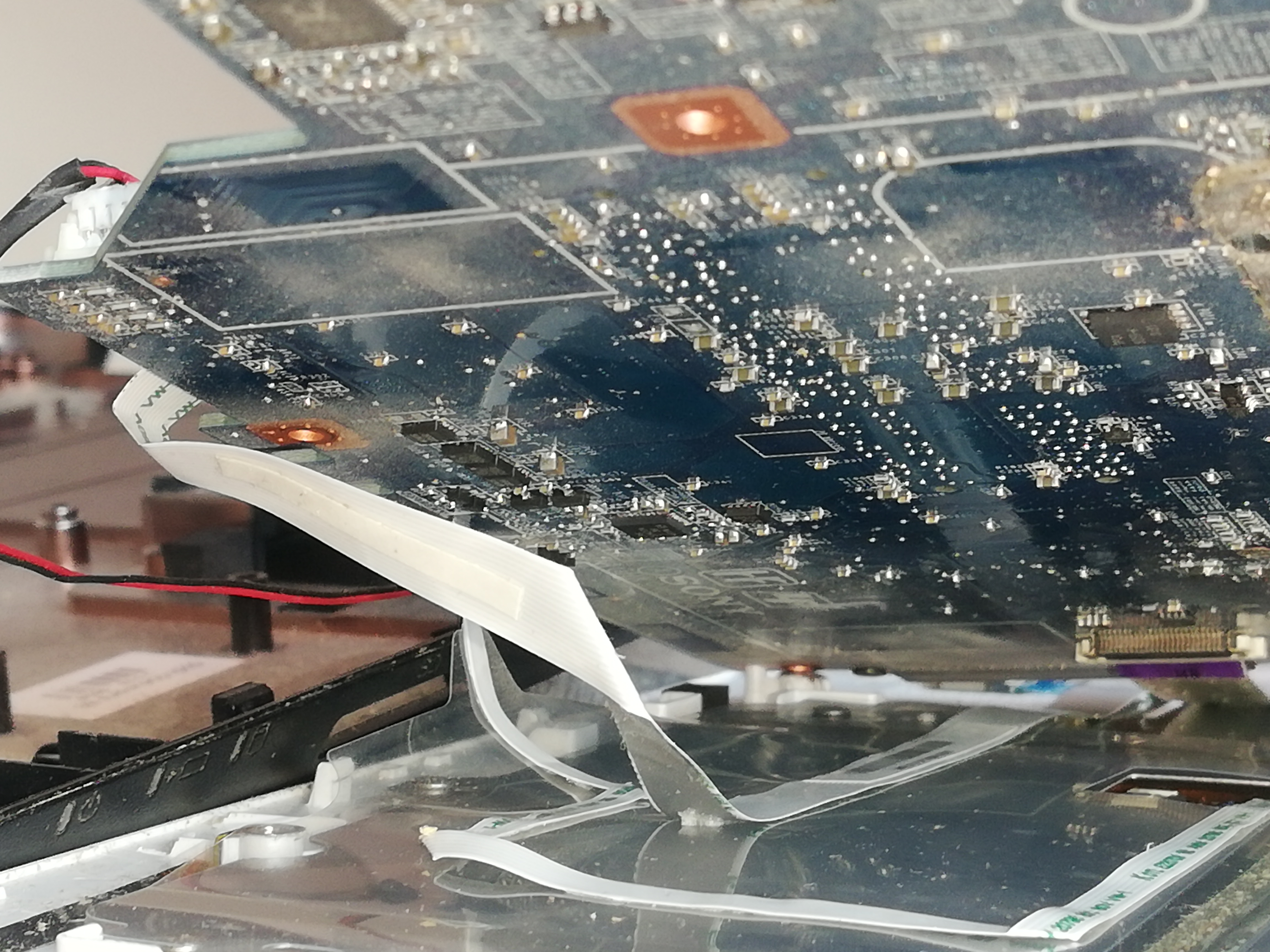

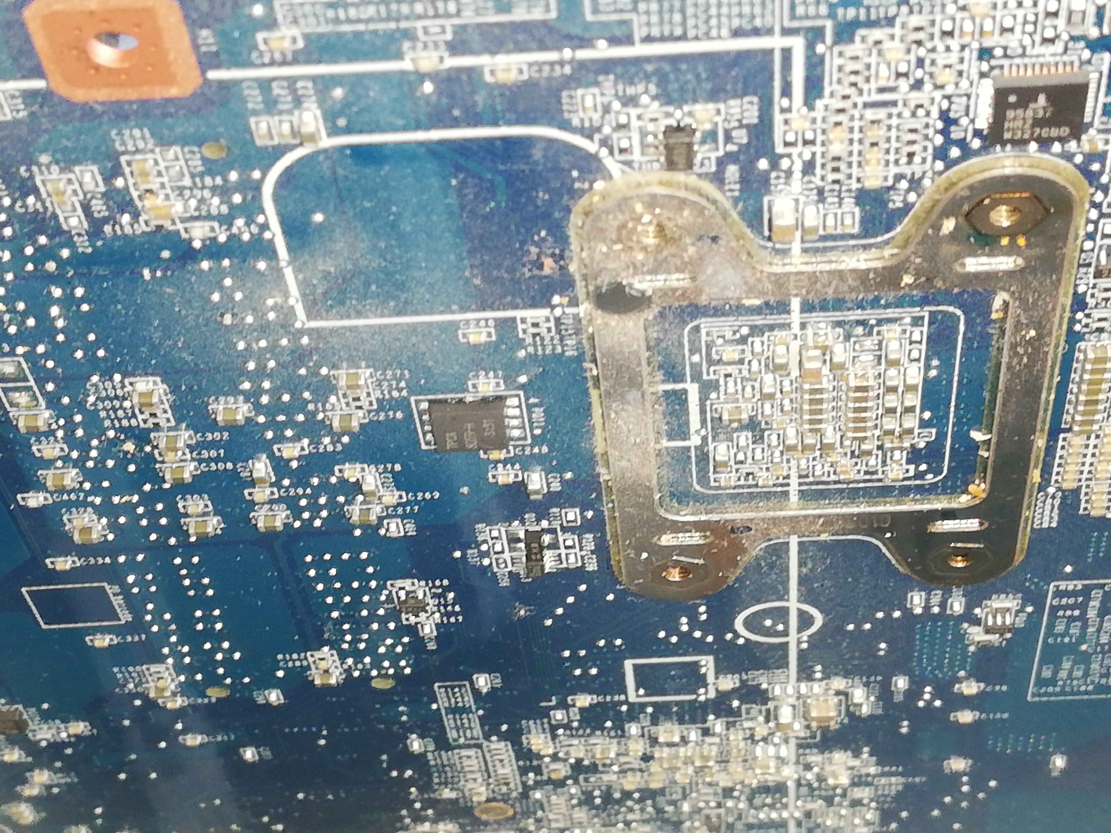

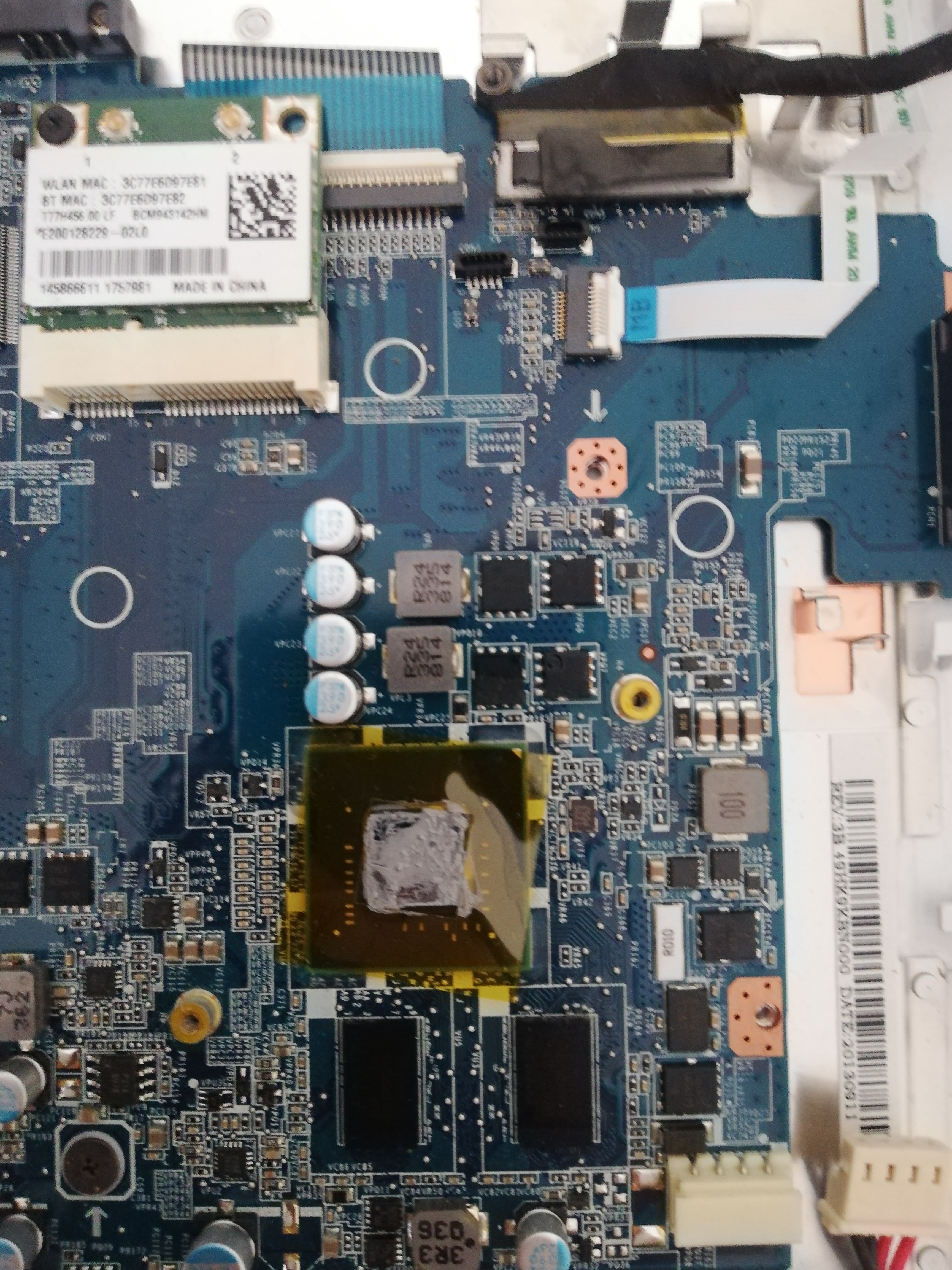

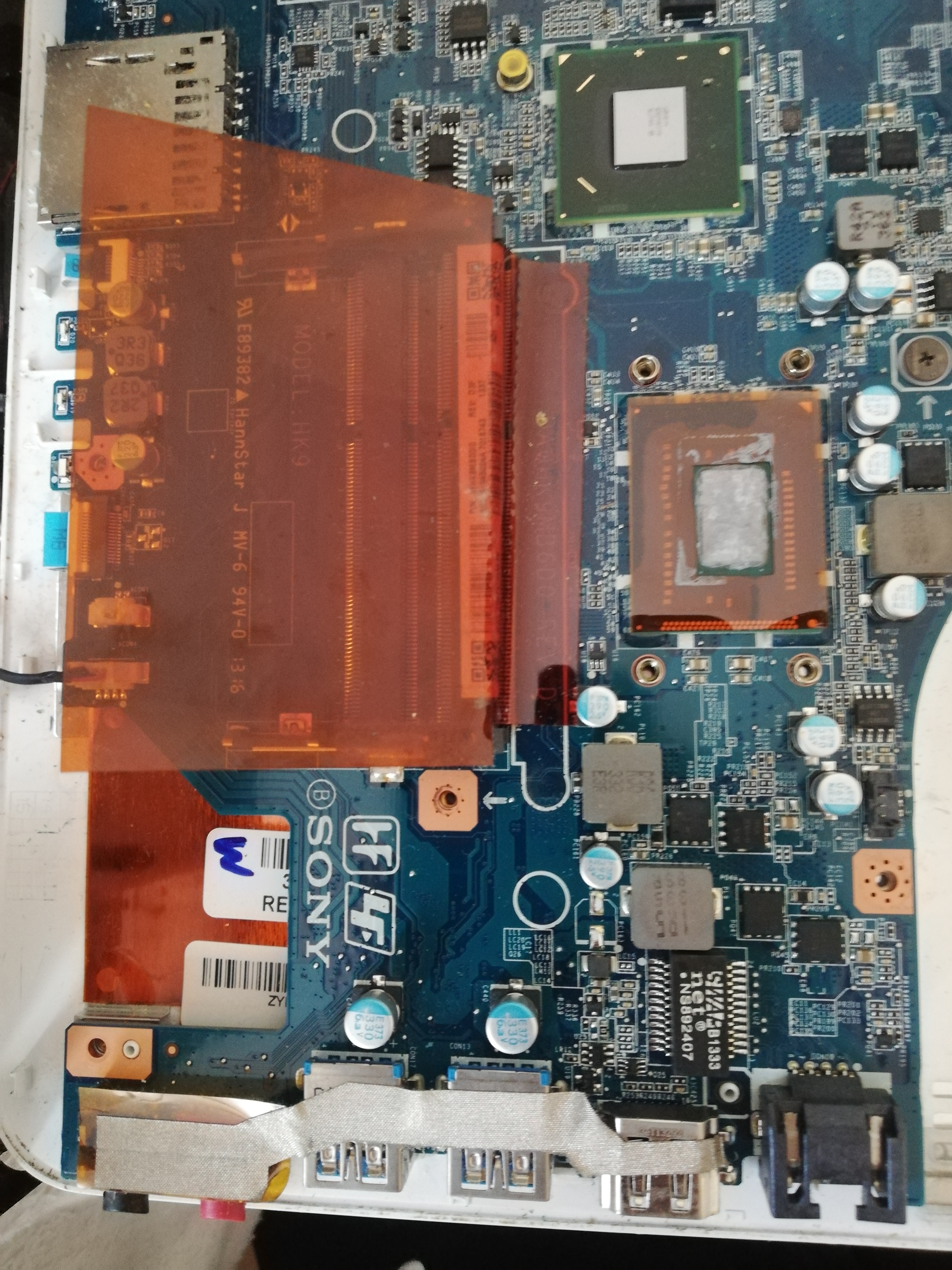

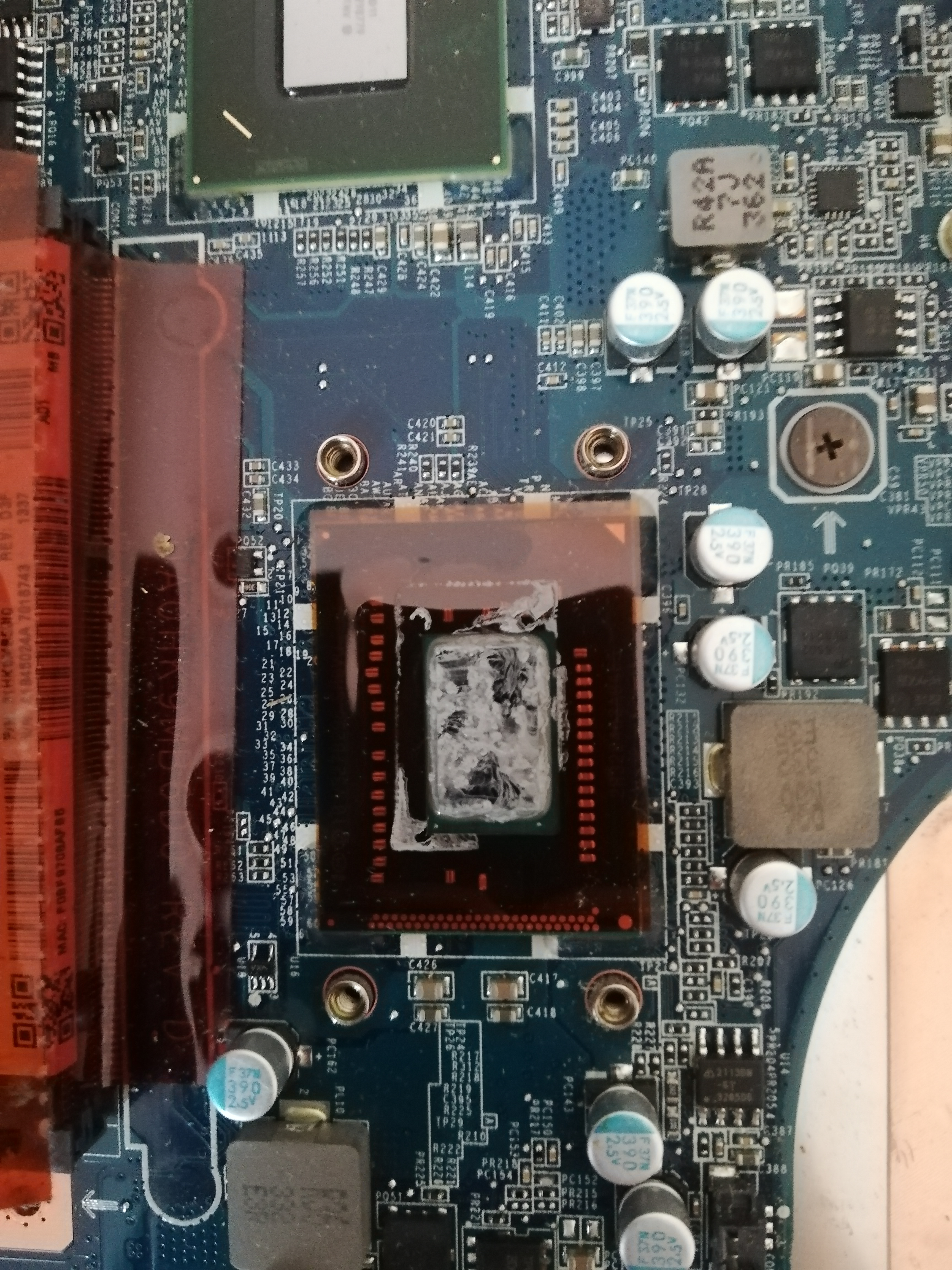

    silentyt
    Posts: 587
    Rate: 42
    @system PL
    @krzysiozak
    Yes, I know it's been a long time since my last response, and I'm sorry.
    Generally, the laptop was in the closet until then, and today, when I am off work, I decided to take it down because a year and a half ago I had a problem with it and I just let it go.
    And as you can see in the pictures - nothing seems to burn a component. Some photos are from the bottom of the motherboard and they are taken a bit strange, but otherwise I can't because I can't disconnect a few cables.
    I took out the batteries from the motherboard to reset the BIOS and after 1 minute I connected the power and nothing.
    I disconnected the RAM and floppy drives and still no effect. Could it be the fault of the power cord? Although with the battery it also does not work ?
    Or maybe with an entrance or a further way?
    When the laptop turned off, it was powered on and with the battery inserted.
    If it is needed, I will try to borrow a multimeter from someone. How do I get what to measure?
