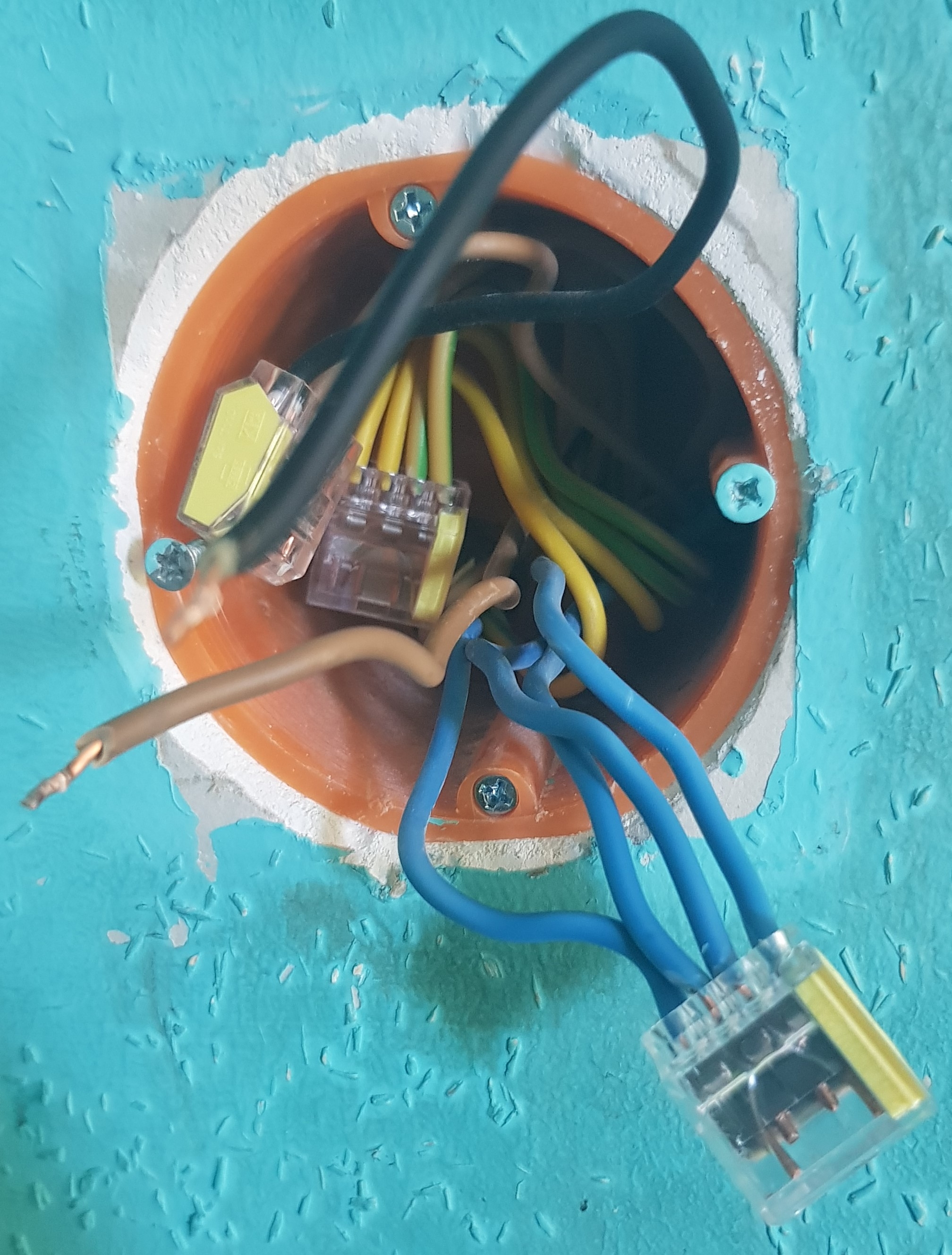

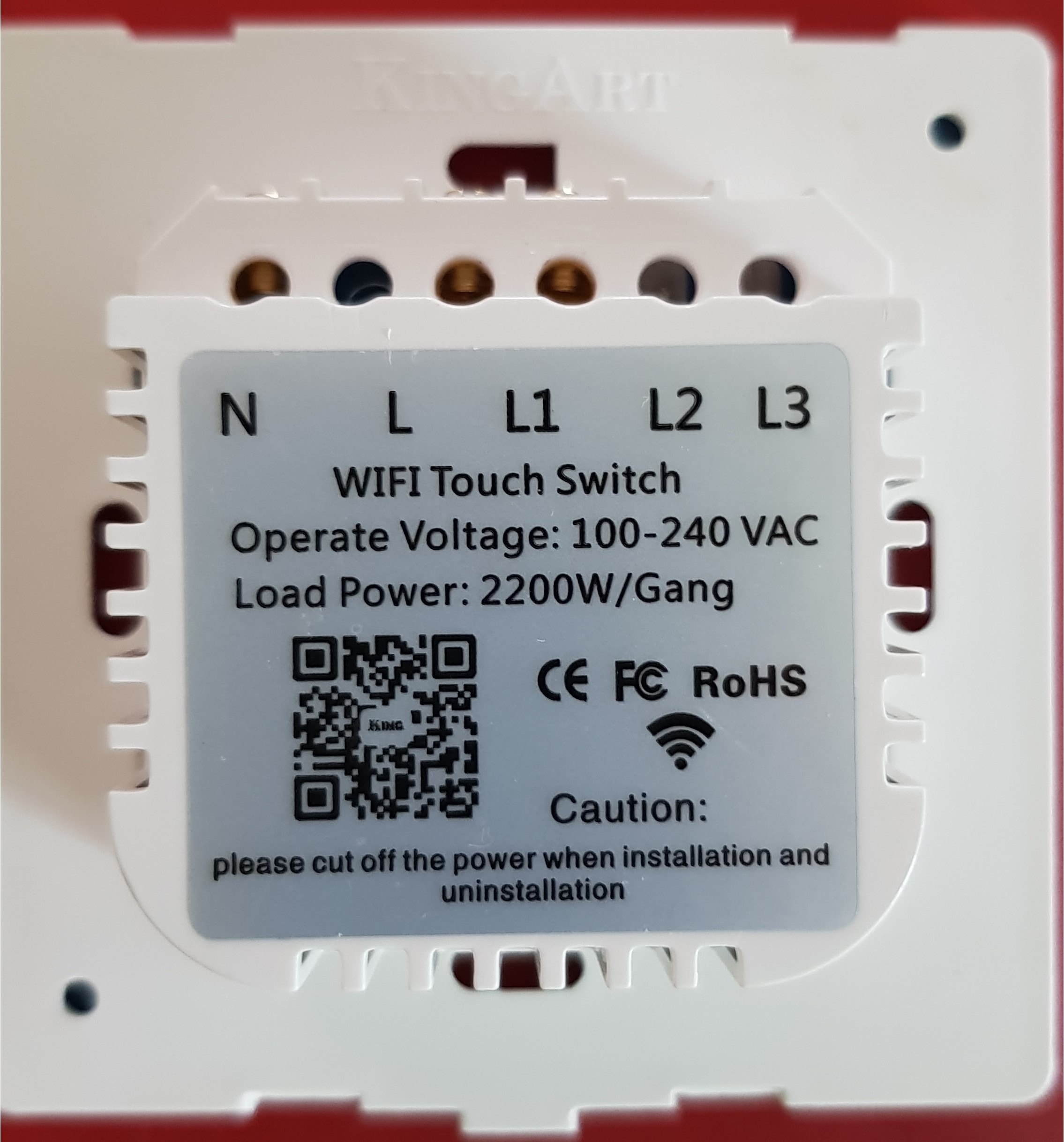

    Can someone help me connect the WiFi touch switch? I already installed such switches and everything was OK now, but I wanted to connect in the kitchen, but here I "buried myself" because the kitchen light is turned on by two switches where I can turn on one and turn off the other. When I connect blue under N, brown under L1, the light starts blinking whether it is on or off, the reaction is the same, connecting yellow under N brown under L1 no reaction when I turn on the light with the second switch (manual), the voltage appears in blue.
    I am already tired of this situation and I am asking for help
    Thank you in advance and best regards

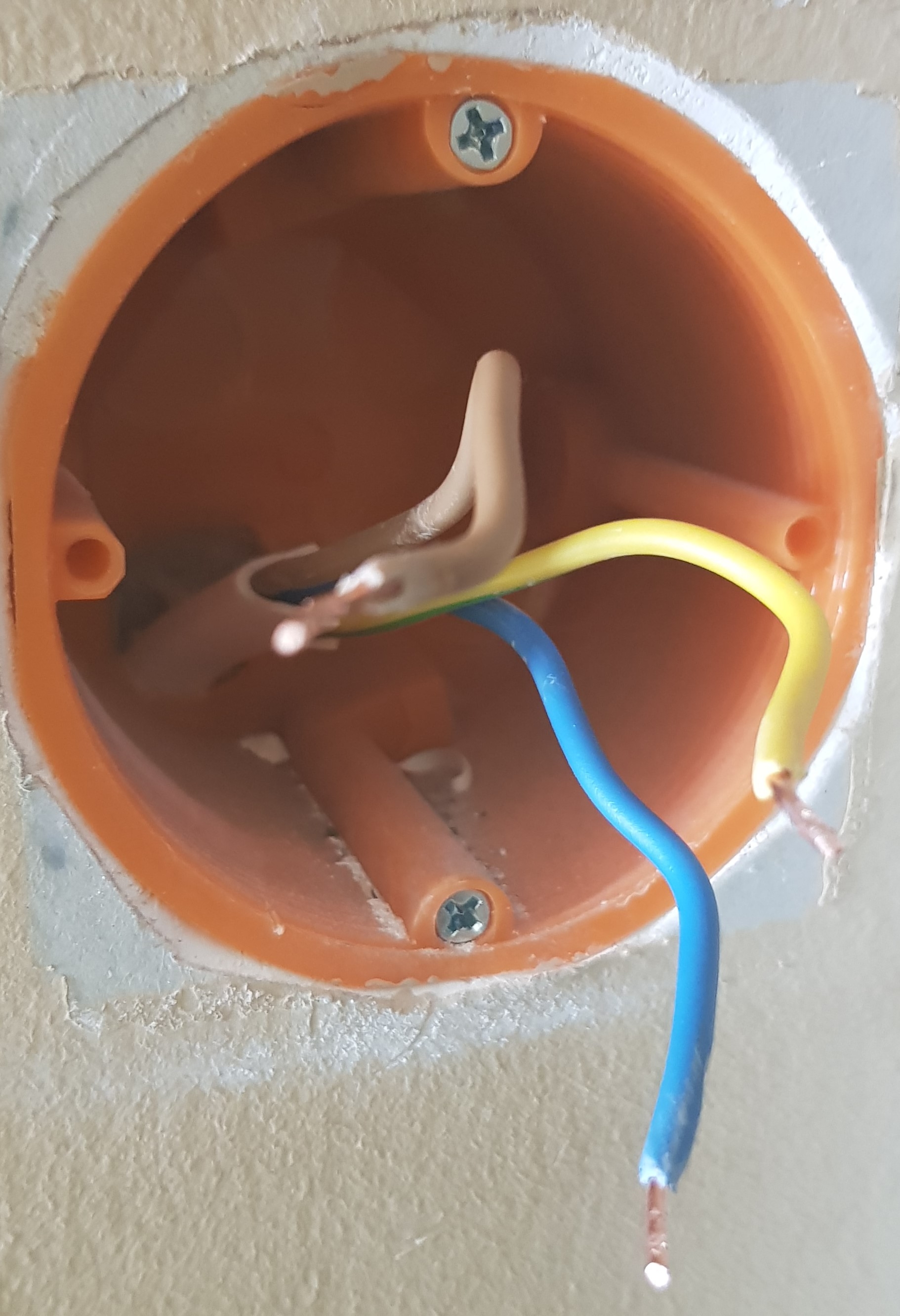

    And here is one socket for a toilet and the same light flashes when turned on
    bend :-(
    There is no mate in this box, neither "N" (ie neutral wire), nor "PE" (ie protective conductor).
    You probably won't connect a WiFi dongle here.

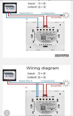

    Please include a schematic diagram of how this device should work.
    For a socket in the bathroom, the insertion of wires in the connectors is incorrect.
