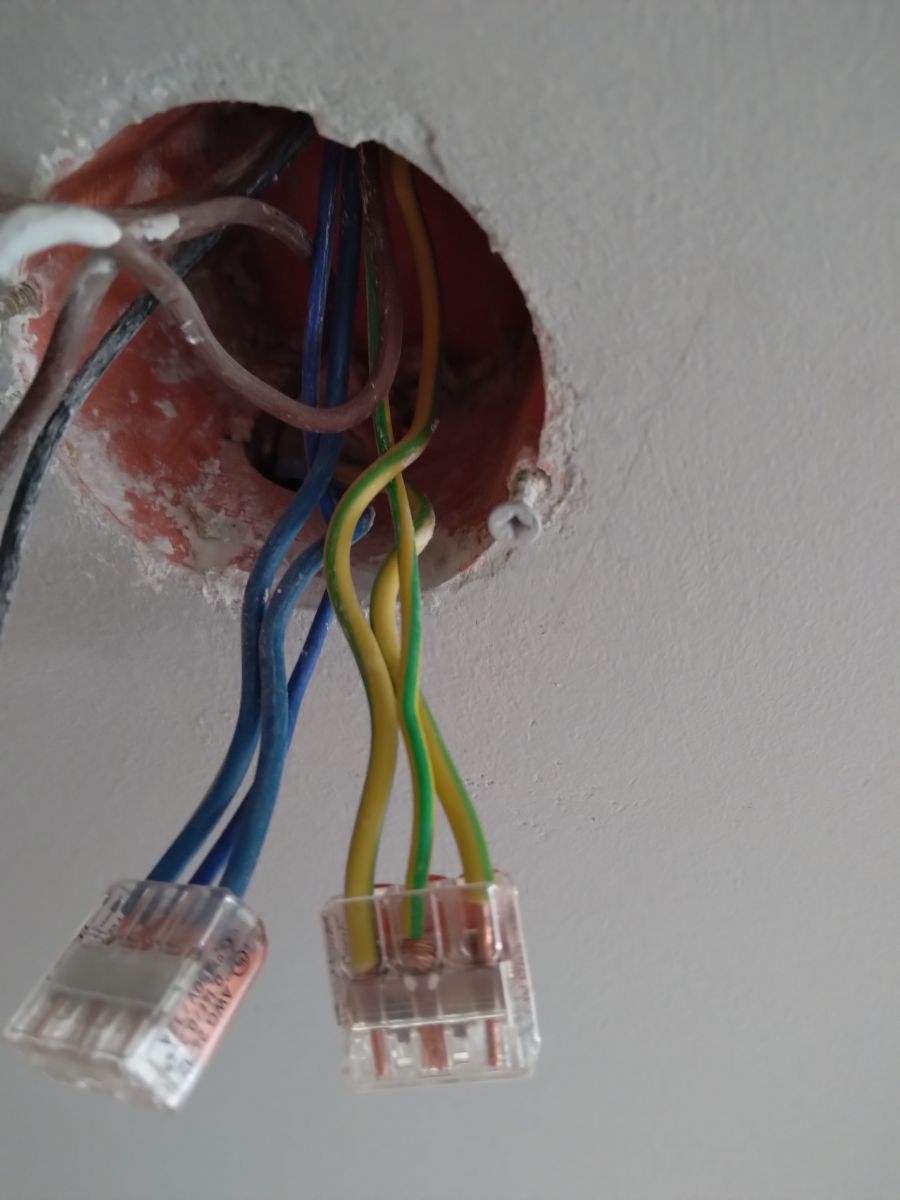

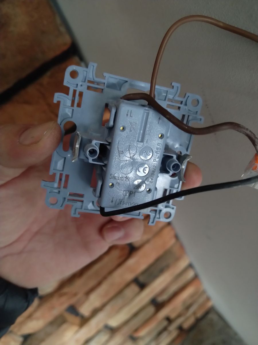

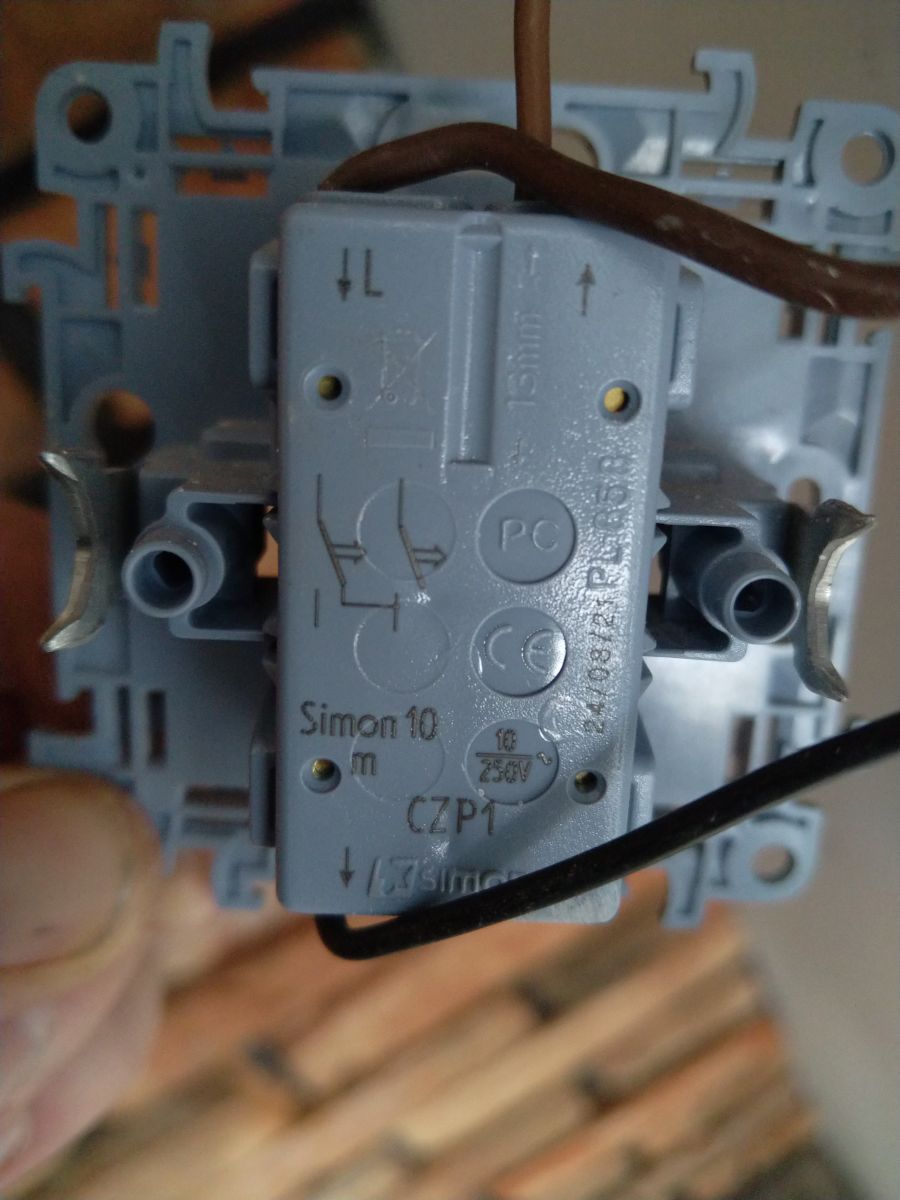

    Hi, I have a problem with roller shutters. I bought a flat from a developer and the roller shutter switch was a standard up-down switch and I had to hold it all the way down to open or close each window. A little bit tricky, so I ordered wifi switches. I paired it with my phone, it works, but it doesn't close or open the roller shutters. In the old switch, there were 3 cables connected to the old switch: phase, neutral, and black L2 or L3. I don't know, there are a couple of other cables in the box, grounding etc. The new wifi switch does not open or close the roll-down shutters even with the buttons, it does not react at all. On this switch, I have there marked N, L-phase, L2, and L3, and shit, or there is some cable missing from the box from the roll-down shutter motor, or I do not know. Strange that there are only 3 cables and the old switch had only these 3 cables connected.

    Well, you described the problem in one sentence, but not in a very clear way. Take photos of what you have in the boxes, what wifi switches you have, what voltages are in the wires and on which ones. Maybe something can be worked out.

    On the old switch, you have phase control, top down by passing on L1 and L2 to the actuator. And you still need an N wire for the WIFI controller.

    in the pictures the old switch in the box I found the phase from the roller shutter motor as the 4th cable

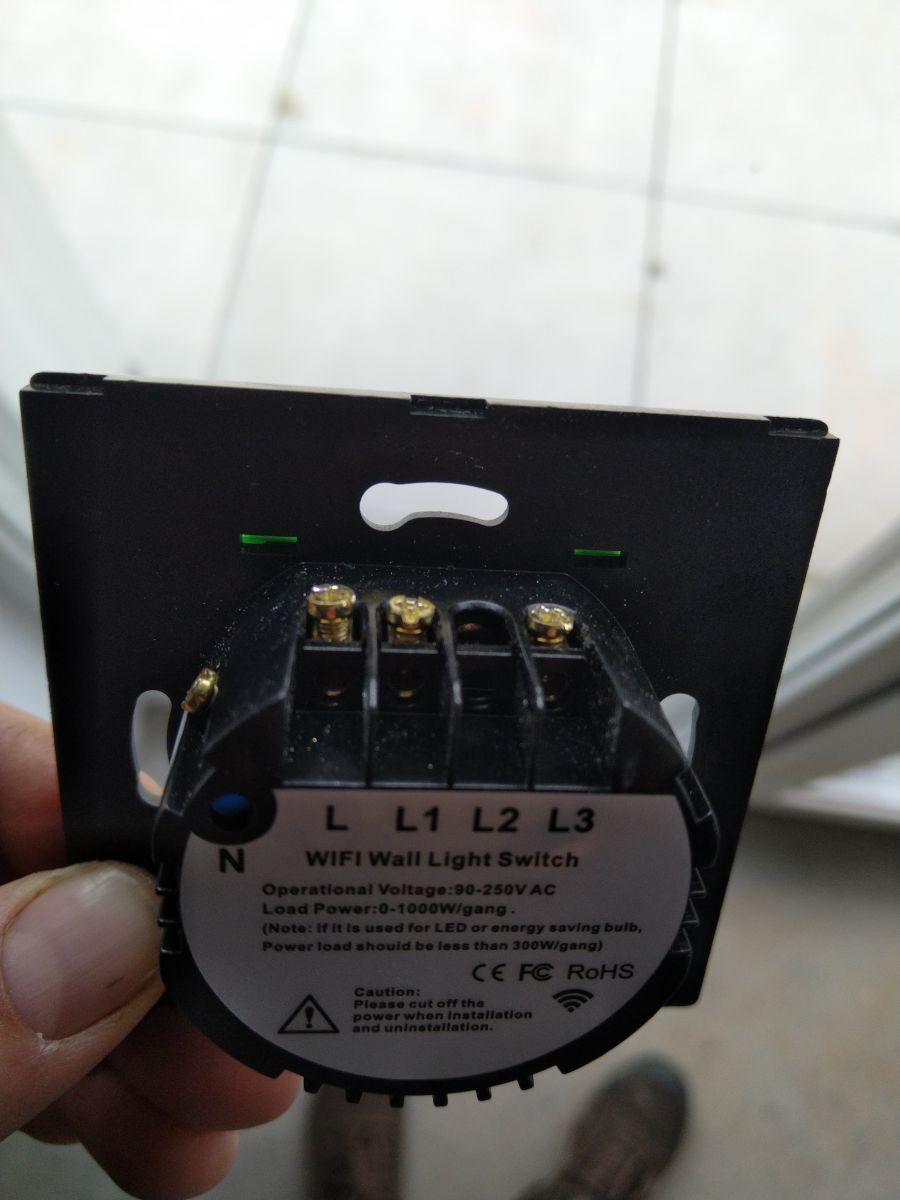

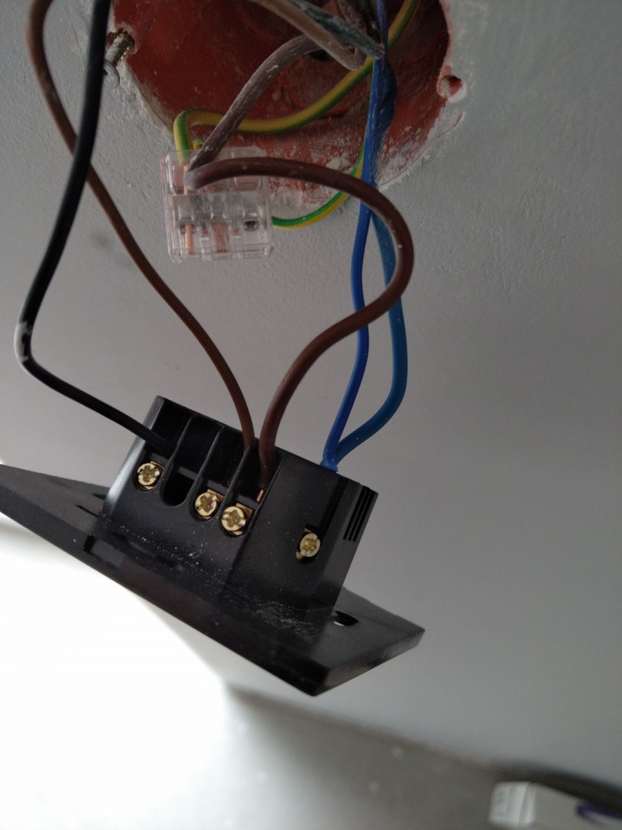

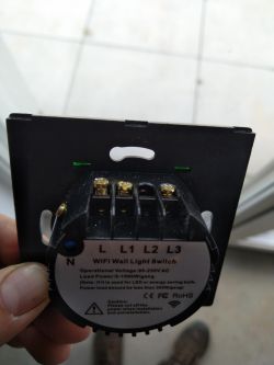

    WiFi roller shutter problem: Old switch vs new (3 cables, connection, developer, L2, L3) WiFi roller shutter problem: Old switch vs new (3 cables, connection, developer, L2, L3) WiFi roller shutter problem: Old switch vs new (3 cables, connection, developer, L2, L3) WiFi roller shutter problem: Old switch vs new (3 cables, connection, developer, L2, L3) I bought such a black switch. I also added that the yellow-green cable I found in the box comes out from the top together with the cables from the roller shutter motor, but it was plugged into the group phase from the socket switches etc. Now how to connect it so that the new switch works I must add that it does not work on 3 cables and the black cable goes into the neutral otherwise the switch does not light up brown L

    New on L you give brown from old L, on L1 L2 brown black and additionally blue on N.

    So from the cube from this tee I am supposed to pull the blue what comes out from the top of the box towards the roller shutter motor????
    #7 20467471
    78db78
    Posts: 10699
    Help: 1822
    Rate: 3297
    Well, yes blue you have to have a WIFI driver.

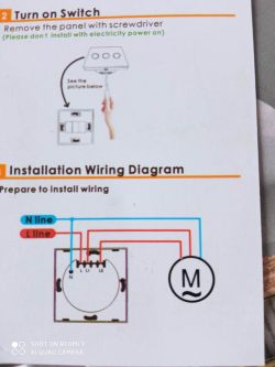

    WiFi roller shutter problem: Old switch vs new (3 cables, connection, developer, L2, L3) >>20467471 This was the manual attached 😉

    You have a diagram of how to connect I see.
