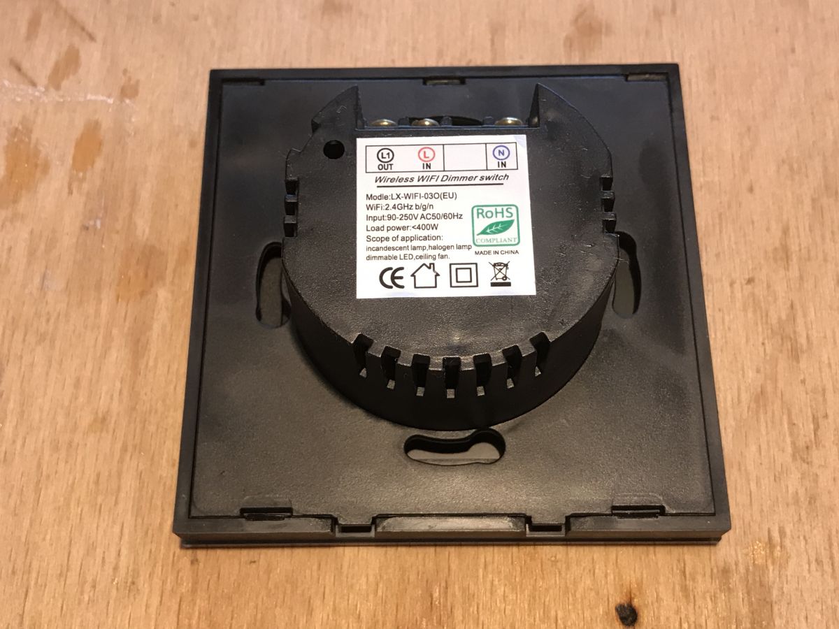

    Rear:
    Smart light switch dimmer QTouch WiFi [Schematic, UART protocol]. .
    There is a different product code on the case to the one on offer. LX-WIFI-03O (EU) . Under this heading you can find offers from outside our country. There is nothing about the RF433 in them.

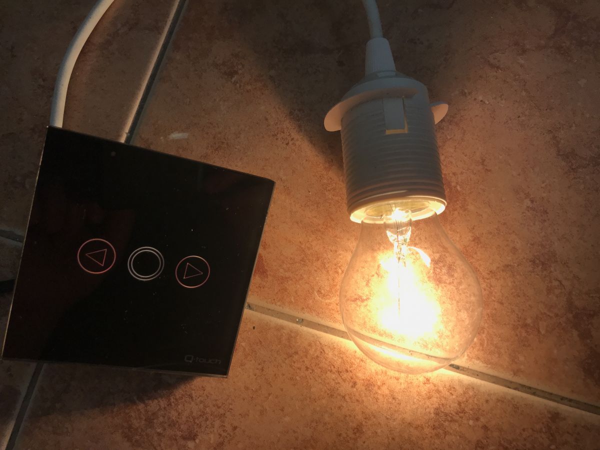

    The buttons are illuminated, in my opinion the whole thing is quite aesthetically pleasing and I like it.
    The buttons respond quite slowly, but the dimming is smooth, but not from 0.
    Smart light switch dimmer QTouch WiFi [Schematic, UART protocol]. Smart light switch dimmer QTouch WiFi [Schematic, UART protocol]. Smart light switch dimmer QTouch WiFi [Schematic, UART protocol]. Smart light switch dimmer QTouch WiFi [Schematic, UART protocol]. .

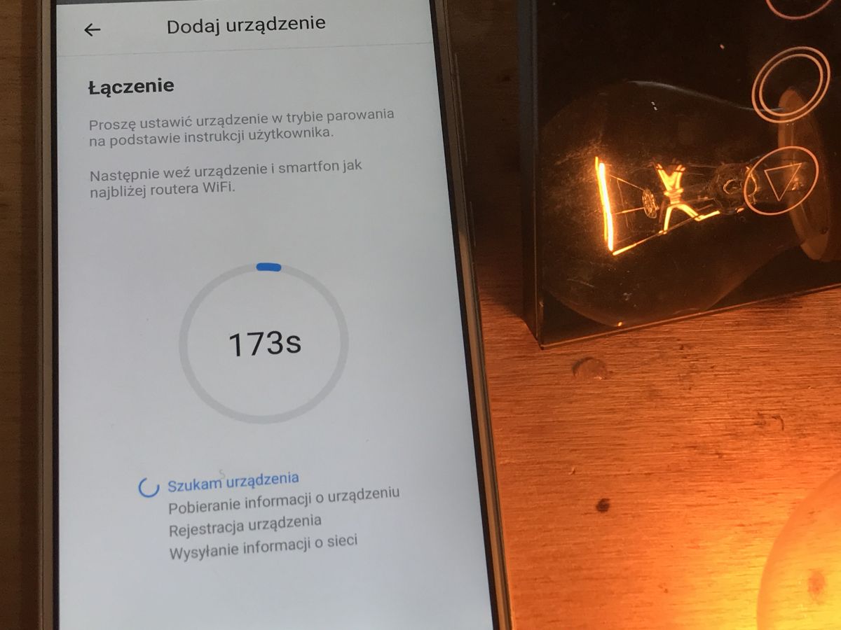

    Pairing with eWeLink app and phone control .
    Before pairing, put the unit into RESET mode by pressing the button for a long time (until it starts flashing rapidly in blue).
    Pairing works in "Quick Pairing" mode.
    Pairing requires the SSID and password of our WiFi (2.4GHz only supported).
    I have covered the Smart device applications in detail in previous topics in this series.
    Step-by-step screenshots of the pairing:

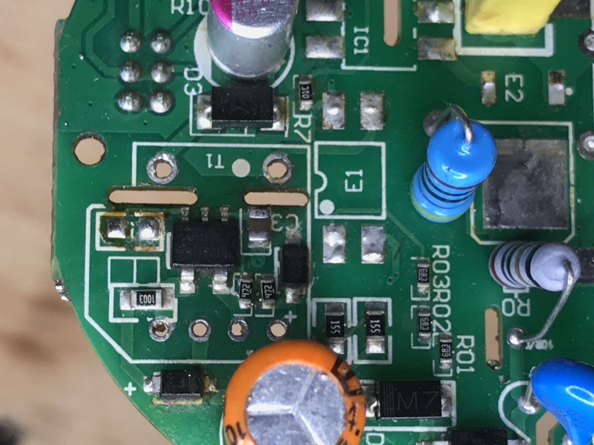

    Transistor 1AM (to turn on the triac?).
    That is, MMBT3904LT1.

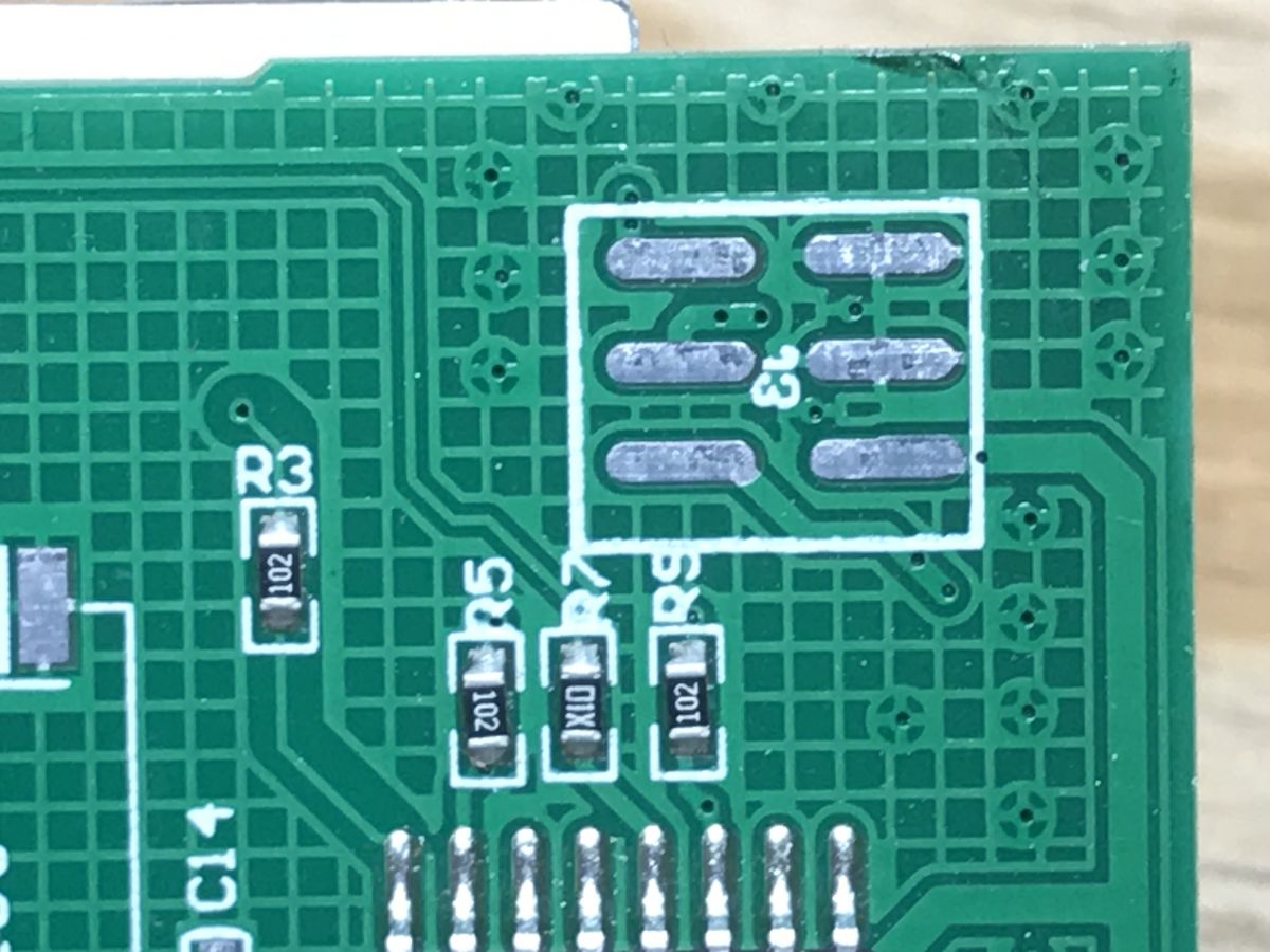

    Two useful soldering points:

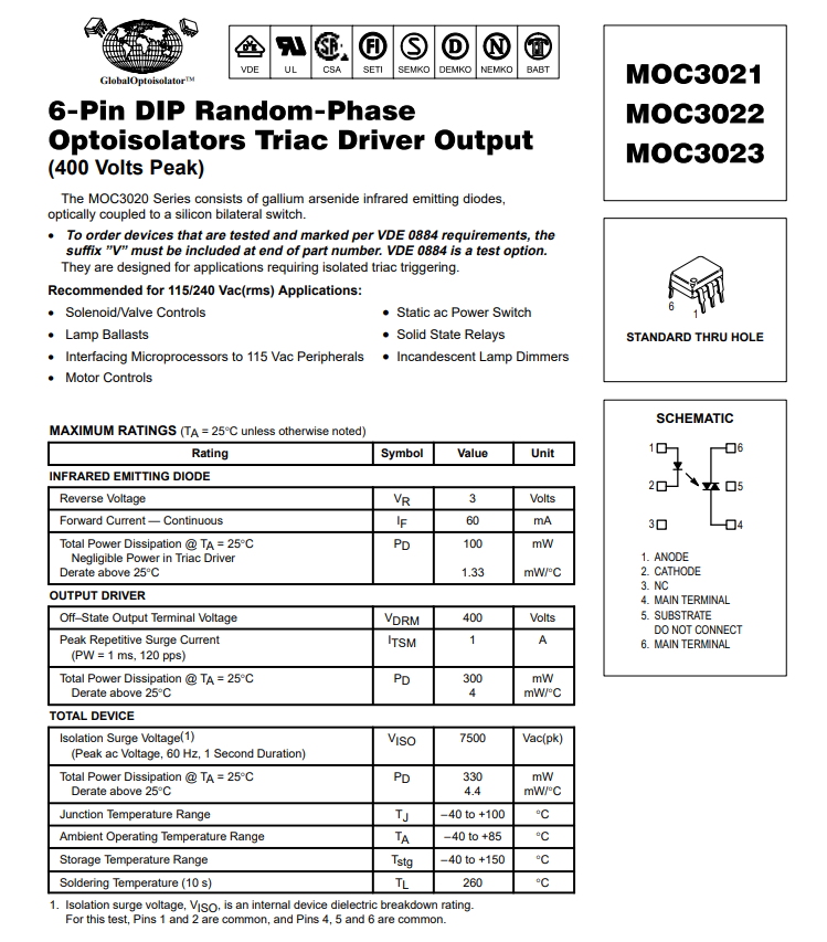

    And on the other side is the triac with its driver.
    MOC3021 manufactured by Fairchild:
    And the triac itself, BT136S-600E:
    While we're here, we can take a look at the MOC3021 data note and explain its connection to the BT136S.
    Additionally, with the AN-780A:
    A 360 ohm (2W) resistor here protects the optotriac from high current when switched on. A 470 ohm resistor (2W) and a 0.05uF capacitor (here: 0.047uF MKP X2 275V) reduces interference for the MOC3021.

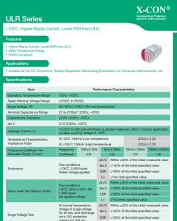

    Changed capacitors? Voltage measurements .
    Already at this stage something didn't sit right with me.
    On the secondary side there are capacitors, consecutively a ULR "silver" at 6.3V with a capacity of 470uF, and then there is the usual electrolytic at 10V, also 470uF.
    Shouldn't it be the other way around?
    I have checked the voltages on them:
    Indeed, on the one at 6.3V there is just under 4V and behind the six legged circuit which is definitely an LDO or possibly a mini step down converter there is 3.3V (and a capacitor at 10V).
    But I think I can see the rationale for this. ULR series:
    This is a low ESR capacitor, and the output of a flyback power supply should be just that. A bit low voltage, but probably still this one better than the usual electrolytic one that is further out. But maybe the Chinese guy got the wrong place?

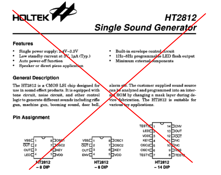

    The inverter controller is a HT2812H.
    And here we have a strange situation - because there are two components with this name (ew without the H) on the net.
    The tone generator from Holtek (it's not this chip):
    And an inverter controller from Hot Chip (it's this chip):

    First attempt at programming .
    At first I thought just use the pads of free space on the TYWE3S or there ESP12, solder the wires there, UART RX TX and esptool.py will work:
    ESP12F pinout (pins also compatible with TYWE3S):
    I have discussed the programming procedure itself several times before, including here:
    https://www.elektroda.pl/rtvforum/topic3749207.html
    Unfortunately it did not work. Esptool.py was not even able to recognise the ESP.
    A quick check of the connections with a multimeter explained why:
    The UTF87001 is connected to the ESP825 via the UART and probably communicates with it too. This makes it impossible to program the ESP. The UTF87001 would have to be soldered out.
    And I will solder out the UTF87001 - but that's later.

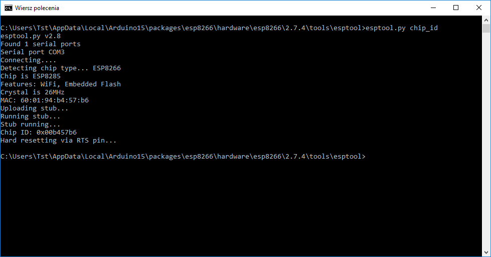

    The programming started working straight away. Command esptool.py chip_id :

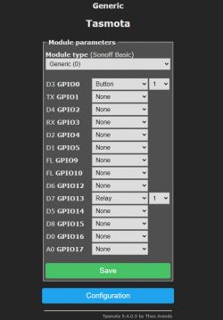

    The first thing I saw after uploading the batch and configuring WiFi for the Tasmota was that, surprisingly, the default setting was already working for the button and LED (that LED what flashes quickly when we are in pairing mode):
    Such as here:
    https://tasmota.github.io/docs/devices/Sonoff-Basic/
    So a configuration like this:
    GPIO0 is the button and GPIO13 is the LED.
    And the other thing I discovered is that the dimming buttons (the ones on the sides) still light up red and when pressed they light up blue, meaning ESP is not involved in their operation.
    I decided to check everything with the bulb (after disconnecting the computer):
    It quickly became apparent that even after uploading Tasmota to the ESP it continued to work:
    - controlling the brightness of the bulb (when lit)
    - switching the bulb on and off using the centre button
    This confirms that these two operations are performed fully by the UTF chip.
    The ESP, on the other hand, only controls the LED from the centre button and can also read its status, but cannot control the bulb directly.
    That is, the centre button is connected to both the UTF and the ESP
    (and this is logical, because ESP needs it to detect the pairing mode and UTF to switch the bulb on/off).

    - the triac is a BT136S, controlled by a MOC3021, an optotriac, it also provides isolation
    - a large 2W, 470 ohm resistor protects the optotriac from high current when switched on (see AN780 for details)
    - a large 2W, 360 ohm resistor and capacitor C3 MKP X2 at the triac act as snubber, the diagram is according to the MOC3021 data sheet
    - The MOC3021 is controlled via transistor 3904 located on the second board, via UTF87001
