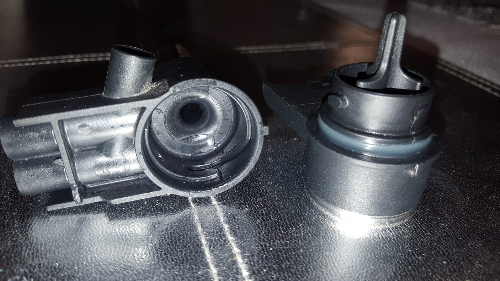

    Does anyone have an idea what else I can check if the milk / water is sucked in by the foamer tube? It seems to me that the frother is tight and clean, I have been descaling many times in recent days (liquid and cubes). I am not sure if the amount of steam is sufficient to create a vacuum in the tube. Do you disassemble and check the ceramic valve?

    I have a request for those who have a similar machine: is there a gasket missing in the milk frother (photo), an element that could fall out during cleaning?
    Could the pulsating (discontinuous) production of steam (film) be the reason why the milk is not puffing? I am sure that the frother is tight, additionally I replaced the seals on the steam nozzles

    As I thought before there was too little steam. This model has two heaters 2x950W. One of these wasn't switched on (no control impulses of triac gate). It turned out that connection between circuit board layers was corroding (photo). My wife will be happy!
    Thank Janos for interest and time.
    I treat the topic as closed.
