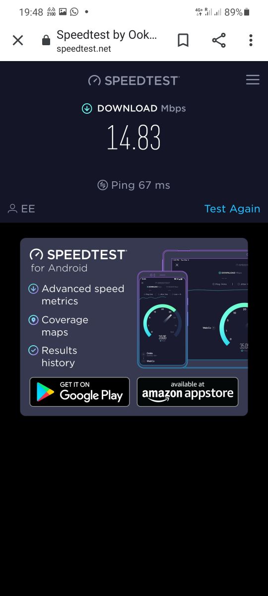

    mateuszgbiorczyk
    Posts: 30

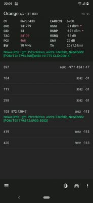

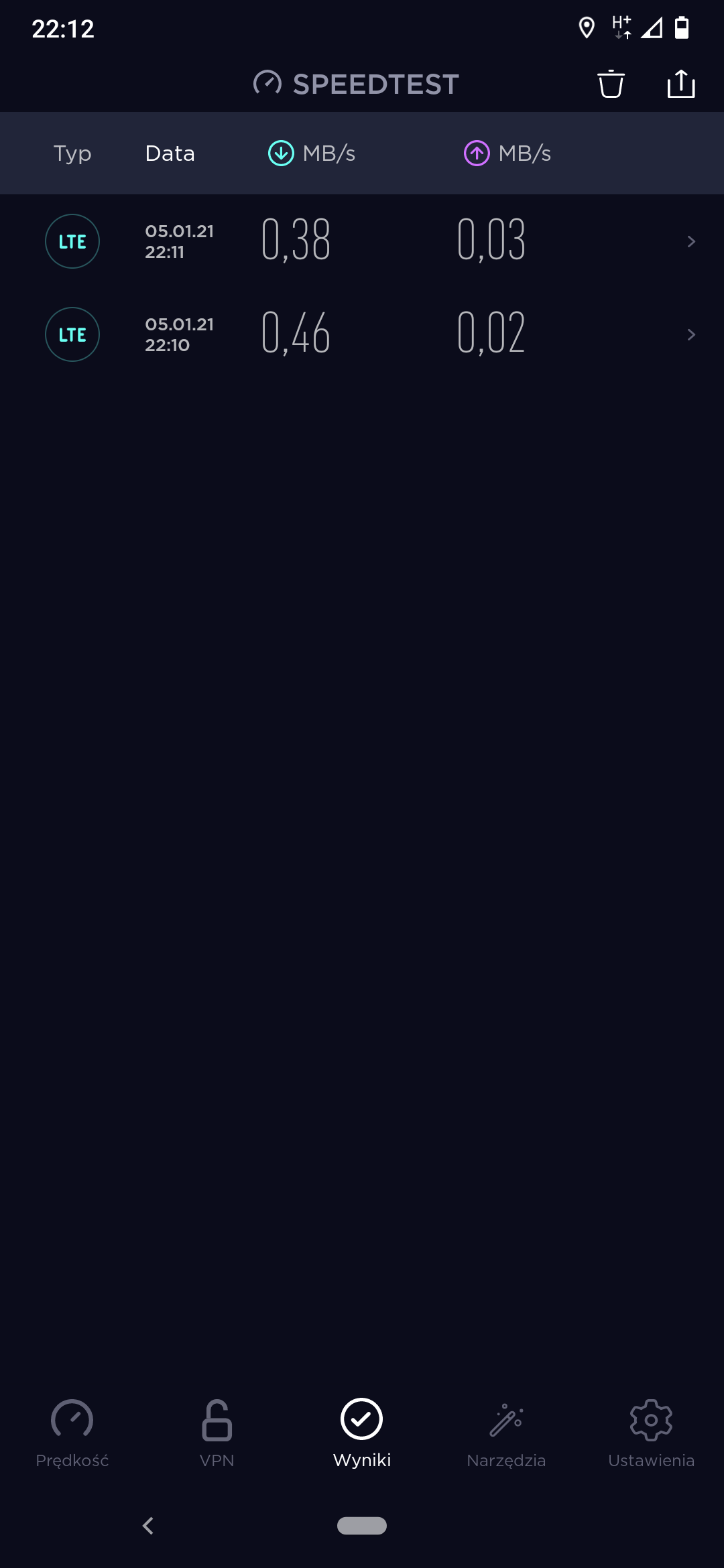

    Approx. I did all the tests - first I did the test in the Huawei application, then 3x speedtest and finally the Huawei application again. The router was placed in the best possible place - I was sitting with the phone very close to the router.

  • #15 17395341
    matek451
    Posts: 31253
    Help: 4352
    Rate: 5808
    The router has connected to T-Mobile's BTS LTE800 in Bugaj, signal parameters are weak. Home or outdoor test? The speeds are not bad, the LTE1800 + 800 aggregation did not turn on. Check also LTE1800 by forcing only this band in HManager.

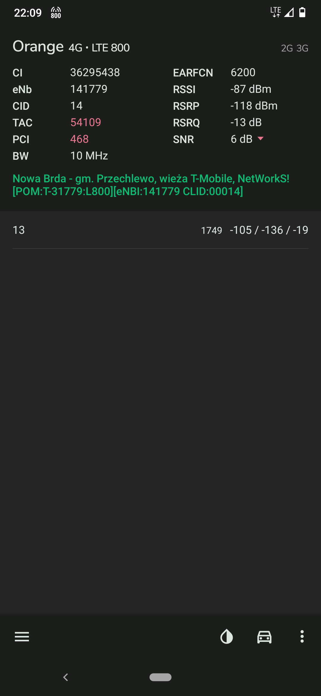

    #18 19162494
    mafefka1402
    Budget-friendly LTE Modem with Gigabit Port & External Antenna for Rural Connectivity Budget-friendly LTE Modem with Gigabit Port & External Antenna for Rural Connectivity Budget-friendly LTE Modem with Gigabit Port & External Antenna for Rural Connectivity Budget-friendly LTE Modem with Gigabit Port & External Antenna for Rural Connectivity
    Hello, I am sending photos, the speed varies depending on the weather, I had a maximum of 14 m, now it's linden. I generally mean that the range should be from the lte antenna and not from h + or edge, and I have the latter two inside the building, outside will be the range yellow so it will be better, thanks for your help

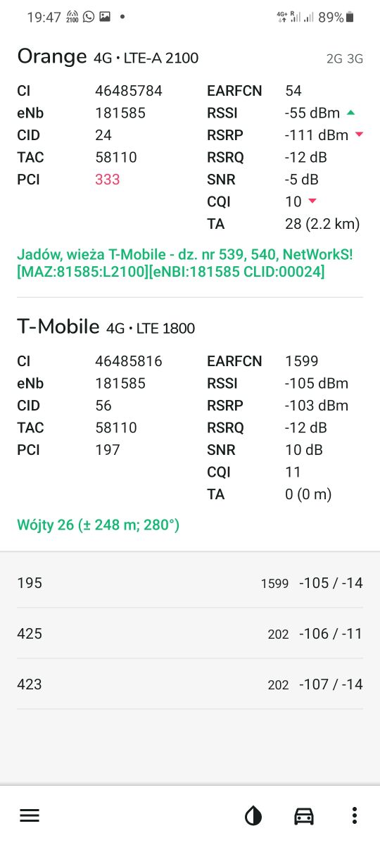

    #19 19412772
    remas81
    Posts: 18
    Rate: 8

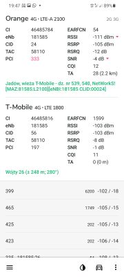

    Hello, I would like to connect to the topic. My location is Letnisko Nowy Jadów. The nearest transmitter is t-mobile (about 3 km) in Jadów, but for some reason Orange works better, although both the closest transmitters are about 6 km away. In addition, the forest around. I am not looking for anything but a stable connection. At the moment, about 1-2 Mbit / s is working, in a moment 10-15 Mbit / s in a moment the signal disappears for 15 seconds and the People's Republic of Poland again ... I want to lead the antennas outside. In addition, my router (DWR 921 D-link), after the last change of the card from Orange to T-Mobile (for the test, I changed back to Orange), started to go dumb. LAN works, I can connect to the router via LAN, but the internet disappears on the computer, although the router lights up that the internet is on and the panel reports full signal range at -75dbm. I can change the router. I can buy antennas. I just want to not get upset about it. I plan to move there and although it will probably be difficult to get used to 100 Mbit / s, I need this internet to be there. It can be free, but keep it stable. The question is what I can have in the category of quality / price or how much should be added to make it simply good. I would like to buy the antennas at www.dipol.com.pl, thank you in advance for your answer
  • Recommend testing local LTE bands before buying router
    #20 19412932
    matek451
    Posts: 31253
    Help: 4352
    Rate: 5808
    The NetWorks station in Jadów works on LTE2100 + 1800 + 800 for Orange and T-mobile, then you have T-mobile and Play with your LTE2100 + 1800 + 800 is also hanging on it. You should test these operators on their cards on the phone outside and show screenshots from the application https://play.google.com/store/apps/details?id=cz.mroczis.netmonster&hl=pl and evening speed tests. DWR-921 is a museum and it is not suitable for these operators, why a bad idea to buy in Dipol?
  • #21 19413322
    remas81
    Posts: 18
    Rate: 8
    dipole = discount :)
    I will do the tests when I am on the plot, I will throw in the screenshots
    The 6km did not suit me a bit, but the BTS map that I found showed only T-mobile and play in Jadów
    the question is whether I can look for some equipment or only after the tests?
    greetings
  • Recommend B535 with dual-band LTE antenna and carrier tests
    #22 19413335
    matek451
    Posts: 31253
    Help: 4352
    Rate: 5808
    The price does not always work miracles, a bad Dipol antenna and it will be like teraZ, which is bad, in addition an old router, so the set is as it looks. The minimum router is B535 with aggregation of 2 LTE bands, including LTE2100 + 1800, is it worth something more expensive to Orange / T-mobile, then the test will show. The antenna is basically at 1800-2100MHz, i.e. Dual LTE 1800-2100MHz, unless you choose equipment with aggregation of 4/3 LTE bands, then broadband to use LTE800. CPE LTE MF258K or WF830 are also at stake, and the basics are always tests.

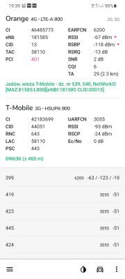

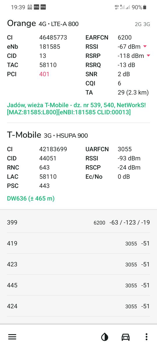

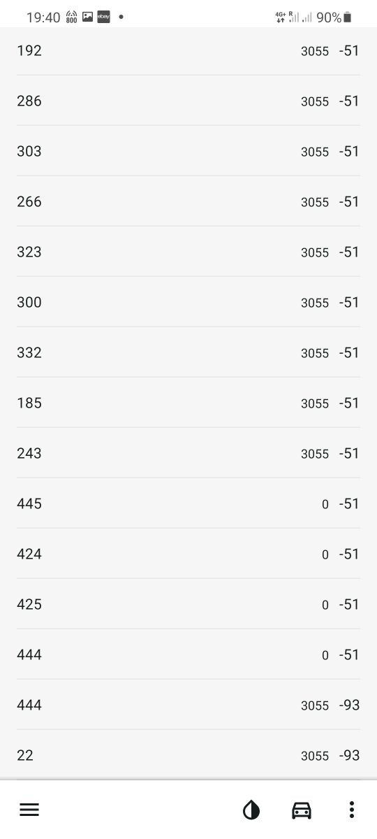

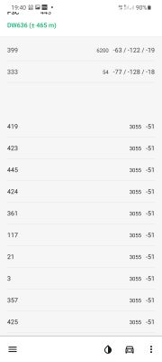

    #23 19417790
    remas81
    Posts: 18
    Rate: 8

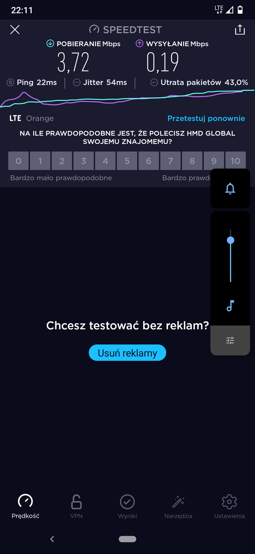

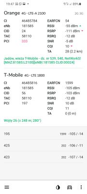

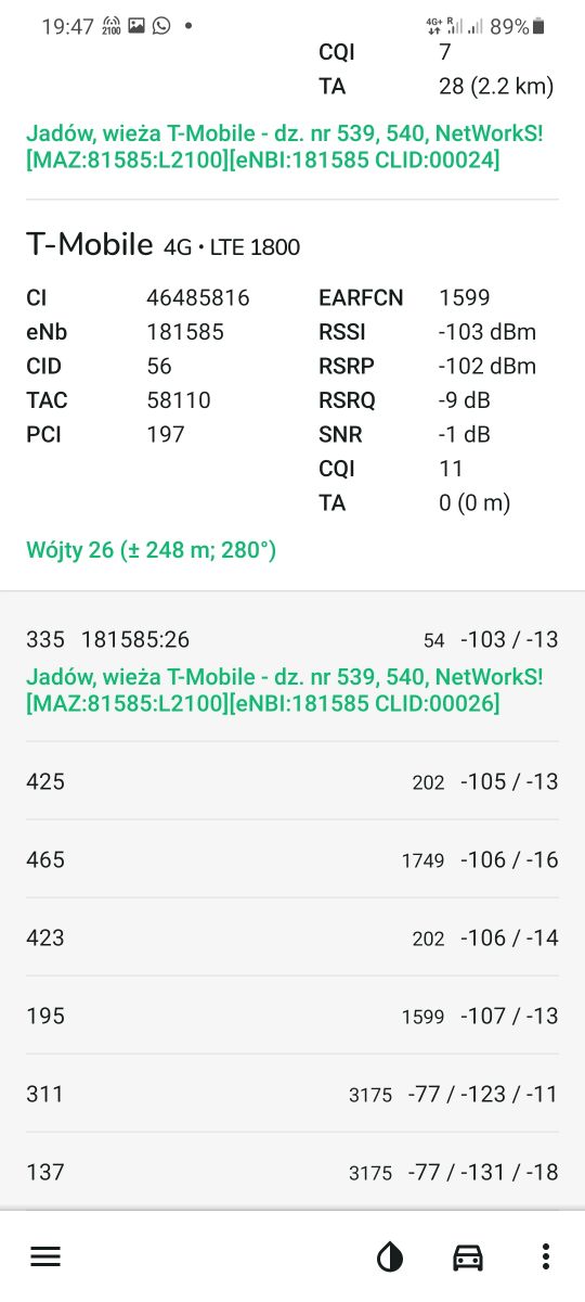

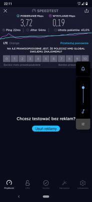

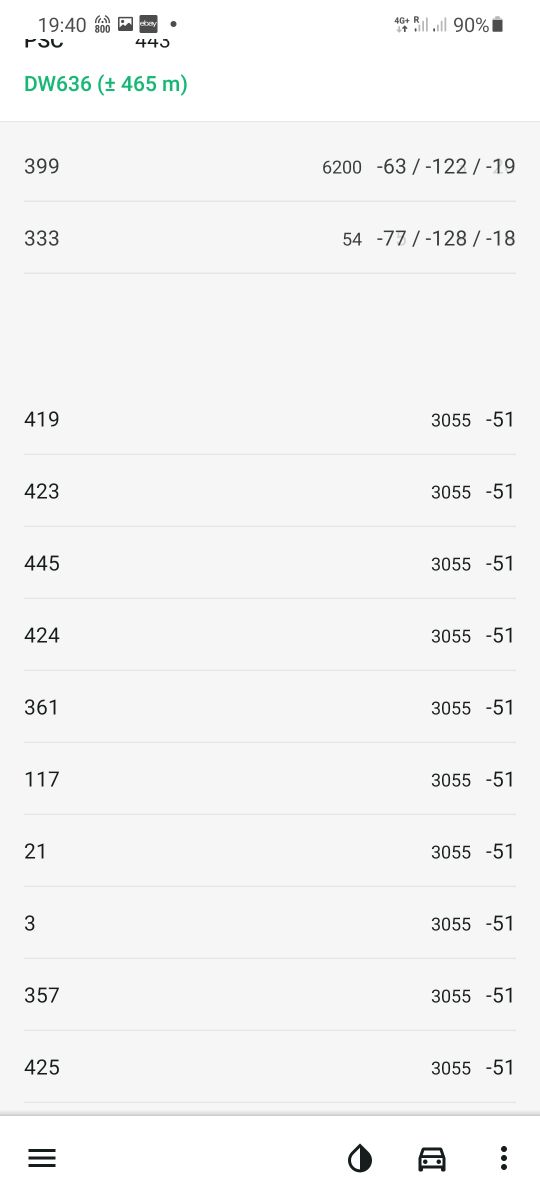

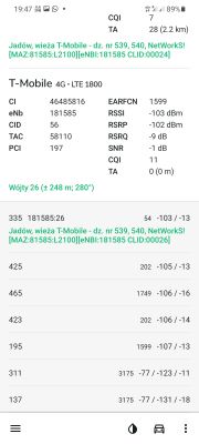

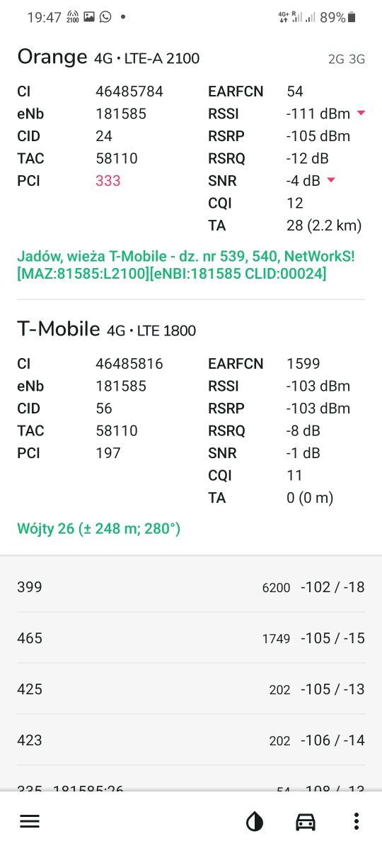

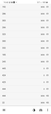

    I'm going to the plot today and I'll post screens in the evening. What is the best question to do these tests? 18-19 20-21 ??
    Added after 11 [hours] 3 [minutes]:
    @ matek451
    After testing. There will be only a small problem with the speed test, because I have an English operator card (which connected Orange) and I think the ping was to the server in Northampton. Tomorrow I will be on the plot again (although I would like to go there with the equipment and install it) I can also improve these tests. The good news is that I made two sets for comparison (one at home, the other on the roof at a height of about 1.5m from the roof) and the latter values were incomparably better. In addition, I noticed that when I mount the antennas at the desired height, they will probably 'see' the BTS, I am hopeful as well. Pics below
