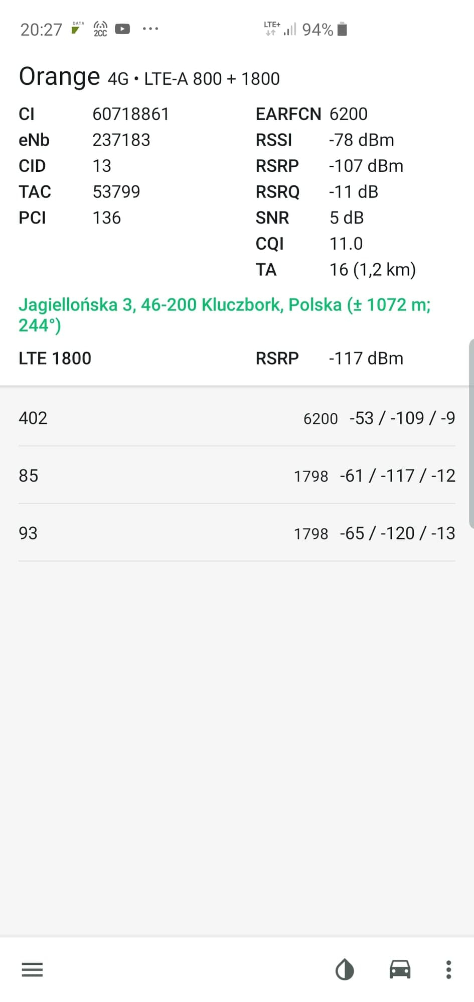

    Hello, I'm green in this topic, so I'm asking for advice. I have internet for a SIM card from Orange, a small cube for wireless connection to the internet. The connection is dropping all the time, you have to restart it forever, etc. In Orange I was told that it is too weak a device to support multiple devices at once and it is more suitable for traveling than for using the Internet at home. When my sister is alone, apparently the internet works fine for her (she only has a computer, phone and watch connected), and when I come home, a computer, two phones, a watch, a printer, a tablet start and problems begin. In the Orange showroom, I was recommended to buy a good router and wanted to ask what I should choose.
    In my place of residence, it catches LTE internet, the house is two-storey, with an area of over 200 square meters, reinforced concrete ceilings, and it must catch in the basement and on both floors.
    A router up to PLN 500 would suit me, but if you know one worth more money, I am asking for suggestions. There is a lot of it on Allegro, I have read guides on what to pay attention to, but there is such a choice that I do not know what to choose.

    What is the location? What is the MiFi mobile router? What problems do you have with it, is it a question of supporting devices via WiFi or LTE connection? What they say in the Orange showroom does not matter, they do not know what they are saying. You should first perform LTE Orange tests, check which BTS NetWorks you are using, on which LTE band, what are the signal parameters on it. Do speed tests. On this basis, an LTE router and a possible external antenna are selected.
    If it is a problem with WiFi, you should do range tests at home, measure the WiFi signal parameters at critical points. The general rule is that stationary devices are connected via LAN cable to the router, and portable via WiFi. The MIFi you have (what?) Does not have LAN ports and after WiFi will support 10 devices, it is generally not dedicated to work 24/7 as a stationary router. His choice was a mega-mistake, but the consultants from the Orange salon sold it to you. There is no chance to cover a house like yours with one stationary router, you need an additional AP for the LTE router connected to the LAN with a cable. Preferably one AP per floor.

    I just know that. salons know nothing, so I wanted to ask. I use it in the city of Kluczbork, the coverage of each operator is good in my city. I am using Orange Airbox LTE
    Best Router for SIM Card: Improve Connection with Multiple Devices in 200sqm Home (LTE)
    The problem is that a million times a day he disconnects when looking at the wifi icon as if it is connected, but the dropbox icon turns off and the internet disappears. This is how I recognize that it has crashed. It takes many minutes, usually I can't stand it and go to restart it, sometimes you have to do it several times and then it's ok, but not for long, because the situation repeats itself many times a day. The internet is disappearing on all devices, so it's not a device issue, it's a connectivity issue I guess.
    I don't have any stationary devices, I need wireless internet for everything. You are right with this device of mine, it is not dedicated to 24/7 work, and unfortunately this is how we use it.
    I don't know how to find out what you described and do these tests. Could you please write me how to make them? What if I bought a router downstairs sister had this device upstairs we have now, we would take a second SIM and sort it out somehow? Is a router a good idea for every floor?

    You have the worst possible crap, i.e. the Alcatel MW40, a mobile router without signal diagnostics, without the possibility of choosing the LTE band and without external antenna connectors, not useful for LTE signal diagnostics.
    First, put the Orange card into the LTE Anfroid phone with the application https://play.google.com/store/apps/details?id=com.wilysis.cellinfolite&hl=pl and show the Indicator tab, make a DL / UL speedtest and show result. Orange is not a dream operator in Kluczbork, the NetWorks network is as thin as ever, 4 BTS with bare LTE1800NetWorks is a misunderstanding. From the assumption, there is no need to count on much. Well, PLN 529 for the B525 is 2x too expensive. What is the street in Kluczbork?

    The nearest BTS NetWorks at Kościuszki 33, LTE1800NW on it, i.e. common 15MHz band for Orange and T-Mobile customers and 3G Orange on UMTS2100HSPA + DC (may be faster than LTE1800NW). The same BTS at the Stobrawa hotel. But the tests are the key anyway.

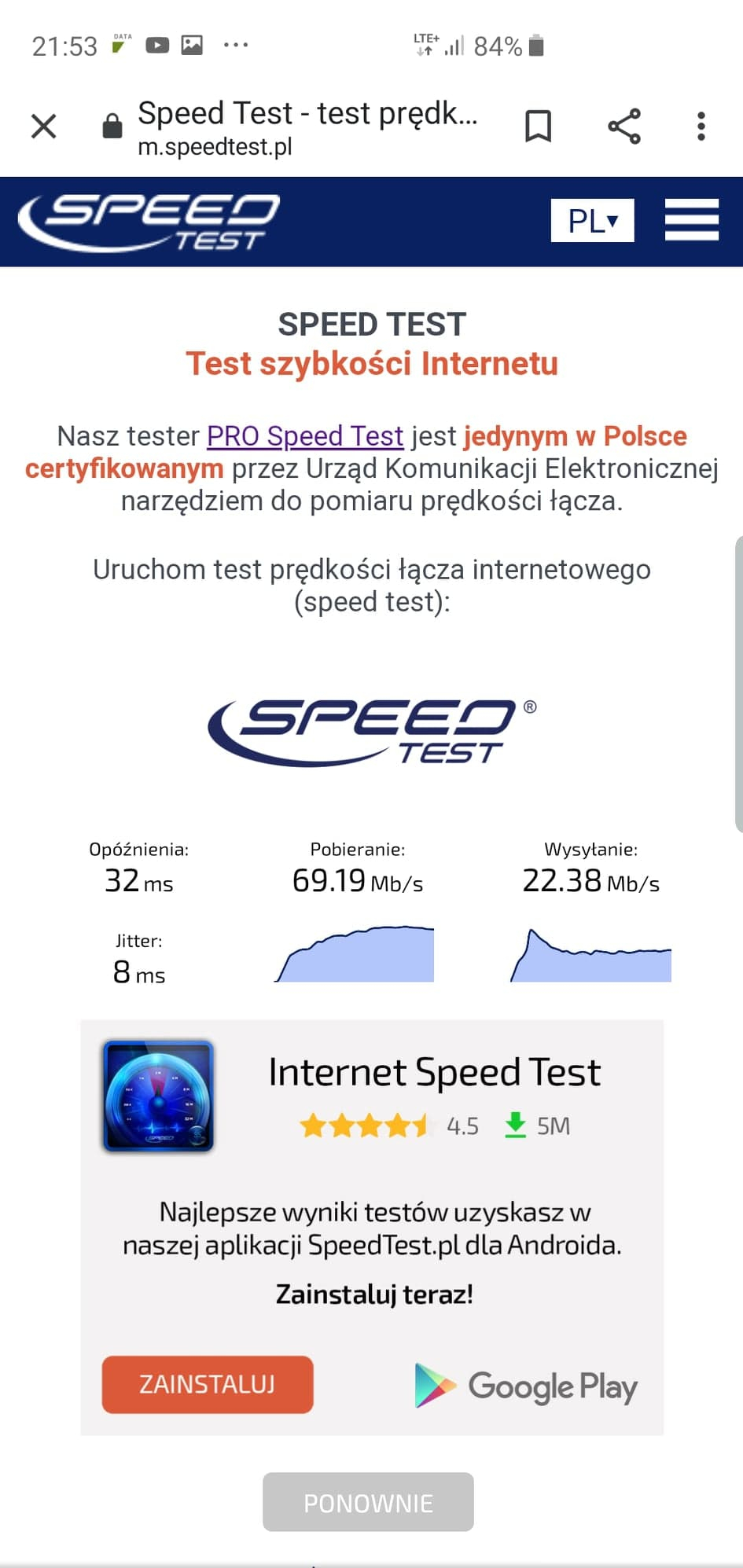

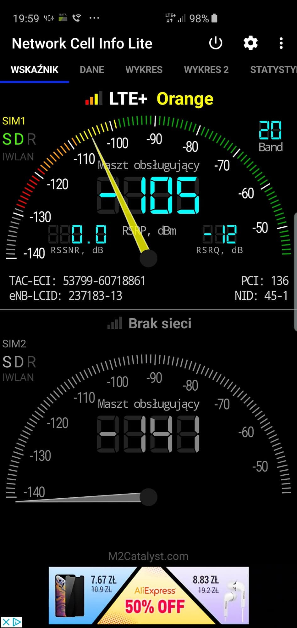

    Here are the test results (I hope I did them well):

    The test showed aggregation of LTE bands from BTS at the Stobrawa hotel as the LTE800 baseband and aggregation with some other band to it, this means that LTE800 Orange was added to the BTS. Signal parameters poor, not bad speeds. Do another test but this time also use this application https://play.google.com/store/apps/details?id=cz.mroczis.netmonster&hl=pl, this one also shows additional bands on LTE +, i.e. it will show the main LTE800 and others screen of it. The phone uses LTE + band aggregation, hence the better DL and how does it look when connected with this Airbox? This MIFi does not aggregate LTE bands and inside it can only connect to LTE800 if the coverage on LTE1800 is weak. / Correct LTE signal parameters https://jackiewiczowie.blogspot.com/2014/10/parametry-sygnau-lte.html

    Irrelevant, it is important that it showed aggregation of LTE800 + 1800 from BTS Mickiewicza 27. Inside the signal on 800MHz from LTE800 is weak, RSTP-107dBm, on 1800MHz with LTE1800 already residual because RSRP -117 very weak. LTE800 Orange is a 10MHz bandwidth. In general, check now how DL / UL works from this MiFi Airbox, at -117dBm on LTE1800 it does not connect with it, and when it comes to such a signal, the speeds should be low. Probably logging into LTE800, but there is no signal diagnostics on it, so we will not confirm it. The tests shown prove the poor coverage of the LTE800 inside the home and the residual range of the LTE1800. An external antenna is necessary, you will not connect it to the Airbox. You can see that choosing this toy was a mistake. If you want to use LTE800 + 1800 or LTE1800 + 800 aggregation, you need a router with 2 CC CA B3 + B20 and an external antenna working at 800 and 1800MHz. The issue of the local network and WiFi coverage at home is another issue. As I wrote an additional AP.

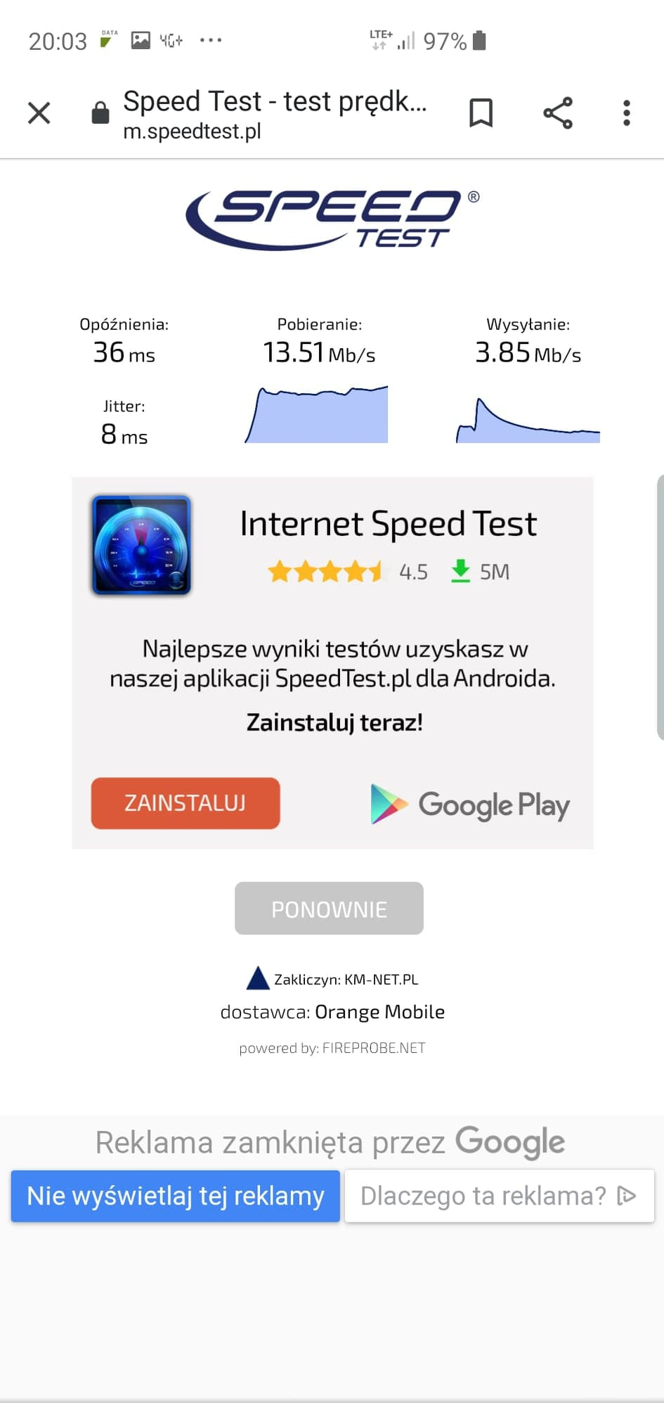

    But in which program to do this test? I have to insert the card into this device and normally on speedtest do it on the computer?

    Overall, not bad for a single LTE band (probably LTE800), but about 10Mb / s is difficult to divide into several devices and users. You can also see for yourself at the end how Orange works for you on a phone with LTE + aggregation when you put it out of the window. Then the signal parameters on LTE800 and LTE1800 will improve by about 10dB, which should translate into an improvement in DL / UL. Do speedtests with the phone outside the window, show the speedtest and screen from NetMonster. In general, you can say something about the equipment and the antenna for Orange.
  • #18 18226909
    Czarna_88
    Posts: 27
    Rate: 22

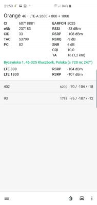

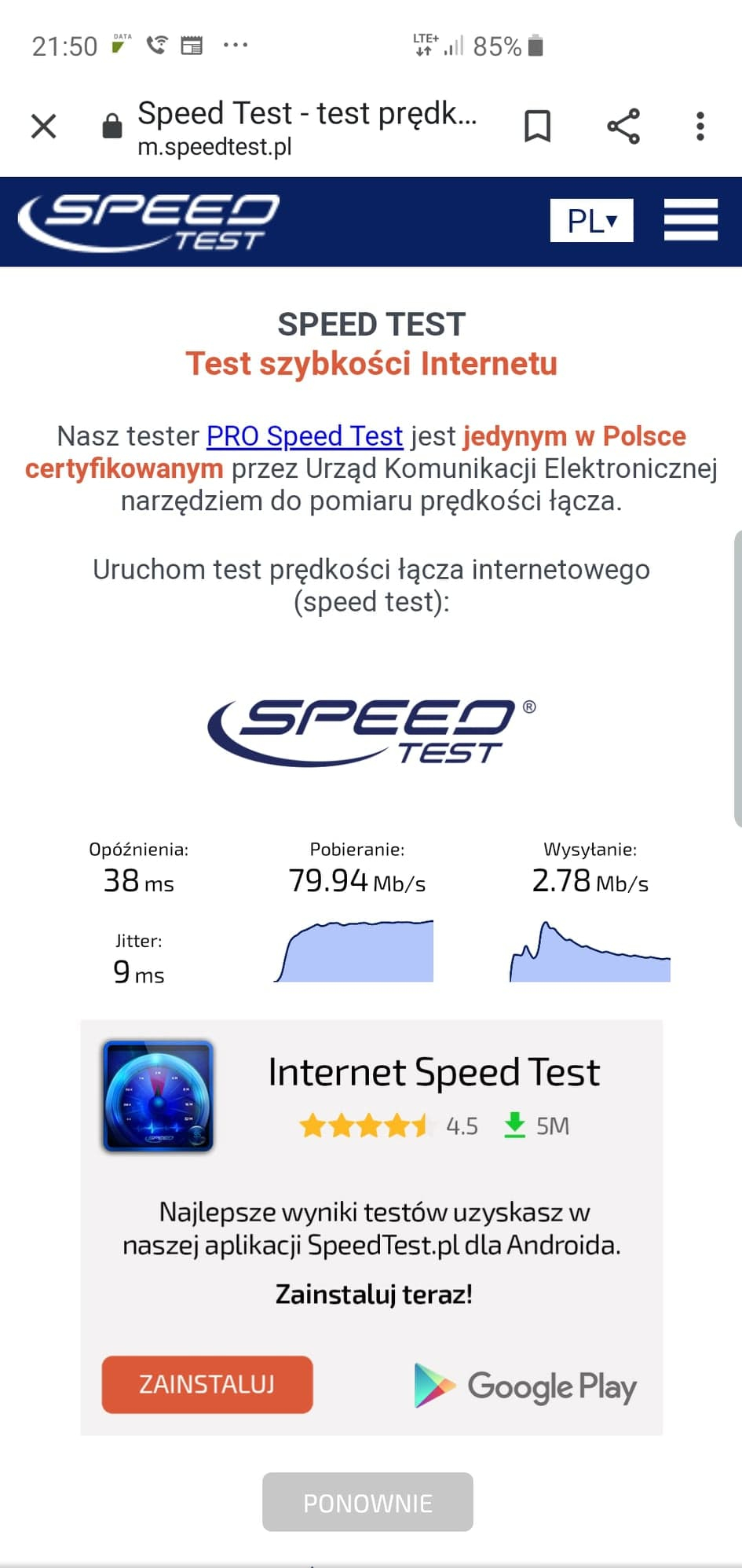

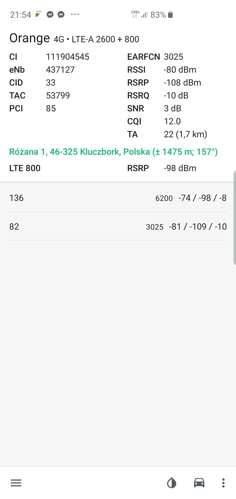

    I have conducted two tests:
    1. Telephone outside the window on the west side:
    Best Router for SIM Card: Improve Connection with Multiple Devices in 200sqm Home (LTE) Best Router for SIM Card: Improve Connection with Multiple Devices in 200sqm Home (LTE)
    2. I went out with the phone to the courtyard from the east side:

    And we are fully clear about LTE Orange in your location. It's not as bad as I thought. The NetWorks network in Kluczbork has potential, it also operates on LTE2600 and LTE800. LTE2600 Orange also works on the BTS at the Stobrawa hotel. The aggregation of LTE2600 + 800 + 1800 started, the signal was quite weak on them, LTE2600 as the basic LTE band. DL good speed and UL low due to weak signal. The second test is LTE2600 + 800 from the ECO chimney on Kołłątaja 8, LTE1800 on it as well, but it is not known if the signal on LTE2600 is quite weak and sufficient on LTE800. Cool speeds.
    To sum up, BTSs with 3 LTE bands and their aggregation, the signal is weak, so an external antenna will be needed. If you want to use aggregation LTE2600 + 1800 + 800, then a router with 3 CC CA B715, if with LTE2600 + 1800 or LTE2600 + 800, then a router with 2 CC CA, eg B525, B535. For this external antenna, its selection after changing the router and testing LTE bands on it. Choice between 2x ATK-504 operating in the 800-2600MHz range if you want to use aggregation of 3 LTE bands or two LTE2600 + 800 or Cybertech 17dBi 1800-2600MHz for LTE2600 + 1800 aggregation. B715 costs PLN 400-500, come from Play. B525 for PLN 250-300 for those from Play, Orange. Antenna 200 PLN for Cybertech, 2xATK-504 from Telkob, cost about 300 PLN.
