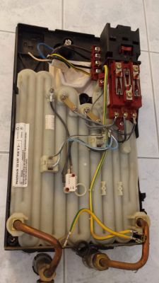

    I have a heater like the photo, it heats very poorly or rather at all, does something like that get fixed? In addition, it flows from it ... I should deal with it, but I do not know what about this heating, there is something that can be replaced on a good day? or at least check? Fix Poorly Heating Water Heater with Leakage - Repairs Needed on Possible Replaceable Components

    Meter in hand and check the heater resistance.

    If it's leaking into the bin, you probably won't buy spare parts for it - from the photo I conclude that this is Siemens DH, if I'm not mistaken, there are no spare parts, I fell in exactly the same way.

    I successfully lined up two heaters (admittedly single-phase).
    A small amount of water was left for the winter and scattered.
    Poxipol could easily be pasted.
    Unless it is leaking somewhere under the seals - then another matter.
