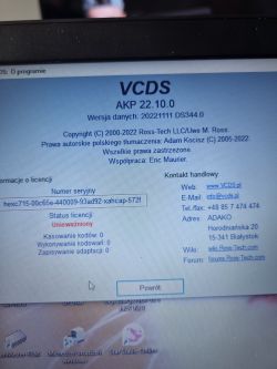

  • AliExpress cable shows unauthorized license status
    #13 20637544
    przemkohej
    Posts: 7
    Rate: 12

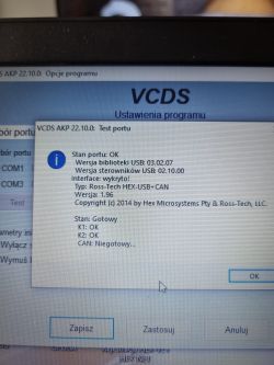

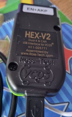

    I have the same problem
    Cable bought from AliExpress
    The installation was done according to the instructions and unfortunately the cable did not work
    Port test completed
    Port condition ok
    USB library version 03.02.07
    USB driver version 02.10.00
    Interface not detected
    VCDS Interface Not Detected: Solutions for Original Cable & USB Driver Issues
    License status UNAUTHORIZED

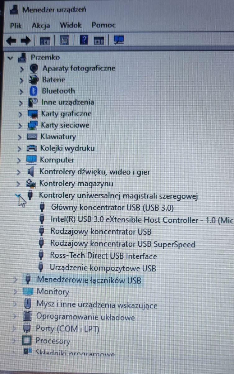

    Device manager
    Ross Tech Direct USB Interface (best drivers)
    The wire glows green
    Antivirus and internet turned off
    And the cable didn't work

    usb as com done? Searching?
  • #15 20637632
    przemkohej
    Posts: 7
    Rate: 12
    Now it is
    Yes test as com
    przemkohej wrote:
    Cable bought from aliexpress
    I don't think Aliexpress will join the official distribution of Ross Tech. How much did the interface cost?
    Wasn't it easier for you to buy locally?
