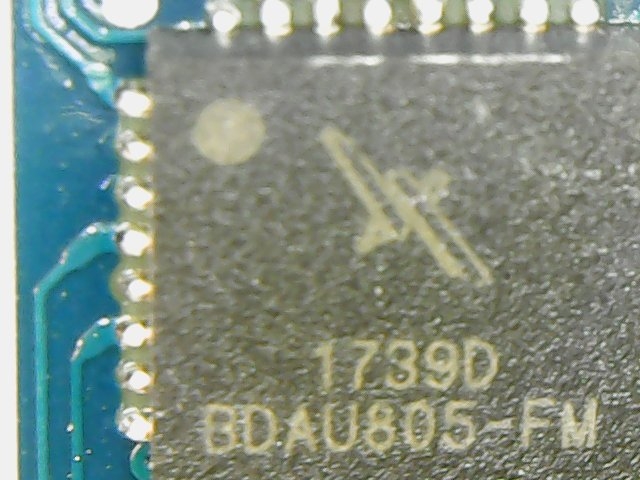

    For the curious, a photo of the main (and only) integrated circuit. Taken with a microscope presented by me quite recently, on our forum.
    Bluetooth 2.1 + EDR module for wireless headphones - TZT PCBA AUDIO - Test Bluetooth 2.1 + EDR module for wireless headphones - TZT PCBA AUDIO - Test Bluetooth 2.1 + EDR module for wireless headphones - TZT PCBA AUDIO - Test .

    So let's move on to the description that majfriend offers:
    Bluetooth on Base CLASS 2 power level, using Bluetooth 2.1 + EDR specification, compatible with Bluetooth 3 and below application version, transmission speed can reach 3 Mbit .
    I would like to add that the receiver/transmitter supports the A2DP standard. This means that we can listen to music from one source while connected to another. For example, you listen to music from your computer and are simultaneously connected to your phone. When a call comes in, you will hear the ringing tone in the headphones, and if you click the centre button to answer the incoming call, the music stops and you can hear the caller in the headphones. The module has a built-in microphone, so we will be able to start a conversation without any problems.
    Power amplifier output power: RMS 2x18 mw (THD = 10%) .
    I am left to believe that this is the case. Although, after the first test, I have no reason to doubt the veracity of this parameter.
    The signal-to-noise ratio is not less than 90dB .
    Here I don't know if there is an error or if the manufacturer/vendor has deliberately not given a specific value.
