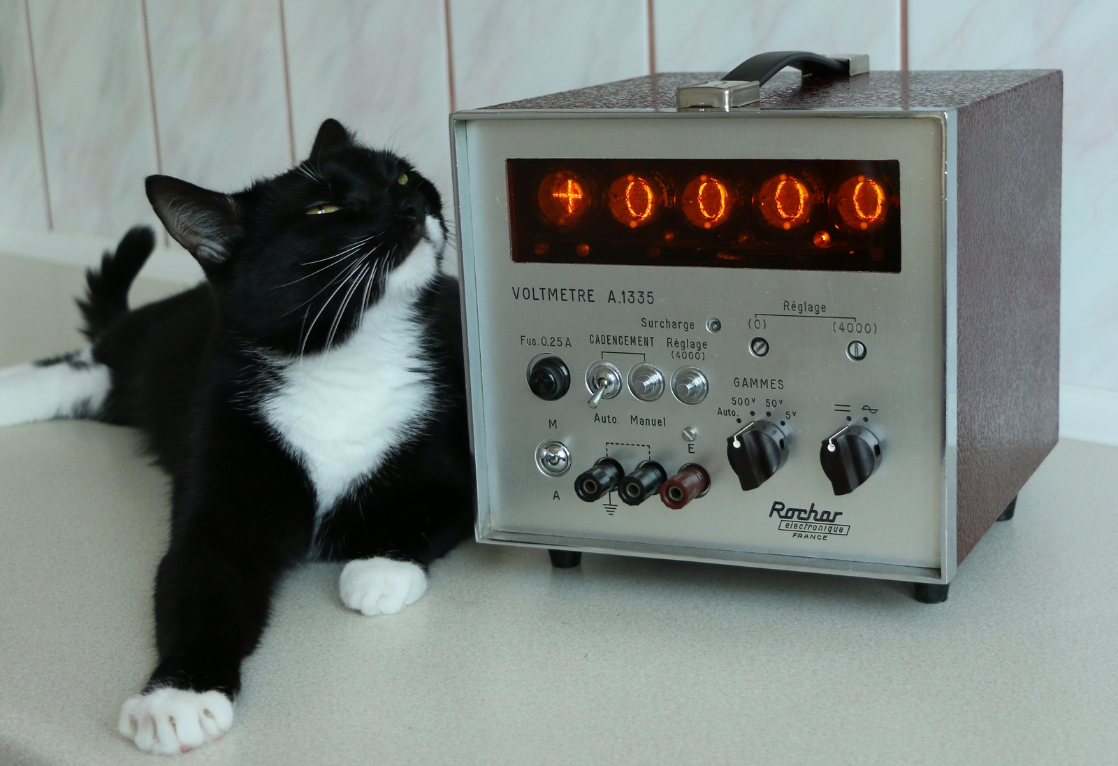

    Black and white cat next to vintage Rochar A.1335 voltmeter with NIXIE tubes

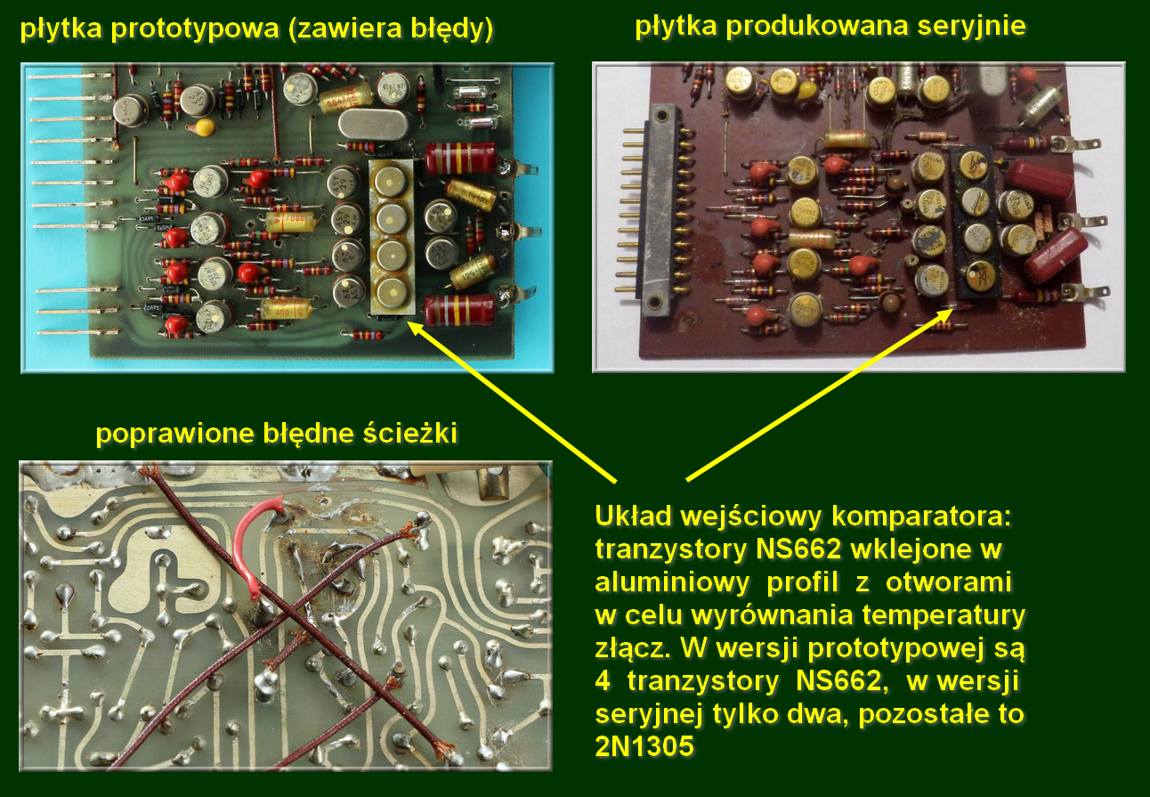

    The Rochar A.1335 voltmeter I received for repair is a prototype version, has no serial number and differs slightly from the devices later produced by Rochar. See the photo below for an example of the design differences:
    Comparison of prototype and production circuit boards of Rochar A.1335 voltmeter

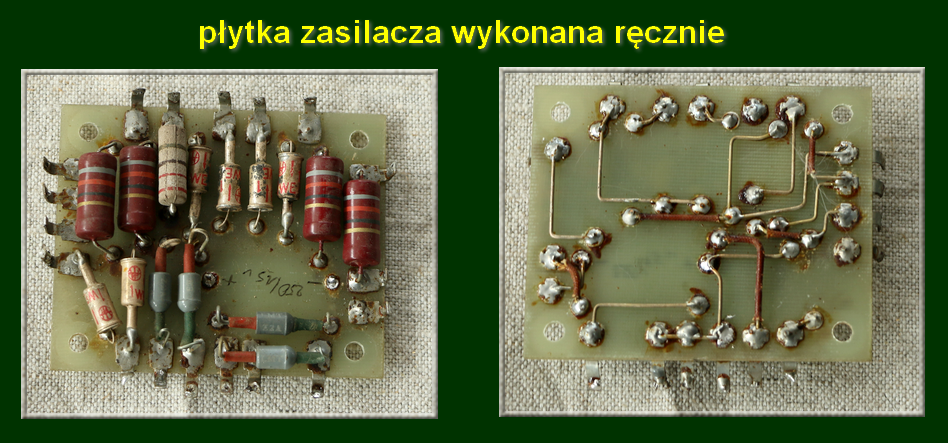

    In the device I repaired, some of the mounting plates are not printed circuits, and the components placed on them were connected by hand using silverplate. This is what the original power supply for the A.1335 voltmeter looked like:
    Handmade power supply board with resistors, capacitors, and soldered wires

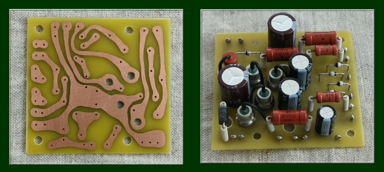

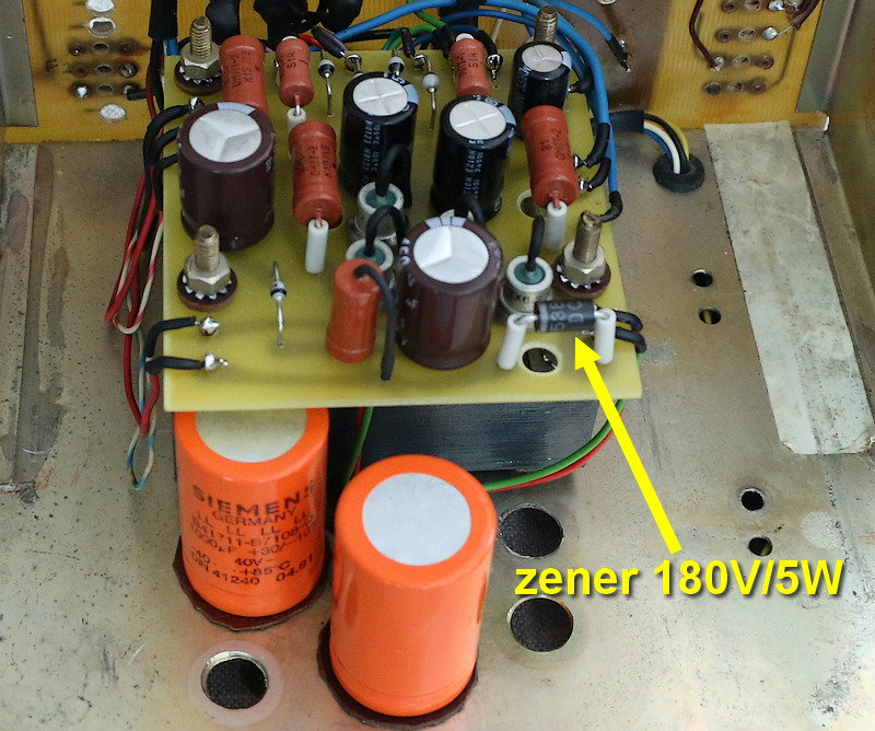

    I started the repair by removing the power supply board and electrolytic capacitors. Some of the components on the board seen in the photo above were damaged, so I did not dismantle them and left the whole board as an antique. For the device I made a new board according to the original schematic, 1960s technology.
    Two PCB boards: left unassembled, right assembled with capacitors and resistors

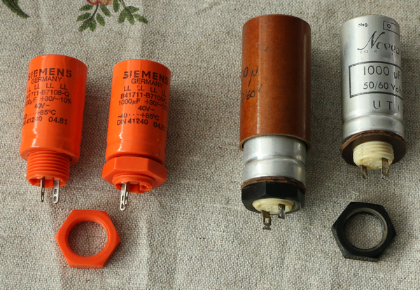

    The electrolytic capacitors were unfortunately dried out and needed replacing. Some were moved from the chassis to the board and replaced with working good quality ones. Two large capacitors were replaced with vintage Siemens and bolted to the chassis (they still have excellent performance and they look nice)
    Four electrolytic capacitors including two Siemens units placed on fabric

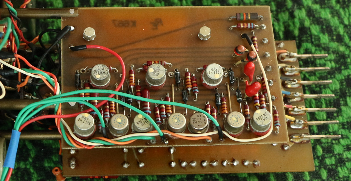

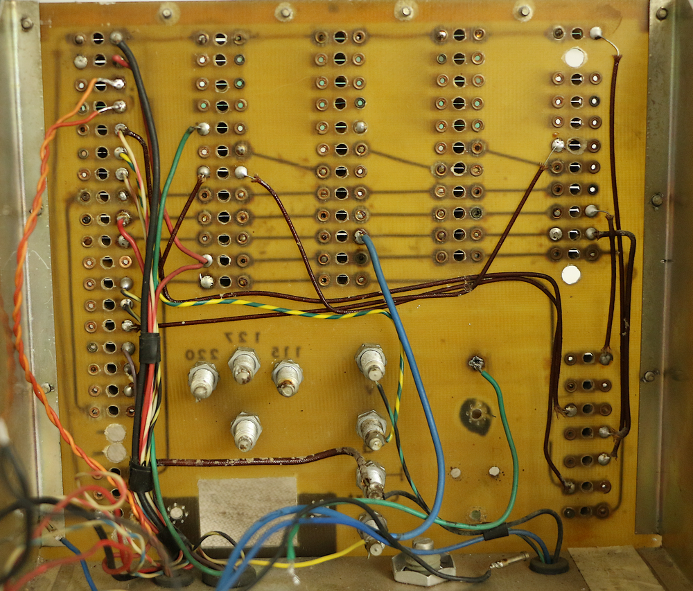

    I also had to sort out the wires. Some had damaged insulation and needed replacing, others were broken off. Some paths were cut and the connections changed with wires, other paths are not there at all, just a crossover of wires. Fortunately I have a schematic (it's attached) and I was able to compare the unit I have to this schematic. This schematic shows the mass-produced version from 1965 onwards, with corrections made in 1967. This is the original scan, poor, but I don't have a better one.
    Back of a prototype circuit board with manual wiring and screw terminals

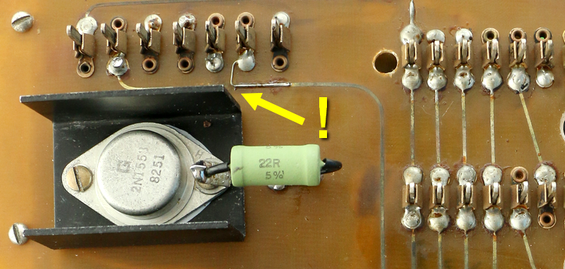

    I was already able to fit the transformer and power supply board. The power supply still needed to replace the 2N555 germanium transistor that stabilises the -12V voltage. I replaced it with a much stronger 2N1558 transistor and added a new resistor (the original one was burnt out).
    Close-up of circuit board with 2N1558 transistor and 22 ohm resistor, arrow shows repaired connection
    The power supply is ready, it passed the load test, there are correct voltages on all connectors, it's good!
    Power supply board of restored Rochar A.1335 voltmeter with replaced components and Zener diode

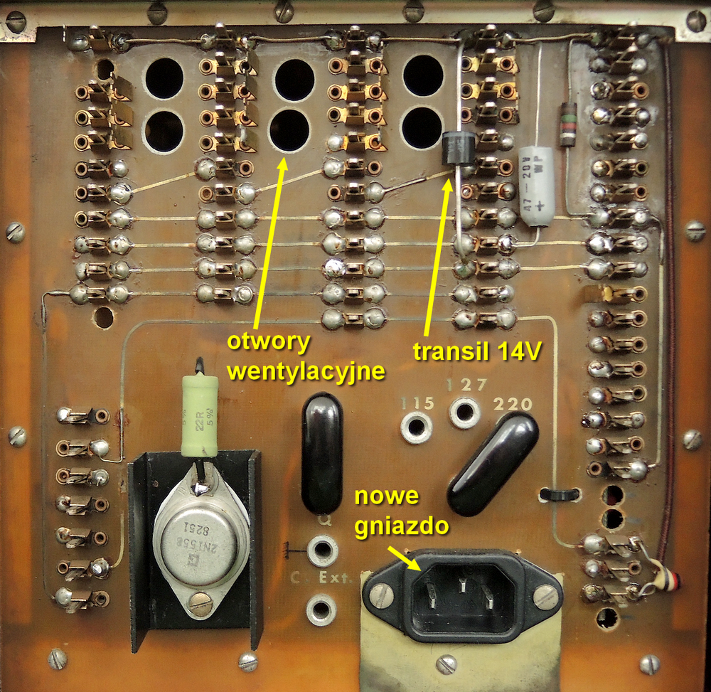

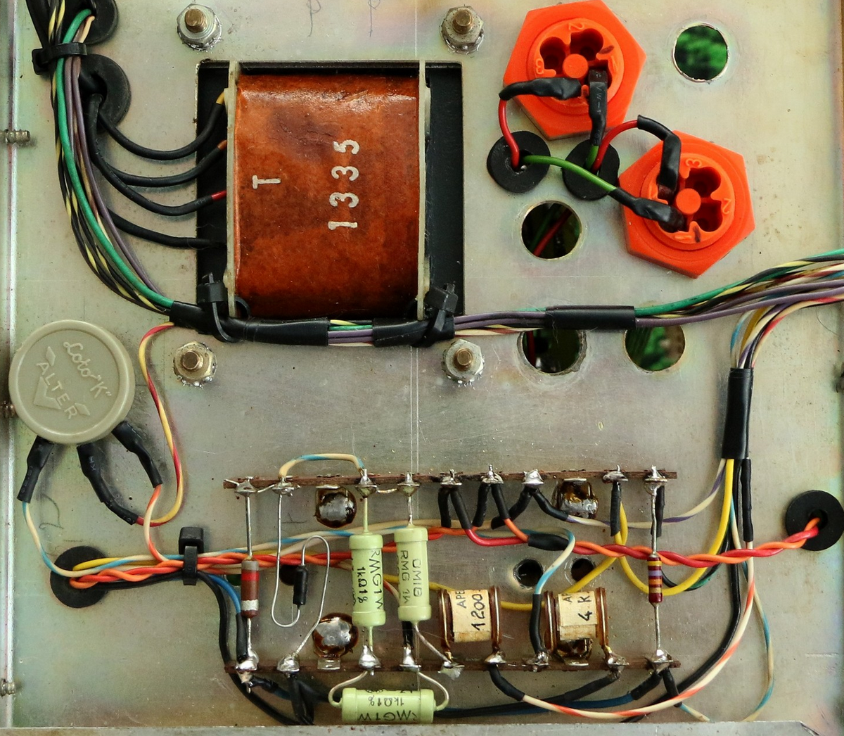

    Note: I added a resistor and a Zener diode to the power supply to limit the supply voltage to the NIXIE tubes to 180V. This is a little low, but the tubes work OK. In this voltmeter the digits in the tubes are controlled by old 2N1990 transistors, for which the catalogue Uce is only 60V. The LC531 tube ignition voltage is about 160V, while the quench voltage is above 110V. The difference of Uce=60V when the transistor is open and plugged is sufficient to ensure proper lamp operation. However, if the mains voltage went up (which happens, due to the photovoltaics), without stabilisation the NIXIE supply voltage would increase and the inactive digits might not go out properly. I also added a 14V transil in the -12V path to protect the modules in case of a power supply failure (there are very old 2N1305 germanium transistors in the modules) I also replaced the power supply socket and made ventilation holes so that the counter modules would not overheat.
    Interior of Rochar A.1335 voltmeter showing power board with labeled modifications
    Note: I run vintage devices through autotransformers that reduce 240V AC to 220V (that's the voltage I have in the mains, 238V with jumps to 246V). Some old appliances designed for 220V cannot handle 240V. While I have never had an electrolytic capacitor explode, it is common for series power supplies to overheat and even for the transformer core to saturate when the mains exceeds 245V (blowing a fuse). I used to think of making a separate 220V AC mains in one room, with Schuko plugs without a grounding pin hole, so as not to confuse it with the 240V mains.

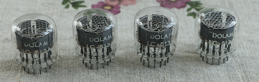

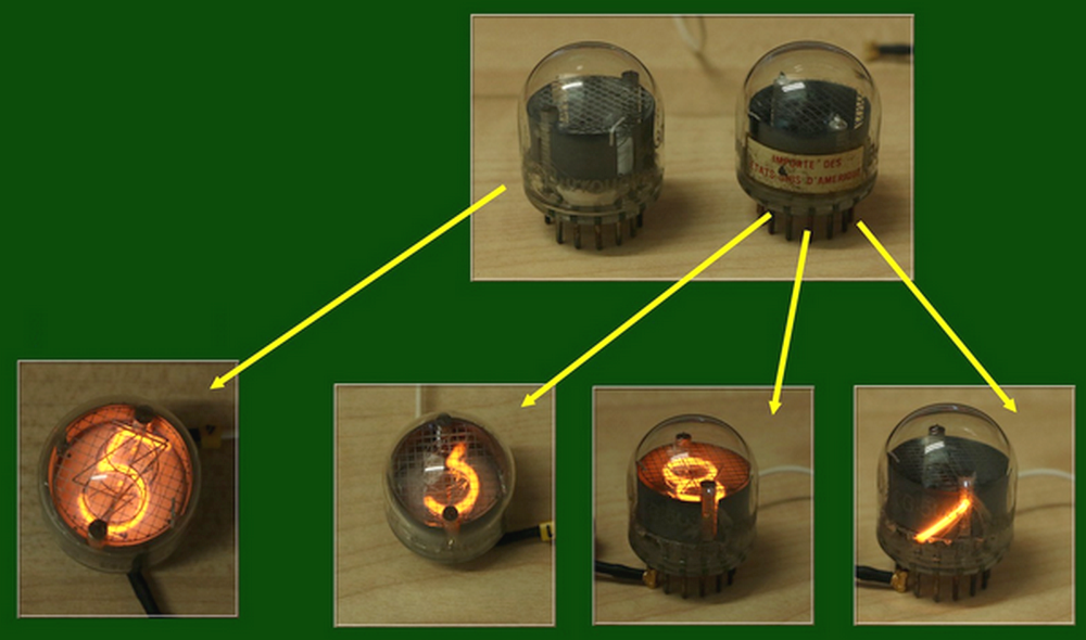

    Another item - NIXIE lamps. The original American Burroughs B5031 were fitted to this unit (later serial models had French CSF F9057 lamps manufactured from 1963 onwards). Unfortunately in my voltmeter the tubes were damaged (some digits burnt out).
    Close-ups of NIXIE tubes displaying digits 5, 3, 9 and 7, with three Burroughs tube types
    Fortunately the Polish LC513 tubes fit perfectly:
    Four DOLAM LC-513 nixie tubes arranged side by side on a fabric background.
    Comparator: Already at first glance it needed repair, or rather tidying up of some components. Due to the fact that this is a prototype version some paths were cut and components were placed in newly drilled holes and connected by wires. It looked like a nightmare, but I managed to embrace it. There was another problem - some of the contact pins were falling out of the boards. All contacts to be removed and reassembled: (the serial version of this voltmeter has good gold-plated pins and sockets)

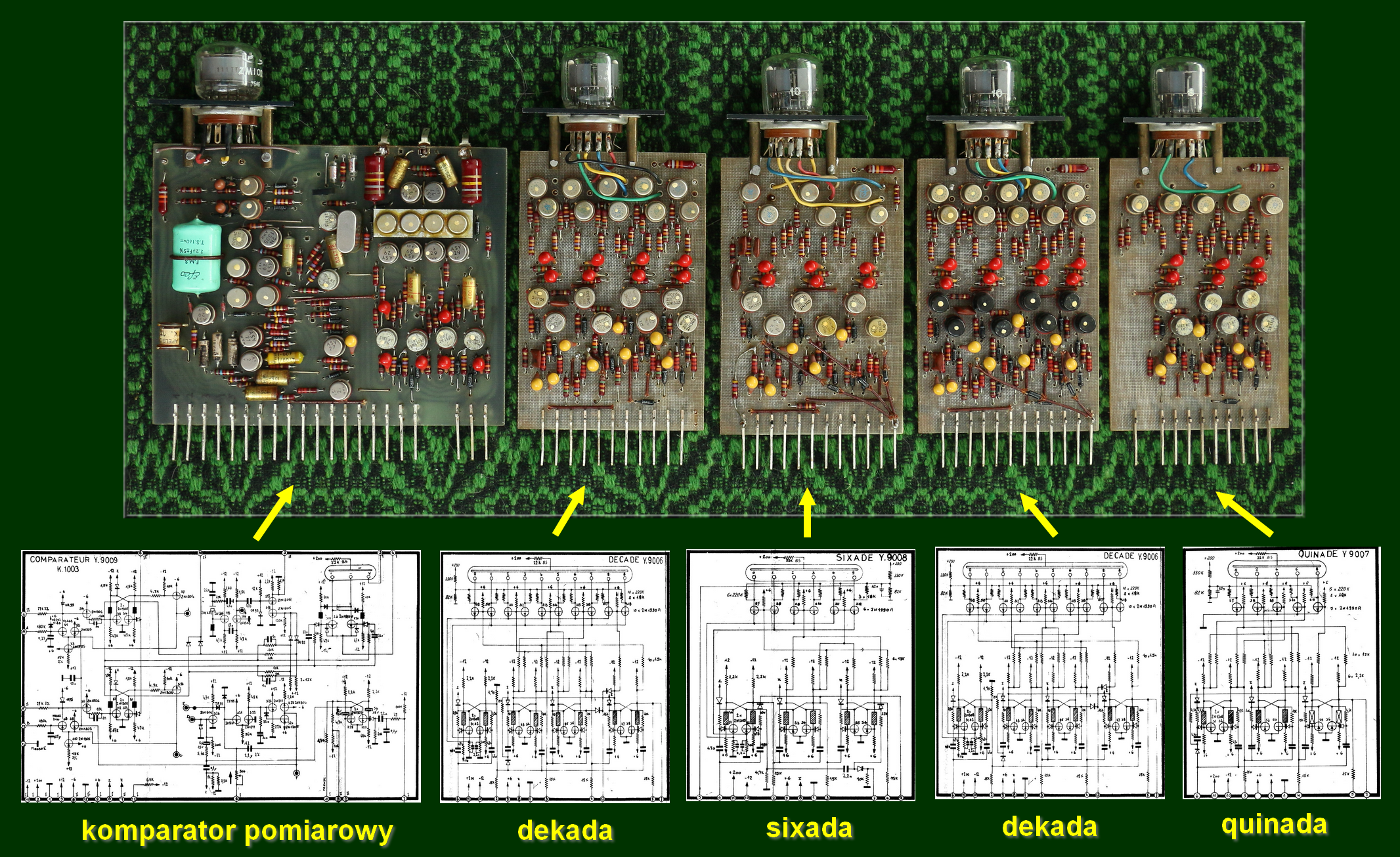

    Dividers: The voltmeter contains 4 transistor dividers. These dividers are not prototypes, they have been manufactured by Rochar before for fuel flow meters and later for frequency meters, so there is no mess with cut paths. The only thing that has been added are the leads for the automatic range switching signal (additional diodes).

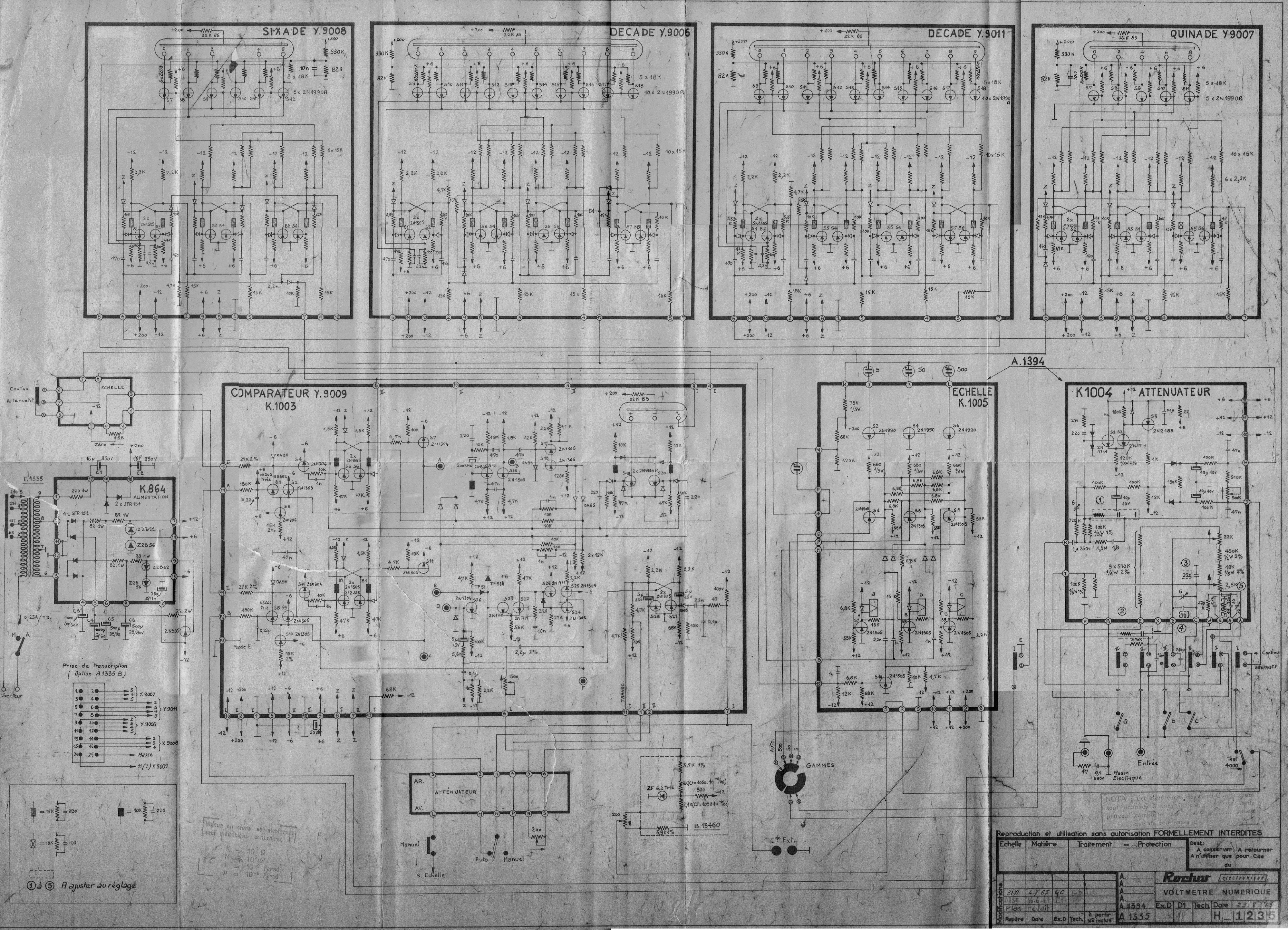

    Counting from the input side of the 200 kHz signal, the first divider divides by 5, the next two by 10 and the last by 6. So the largest displayed value can be 5998 (the last digit of the result can only be even). Apparently Charbonnier decided that the accuracy of the A.1335 measurement was so low that it was not worth fitting a full decade (transistors were very expensive in those years, especially the 'high voltage' ones at 60V).
    Five vintage circuit modules from the 1960s with matching schematics labeled below

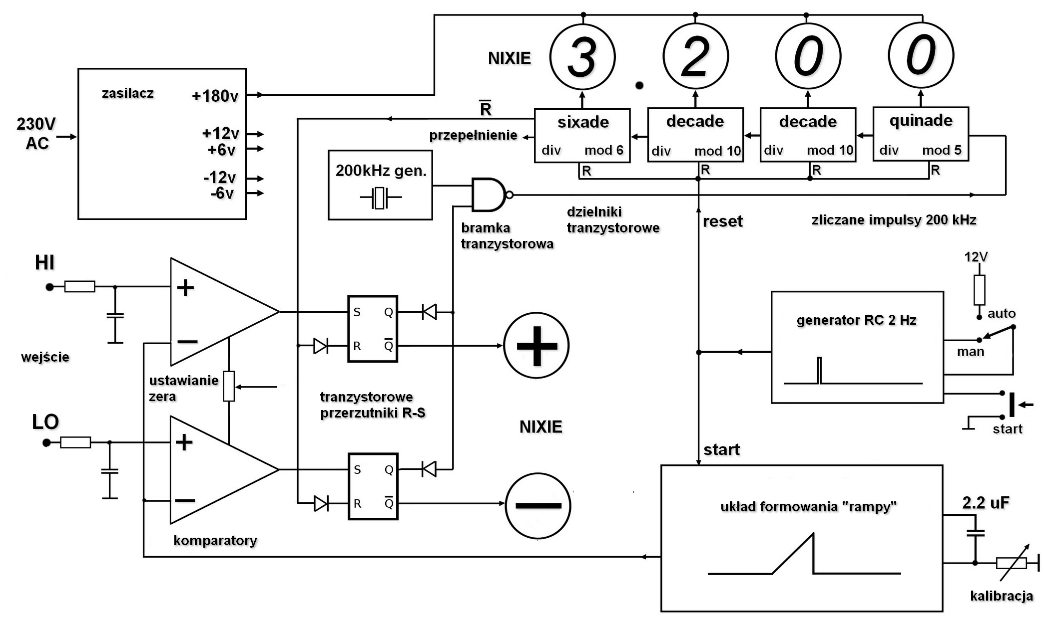

    Random digits are displayed, the instrument does not measure voltage. To fix this monument let's look at the principle of its operation: This voltmeter has no integrator (the Solartron LM1420 already had an integrator). The A.1335 has a pulse-timing circuit. Simplified block diagram with range change automation omitted:
    Block diagram of Rochar A.1335 digital voltmeter using NIXIE tube displays.

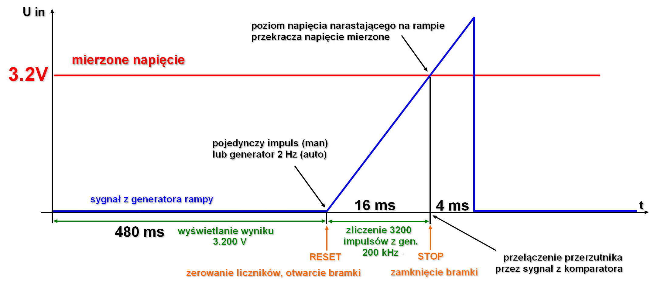

    Operating principle:
    Ramp-based voltage measurement diagram for the Rochar A.1335 digital voltmeter
    The measuring system can be triggered manually with a push button (one measurement) or automatically from a 2 Hz generator. Immediately after triggering, the counters are reset and the flip-flop opens the gate and pulses from the 200 kHz quartz generator are applied to the counters, which count them by flashing for a while (no latch). At the same time, the 'ramp' formation circuit is activated, which feeds a linearly rising voltage to the comparator depending on the time constant of the RC circuit with a 2.2 uF capacitor. When the "ramp" voltage exceeds the measured voltage, the comparator switches the flip-flop, which closes the gate and the displays show the measured result. Another cycle can be started by pressing a button, or the automaton will repeat the measurement every half second. Seemingly simple, but building this without digital integrated circuits, on old germanium transistors is a masterpiece.

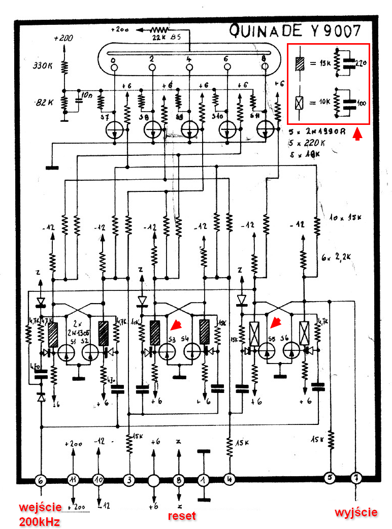

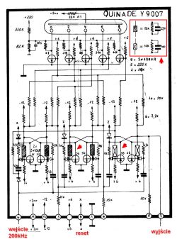

    The 200 kHz quartz generator works, the gate opens, but the first quinada does not count correctly! (quinada is a word invented by Charbonnier, he liked to create his own words to name his circuits, sometimes he also created his own symbols). Let's look at the schematic of this divider: Three flip-flops configured to divide by 5 and a simple driver on 5 transistors.
    Circuit diagram of QUINADE Y9007 pulse divider with component labels
    What's broken: a faulty (open) diode at the collector of transistor S1 prevents the reset signal from being applied! Replacement of the diode and it is OK.

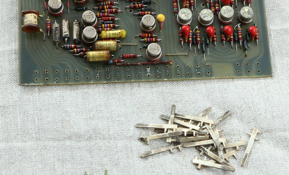

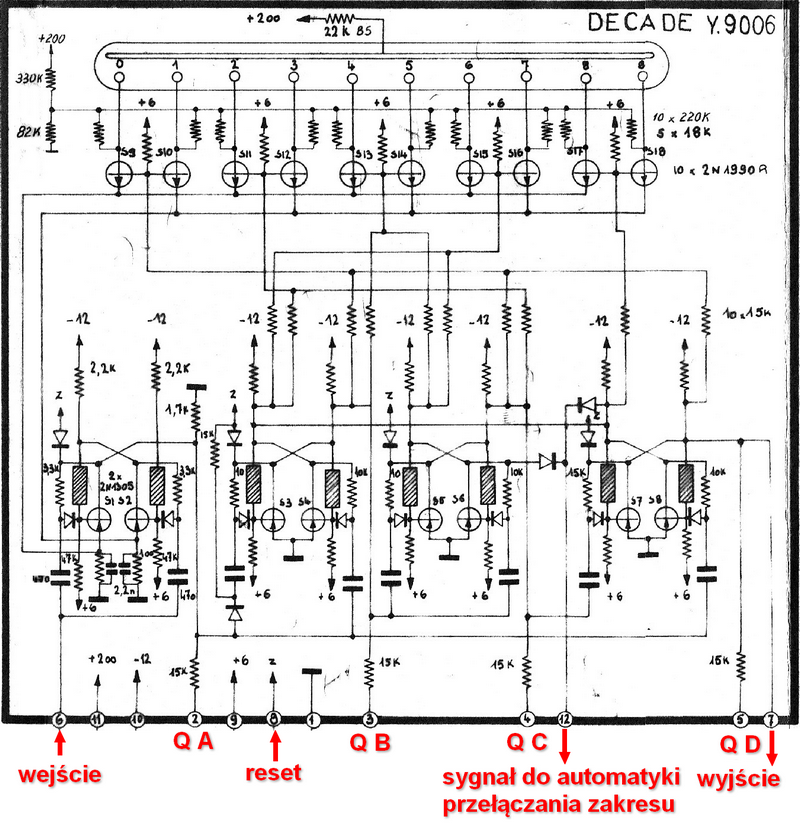

    But not quite, the second module, the decade, is also broken. This module contains 4 flip-flops. The first one divides by 2, the next three are configured to divide by 5. Just like the well-known 7490 counter. The first flip-flop has another function: by alternating the polarity of the emitters, it controls a transistor decoder displaying alternating even and odd digits, thus correctly selecting one of the 10 digits (the quinada does not have this decoder, the emitters of the transistors controlling the NIXIE tubes are shorted to ground).
    Diagram of Y.9006 decade counter with labels for inputs, outputs, and control signals
    The diode feeding the signal to the range automation control was faulty, it was shorted and the decade display was wrong and dividing incorrectly. After replacing the diode the meter started up correctly, the voltmeter displayed a stable result!

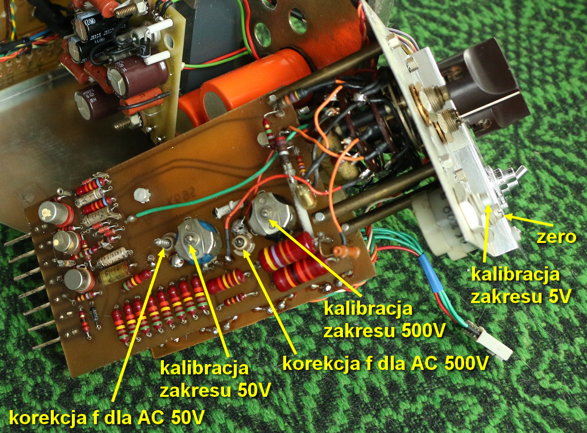

    Unfortunately, the voltmeter repaired in this way only worked on one range. The other ranges did not work, so I had to deal with the range-switching circuitry. The A1335 ranges can be switched manually, or the automatic can be switched on. The automatic did not work, manual switching only activated one range. In addition, the equipment measured badly, although the result was stable.
    Here is the range switch board with a description of the control elements: (the white connector visible in the photo is not original, I inserted it for ease of board removal)
    Calibration board of Rochar A.1335 voltmeter with labeled potentiometers and electronic parts
    and this is the automation board:

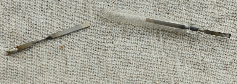

    I checked the components on the boards, they were OK. However, there are 4 large reed relays between the boards (not visible in the photo). The reed switch in one of them was broken:
    Broken glass reed relay lying on woven fabric background

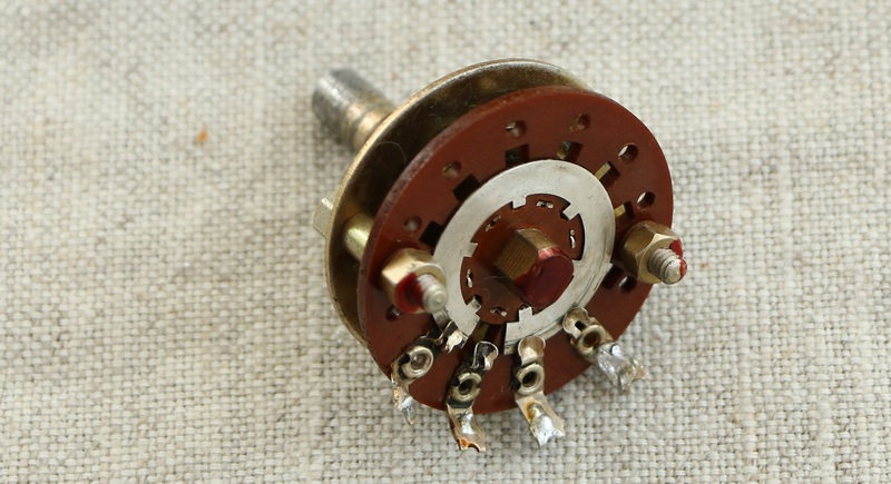

    In addition, the rotary switches, which nobody had used for more than 30 years, needed cleaning.
    Close-up of a vintage rotary switch with soldered wire terminals
    After replacing the reed switch and cleaning the switches, the voltmeter started up on all ranges, but the readings were not correct. On the underside of the unit there is a voltage reference - a 6.2V reference diode (small black element) and resistors, including two precision resistors. A couple of resistors were faulty, fortunately the precision 1200 Ω and 4 kΩ resistors are OK. I replaced the resistors with Polish RMGs. I still had to glue the calibration voltage setting potentiometer visible in the photo, because the lid fell off.

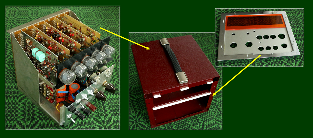

    All that remains is the refurbishment of the housing. Cleaning of rust, painting, pasting of plexi etc. It was very difficult to keep the original colour, custom mixed paint. But I will not describe it here.
    Three parts of Rochar A.1335 voltmeter: internal module, casing, and front panel

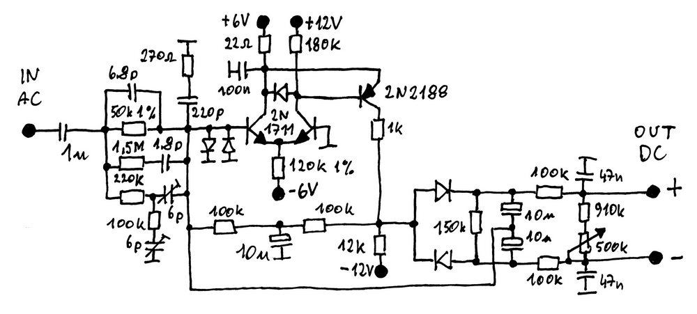

    And the alternating voltage? Here it is no longer simple, nor so beautiful. Where to get an AC voltage standard from? I don't have an AC calibrator, the HP3325A broke down (when I fix it, I'll make another measurement), so I used an Adret 2230A generator, which used to be used to test telephone lines. This generator was once even calibrated, so maybe it won't be too bad. I loaded the 75 Ω output with two 150 Ω resistors connected in parallel. For voltage monitoring, I attached a Solartron 7140 voltmeter.
    The Rochar A.1335 measures reasonably correctly up to 10 kHz. Measurement on the second video, 4 signal levels: +12dBm, +10dBm, 0dBm, -10dBm for frequencies 100Hz, 1kHz, 10kHz, 100kHz. Admittedly, above 10kHz the result is inaccurate, but for a vintage design it is fine. Another monument saved!

  • Cathode poisoning can be reversed by overdriving digits

    Sensational work, I'm really impressed with both the end result and the knowledge to understand how the instrument works and to diagnose and fix all the faults. It's good that such a unique gauge ended up in the hands of someone who gave it a second life, rather than someone who would treat it as a source of nixie tubes for their next watch....
    As for the original lamps - they may be salvageable. "Burning out" of the digits is probably what is known as cathode poisoning, often found in displays that showed certain digits much more often than others. A layer of material vaporised from the more frequently used ones is then deposited on the less frequently used ones, which disrupts the current flow on the 'soiled' cathode and is visible as dark spots or non-luminous segments. This condition can in many cases be reversed by feeding the lamp through a power supply with a regulated output voltage and selecting the voltage in such a way that the poisoned parts of the digit (or at least as many of them as possible) begin to glow; at the same time, the digit current should not exceed about three times the rated current. After a few hours or so of such "chewing", the dark fragments should begin to glow, then the procedure is repeated for the next digit, and so on. I managed to save a few LC-531s and IN-12s this way, perhaps my colleague's tubes would also react well to such a "treatment".

    Actually, in one lamp the odd digits are "poisoned" - this lamp was working in a quinade that only displayed the even digits. When I find time, I'll try to carry out an activation of these digits, maybe the original Burroughs will still light up.
    Personally, I think that putting NIXIEs in watches is a waste of vintage lamps, while activating the practice of destroying vintage devices. Some time ago I took in such a frequency meter:

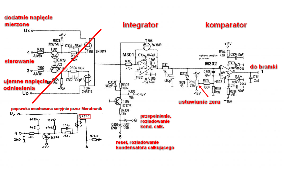

    The ICL7106 operates on a different principle - double integration. In the RocharA.1335 voltmeter, the input voltage is compared with the voltage from the ramp generator (this is a timed circuit, less accurate), while in the ICL7106 the measured voltage is applied to the integrator and integrated over a fixed period of time, measured by the control circuit (during this time the integrator capacitor is charged in proportion to the measured voltage). After this period, a voltage of reverse polarity from the reference voltage standard is applied to the integrator input and a second integration (capacitor discharge) takes place. During the discharge of the capacitor, pulses are counted which, after discharge, will be stored in the latch and displayed as the result. A higher input voltage will build up more charge in the integrator capacitor, so the discharge time will be longer and more pulses will be counted. This is very abbreviated, but this is how most modern digital voltmeters work.
    Analysing the ICL7106 you won't notice this because it's a ready-made 'cube'. To understand double integration I recommend looking at the simple voltmeter that is built into the Meratronik E317. (schematics below)
    Circuit diagram of integrator and comparator with labeled measurement stages.
    Schematic diagram of integrating digital voltmeter with labeled sections and functions.
    A negative reference voltage is applied to the Uo input, a positive measured signal is applied to the Ux input. These signals are switched by a timing circuit using keys on J-FET transistors and integrated in an integrator made up of an operational amplifier uA741, a 470 kΩ resistor and a 470 nF capacitor. The signal from the integrator is compared by the comparator uA710 with the 'zero' determined by a potentiometer and applied to gate B1.
    Let's follow the measurement cycle: after start-up, a reset is performed (C201, R202), the integrator capacitor is discharged by T306, the Q outputs of both metering switches P1 and P2 are low, gate B1 blocks the signal from the comparator. The non-Q output of the P1 flip-flop is in high state and opens the T303 key feeding the measured voltage Ux to the integrator. The 7490 counters count the pulses from the generator timing the charge, the integrator capacitor charges. When the number of pulses exceeds 999, the flip-flop P1 will change state and switch keys by applying a negative voltage from the reference to the integrator, and at the same time open gate B1 for the signal from the uA710 comparator. From this point, the capacitor discharges and the counters count the pulses from the generator again until the reference voltage discharges the capacitor. When the voltage at the output of the integrator drops below the "zero" set by potentiometer R316, the comparator gives a signal through the open gate B1 and triggers the flip-flop P2, which causes the state of counters 7490 to be written to latch 7475 and the result to be displayed via decoders 7447. A moment later (R206, C204) a timer is triggered which resets the circuit and, after the time set by R207, C205 has elapsed, another measurement cycle will begin. There is also an 8-input gate 7430 that will stop the generator if the counters exceed 999 due to too high a charge in the capacitor, accumulated when the input voltage Ux exceeds the reference voltage.
    That's it in a nutshell. If anyone wants to play with an integrating voltmeter and understand the principle of its operation, I recommend trying this circuit. I recently converted this circuit to CMOS for fun and added "half digits", it works perfectly, description at the link:

  • Half-scale display on the Rochar A.1335 meter
    #14 21761319
    OTLamp
    Tube devices specialist
    Posts: 2351
    Help: 335
    Rate: 518
    kris8888 wrote:
    I'm guessing that in addition to vintage receivers you must have started collecting old measuring equipment...

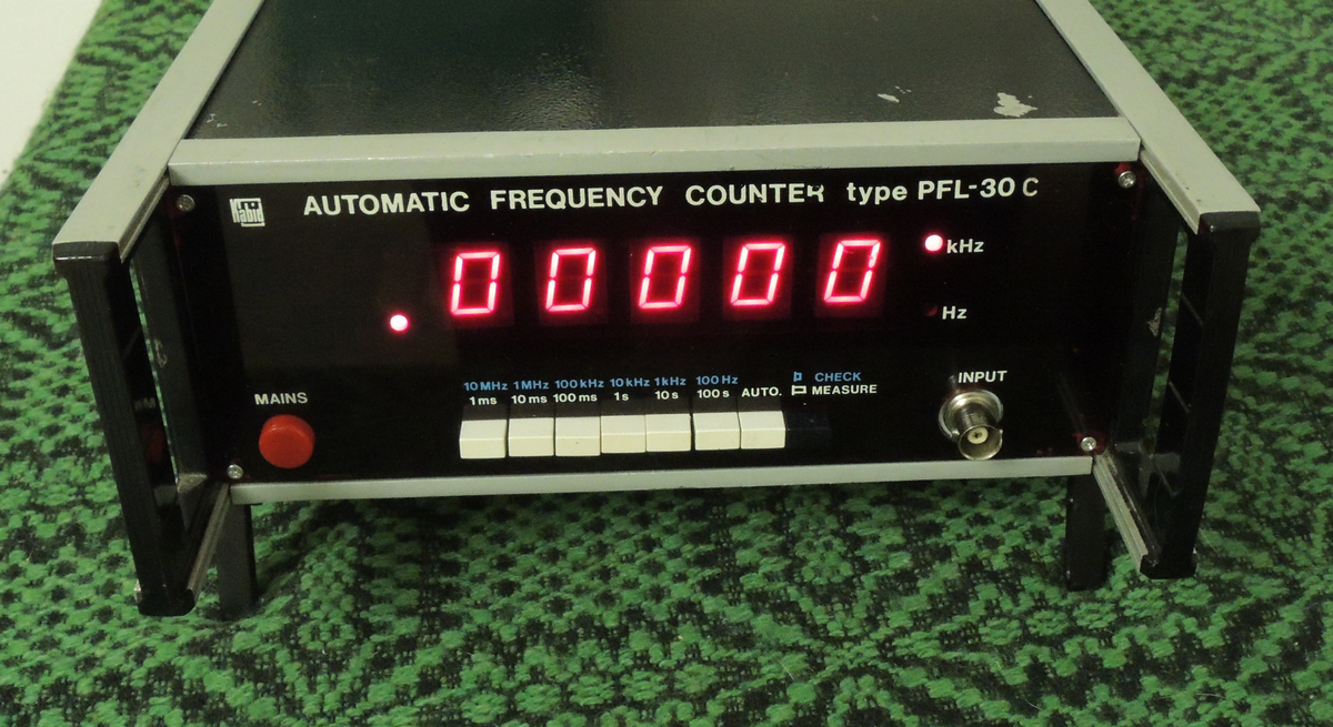

    In fact, for about a dozen years now. But only digital and as old as possible. Unfortunately those from the 1950s are both very rare and very expensive. When some NLS comes out once every few years, you have to shell out a minimum of 500 bucks. That's why I only have 2 in my collection for now :(
    For that, the title one is probably the first one I've ever seen that displays half of the possible meter readings.

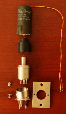

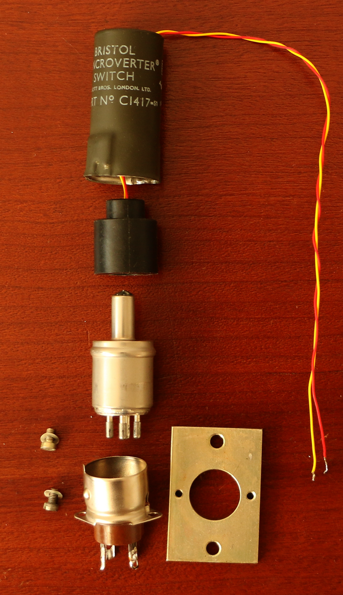

  • Hermetic selector worn out, J-FET replacement planned
    #15 21761372
    sq2aki
    Posts: 31
    Rate: 163
    OTLamp wrote:
    It is interesting to note that in the late 1950s, when it was already known that electromechanical decoders were a dead end, NLS continued to develop this.
    Can such a hermetic electromechanical selector even be repaired?
    Disassembled Bristol Microverter electromechanical switch on wooden surface
    It works, or rather it worked in a Marconi TF2603 voltmeter. It was switching the signal from an HF probe fed to a chopper type amplifier at 80 Hz. Catalogued it had a minimum of 1,000 h of operation, but it seems to have worn out by now and needs to be replaced with something. Commonly available relays (even reed relays) don't work, the voltmeter measures wrong.
    If it can't be fixed, I'll try replacing it with J-FET transistors.

    @sq2aki It's not so much a selector as a vibrator. There used to be such instead of transistor keys in power supplies for mobile tube devices e.g. car receivers or military radios.
  • Chopper identified and replacement suggested
    #17 21761393
    OTLamp
    Posts: 2351
    Help: 335
    Rate: 518
    sq2aki wrote:
    Can such an airtight electromechanical selector be repaired at all?
    This is not a selector. You have the selector in one of the videos above. It takes the form of a rotary switch with a ratchet mechanism driven by an electromagnet.
    Your component, on the other hand, is a chopper, and it is from this component that the name "chopper amplifier" is taken for a shorter term for amplifiers with processing. I don't know to what extent it is possible to repair these components, I have never taken them apart. However, this is not an ordinary car converter vibrator. Choppers are designed specifically for switching very small signals, where even thermoelectric voltages can make a difference. The contacts are therefore not made of the finest materials, they are rated for millions of switching operations, the switching current is unimportant, but the "quality" of the contact is of paramount importance, and the entire component is appropriately shielded. However, they can be found on various portals for a few to several dollars/euro. A substitute can be selected.

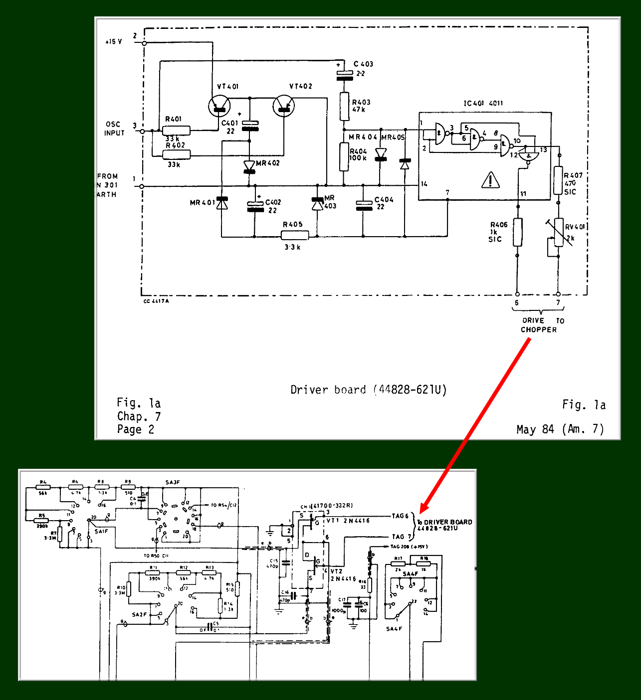

  • J-FET chopper replacement for mechanical syncroverter
    #22 21761636
    sq2aki
    Posts: 31
    Rate: 163
    OTLamp wrote:
    You can select some kind of replacement.
    I have found a solution, or rather the Marconi company has solved the problem of the lack of mechanical choppers. In the 1984 service manual there is this addition:
    Renovation of the historic Rochar A.1335 digital voltmeter
    Chopper on J-FET transistors controlled by a driver on a CD4011 inserted instead of a mechanical "syncroverter". Need to try this solution and revive the old voltmeter when there is some spare time...
    Regards, M.S.
  • Optocouplers suggested instead of J-FET switches
    #23 21761693
    kris8888
    Posts: 7080
    Help: 537
    Rate: 1929
    J-FET transistors can have a significant gate-to-source leakage current, which can make a difference when switching and measuring such low voltages. They should therefore be very carefully selected for minimal IGSS.
    Hence my suggestion, and not only my suggestion as there are such chopper amplifier solutions, to use suitably controlled photodiodes or phototransistors (optocouplers) as switching elements.
  • Marconi chopper circuit with matched J112 FETs
    #24 21761742
    sq2aki
    Posts: 31
    Rate: 163
    kris8888 wrote:
    meaning gate-to-source leakage current
    Of course it matters, but rather in picoamperes. E.g. selecting an FET for a Keithley 614 is not easy. And the Marconi voltmeter measures very small voltages, the lowest range is 1 mV, so a photodiode or phototransistor in the optocoupler is out, at most photo resistors. I have seen such a chopper with photo resistors illuminated by neon tubes fed from different halves of a 50 Hz sine wave. However, I will initially try the circuit published by Marconi with matched J112 type FETs that are adapted to the choppers (I don't have the original 2N4416).

    This voltmeter has a very simple AC/DC converter:
    Hand-drawn AC/DC converter schematic with 2N2188 transistor and diodes
    The circuit works reasonably well up to 50 kHz. And this is data from the Rochar catalogue:
    Catalog page of Rochar A.1335 voltmeter with specifications in French and English
    The catalogue data for the DC range is correct, but for AC a little inaccurate. For 200 kHz we have a result overestimated by more than 2%, while in the catalogue it is only 1%. However, it must be remembered that this device is more than 60 years old and still works....

How does the A.1335 actually measure voltage?
It counts 200 kHz clock pulses while a linear ramp climbs until it exceeds the input voltage. A comparator stops the gate, and the counters show the result. There is no integrator or latch; displays flash during counting. "Seemingly simple…a masterpiece" without ICs. [Elektroda, sq2aki, post #21759194]
Why does the display top out at 5998 and why are last digits even?
The chain is /5, /10, /10, /6. That makes the top reading 5998, and the final division by two yields only even least‑significant digits. Charbonnier optimized parts count when high‑voltage transistors were expensive. [Elektroda, sq2aki, post #21759194]
