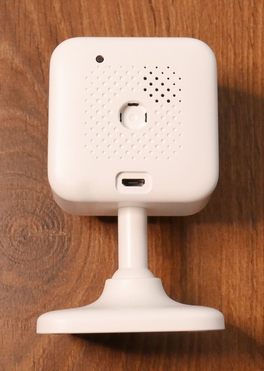

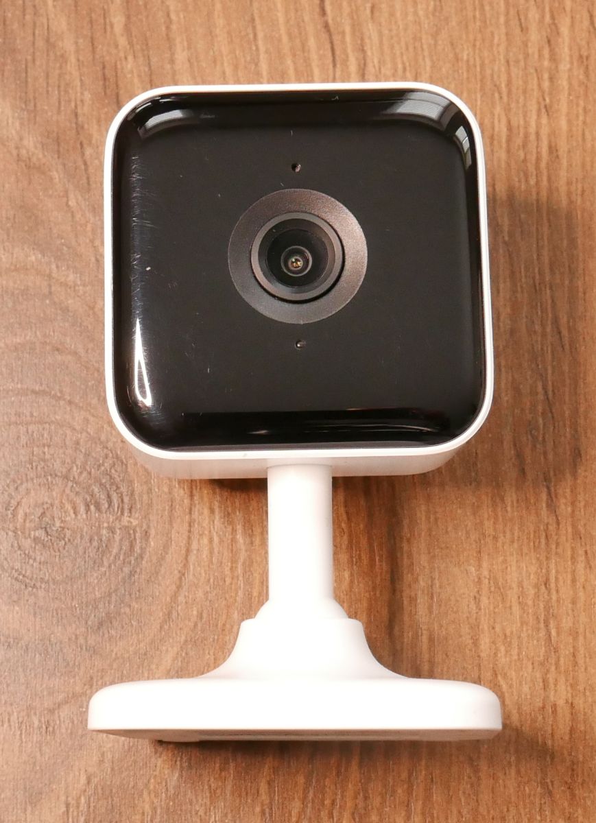

  • Front view of GNCC GC2 camera on a white base, lens centered on glossy black face. Back of white GNCC GC2 camera with visible speaker and micro USB port
    This time a description of the GNCC GC2 camera. The camera version on the ak3918ev300 chip is not supported by either Thingino or OpenIPC. In order to run RTSP streaming, I had to use the manufacturer's SDK and write my own software. While there is an example with RTSP, it does not have iris and IR LED control, nor does it have an OSD. In addition, I had to add button support. The only thing I didn't get right was the microphone. The camera can now be configured and used without the app. The software that works with the app I knocked out.

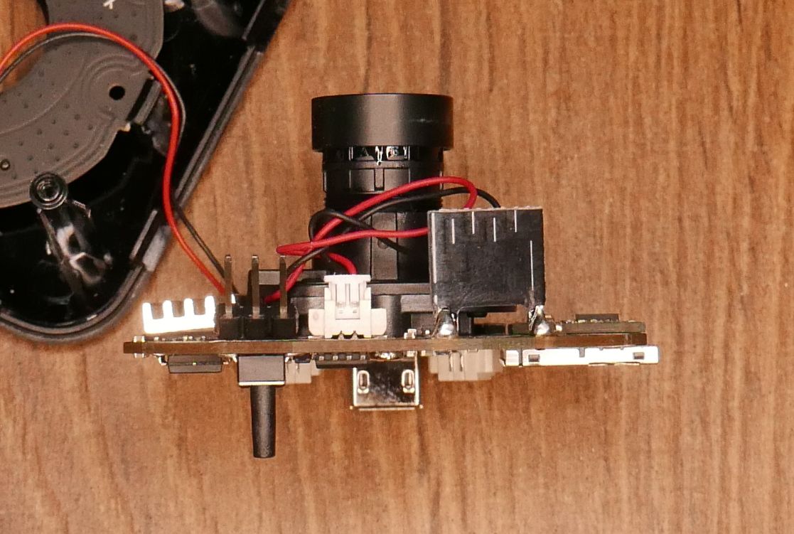

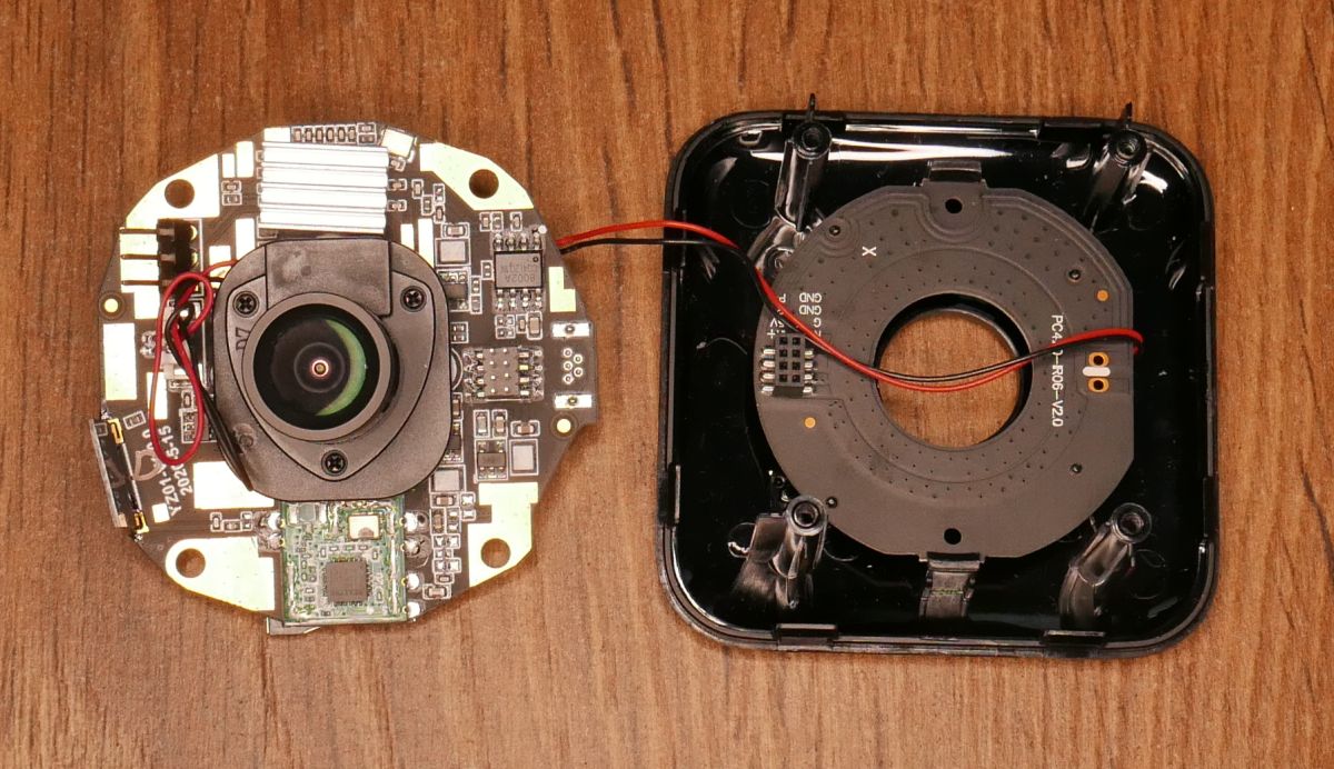

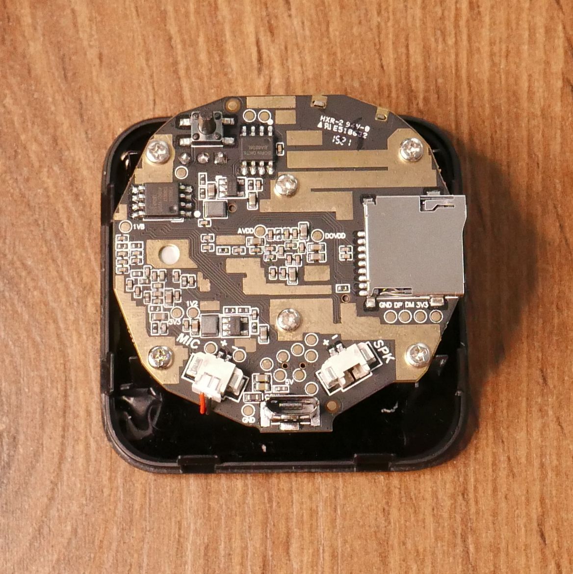

    Interior of camera:
    Ak3918ev300 processor, 8MB Flash, WiFi RTL8188FU.

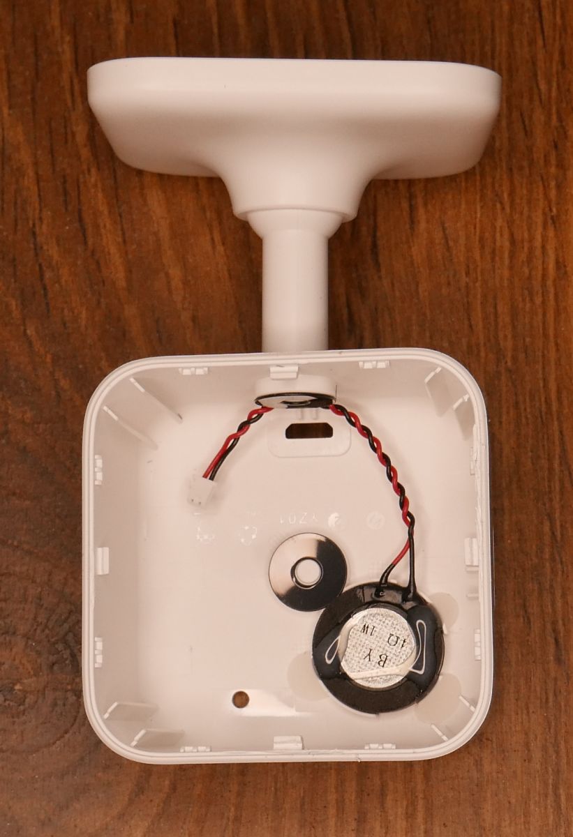

    PCB board with microSD slot and connectors labeled MIC and SPK Interior of GNCC GC2 camera showing lens, circuitry, and IR LED panel GNCC GC2 camera interior with lens module and PCB with wiring
    Interior of GNCC GC2 camera housing with speaker and wiring visible

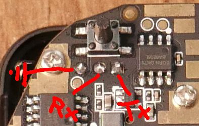

    U-Boot:
    Close-up of a PCB with manually labeled UART pins: Rx, Tx, and GND.
    UART 3.3V, speed 115200.

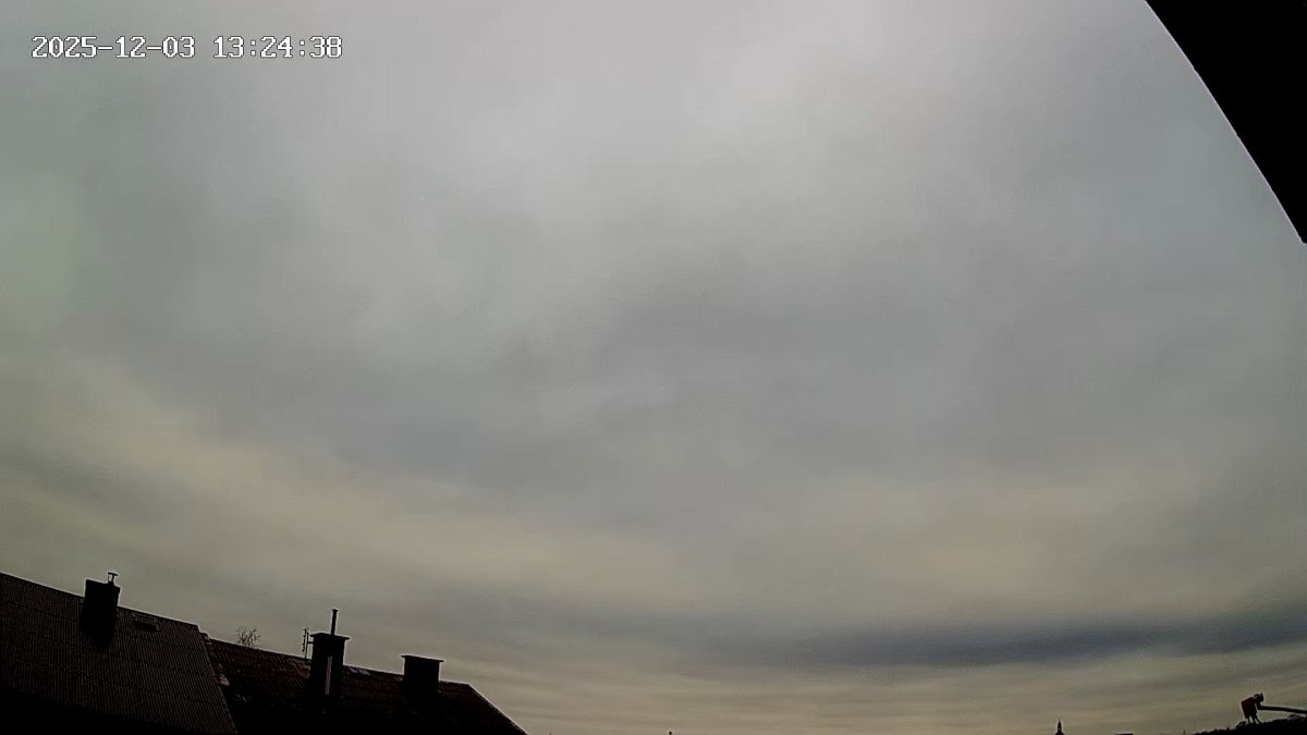

    RTSP link:
    rtsp://<camera_ip>/ch0
    Streaming RTSP from camera:
    Camera snapshot showing rooftops and cloudy sky with date and time overlay in the corner
