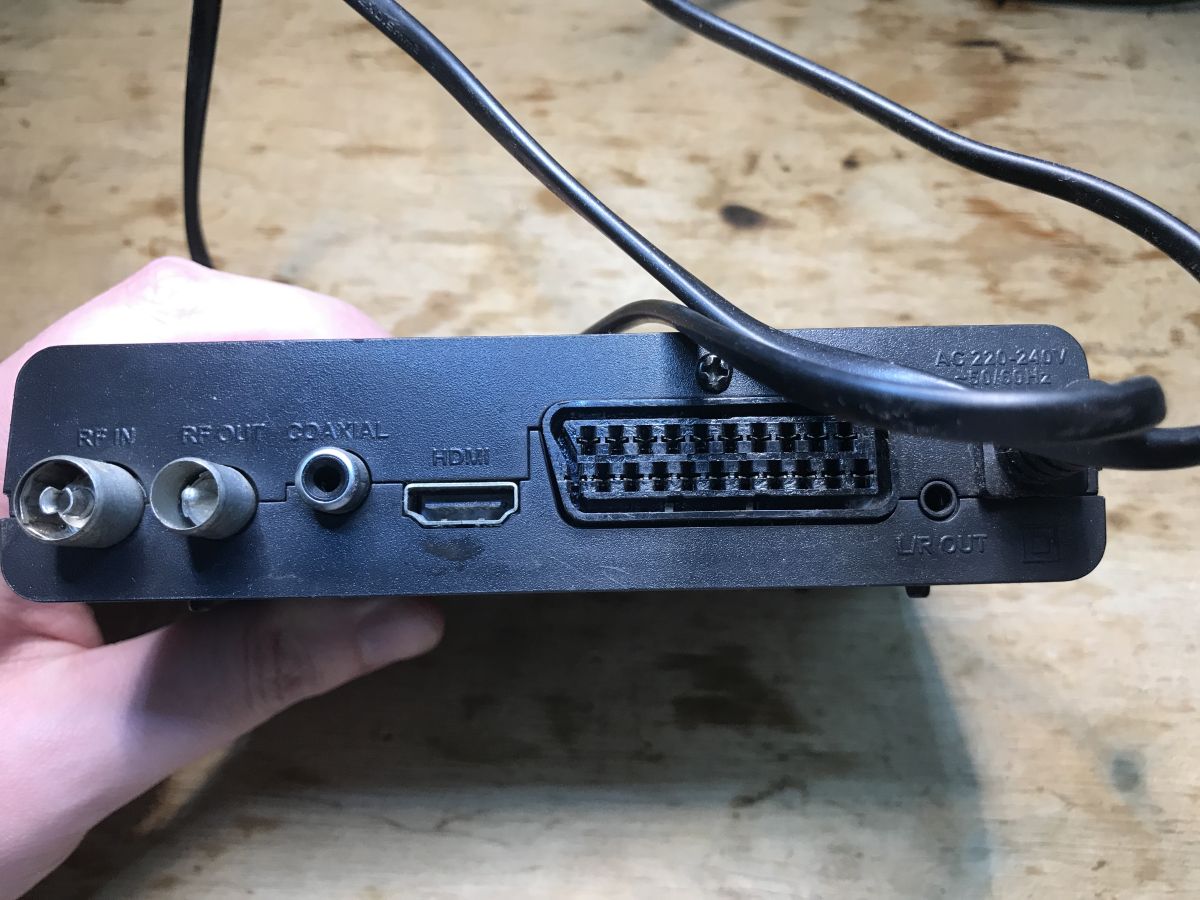

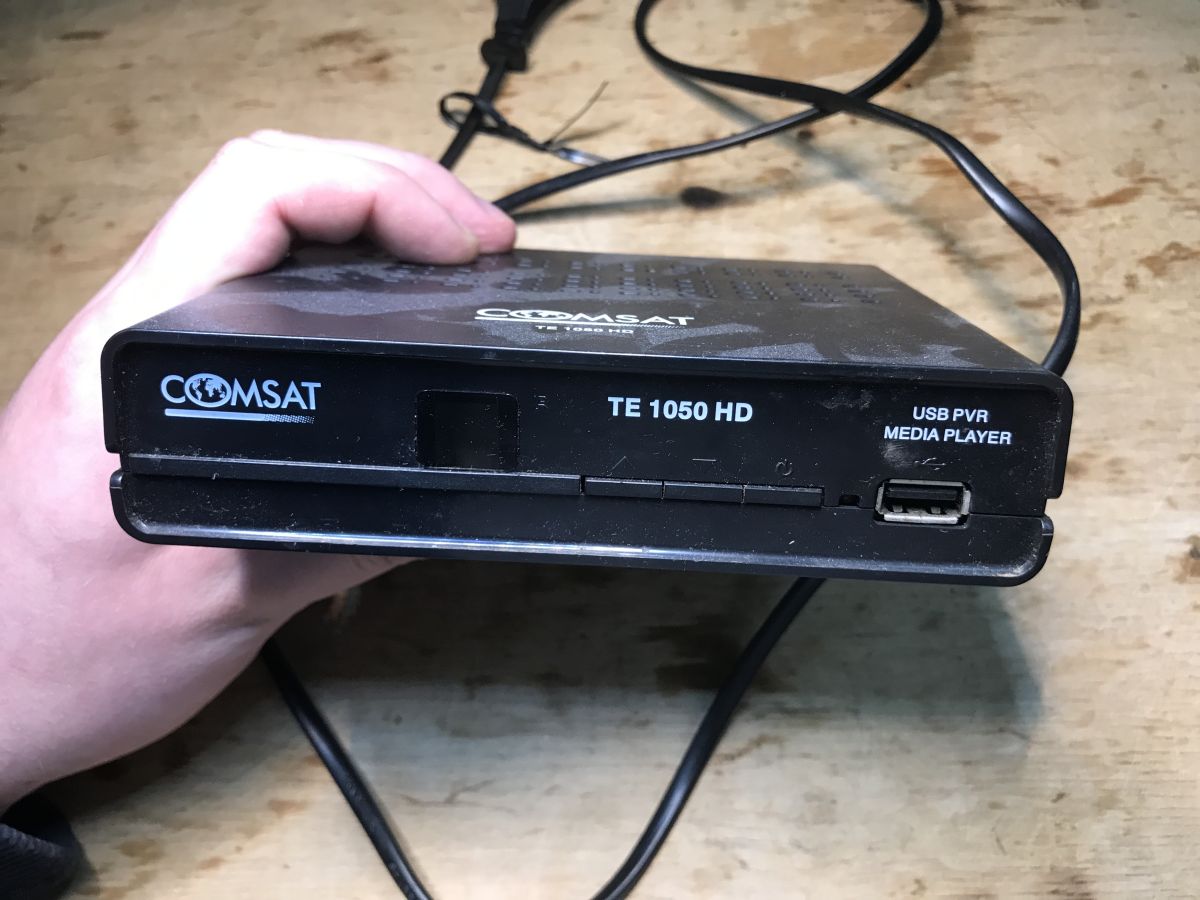

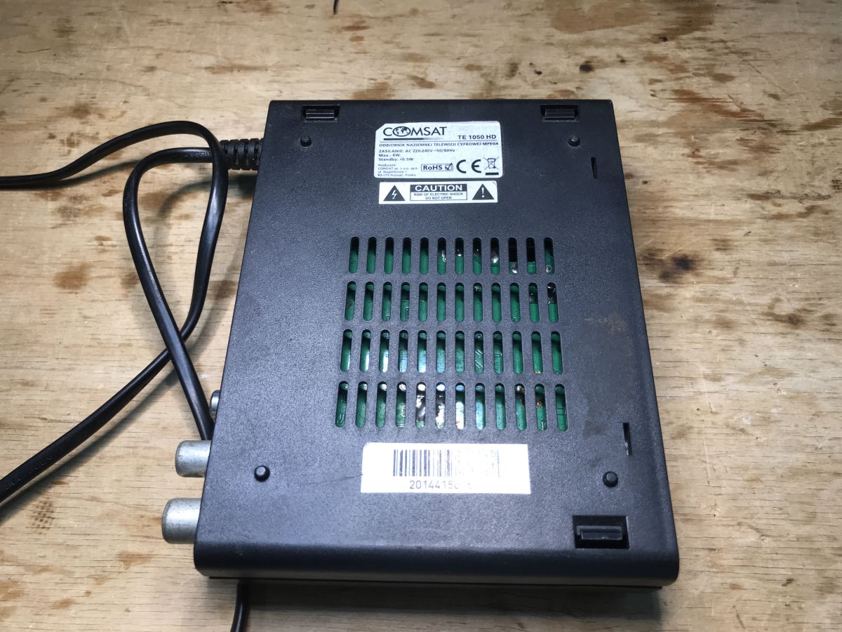

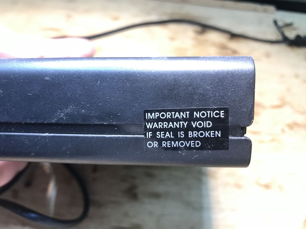

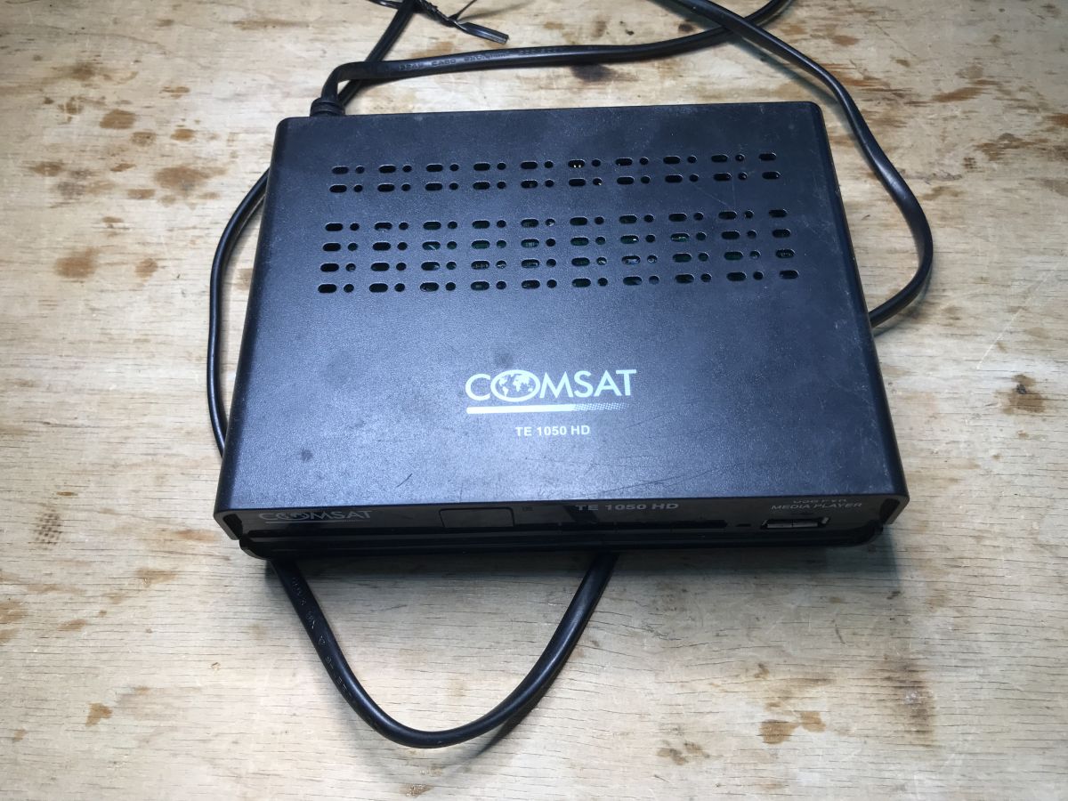

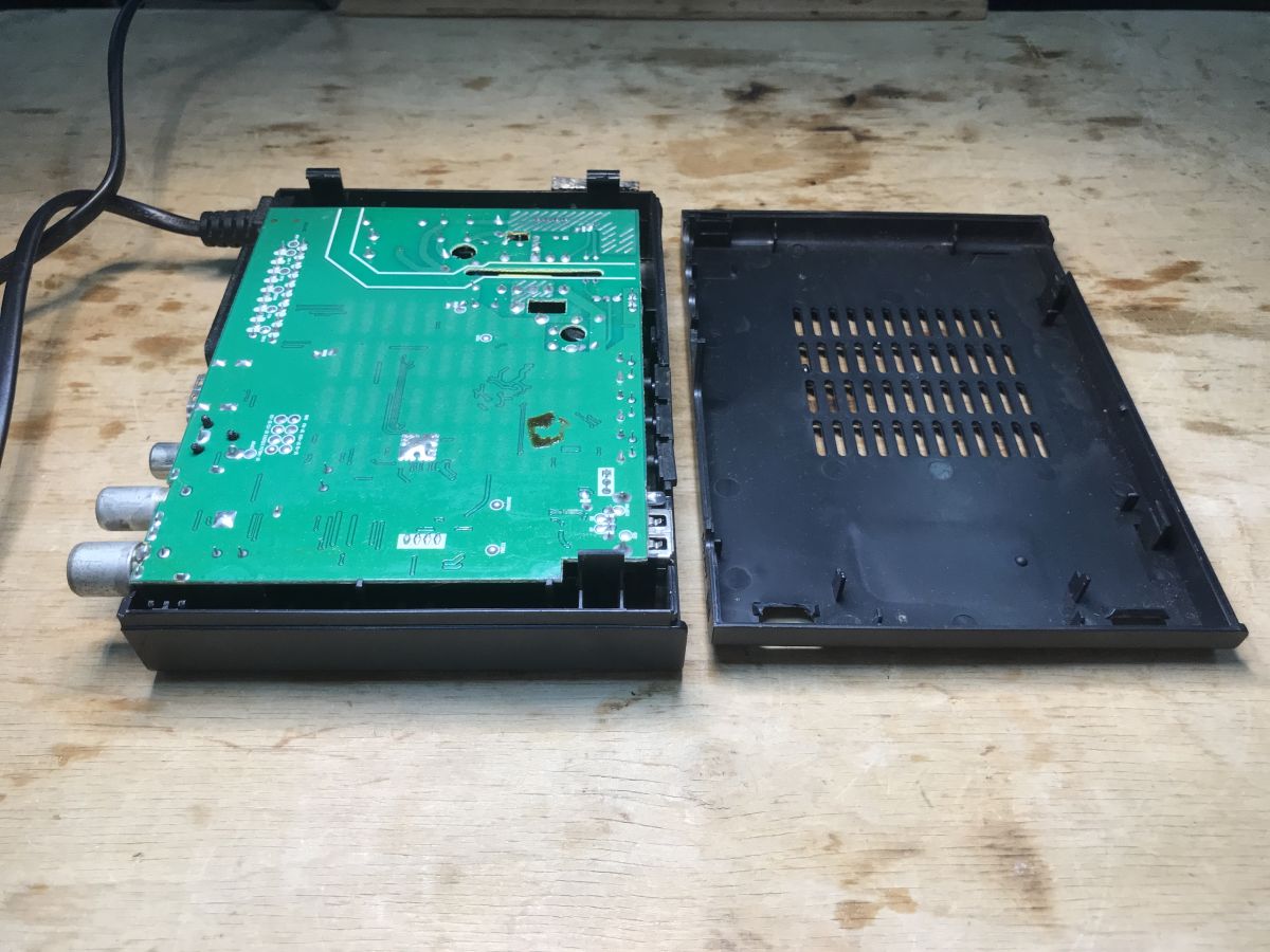

    Standard - to start with a glimpse of the outside, the hardware is tiny, already without a remote control. It won't be of much use for TV anyway, it won't receive DVB-T2, but maybe it will be of use to an electronics engineer? At the very least, there must be some power supply inside, and maybe the housing can be used for something too.
    COMSAT TE 1050 HD set-top box viewed from above on a wooden surface Front panel of COMSAT TE 1050 HD tuner with USB port and USB PVR MEDIA PLAYER label Bottom view of COMSAT TE 1050 HD receiver with label and ventilation slots
    Rear panel of a set-top box with RF, HDMI, SCART, and AC power connectors Warranty seal with warning label on a black electronic device enclosure TE 1050 HD tuner circuit board with opened case on wooden workbench

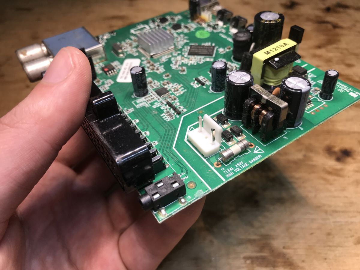

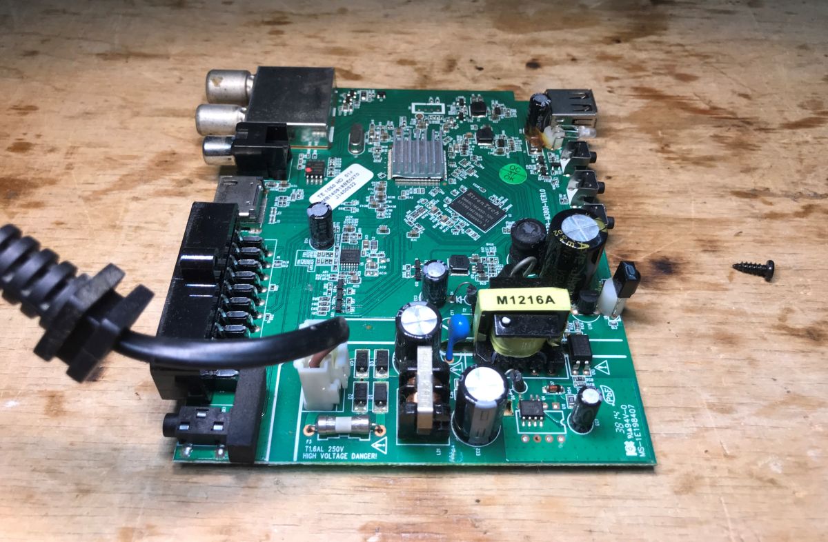

    There is a single PCB inside, not even a split for a separate power supply. There is also no display, so you can't use the parts to build a clock.
    DVB tuner PCB with electronic components and M1216A transformer
    The board consists of two sections - the 'hot', primary side of the power supply, and the 'cold', low-voltage side. Most of the components are surface mounted.
    Close-up of PCB with power supply components and TV tuner connectors

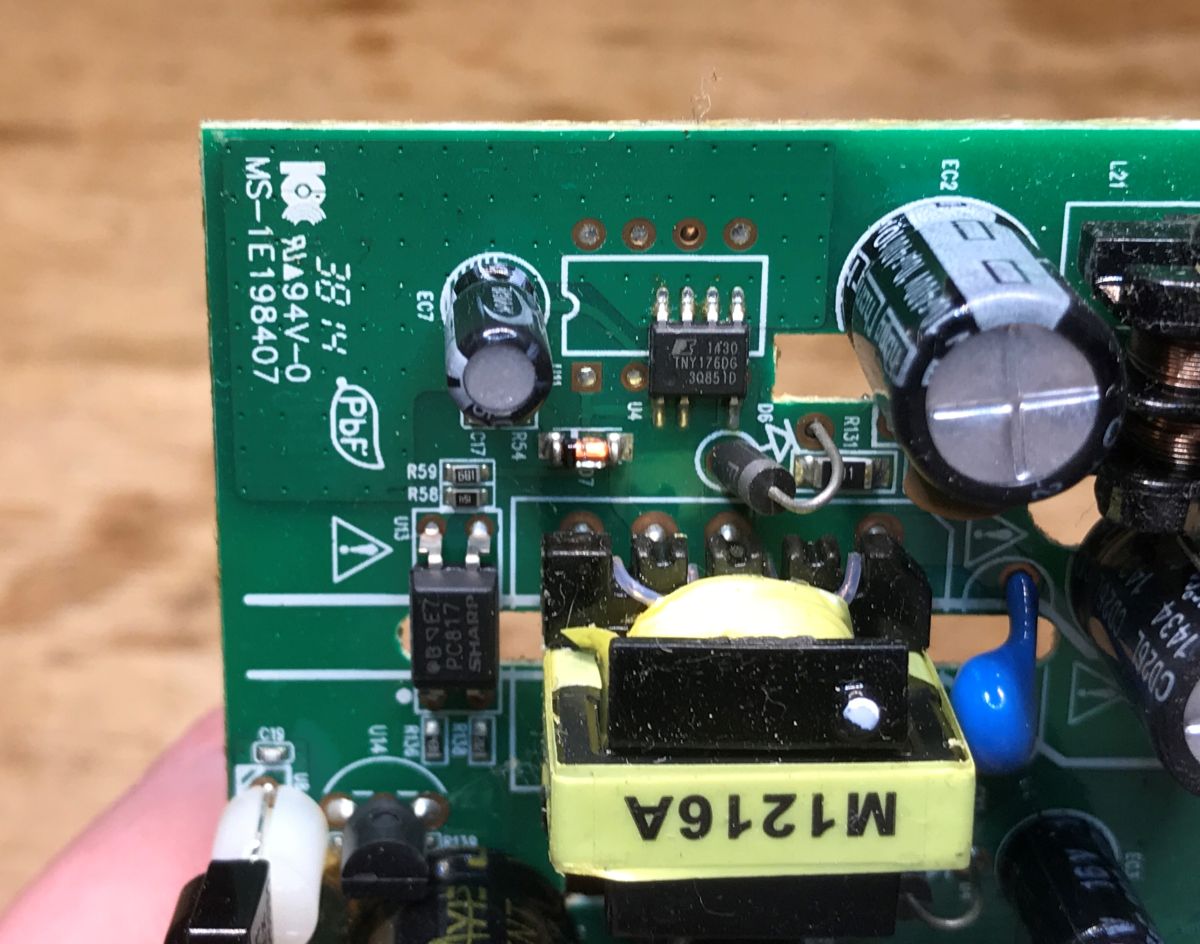

    The power supply is built quite well, there is even a filter against interference emissions, a fuse, a proper capacitor connecting the primary and secondary side.
    Close-up of TNY176DG chip and power supply parts on a green PCB

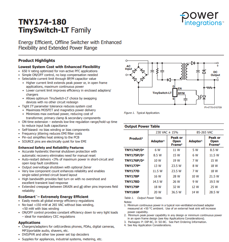

    The power supply is based on the TNY176DG in a surface-mount version. There is also space on the board for its through-hole counterpart.
    Power table and application circuit of TNY174–180 TinySwitch-LT series

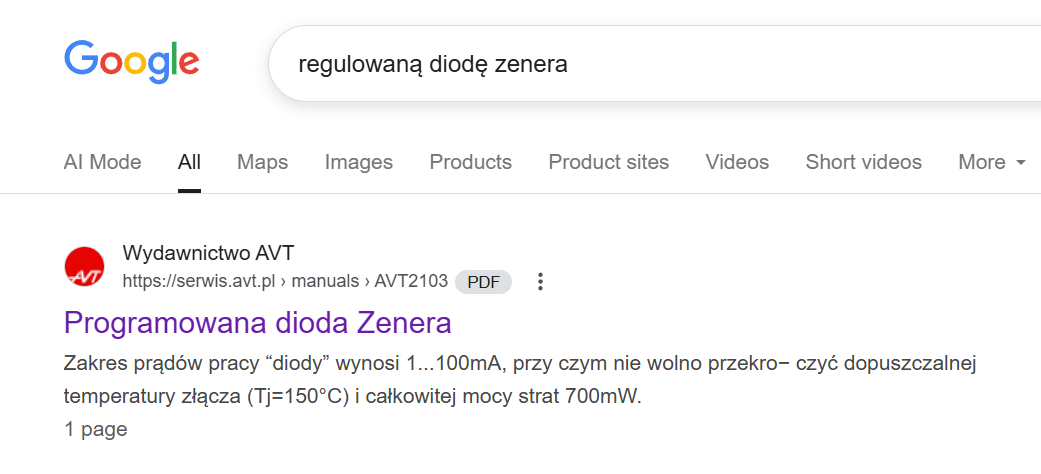

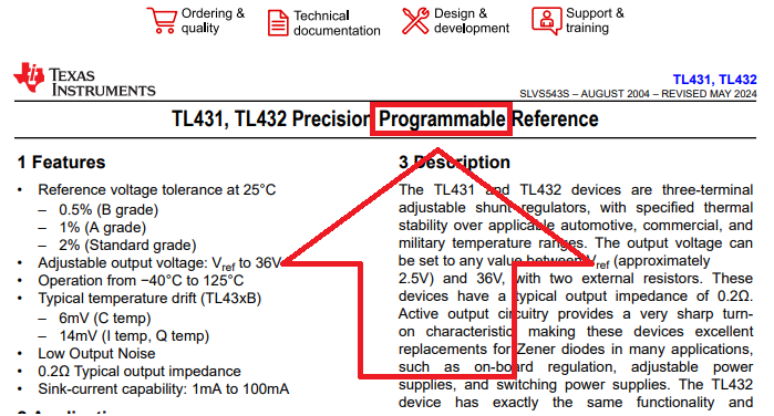

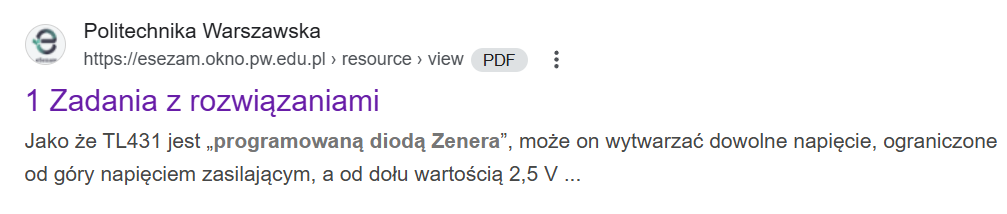

    On the secondary side you can see a classic - the "programmable Zener diode" TL431, it provides the reference voltage and takes part in the feedback loop of the power supply. Changing its resistors can change the output voltage to some extent.

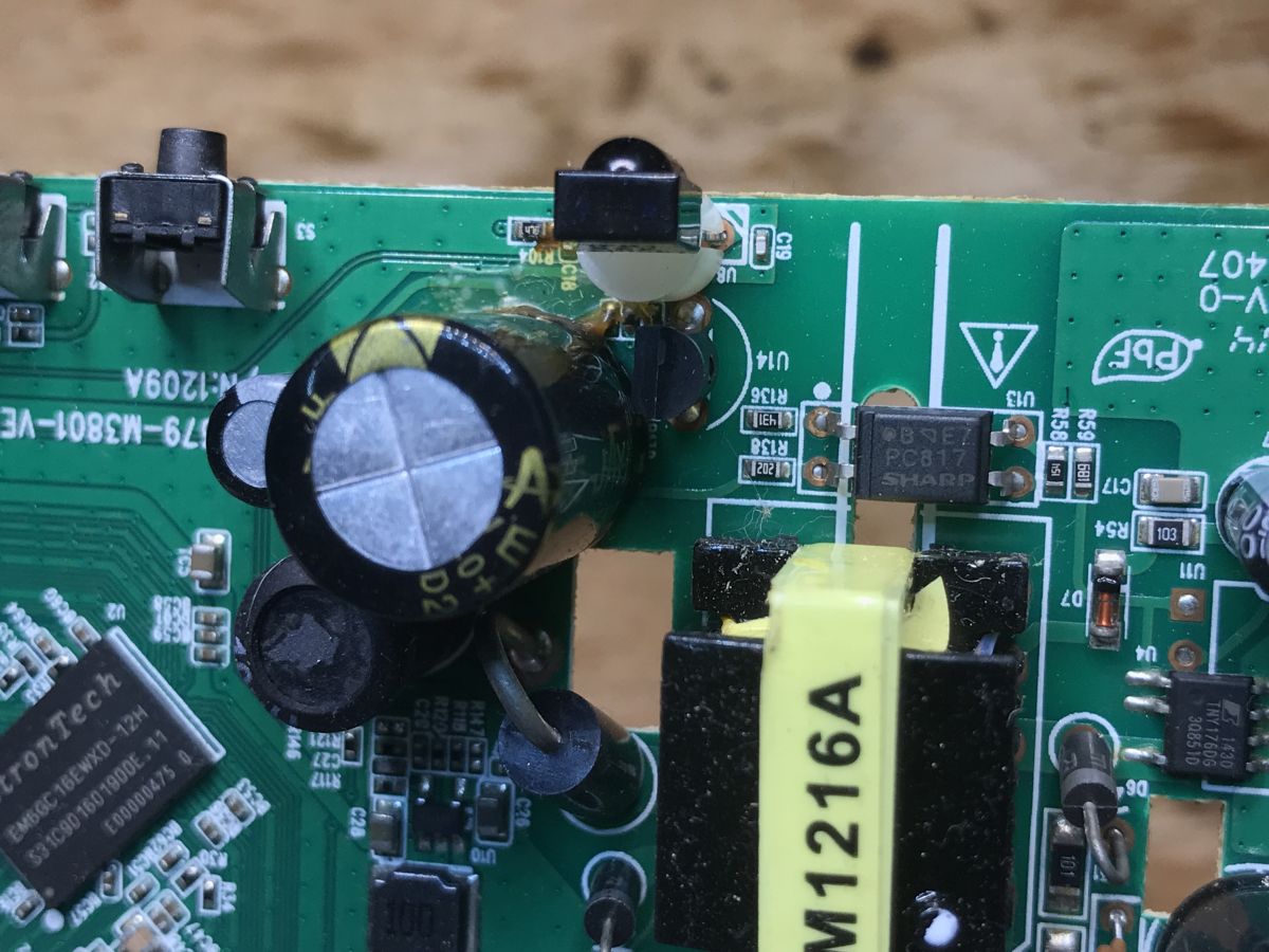

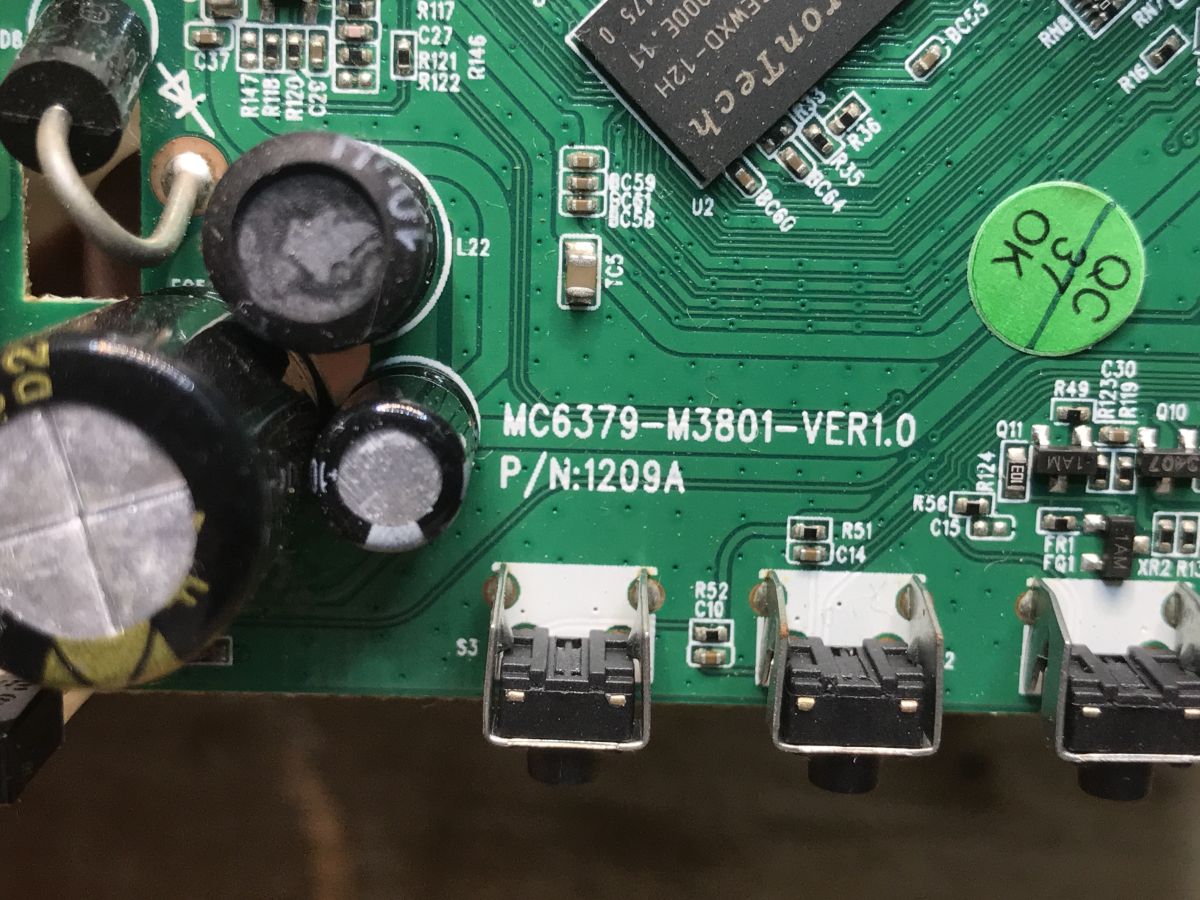

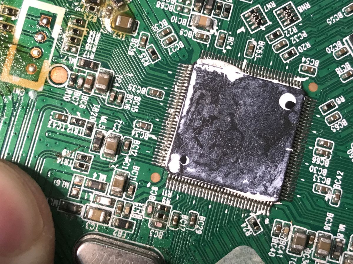

    The CPU sections can now be viewed. The board is signed as MC6379-M3801-VER1.0:
    Close-up of MC6379-M3801-VER1.0 tuner PCB with electronic components visible

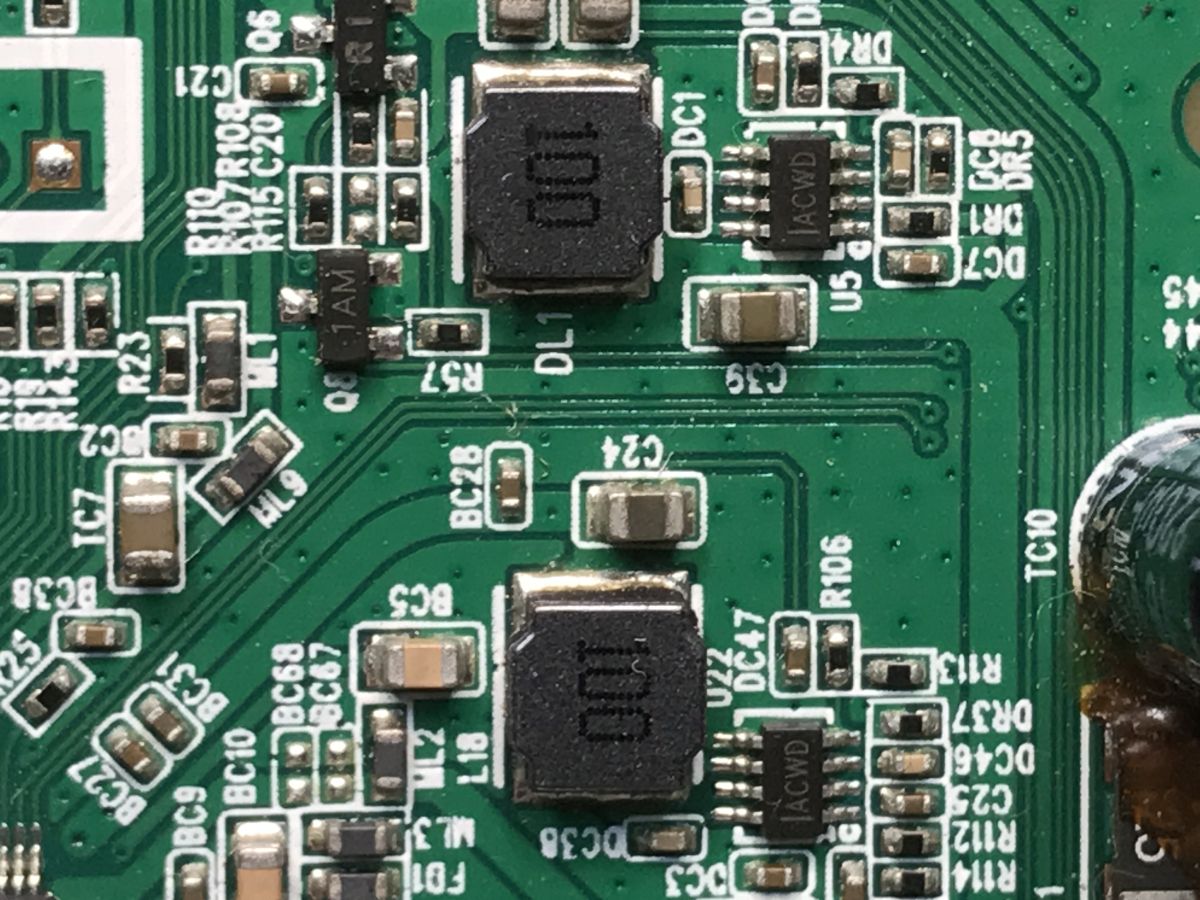

    The power supply typically gives 5 V, so lower voltages for RAM and CPU are generated by additional inverters:
    Close-up of SMD components and power inductor on a green PCB from TE 1050 HD tuner
    The program holds the Flash memory - 25Q32BSIG (4 MB):
    Close-up of 25Q32BSIG Flash memory chip on TE 1050 HD tuner PCB

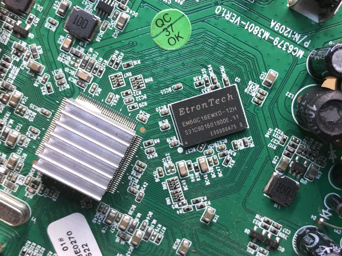

    Close-up of EtronTech chip on the PCB of TE 1050 HD tuner
    EM6GC16EWXD-12H is a DDR3 DRAM , 64M x 16 bit.
    Close-up of M3801 chip on green PCB with various SMD components around it
    The CPU itself appears to be an M3801 ALI. This agrees with the device data sheet.

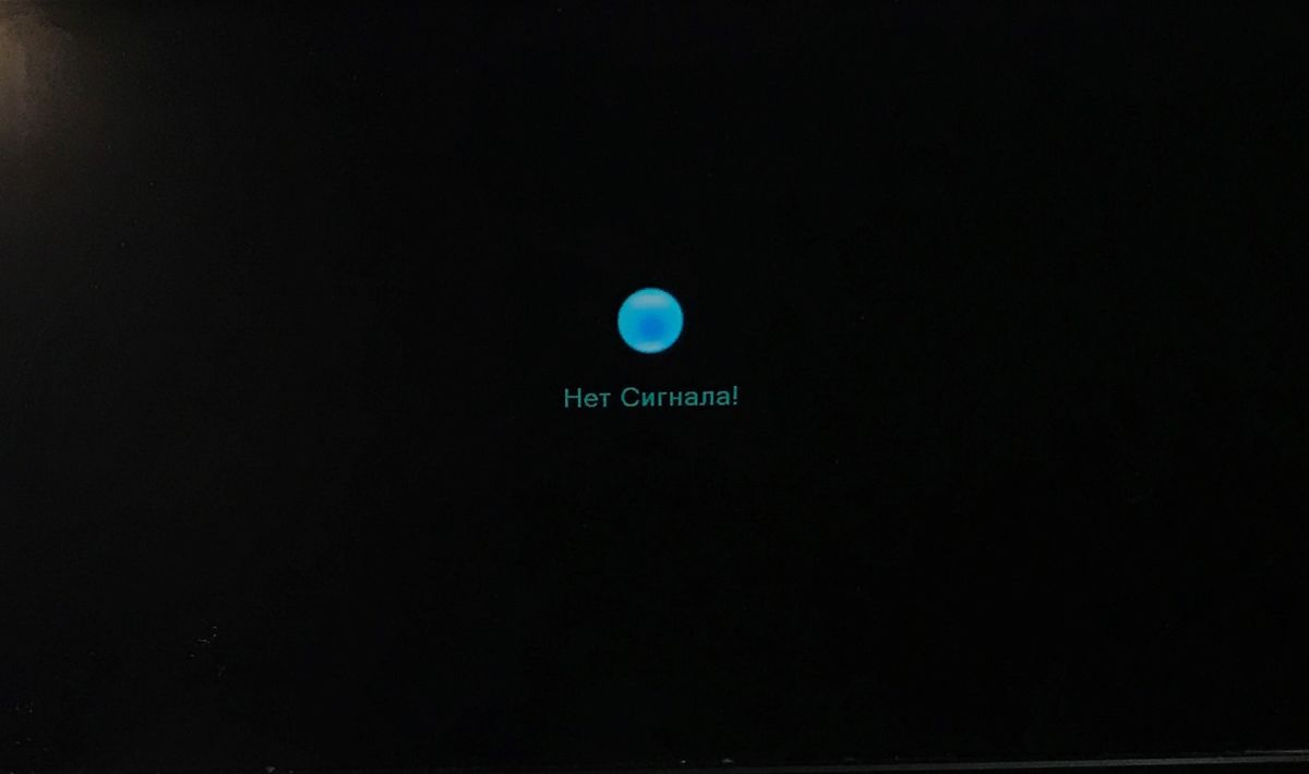

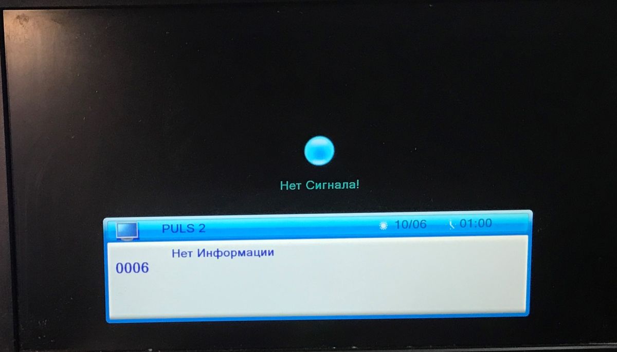

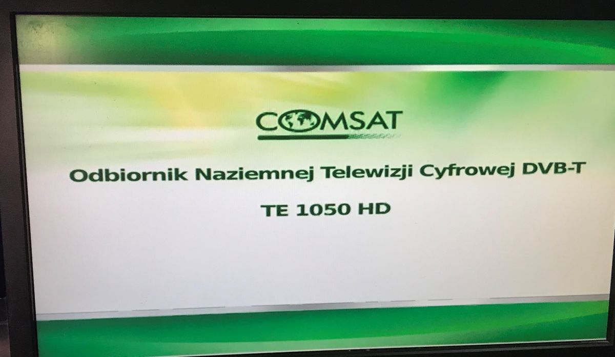

    Tuner turns on, gives picture, shows no signal.
    Startup screen of COMSAT TE 1050 HD with DVB-T receiver info “No signal” message in Russian on PULS 2 TV channel screen. Black screen with blue symbol and text “Нет Сигнала!”

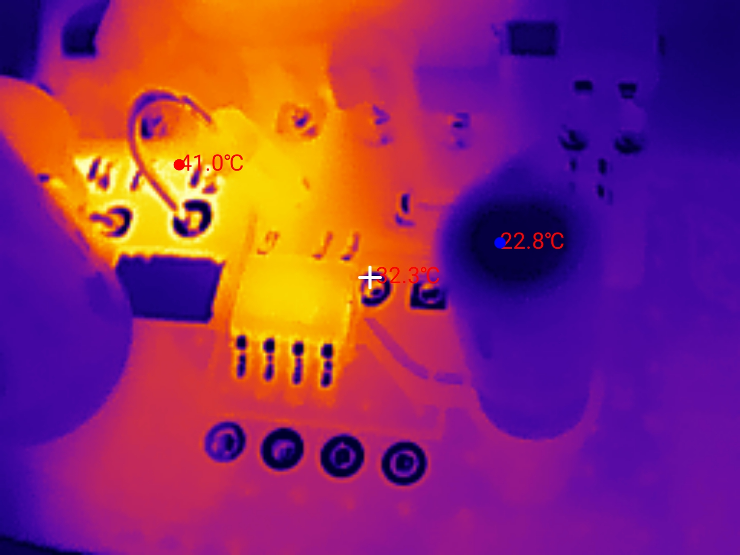

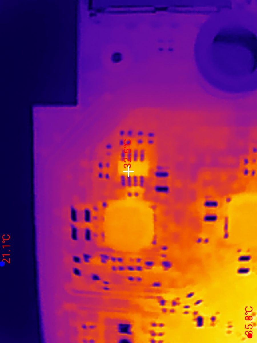

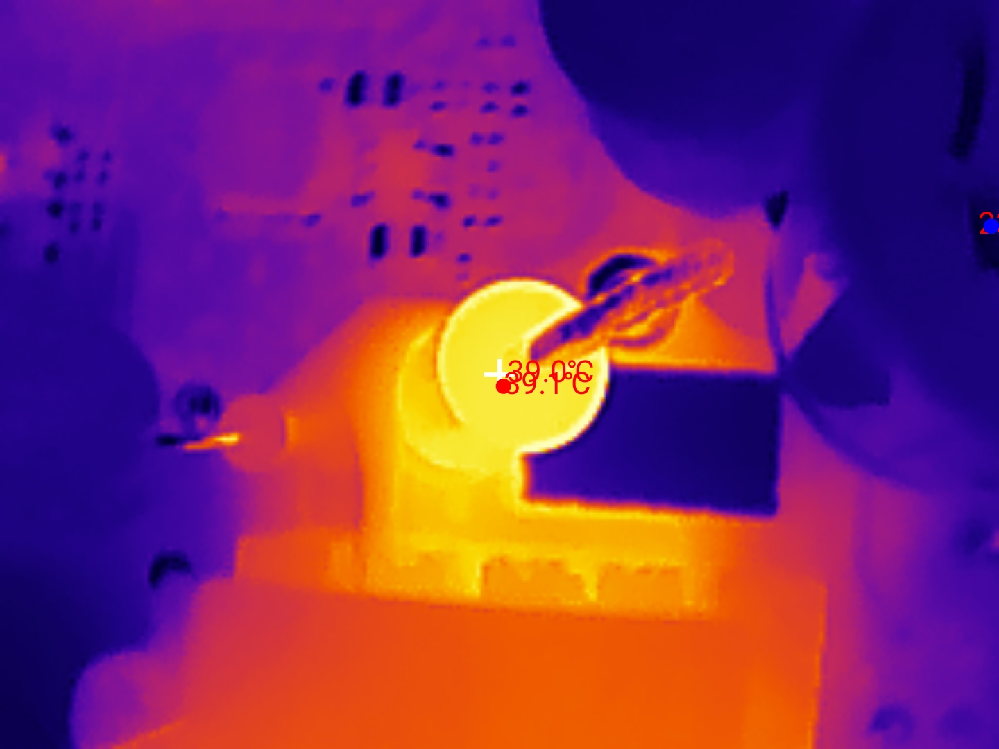

    What heats up in such a tuner?
    A short play with the InfiRay P2 PRO. The equipment went 5 minutes without a signal, still displaying the image.
    Thermal image of TE 1050 HD tuner interior showing hot spot reaching 48.2°C
    The CPU and the inverter heat up the most - separately its primary and secondary sides. On the primary side, the TNY and the current measurement resistor heat up:
    Thermal image of TV tuner interior with three temperature points: 41.0°C, 32.3°C, and 22.8°C
    On the secondary side, the Schottky diode:
    Thermal image of TE 1050 HD tuner PCB showing 39.9°C at the power converter
    A little the transformer is also heating up:
    Thermal image of set-top box interior showing heat spots up to 40.3°C
    The inverters from the voltages for the CPU and RAM are much less heated:
    Thermal image of a PCB board, hottest point reaches 35.6°C

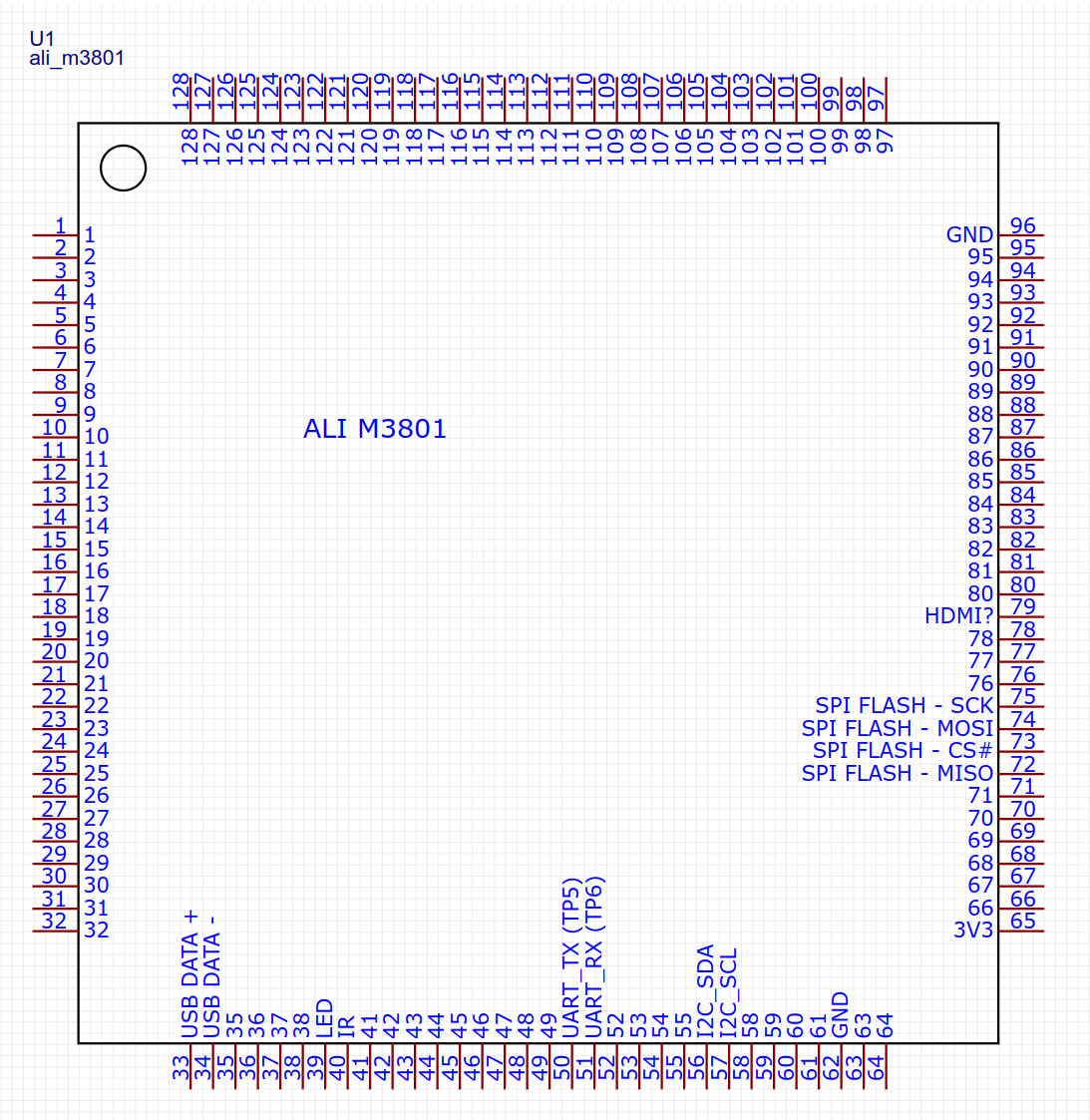

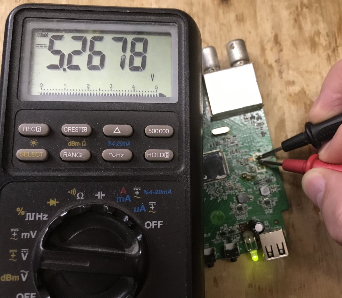

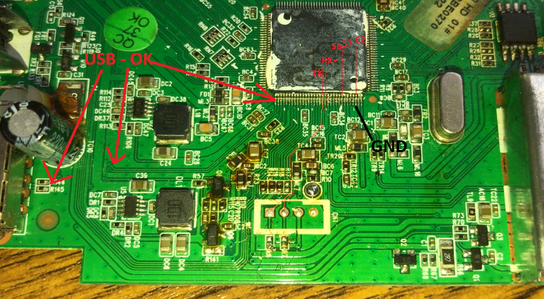

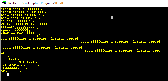

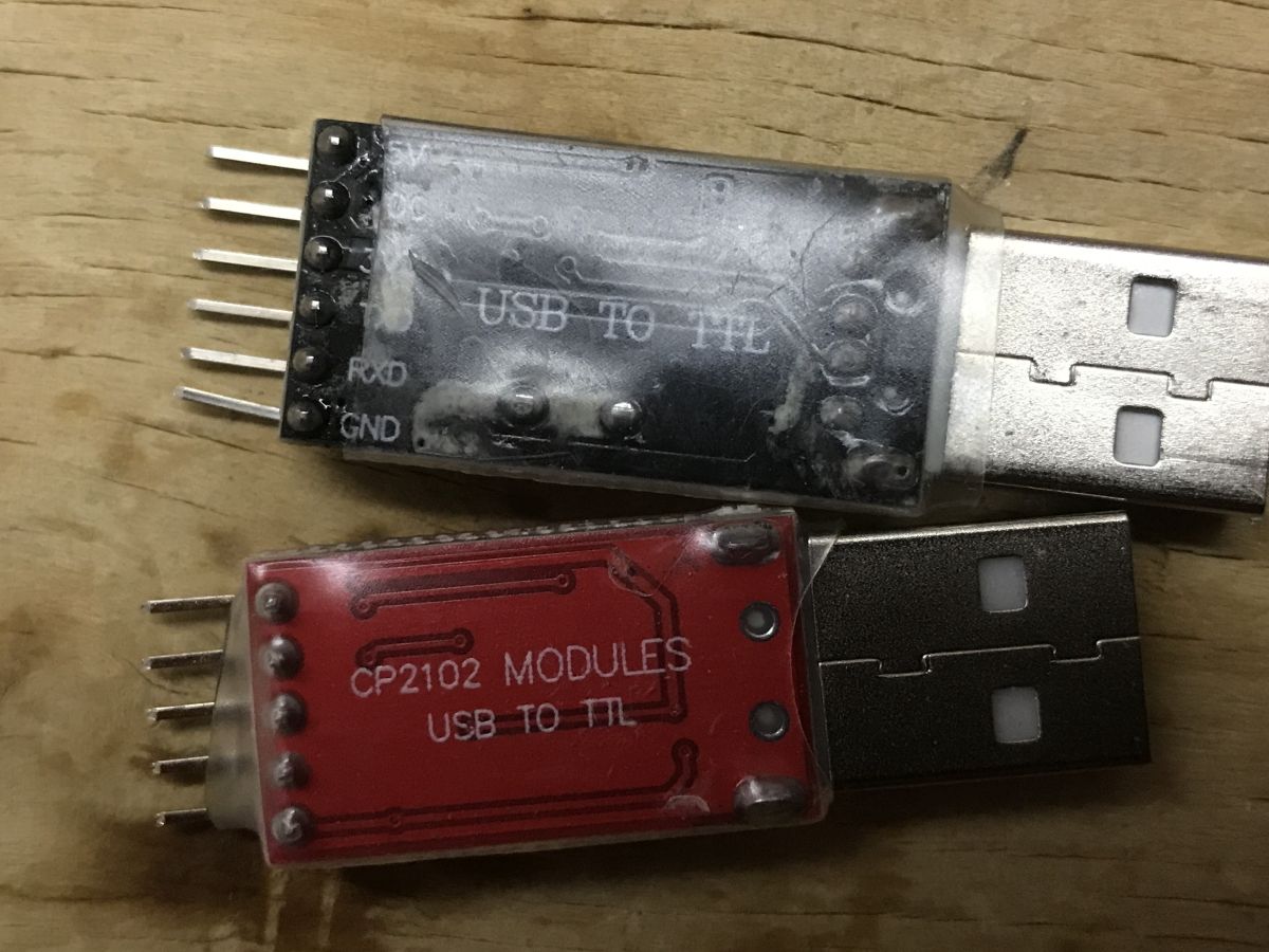

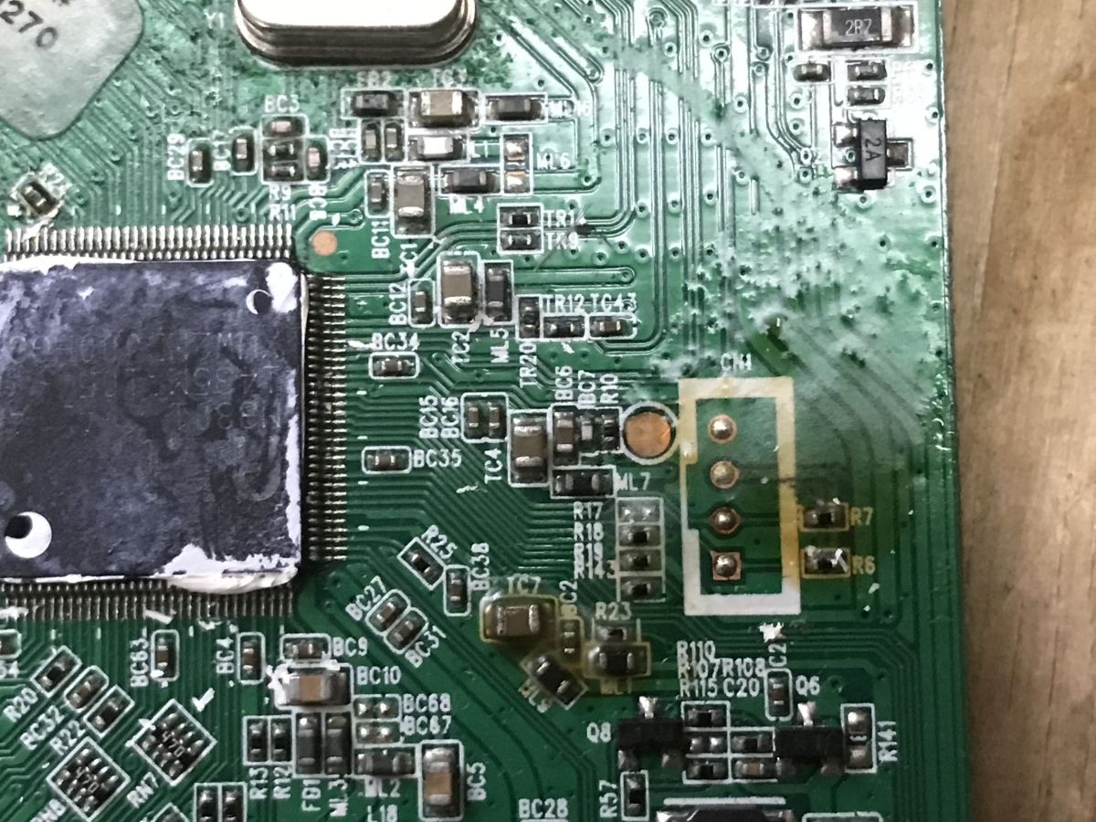

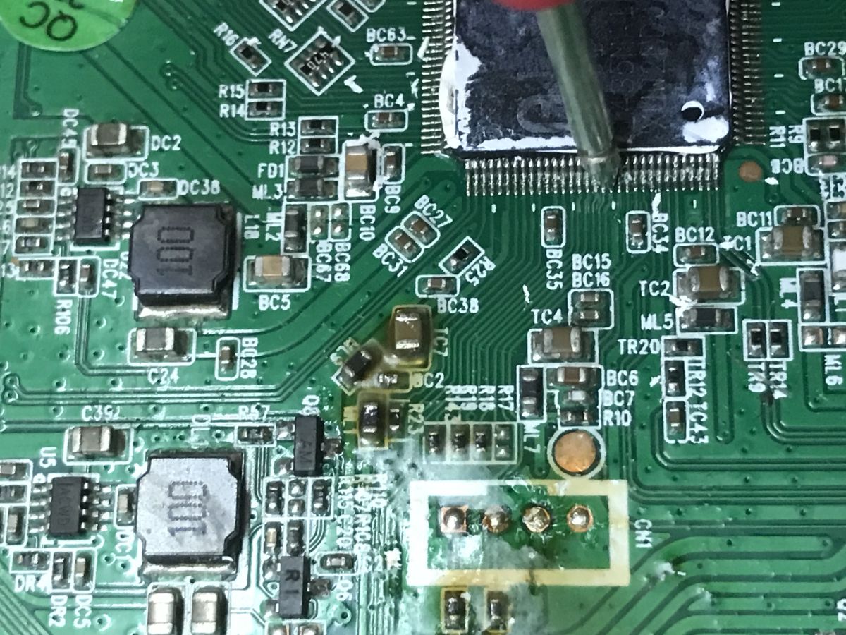

    UART port
    The device has pads derived from the UART. There are four pads, 5 V (the same as on the USB goes, the main power line), ground, RX and TX.
    Close-up of a PCB section showing UART pads and surface-mount components. Voltage measurement of 5.27 V on DVB-T tuner PCB using a digital multimeter Measuring resistance on a PCB using a digital multimeter
    RX and TX reaches here - I don't have a more precise probe at hand:
    Close-up of a probe touching IC pins on a DVB tuner printed circuit board.

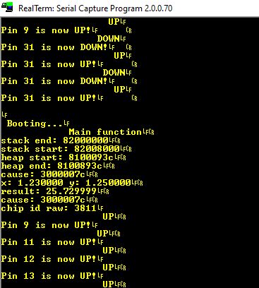

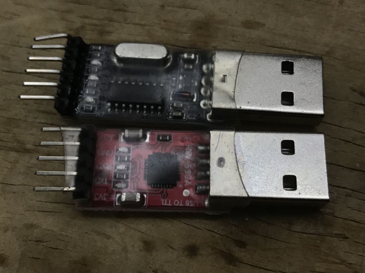

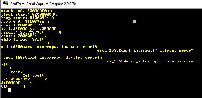

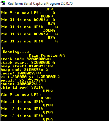

    Boot log UART
    At 115200 baud, residual messages can be received at startup. The tuner does not respond to any commands or special characters at boot. The Upgrade tool does not see it either.
                                                                                                                                                                                                                                                                                                                                      APP  init!
    bl_flash_init!
    bl_verify_sw
    check_program!
    success!
    MC: APP  init ok
    << SDK4.0ba.4.0_20101217 >>
    Libcore version 8.1c.0@SDK4.0bd.8.7_20121127(gcc version 3.4.4 mipssde-6.06.01-20070420)(vic.wang@ Fri Nov 30 11:35:29 2012)
    Application version 1.0.0@SDK4.0bd.8.7_20121127byUSER

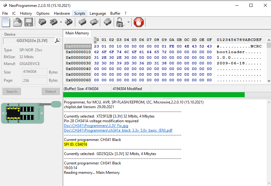

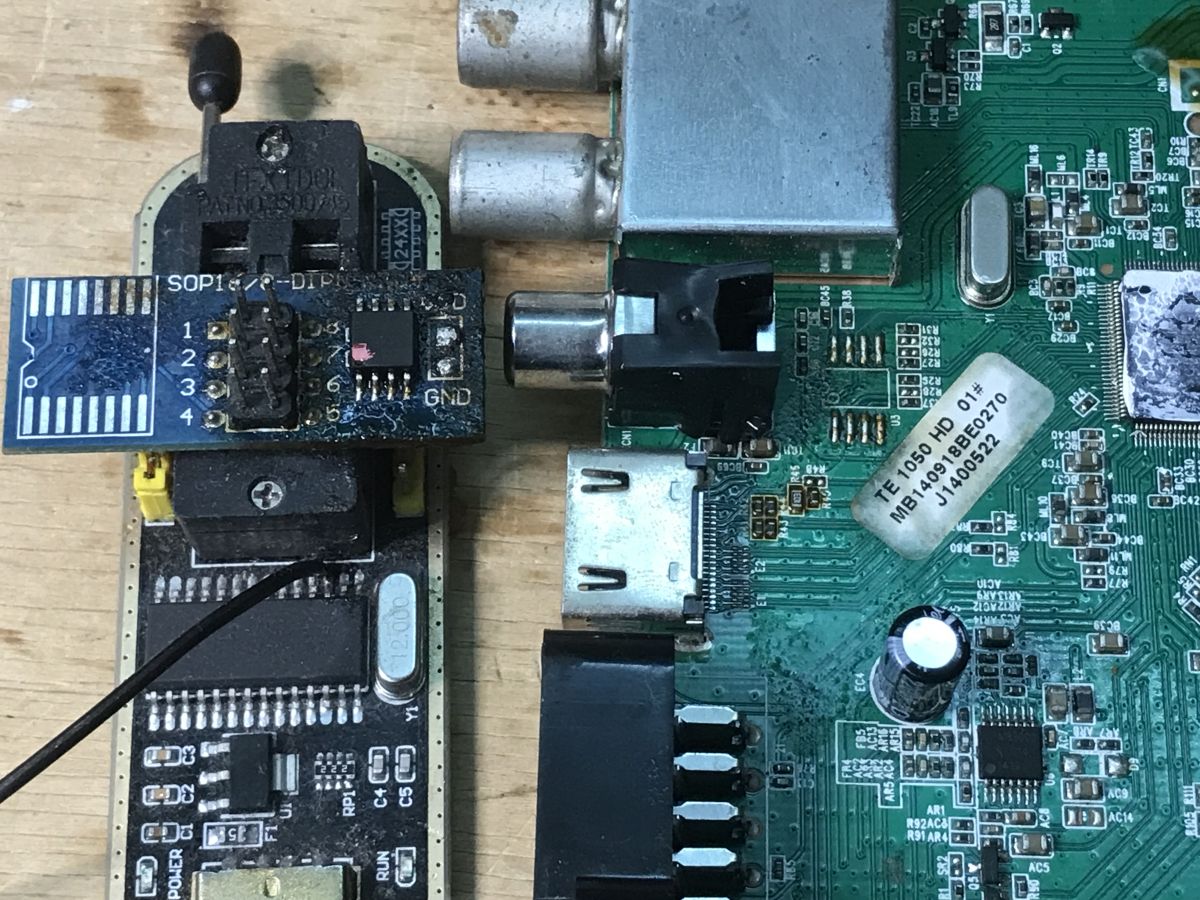

    Flash memory upload
    All you have to do is solder the bone and use CH341. On the computer side I use NeoProgrammer.
    Close-up of the TE 1050 HD mainboard connected to a Flash memory programmer
    Screenshot of NeoProgrammer showing SPI NOR Flash memory contents

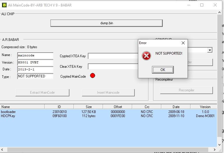

    Tests with existing tools

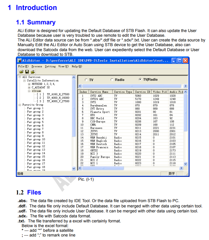

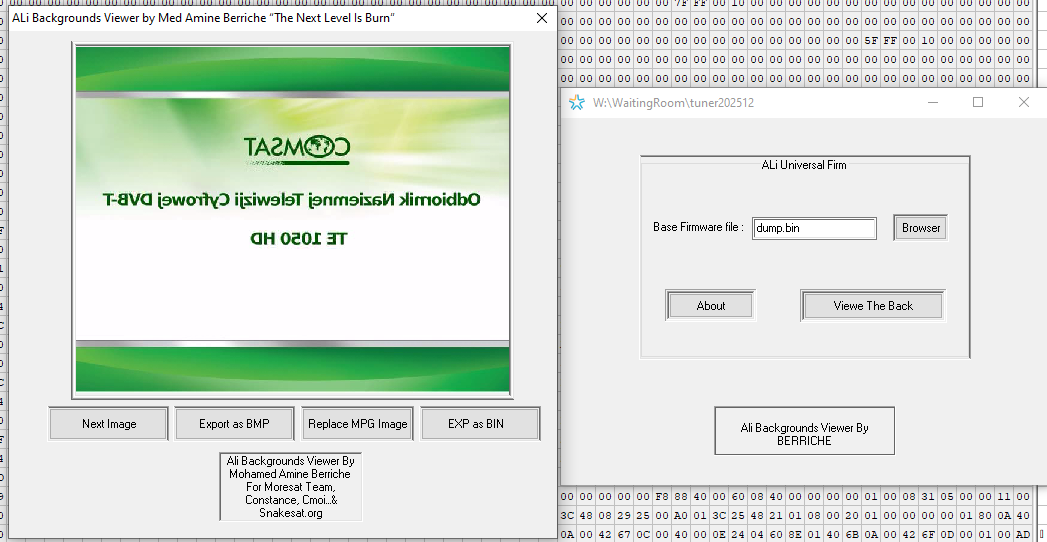

    Ali MainCode-BY-ARB Tech V 9 - BABAR decodes something there, but then crashes with an error. Unable to extract or insert code.
    Screenshot of Ali MainCode tool showing NOT SUPPORTED! error for dump.bin file
    Ali Background Viewer manages to find one image:
    Screenshot of ALi Backgrounds Viewer showing TE 1050 HD set-top box splash image

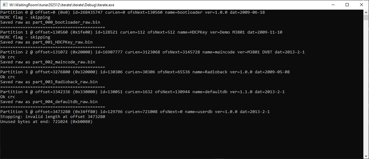

    Flash dump analysis
    I started classically with binwalk , but it didn't give too many results, and in turn I didn't want to check again every result shown with the -I switch.
    tester@DESKTOP-6SD9MUK:/mnt/w/WaitingRoom/tuner202512$ binwalk dump.bin
    DECIMAL       HEXADECIMAL     DESCRIPTION
    2321543       0x236C87        Copyright string: "copyright laws as"
    2636264       0x2839E8        Cisco IOS experimental microcode, for "']"

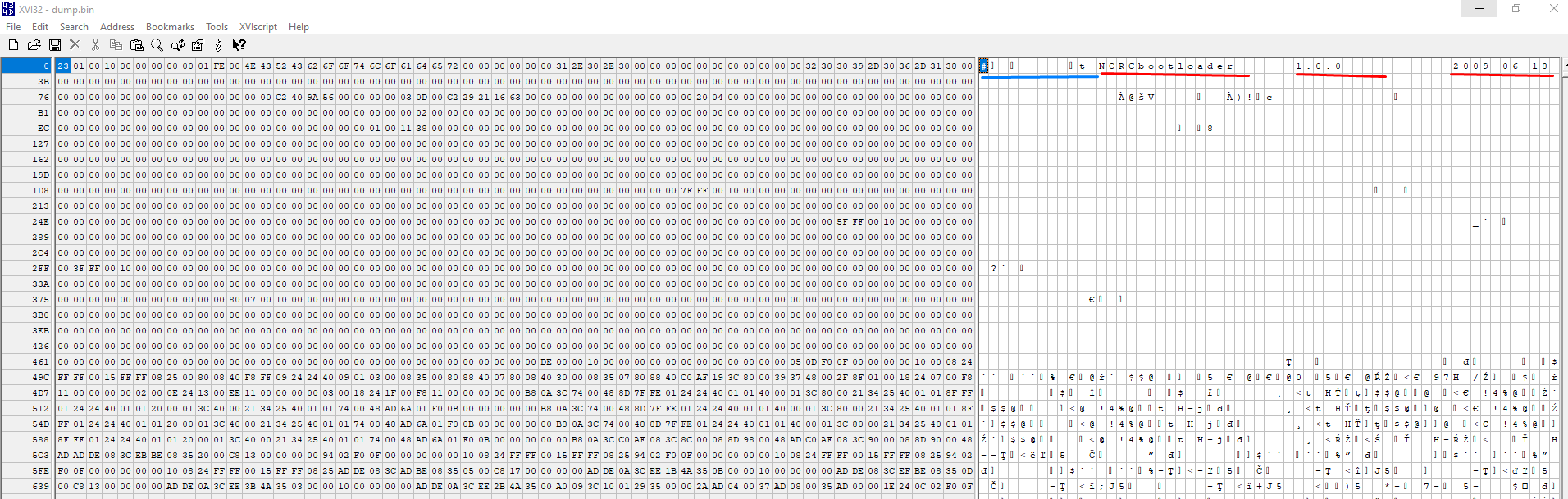

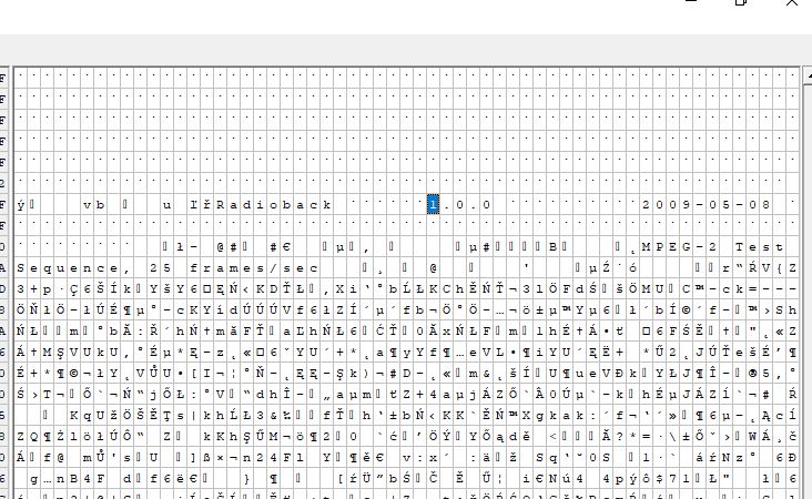

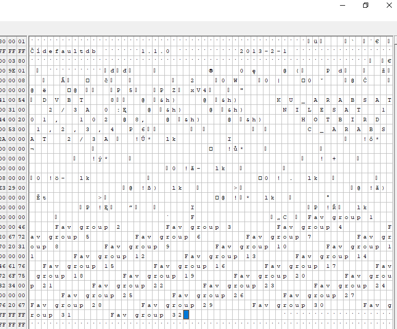

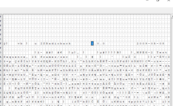

    I quickly decided that I would play around manually. Right at the start you see something that resembles a header structure - you can see the inscriptions NCRCbootloader, 1.0.0 and some date.
    Hex editor view showing flash partition header with bootloader name
    I have highlighted it in red in the image. So it's easy to guess that the values earlier (underlined in blue) are probably some offsets or partition sizes.
    Now just check each of them - maybe any of them are partition lengths?
    I checked four bytes each, in two orders: big-endian and little-endian. Either the oldest byte is first, or the youngest. Then I would make a jump by a given value in my hex xvi32 editor and see where I landed:
    Hex editor view showing Radioback partition header highlighted in a data file.
    The value just before the NCRC name leads to the next partition! You can outline the structure:
    Code: C / C++
    You still need an auxiliary function to swap the byte order:
    Code: C / C++
    And the whole thing can be analysed in the program.
    Code: C / C++
    It is good, but it is not perfect:
    Partition 0 @ offset=0 (0x0) id=268435747 unk=0 len=130560 name=NCRCbootloader ver=1.0.0 dat=2009-06-18
    Partition 1 @ offset=130560 (0x1fe00) id=128521 unk=1879048192 len=512 name=NCRCHDCPKey ver=Demo M3801 dat=2009-11-10
    Partition 2 @ offset=131072 (0x20000) id=16907777 unk=2091331328 len=3145728 name=yÝĘ~maincode ver=M3801 DVBT dat=2013-2-1
    Partition 3 @ offset=3276800 (0x320000) id=130306 unk=1651900416 len=65536 name=ułż°Radioback ver=1.0.0 dat=2009-05-08
    Partition 4 @ offset=3342336 (0x330000) id=130051 unk=1611005952 len=130944 name= ver=1.1.0 dat=2013-2-1
    Partition 5 @ offset=3473280 (0x34ff80) id=129796 unk=1879051008 len=0 name=NCRCuserdb ver=1.0.0 dat=2013-2-1
    Stopping: invalid length at offset 3473280
    Unused bytes at end: 721024 (0xb0080)
    Those strange stamps at the beginning of partition names make it suggest that the NCRC is not part of the name (string), but a special field value, probably from the CRC....
    Code: C / C++
    O much better:
    Partition 0 @ offset=0 (0x0) id=268435747 unk=0 len=130560 name=bootloader ver=1.0.0 dat=2009-06-18
    Partition 1 @ offset=130560 (0x1fe00) id=128521 unk=1879048192 len=512 name=HDCPKey ver=Demo M3801 dat=2009-11-10
    Partition 2 @ offset=131072 (0x20000) id=16907777 unk=2091331328 len=3145728 name=maincode ver=M3801 DVBT dat=2013-2-1
    Partition 3 @ offset=3276800 (0x320000) id=130306 unk=1651900416 len=65536 name=Radioback ver=1.0.0 dat=2009-05-08
    Partition 4 @ offset=3342336 (0x330000) id=130051 unk=1611005952 len=130944 name=defaultdb ver=1.1.0 dat=2013-2-1
    Partition 5 @ offset=3473280 (0x34ff80) id=129796 unk=1879051008 len=0 name=userdb ver=1.0.0 dat=2013-2-1

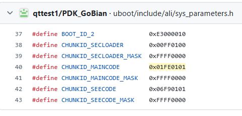

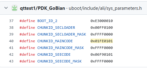

    I then started looking for information about the constant, which looks like a header identifier to me. Bingo - there are results on GitHub:
    https://github.com/search?q=0x01FE0101&type=code&p=1
    Header file fragment with CHUNKID definitions from the PDK_GoBian project
    It corresponds to the constant - CHUNKID_MAINCODE.
    You can find code showing how the application starts:
    https://github.com/qttest1/PDK_GoBian/blob/master/uboot/board/ali-stb/norflash/flash.c#L109
    Code: C / C++
    This also found the rest of the header structure:
    Code: C / C++
    It looks like my first assessment was almost entirely correct - only the variable I specified as length is actually an offset to the next partition, and the partition length may be smaller.
    Code: C / C++
    This is confirmed - the second int32 looks like the actual partition size (not the maximum):
    Hex editor screenshot showing defaultdb partition data of a TE 1050 HD tuner
    Here we still have a mention of NOCRC:
    Code: C / C++
    This would explain everything, after all, in ASCII 0x4E435243 is "NCRC". This is the special value used to mark partitions without CRC.

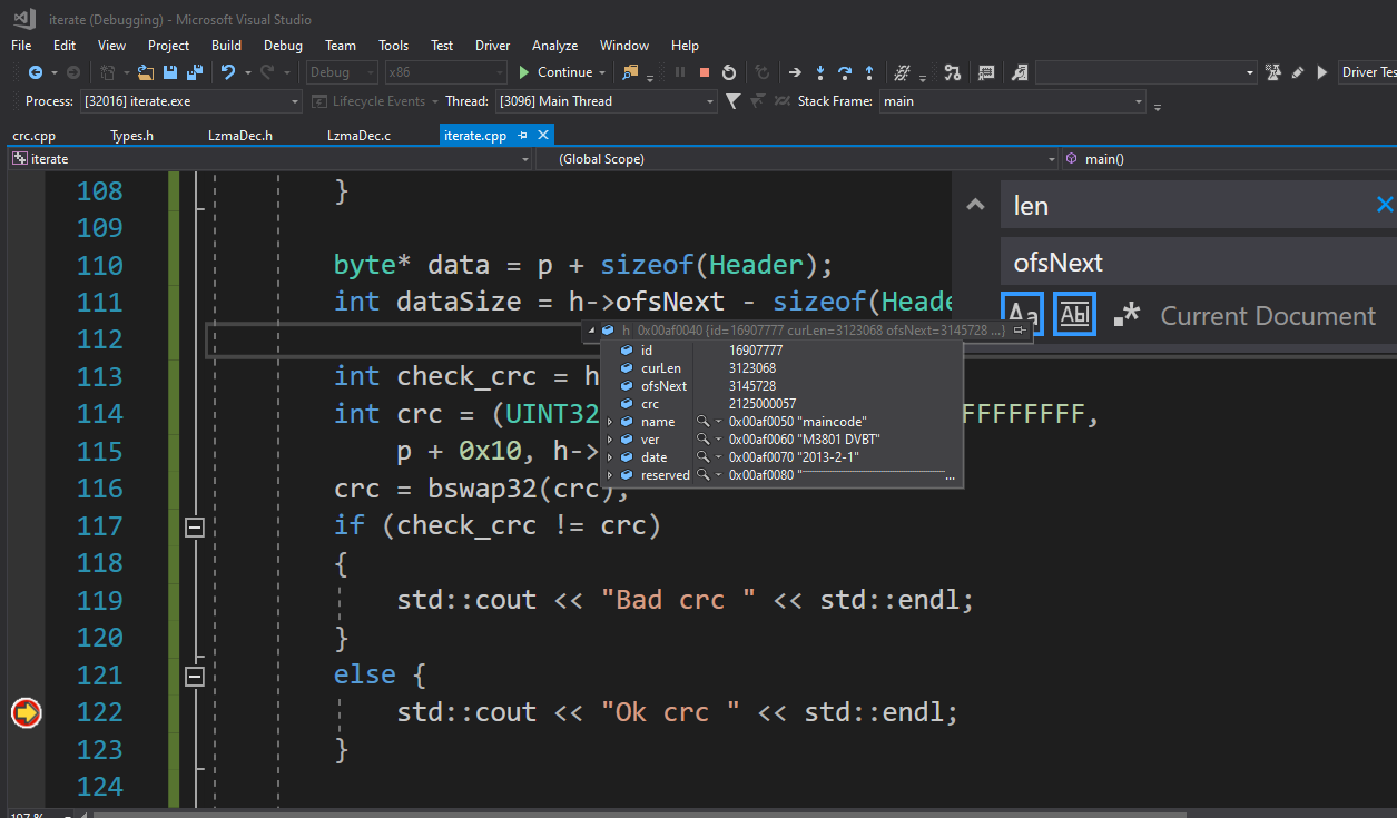

    Correct CRC check
    At this stage I have already managed to find the code where the CRC is verified:
    Code: C / C++
    The mg_table_driven_crc function is also available, moreover it has no dependencies on other libraries. It can be easily ported.
    https://github.com/erwinbsbqq/PDK_GoDroid/blo...63f95/uboot/board/ALi/ali_3503/fastCRC.c#L171
    I added it to my program and from now on I can verify the CRC of partitions.
    Visual Studio window with a C++ file checking CRC of a flash partition
    All CRCs are correct:
    Screenshot of a program displaying the Flash memory partition structure of the TE 1050 HD tuner

    https://github.com/jinfeng-geeya/3202C
    https://course.khoury.northeastern.edu/cs3650...XT-CD/Content/Software/SDElite/clickthru.html
    Summary
    I managed to find out the format of the partition in the flash dump, my program also checks the CRC correctly, so I can generate a new checksum if needed. I have posted the source code on GitHub:
    https://github.com/openshwprojects/AliUnpacker
    I have added a copy of the 4 MB from this device to my collection of memory dumps:
    https://github.com/openshwprojects/FlashDumps/commit/c601366e6d63c2d1f65597aa96c4dfa477191aaf

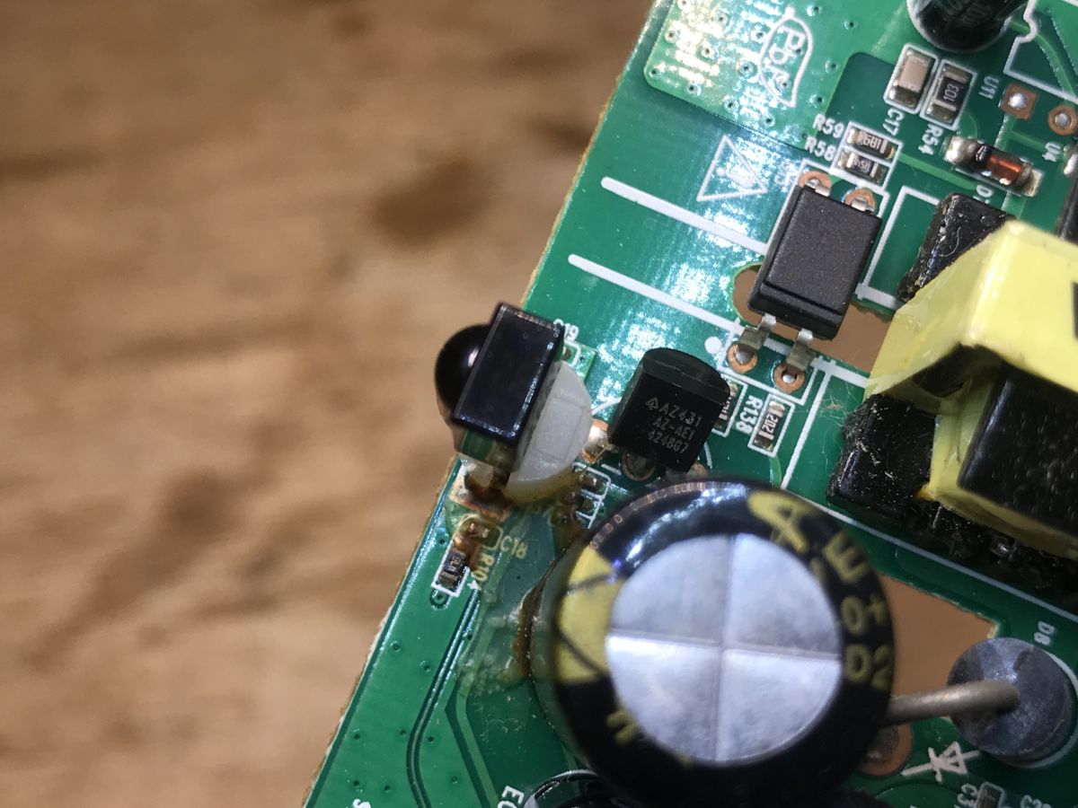

    Adjustable, nothing programmable there!
  • Requesting ALI M3801 pinout map for button keys
    #3 21772166
    Posts: 14791
    Rate: 12937
    As I was learning this term was normally in circulation, although in my post I used "
    Screenshot of a PDF search result from Warsaw University of Technology about TL431
    Close-up of AVT-2103 kit description: Programmable Zener diode.
    As you can see, opinions vary.
    Google search result for “regulowaną diodę zenera” showing AVT Zener diode PDF link
    Section of TL431 datasheet with typo highlighted in word Programmable
    Thanks for pointing out this interesting naming issue, but I'd still rather focus on the tuner itself. I found a project that compiles and starts on this CPU. I am just getting the buttons working.
    Debug messages with GPIO button states and boot log in RealTerm program
    Is there an ALI M3801 pinout map available somewhere? I know that on my copy the up/down keys (channels) are on 31 and 9.

    Whatever you call it, those who dabble in electronics will still be familiar with what a bug is and what you eat it with. :)
  • TL431 versus zener and synchronous rectifier comparison
    #5 21772652
    Posts: 14791
    Rate: 12937
    Indeed, the TL431 is a classic, although I also occasionally see an inferior solution (a simple Zener diode), and in newer PSRs (primary side regulation - as the name suggests, primary side regulation, without optocoupler and TL431). Similarly, I increasingly see a synchronous rectifier on the secondary side instead of the classic Schottky diodes (this is based on a MOSFET, and its resistance in the open state ensures less loss than would be the case on the voltage drop across the Schottky diode).

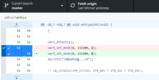

    Now I'm trying to start receiving data via the UART. I already thought I had the wrong pins, but no....
    Close-up of PCB with marked TX, RX, GND pins and USB signal lines.
    ALI M3801 pinout diagram showing UART TX on pin 50 and RX on pin 51
    As a test, I disabled the parity even mode for the UART in the code - I disabled parity completely and it is already receiving something:
    Code snippet showing UART parity setting changed in entry.c file
    Screenshot of RealTerm showing received UART data with serial transmission errors.
    I have looked at the information on the web about the CH341 and come to the conclusion that:
    - CH341 does not handle parity bits correctly
    - or, more precisely, data with the even bit are not sent correctly (the receiver rejects them - bad parity or no parity??)
    - but interestingly, when the device sends data with this bit to the CH341, the CH341 nevertheless receives it correctly, so in a way it misleads me by giving the impression that everything is ok....
    I guess I'll have to check this with a logic analyser.

    Then use a standard uart module on the FT232RL why bother.
    Greetings
    Michal

    Maybe it would be possible to make an SDR based on this, there was a similar project on the forum recently, but there only the head unit was used and the MCU was completely different externally added. I would also be interested in displaying something on HDMI.
    michas wrote:
    FT232RL
    I don't think I have this classic, although I would have to look for it. I have a CH341, a CP2102 and an MCP2221. The CP2102 didn't make it either, I don't know about the MCP2221.
    Two USB to TTL adapters with female header pins on a wooden surface Two USB to TTL converter modules, CP2102 and an unmarked one, on a wooden surface

    Maybe try the Putty program it has never failed me.
    Greetings
    Michal
  • Parity setting changed from even to none for UART reception
    #12 21773379
    Posts: 14791
    Rate: 12937
    Unfortunately, I'm afraid it's not a PC software issue - it's more a driver issue for the USB to UART converter in question.
    For now I've changed the mode in the code from even to none (no parity) and something can be received there, but I can see there's a long way to go with this. In the next topic I'll present exactly what I managed to fire off - what a project from Github, quite interesting overall.

    As for those partitions in flash - I found an ancient manual from 2011 - ALiEditor - see attachment.
    Screenshot of ALiEditor software showing channel list and satellite settings
    • 443650643-ALiEditor-User-Manual.pdf (521.3 KB) You must be logged in to download this attachment.
