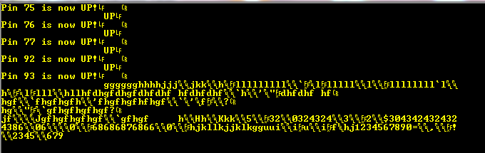

    Faster button scan
    I also wanted to improve the GPIO scan so that it displays what has changed. To start with I used the following code:
    Code: C / C++
    This didn't start - all I get is "Booting.... M" on the UART and silence. Perhaps the array didn't fit on the stack.
    So I optimised the code so that one pin is one bit:
    Code: C / C++
    Bingo - you can now see which pins are the buttons from the programs. Interestingly, the main on/off button is not seen:
    UART terminal screenshot showing GPIO pin state change messages.

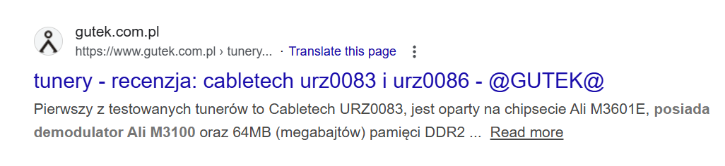

  • Pico Mini B pricing and AliExpress source question
    #4 21774969
    bulek01
    Posts: 337
    Help: 12
    Rate: 294
    Using things instead of throwing them away I think is nice, but yes unfortunately it is very time-consuming when there is no documentation and financially it is often not profitable if you look at it that way. To me, for example, it gives the satisfaction of using something instead of throwing it away.
    Cool that you were able to get so much going.
    piotr_go wrote:
    Come on, for 25PLN you can buy a tiny module (on RV1103) with better support.
    I have just been seeing these modules on aliexpress lately. I am considering whether to buy one for testing. My question is where can you buy them so cheaply?
    The Pico Mini B version with 64MB RAM and 128MB flash buying two pieces the cheapest I can find for 34zl/pc on ali.

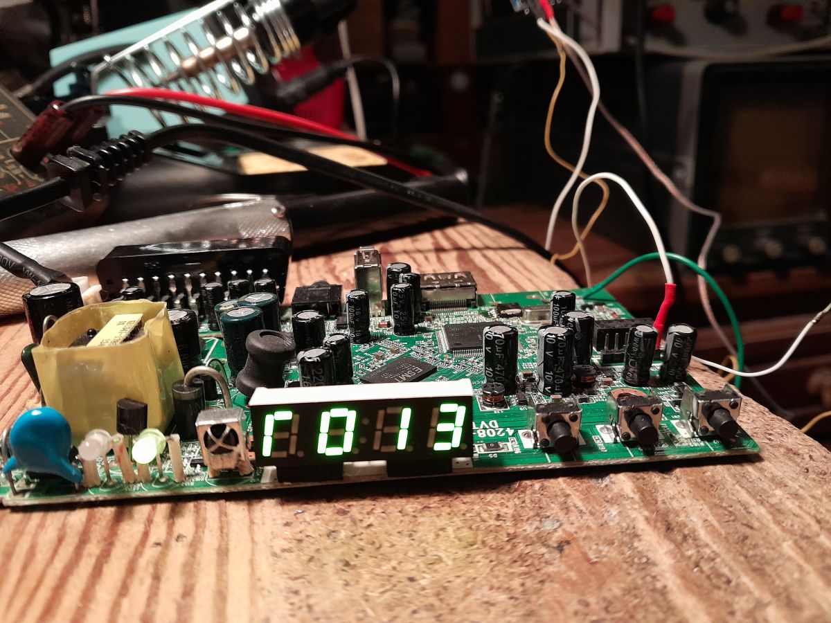

  • UART found on hidden test pads, boot pauses at ASH
    #7 21788762
    maciej_333
    Posts: 4226
    Help: 487
    Rate: 1594

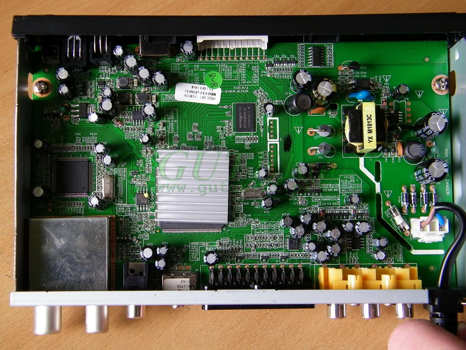

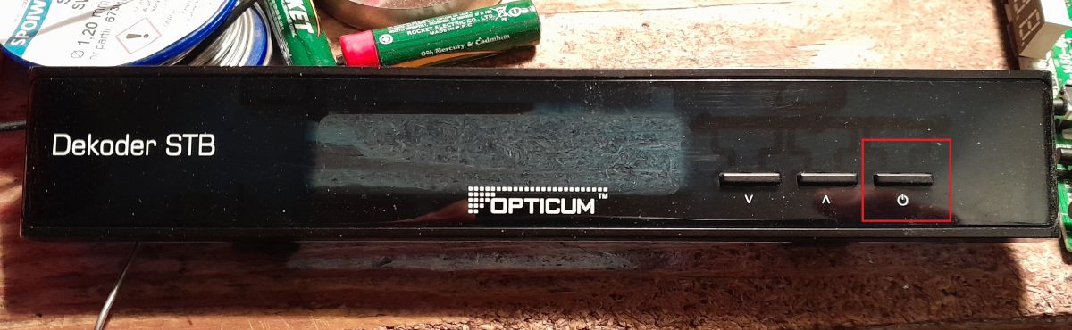

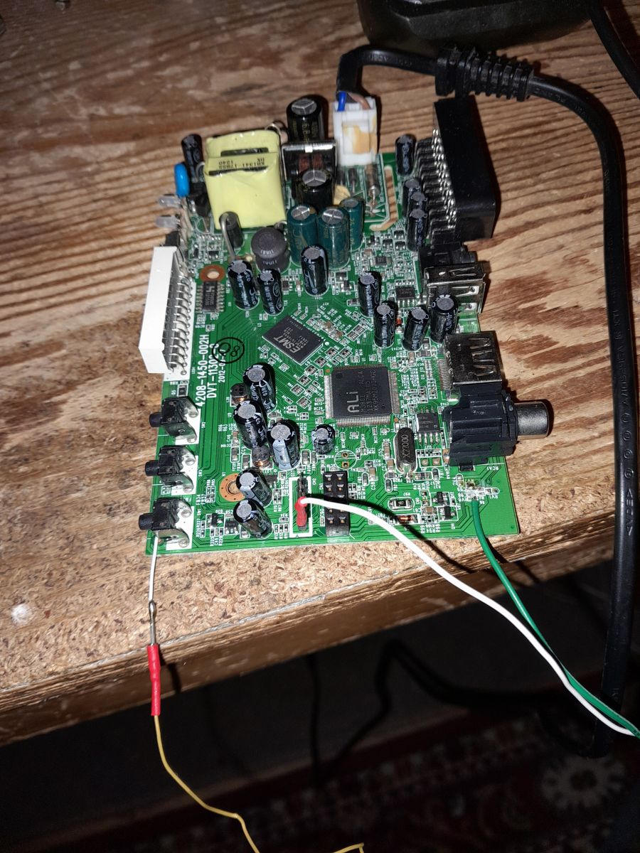

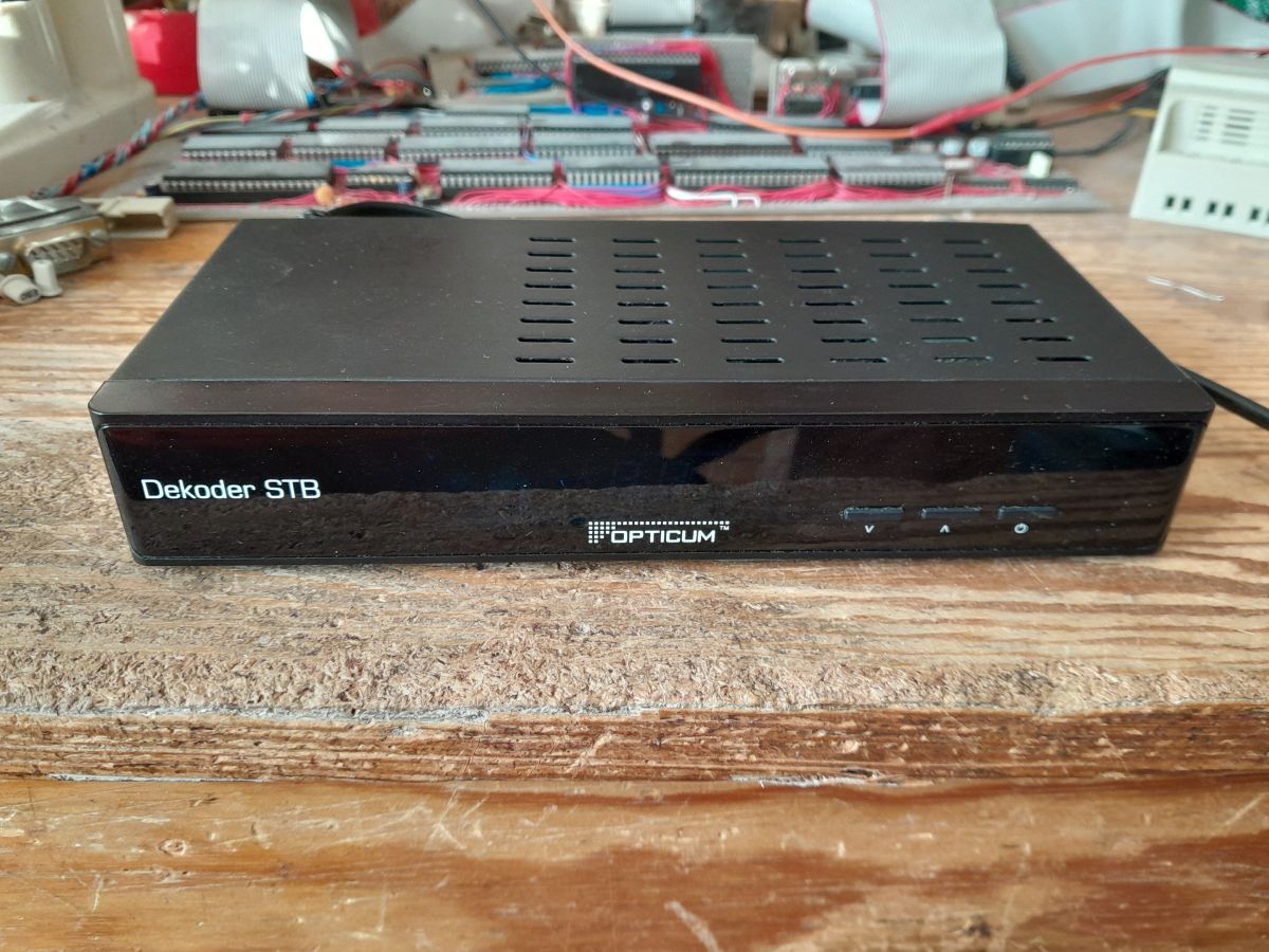

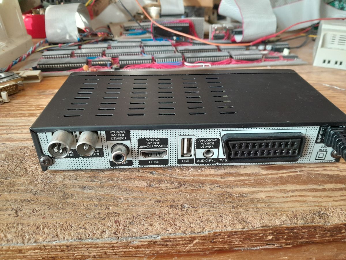

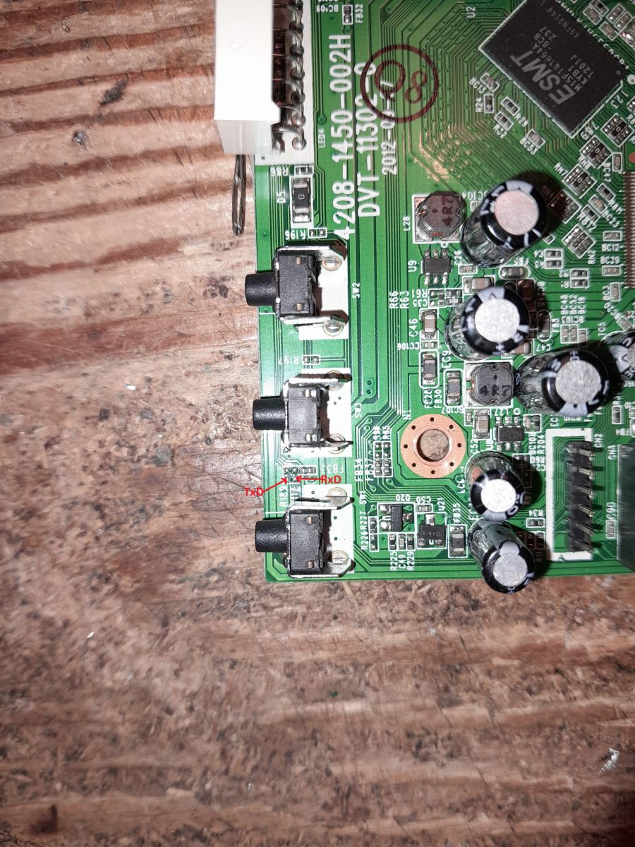

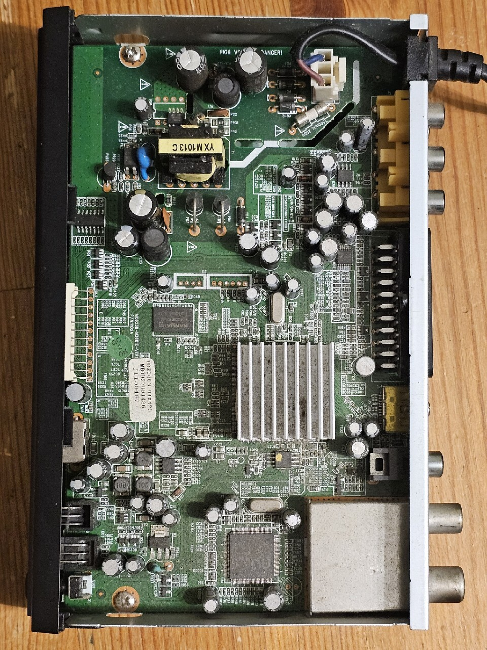

    Below are pictures of the Opticam HD N2 tuner on the M3801:
    DVB-T receiver Opticum HD N2 on a wooden work surface Rear panel of Opticum HD N2 DVB-T tuner showing multiple input/output ports Interior of DVB-T tuner showing PCB with various electronic components Bottom of DVB-T Opticum HD N2 set-top box with labels and ventilation holes Remote control for DVB-T tuner Opticum HD N2 on wooden surface
    Here, exactly, there is no connector that could be a UART. The CN2 connector is probably a JTAG. However, given that it is known on which pins the UART is, it is possible to determine where the paths go from it. TxD and RxD come here:
    PCB with ALi M3801 chip, HDMI port, and handwritten UART signal labels
    Both lines are pulled up to +5 V using 4.7 kΩ resistors. However, despite this, the voltage levels are +3.3 V. Furthermore, there are still capacitors between TxD and RxD and ground. A strange solution. Further analysis leads to the conclusion that the UART is also here:
    PCB fragment with TXD and RXD markings near vertically aligned jack sockets

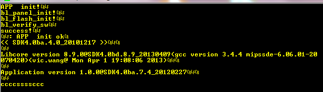

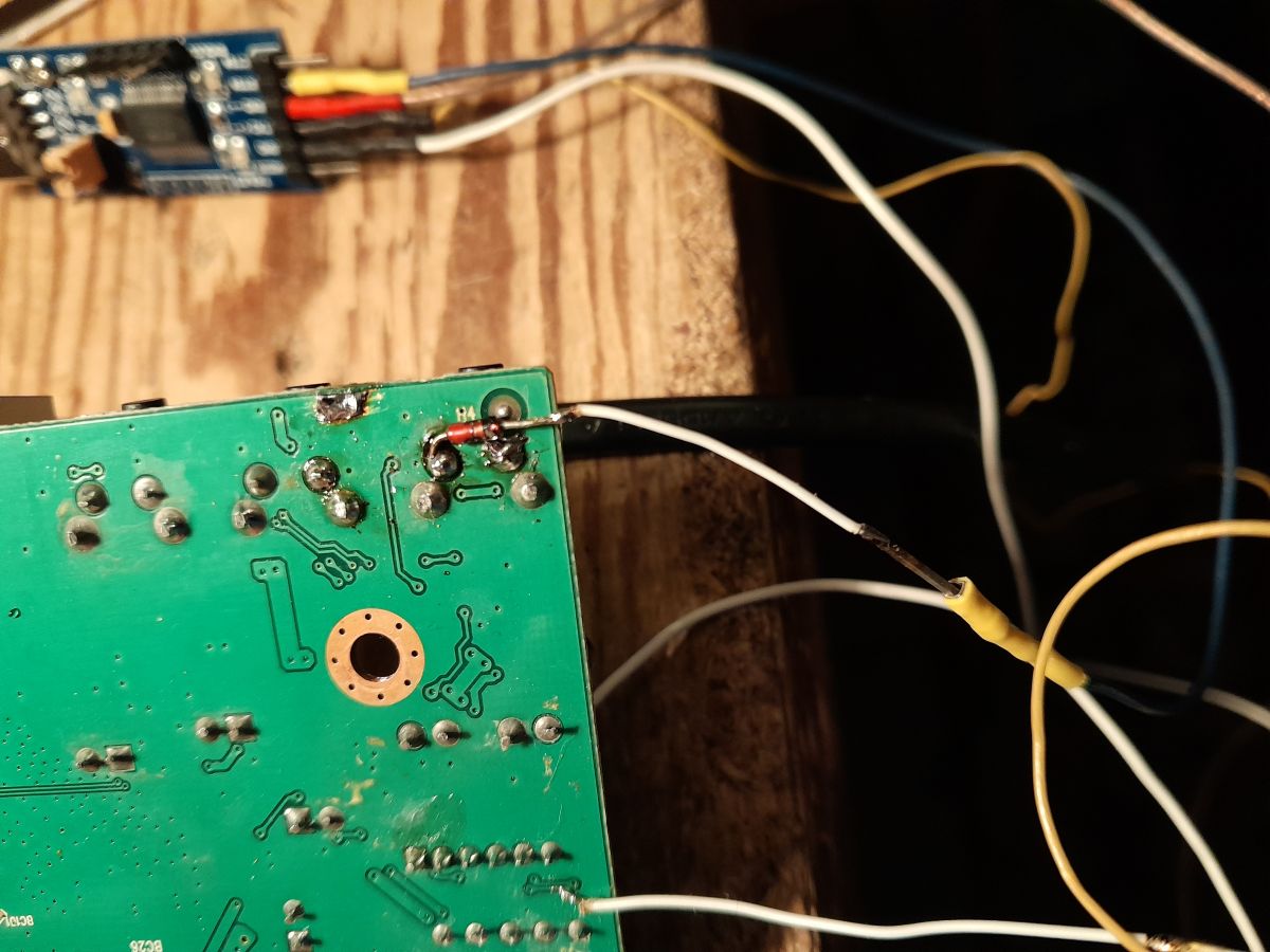

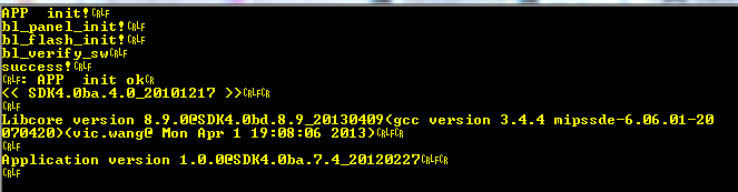

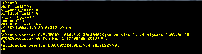

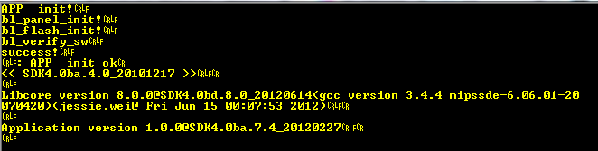

    I added wires to this and connected a converter to FT232:
    Opticum HD N2 tuner board with UART wires soldered to pin header

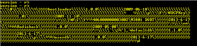

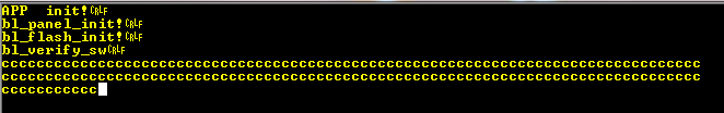

    After setting in a bit rate of 115200 b/s and 8E1 something can be received there:
    UART console screenshot showing SDK and application version messages

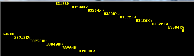

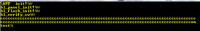

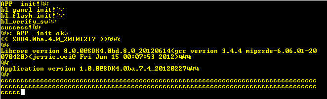

    No response to CR and attempt to start the tuner e.g. with some key held down. The only thing the tuner responds to is "c":
    UART terminal output with initialization messages and repeated c characters

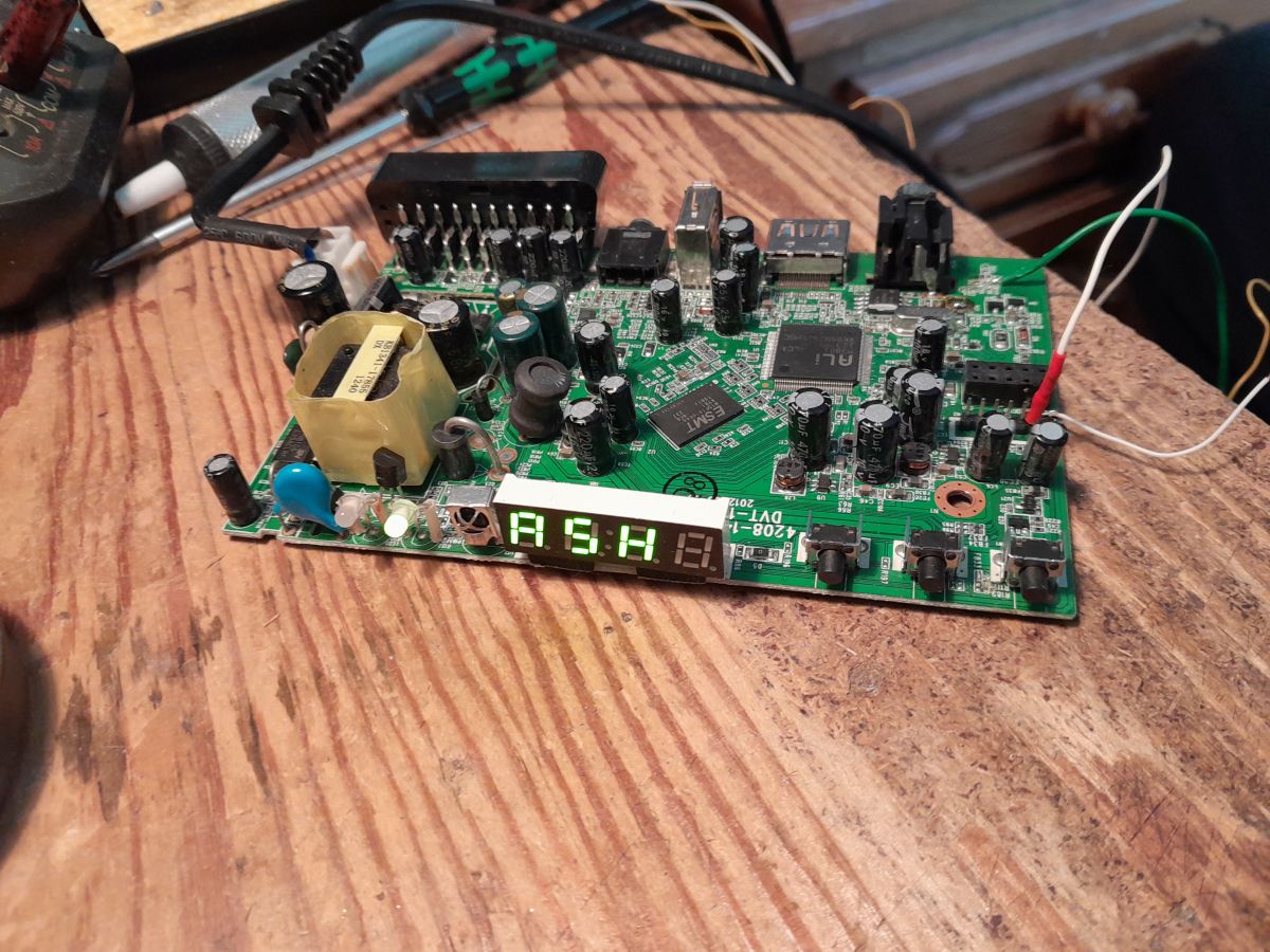

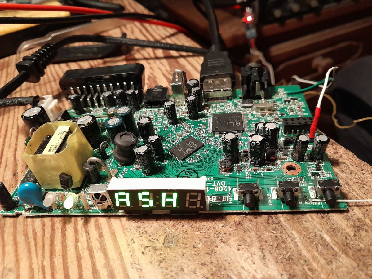

    If the tuner starts up with a constant "c" being sent, there is a boot pause:
    Terminal screenshot with boot messages and repeating letter c

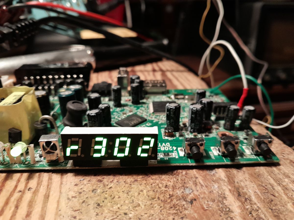

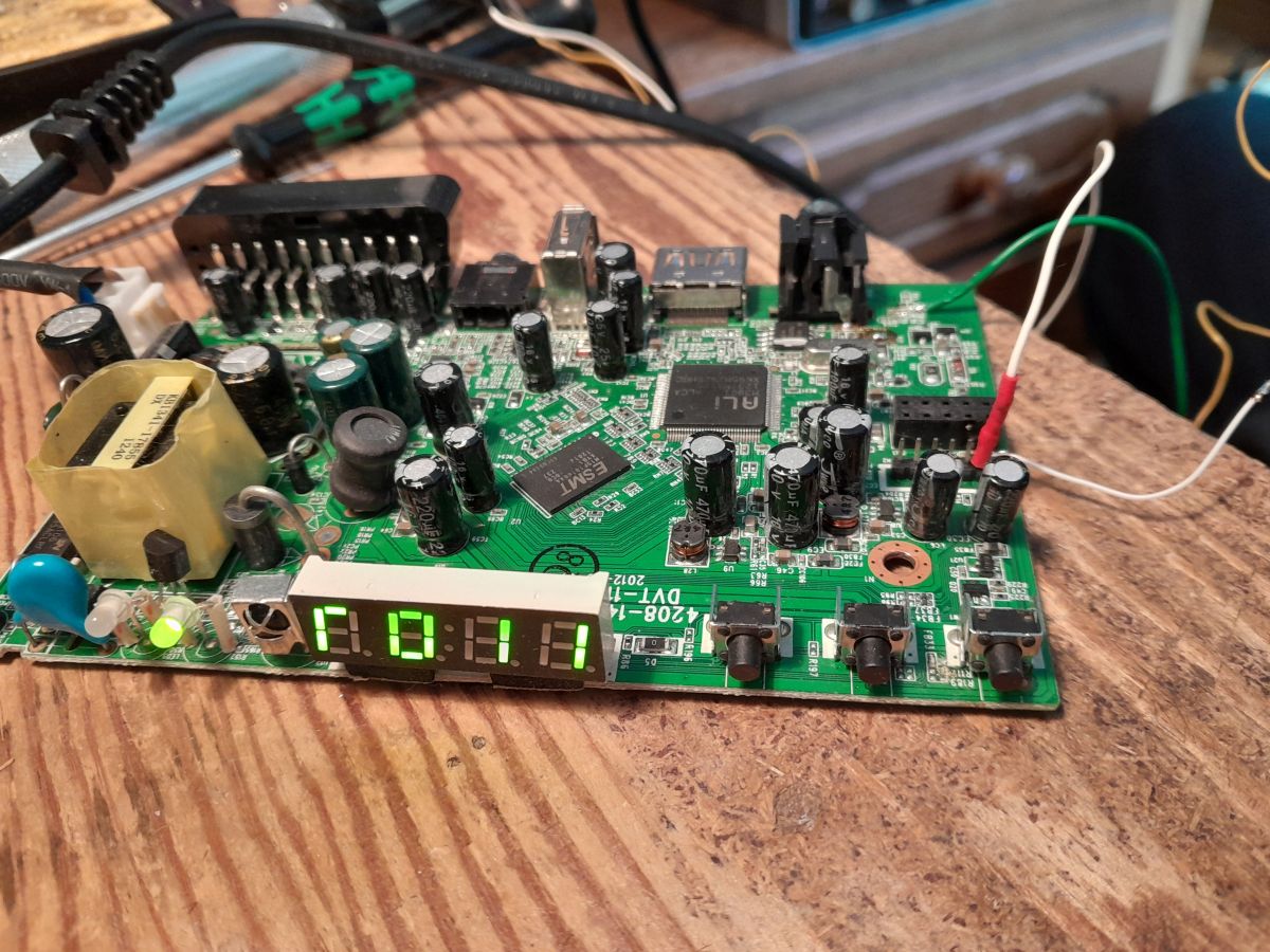

    The display then shows "ASH":
    Tuner circuit board with ASH on display and connected diagnostic wires.
    However, still no response to anything but "c".

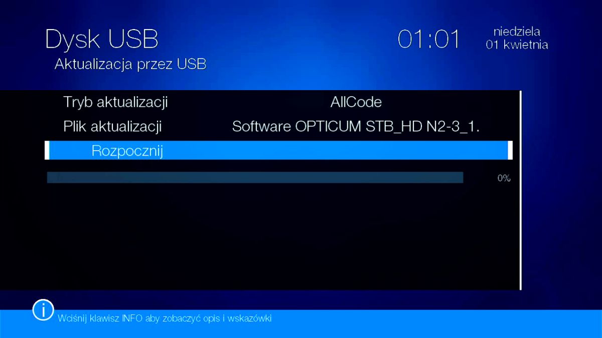

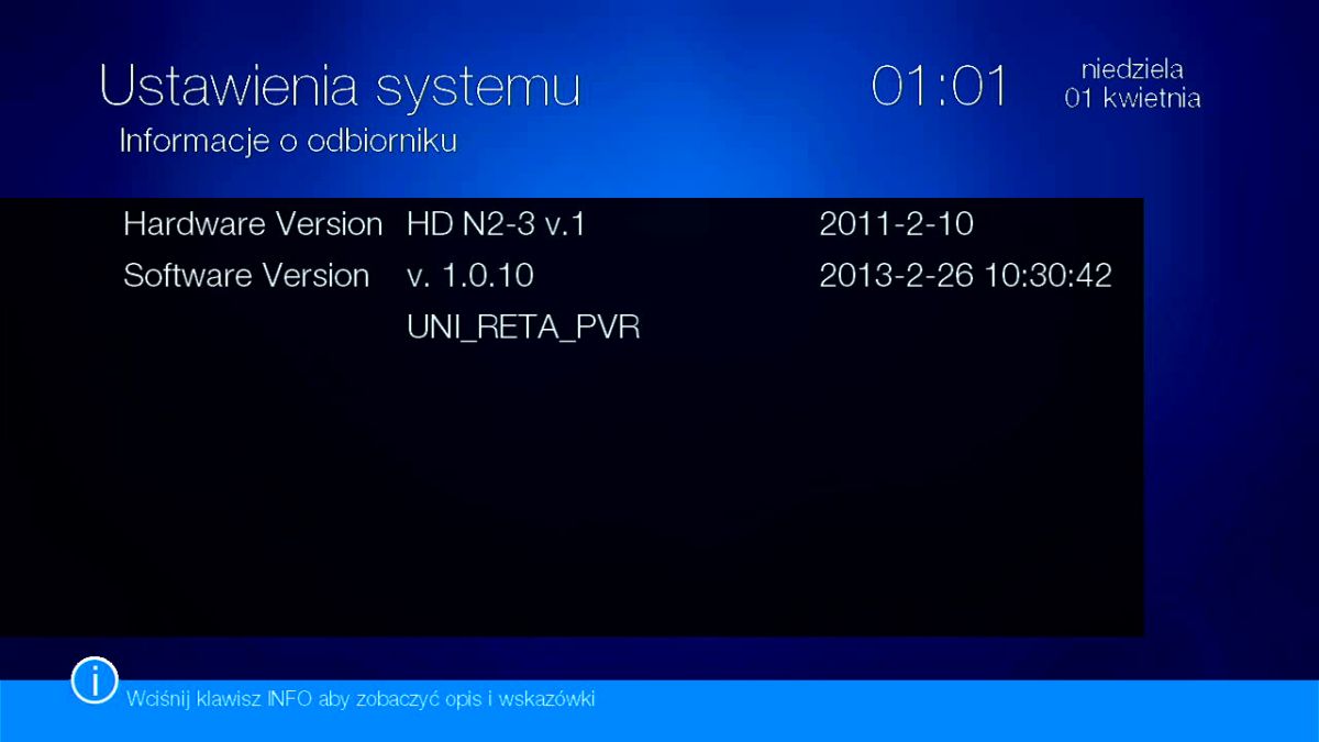

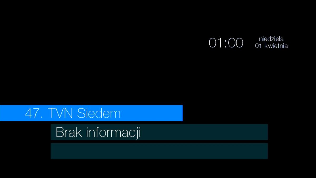

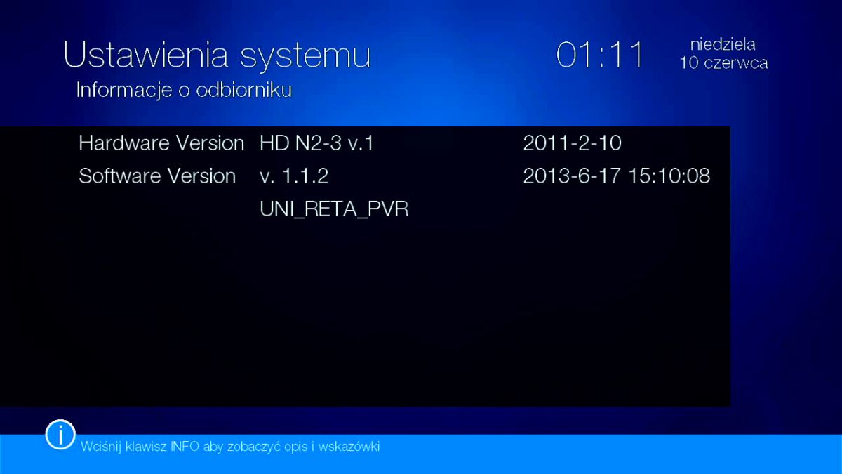

    There was no boot logo on HDMI at startup. After booting:
    Tuner interface showing channel TVN Siedem and No information message

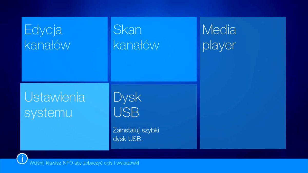

    Menu and tuner information:
    Main tuner menu with channel edit, scan, media player, system settings, and USB disk System settings screen of TV tuner showing hardware and software versions

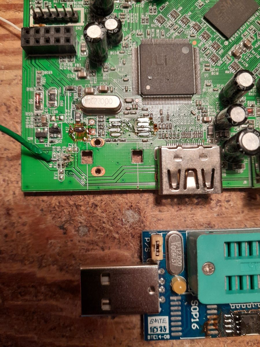

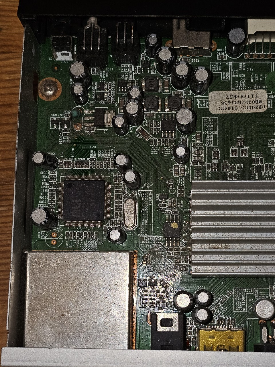

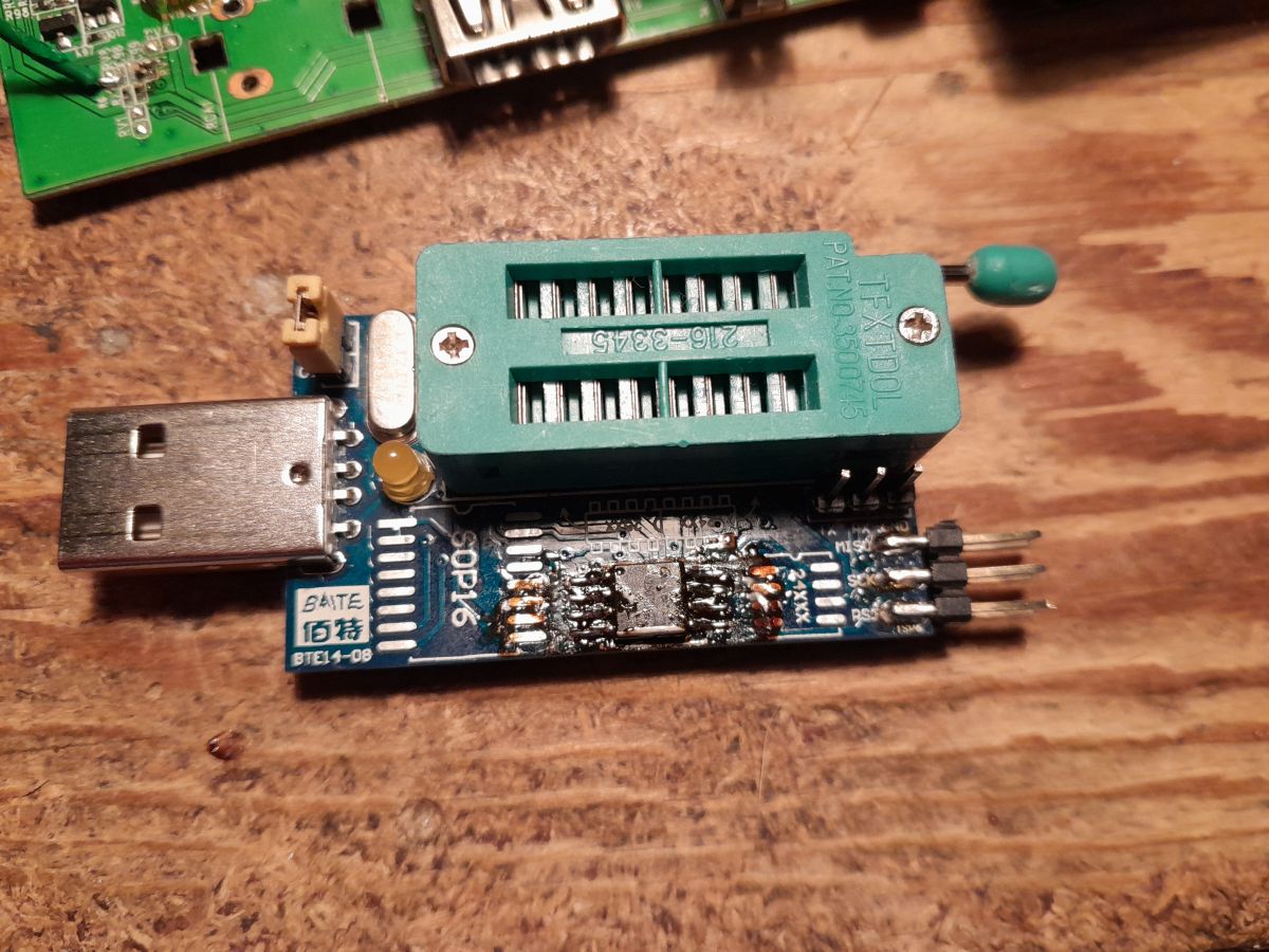

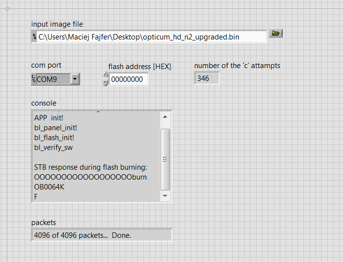

    I tried to read the flash memory through the programmer on the CH341 using the clip. The neoprogrammer detected this memory supposedly as 25Q32, but even then it did not detect the chip when trying to read it. For this attempt I desoldered the FB1 choke on the flash memory supply and had to desolder the RCA connector as there was no room for the clip. Unfortunately I don't have a hotair now to desolder the chip.
  • Bootloader sends `c` to enter standby mode
    #8 21792106
    Posts: 14649
    Help: 655
    Rate: 12660

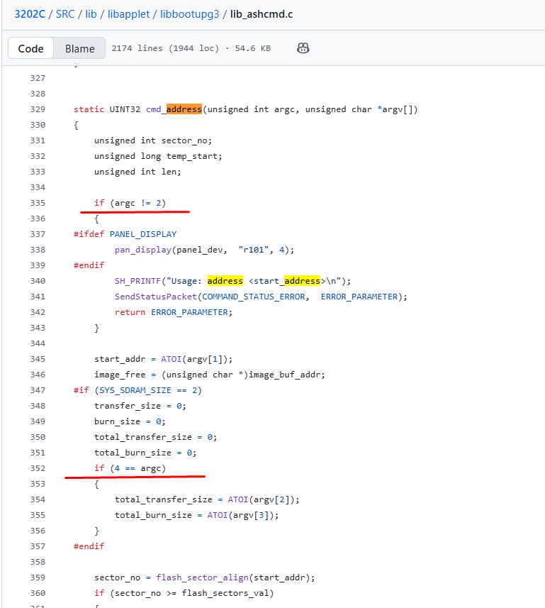

    How did you know about this sending 'c'? I at the time of writing the topic didn't know about it, I only recently read it in the code.
    BootLoader_clut8loader3bootloader.c
    Code: C / C++
    I can't see so far that 'c' does anything other than interrupt bootloader.
    And did you manage to rip the flash?
    I'm going to try and see if it's not possible to just re-solder this flash permanently onto the socket (whether the line length will allow) so as not to solder from scratch with each attempt.
    ASH I think the lib_ash_shell is?
    https://github.com/jinfeng-geeya/3202C/blob/b.../SRC/lib/libapplet/libbootupg3/lib_ash.c#L252
    Here you would have a list of commands in that case:
    https://github.com/jinfeng-geeya/3202C/blob/b...c2/SRC/lib/libapplet/libbootupg3/lib_ashcmd.c
    Code: C / C++

    #9 21792190
    maciej_333
    Posts: 4226
    Help: 487
    Rate: 1594
    How do you know about this sending 'c'?
    I determined this very primitively i.e. by trial and error. I pressed various keys in the terminal. The tuner only responded to 'c'. I tried sending many 'c's, because maybe some buffer will overflow and some variable will continue to be overwritten making something interesting happen. However, this does not happen. This would also be evident from the bit of code you inserted.
    I managed to rip the flash?
    I don't have a hot air right now. Desoldering the flash and then soldering it again without it is a mean pleasure. Such a small chip could still be removed without this.
    I'll see if there is a response to these commands.

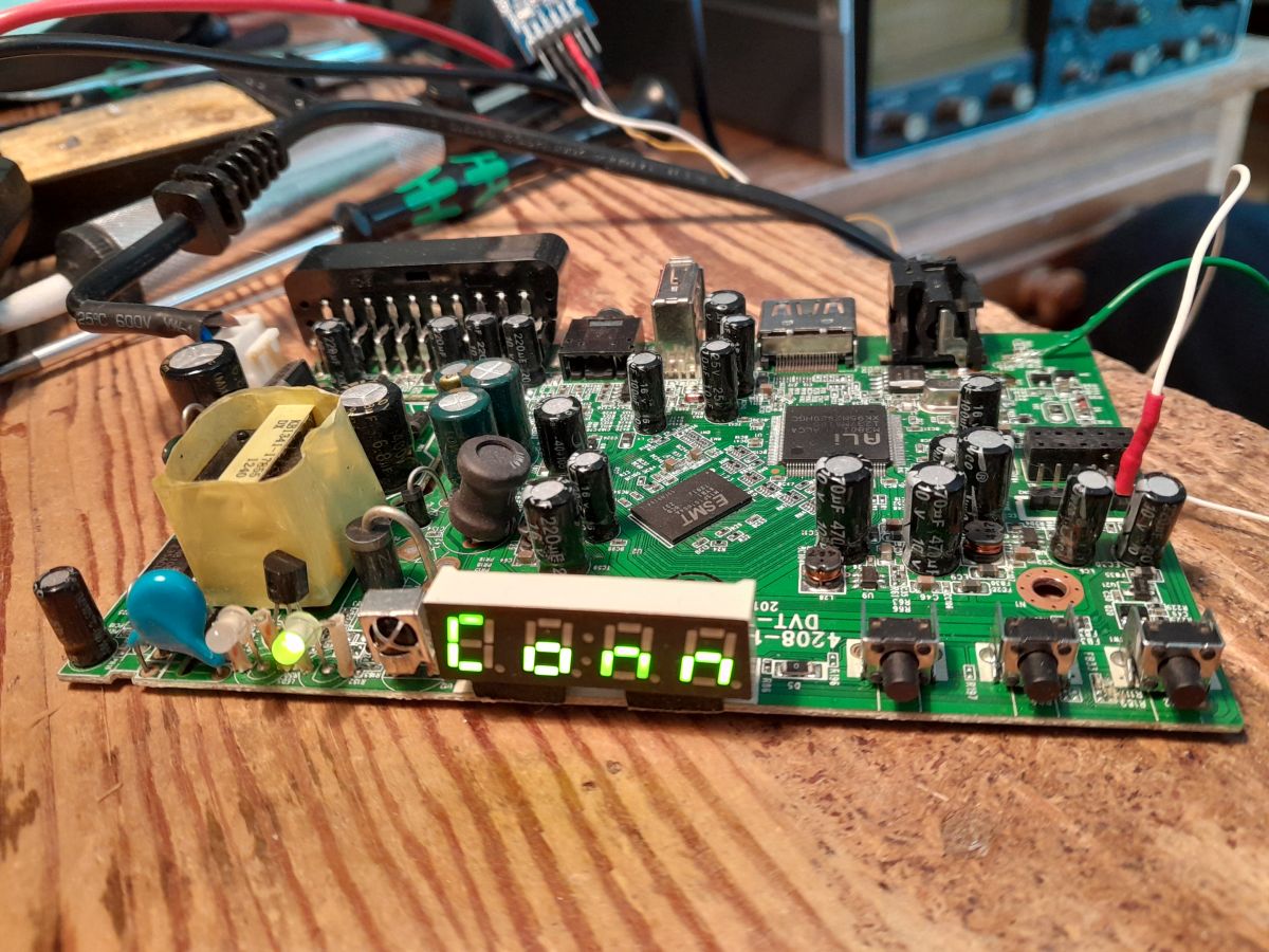

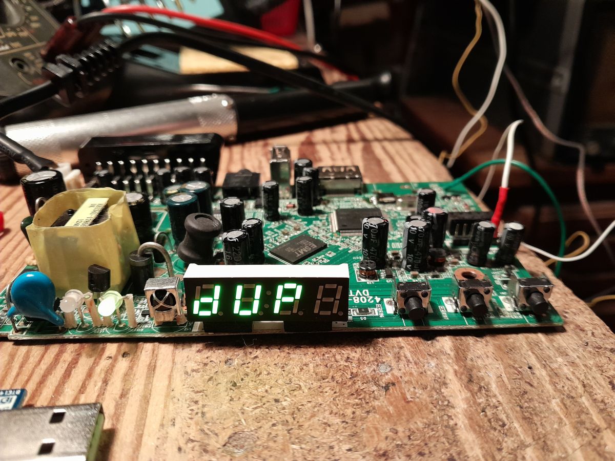

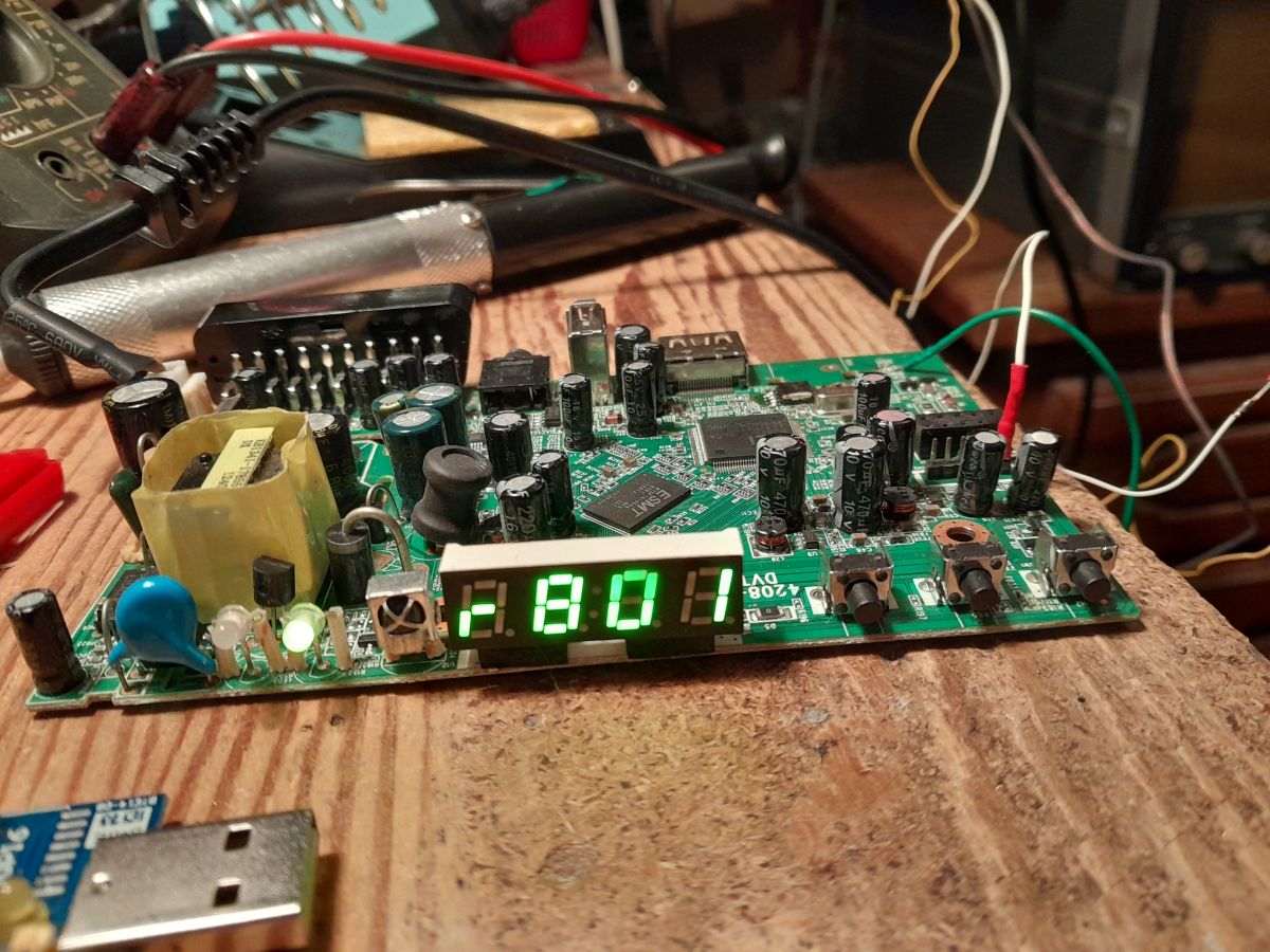

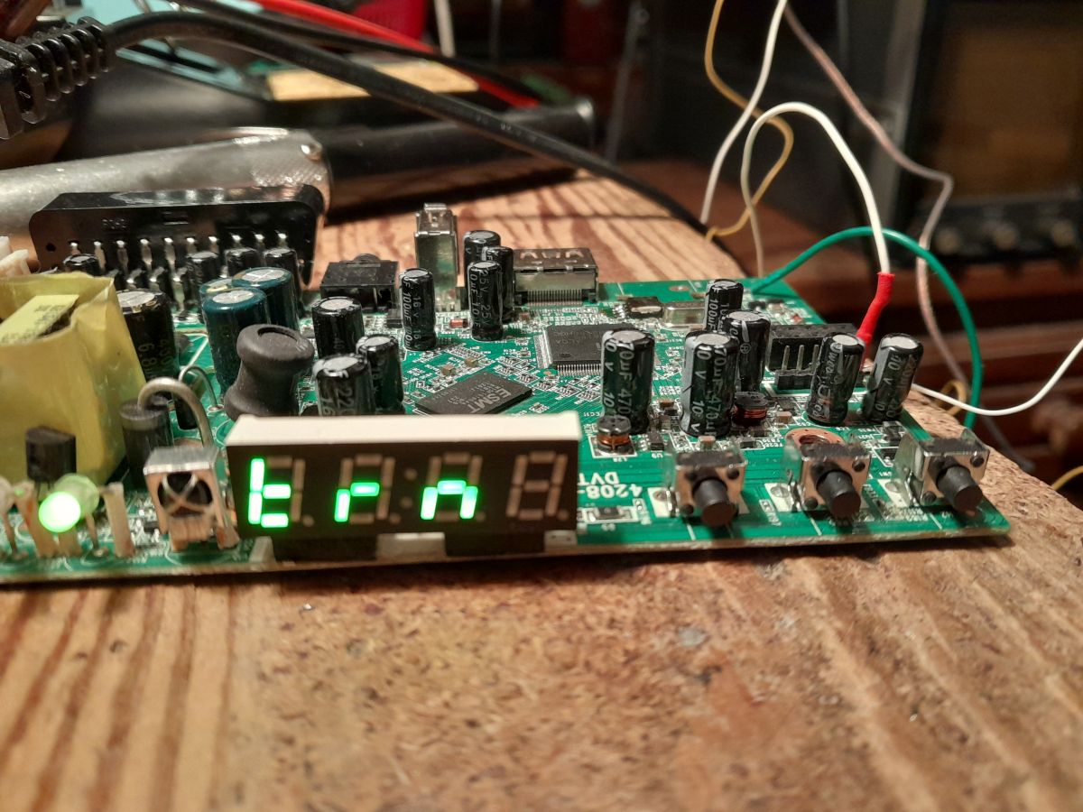

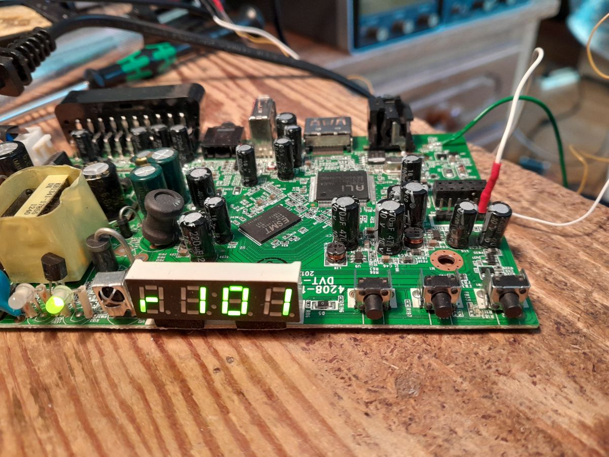

  • r101 display indicates comtest usage error
    #10 21792826
    maciej_333
    Posts: 4226
    Help: 487
    Rate: 1594

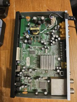

    I played around with these commands. Sending 'comtest' with or without a parameter after booting the application resets the tuner. It's a bit more interesting after suspending boot via 'c'. There is, of course, ASH at the start:
    Mainboard of a tuner with LED display showing ASH
    The 'comtest<CR>' can now be sent:
    Screenshot of terminal log with comtest command and system initialization
    The display will show:
    Close-up of a PCB with an LED display showing r101 and connected wires.
    Comtest command code:
    Code: C / C++
    Link
    From this it would appear that r101 in the display is some kind of error. The way the command is used in the console does not show up:
    Code: C / C++
    However, after sending e.g. "comtest 50<CR>" a little more happens:
    Terminal showing result of “comtest 50” with a yellow string of random characters
    As you can see there is already an echo. The display shows "Conn":
    Tuner PCB with LED display showing Conn
    It is difficult to tell what the <data_num> parameter means. Running comtest with a smaller <data_num> and sending that many characters does nothing. After sending any two characters, the display goes something like this:
    PCB of set-top box with display showing Conn and connected wires on wooden surface.
    Sending e.g. just "comtest<CR>" again does not change anything.
    No response to the rest of the commands. There are two versions of these commands in the code. There is no response to either. It appears from the code ( link ) that you can send in the older version "version - r<CR>", but that still doesn't work. The only thing that happens is some sort of response to "version<CR>;" sent as many times after comtest:
    Terminal screenshot with corrupted output after sending the version command to a tuner in debug mode
    However, it's more of a bug in the code.
    Also note that you need to send the command in one transfer (minimal delays between characters), not by pressing keys in the terminal. Without this, there is no response from the tuner.
    As you can see rather most of this code is cut out. Partly too, of course, the tuner's behaviour coincides with the code. I don't know if such an analysis is useful for anything.
    Added after 1 [hour] 8 [minutes]:
    I did the tuner update via flash drive: Link :
    Set-top box update screen showing 0% progress and Start option highlighted
    The software version is different:
    System settings screen showing hardware and software version information
    The console also shows this:
    Console display showing initialization messages and software version info
    Now the tuner responds to 's' and 'c':
    Screenshot of terminal showing system boot logs from tuner initialization
    In the case of 's' the echo is delayed. However, the 's' doesn't actually do anything. It does not pause the boot.
    It looks like the 'comtest' is not a UART test, it is sort of initialising the console. Currently after sending 'comtest 50<CR>' it works slightly better 'version - r<CR>':
    Terminal screenshot showing the output of the version -r command
    However, you have to send the command twice. The "reboot<CR>" also works:

    However, after this command the 'O' is sent first, then the rest. Also 'burn<CR>' works, but this command has to be called probably with some image loaded into RAM beforehand. This has corrupted the flash content. I therefore need to fix this. In the console there was something like this:
    Yellow BxxxxkW messages on black terminal screen, displayed diagonally
    It even deleted the bootloader.

    Surely the order is address, transfer, and burn?
    This code of theirs is weird:
    Source code snippet of cmd_address function with argument check highlighted
    And address did you set that burn something messed up?
    Code: C / C++
    Here they supposedly check.

    I have restarted this tuner. I found the batch for it: Link . The file that is in this topic is a bit too long. I don't know how it was read. However, after cutting the end in the hexeditor and thus shortening the file to 0x400000 B it is possible to program the memory. It turns out that the software version is identical to what it was with me originally. I then did an update with the file from Chomikuj and re-soldered the flash to read it. I am inserting the batch in the attachment. The update is very important because more commands work.
    Regarding the flash desoldering itself, you can easily deal with such a small chip by the so-called "short circuit" method:
    CH341A USB programmer with ZIF socket and flash chip on wooden surface PCB with electronic components and USB adapter for flash memory programming

    The implication is that initially there will be 'dup' on the display, then a flash length will be sent, there will be a wait for 'O', a dump will be sent and finally a CRC. While the dump is being sent, something is supposed to flash on the display.
    You have to send a comtest after boot pause, e.g. "comtest 50<CR>" and then "dump<CR>". The latter has to be sent several times until the display shows "dup":
    Circuit board with LED display showing dup
    In the console it might look like this:
    Screenshot of terminal window showing yellow dumpCR text on black background
    "NULL @ NULL NULL" is the size of the flash. However, it is not sent in text, but in binary. According to the ASCII code table, the '@' is 0x40. So the size is 0x00400000 B=4194304 (dec) B. This is the correct value. If the host sends something other than 'O', the display will show 'r801':

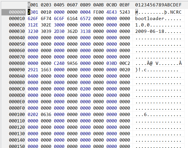

    In the terminal you have to set the write to file. The dump looks normal:
    Hex editor screen showing binary data with ASCII interpretation and bootloader info
    There is a CRC at the end:
    Hex editor screenshot showing flash memory end and CRC value 5FE3 2852
    This makes the file size 4 B larger than the flash size. It is difficult to say what the CRC algorithm is here. Initially, the CRC is initialised by 0xFFFFFFFFFF. This is some knowledge, because you still need to know the polynomial. It is not the common 0x04c11db7. However, this is not so important now.

    Regarding the flash programming via UART, proceed as follows:
    1. Hold boot by sending 'c' during boot.
    2. Send 'comtest 2<CR><CR><CR>. However, there should be a smaller parameter value and exceptionally two additional <CR>;. This ensures that the console works properly and you no longer need to send commands several times. So for "comtest 2<CR>" alone, the display is "Conn". Whereas after two additional <CR> there will be "R013":
    PCB board with display showing R013 and various electronic components
    3. Send "address 0<CR>". The parameter 0 here is the starting address in flash. However, it is aligned to the sector size, i.e. 4096 B (there are 4194303/4096=1024 sectors). For writing the whole flash it should be 0. If the address for the command "address <start_address><CR>" is larger than the flash size then there is an "r302" on the display and an 'E' is sent:
    Green LED display on PCB board shows error code r302.
    For the missing parameter it is 'r301':
    LED panel showing r301 on a PCB with electronics and connected wires
    With a valid address an 'O' will be sent and the display will remain what it was last. The address can be from 0 to 4194303.
    4. Send 'transfer <data_length><CR>'. Here <data_length> is the size of the image to be sent probably in bytes. The display will show 'trn' and an 'O' will initially be sent:
    PCB with display showing ERR4 and connected wires on a wooden surface.
    There is then a wait for data packets. When a packet fails to arrive or is erroneous an 'E' is sent. I was able to determine that the length of the packet must be 2048 B (in the code it is supposedly 1024). The packets must have a CRC at the end, and the packet length takes the CRC into account. For this command too, there can be errors "r501" and "r502" shown on the display. The only thing available is to send raw and uncompressed image data. Uploading everything as a compressed image using 7zip will not work. This is a pity, as it would make things a lot easier.
    5. Eventually, you have to send "burn<CR>" and then "reboot<CR>" to load the new image and run it.

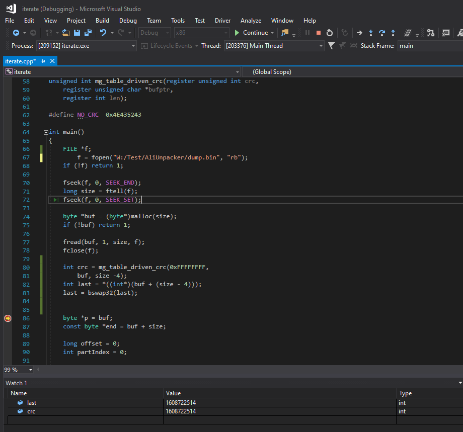

  • #16 21794337
    Posts: 14649
    Help: 655
    Rate: 12660

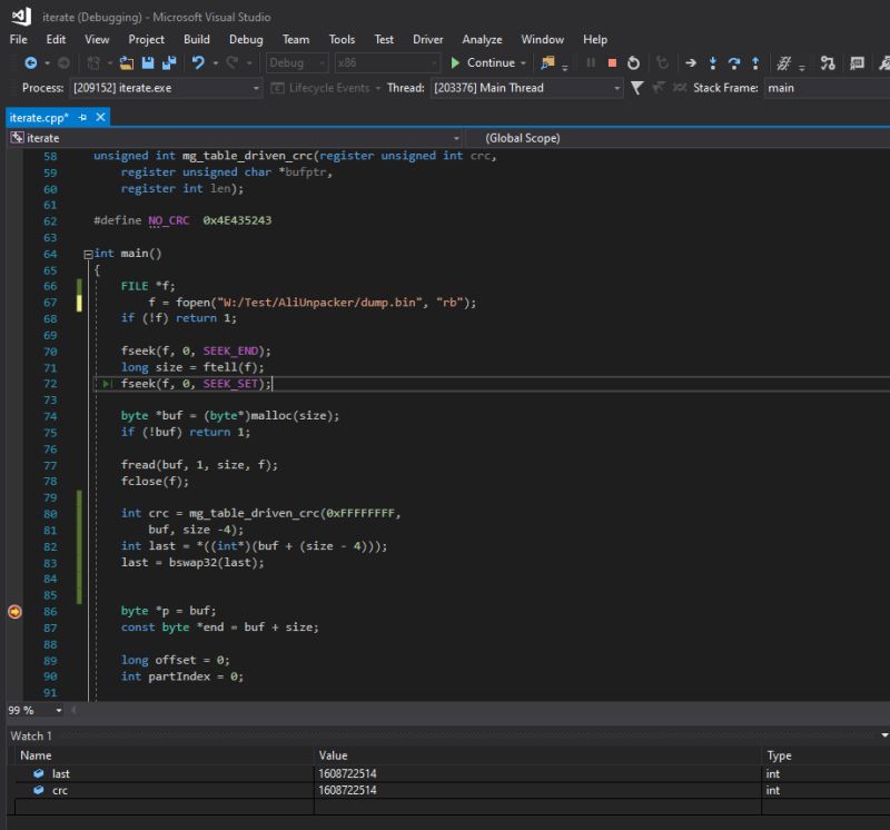

    It works for me, maybe you fell in the endiannes trap? Order of bytes.
    Visual Studio screenshot with C++ code and variables crc and last shown in debug view
    Here's the source code: https://github.com/openshwprojects/AliUnpacker

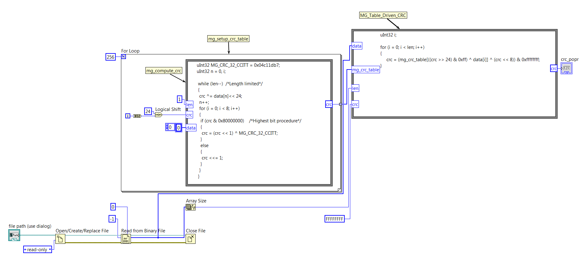

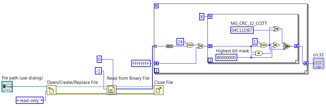

    Thanks for the suggestions. I want to do this in LabVIEW. I made a code like this:
    LabVIEW block diagram computing CRC32 from binary file data
    From the conditional compilation in your code, it would appear that this is the variant being used. Still need to think what is wrong here.
  • Missing bswap32 for big-endian CRCs
    #18 21794459
    Posts: 14649
    Help: 655
    Rate: 12660
    This is the first time I have seen such an environment. Why such a choice?
    It still seems to me that the bswap32 call is missing there
    Code: C / C++
    You have a little endian system on your computer, and those CRCs are probably in big endian.
  • LabVIEW CRC rewrite matches file values
    #19 21794579
    maciej_333
    Posts: 4226
    Help: 487
    Rate: 1594
    It's not a question of endianess. In LabVIEW I display the CRC as HEX (not decimal), so if I had the order wrong, it would be immediately apparent. For some reason the C code doesn't want to work properly there. So I have rewritten the "MG_Compute_CRC" function into graphical code:
    LabVIEW block diagram calculating CRC32 from a binary file
    Now the CRC calculated in LabVIEW is as follows:
    CRC32 value in hexadecimal format: 5FE32852 displayed in LabVIEW interface
    In the file it is the same:
    CRC values in hexadecimal format: 5FE3 and 2852
    I also ran this fast version of the CRC with the "MG_Table_Driven_CRC" function. It works correctly and actually faster, but I don't need it.
    Now it remains to encapsulate this in what is known as SUBVI, which is the LabVIEW equivalent of a function from C, and to do the rest of the code.
    For embedded systems I normally use the C language. Regarding the PC I now only use LabVIEW. I find it extremely convenient and readable. It is cool, especially if you need to do something with measurement equipment. The environment is second to none for measurement systems. However, it can also be treated as a 'normal' programming language.

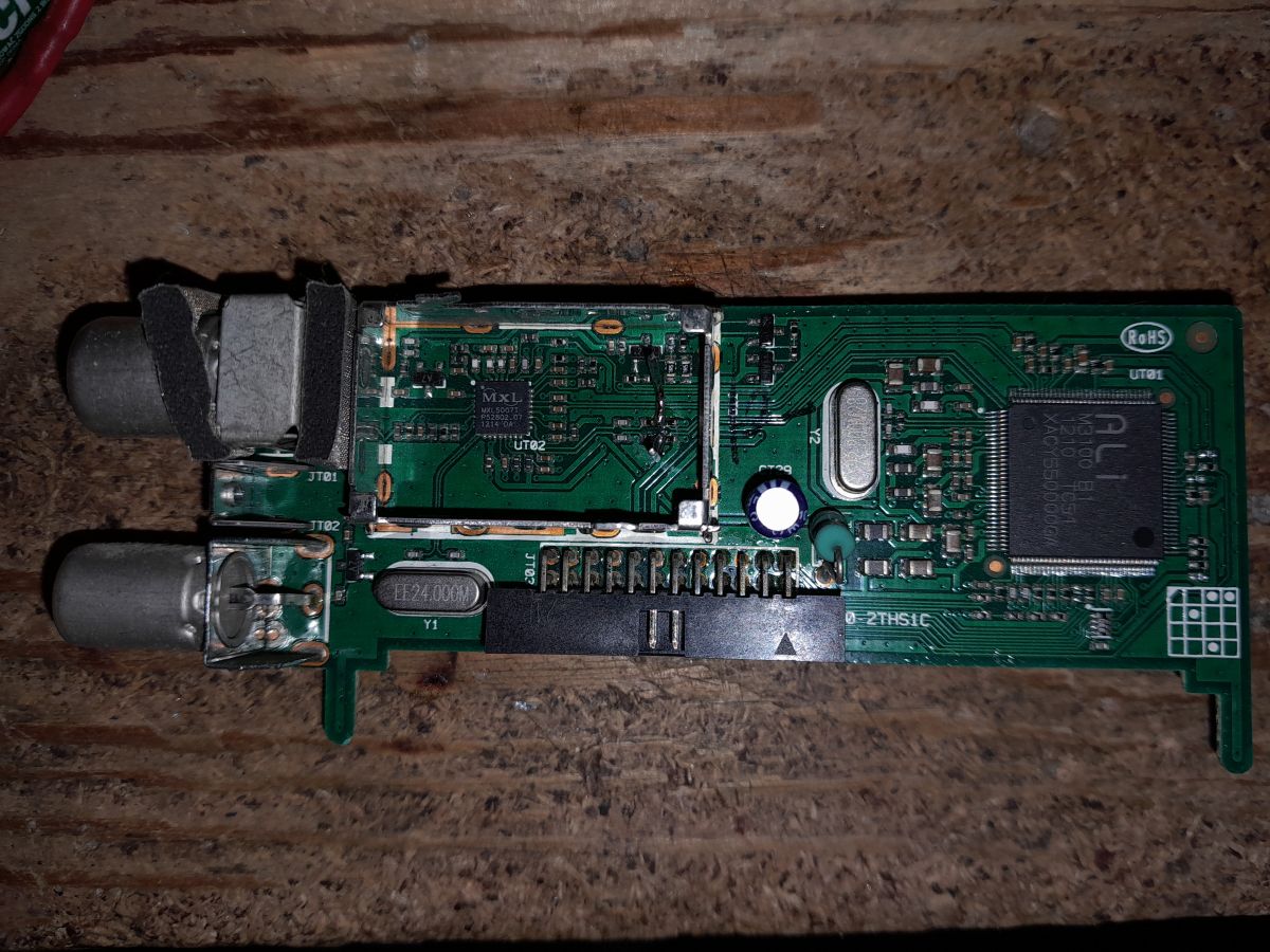

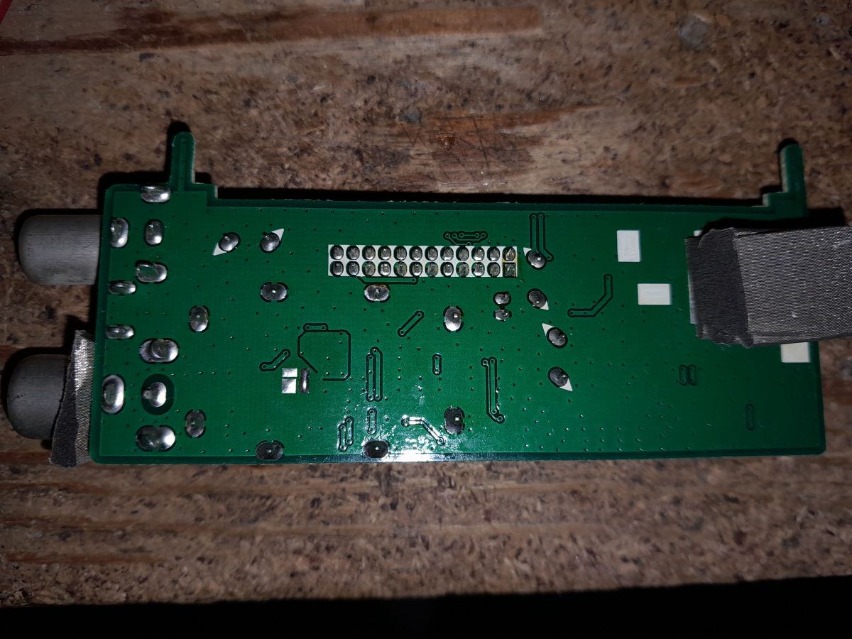

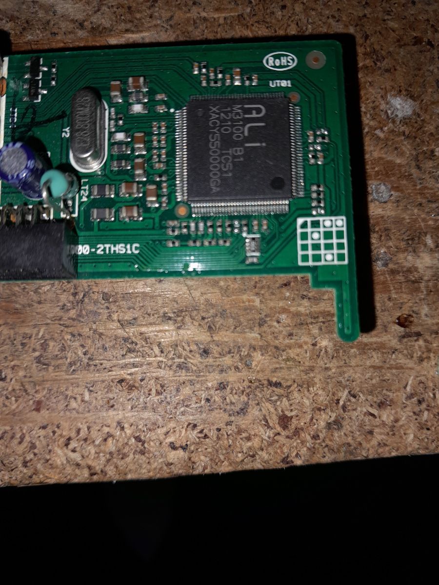

    Since we are talking about Ali chips here, I have an interesting head unit from a Ferguson Ariva 150 Combo DVB-S/DVB-T tuner:

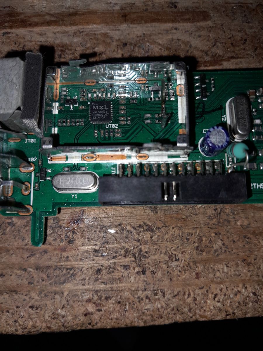

    DVB tuner module PCB with MxL5007T and M3100 chips visible Bottom view of PCB tuner module with RF connectors and solder pin rows
    There is a MxL5007T (head) that is well known to me:
    DVB tuner module with MxL5007T chip on PCB and visible connector and crystal oscillator.
    I have already run this chip with very good results in SDR. The second chip is the mysterious M3100 (demodulator):
    PCB with ALi M3100 B1 chip and various SMD components on a wood surface
    It probably outputs MPEG-TS. However, maybe it can be programmed to read the I and Q components via SPI. The problem is that I can find absolutely nothing about it. Have you perhaps even seen any code, schematic, pinout etc.?

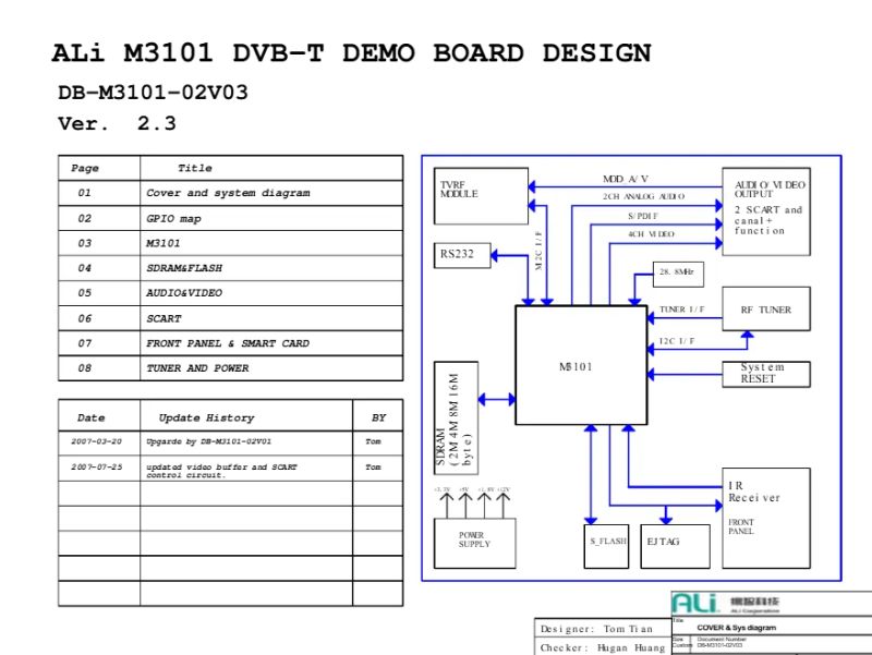

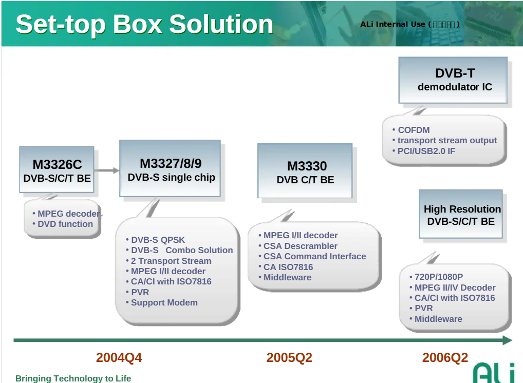

    I see no direct mention of the ALI M3100 so far. Only I have about the M3326C, M3327, M3328, M3329, M3330.
    Block diagram of ALi Set-top Box chips including M3326C, M3327/8/9, M3330 and others
    M3101 I have. First page:
    Block diagram of ALi M3101 demo board showing labeled system component connections
    The rest in the appendix.
    I haven't checked thoroughly so far, but maybe it's a different version of this circuit?
    But I don't think it's that, because it's the main processor.
    • 585046784-ALI-M3101-DVB-T.pdf (143.84 KB) You must be logged in to download this attachment.
  • Cabletech URZ0083 uses an M3100 chip
    #23 21795327
    Posts: 14649
    Help: 655
    Rate: 12660

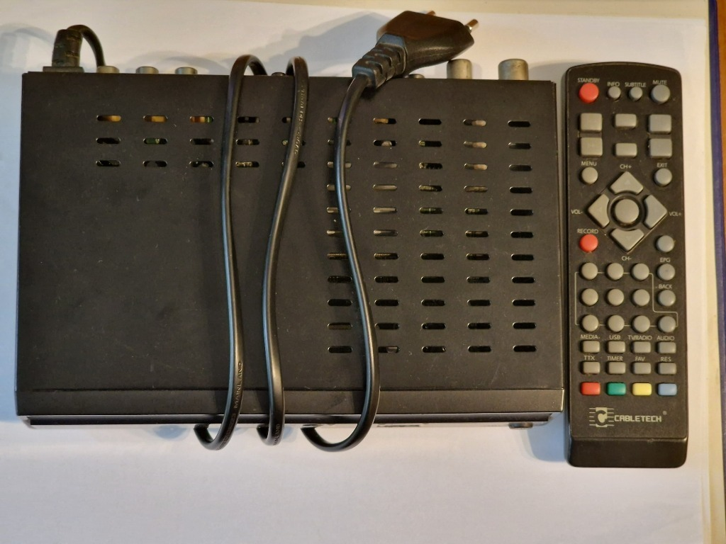

    I know where I have seen M3100. These are pics from someone outside the forum:
    Cabletech URZ0083 DVB-T decoder
    Cabletech URZ0083 DVB-T set-top box with remote and power cord
    Rear panel of Cabletech URZ0083 set-top box with AV ports and power input
    Interior of Cabletech URZ0083 DVB-T decoder showing main circuit board
    Close-up view of Cabletech URZ0083 DVB-T decoder motherboard
    Interior of Cabletech URZ0083 DVB-T decoder with visible electronic components
    [url=https://obrazki.elektroda.pl/7240899100_1767232358.png]Mainboard of decoder with MC6238-M3601E label and aluminum heatsink
    [/url]

    Google search result showing review of Cabletech tuners on gutek.com.pl website
    https://www.gutek.com.pl/tunery_cabletech_urz0083_urz0086_recenzja.htm
    Inside of a digital TV tuner showing green PCB with electronic components
    Perhaps the author - @@GUTEK@ ? - knows something more.
  • UART flash writer with automatic packet padding and reboot
    #26 21797046
    maciej_333
    Posts: 4226
    Help: 487
    Rate: 1594

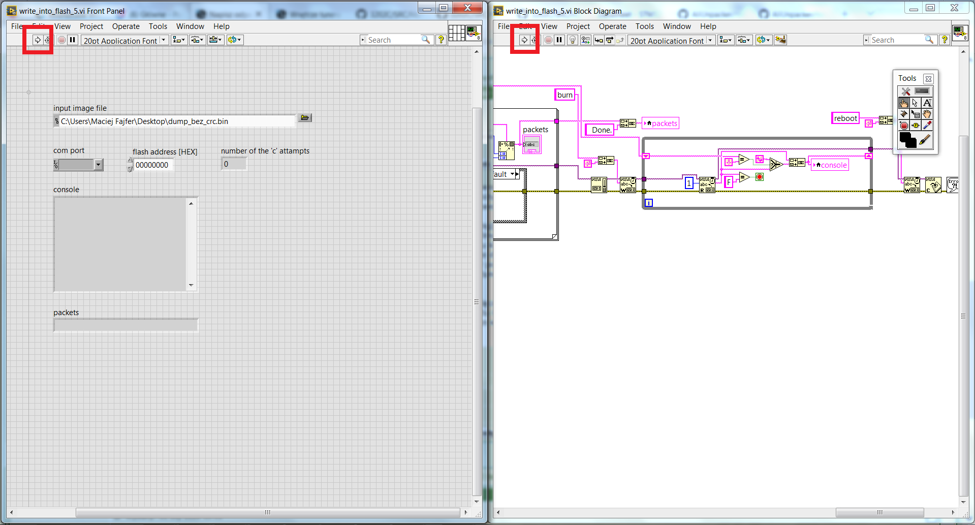

    I have already made a preliminary version of the flash writing program via UART in LabVIEW. It is generally in line with the description and observations I gave earlier. Regarding the command "burn<CR>", it should be noted that a write probably only occurs if the inserted image is different from the current one. Furthermore, this command does not necessarily feel like writing to certain flash locations. It does not write to those places where all settings such as volume, channel list etc. are present.
    Below is the program code in LabVIEW:
    LabVIEW block diagram for flash memory writing via UART interface

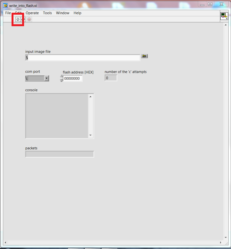

    This is the so-called Block Diagram, a kind of source code. No subroutines (SUBVI, something like functions) here, of course. The user panel (the so-called Front Panel) looks like this:
    LabVIEW user panel for flashing firmware image over UART to flash memory
    The programme is completely automatic. It aligns the image size itself to the packets that are written to the flash. The completion is done by 0xFF. In addition, there is a reboot after writing. I also figured out how to reset the tuner when there is an application loaded. There are no M3801 leads, so not even sure where any RST/NRST style lead is. However, you can use the STAND-BY key that is on the remote control board and thus on the front panel:
    Front panel of Opticum STB decoder with power button highlighted in red
    Generally it comes out that this key is connected directly to some GPIO/processor interrupt line. The rising/falling edge turns the device on or off. Hence it occurred to me to primitively control this line, e.g. with an RTS on a USB<->UART converter. So such a solution was created:
    Hand-drawn schematic of tuner connected to USB–UART FT232 module
    I have used an additional 'splitter' diode here. This ensures that when there is a high level on the RTS line, while the SW1 key is pressed, there will be no short circuit on the RTS. I have not checked if there is any external pull-up resistor for SW1. As you can see by controlling RTS appropriately you can reset the tuner when the application is loaded.
    The tuner board during testing:
    Tuner circuit board with USB-UART module and multimeter on workbench
    Added diode:
    PCB with soldered wires and visible solder joints.
    To run the program, simply switch on the tuner with the USB<->UART converter module attached, select the image file, COM port number and address in flash. Then simply run the program by clicking Run in LabVIEW (on any of the panels):
    User interface and block diagram of a LabVIEW program for flashing data.
    So far it seems to be working somehow. Uploading small images is quite fast. Could you insert some of your compiled image with a description of where in the flash (offset) it should be uploaded? This would allow me to do a final test.
    Then I will compile it and make the program available with the graphic code. It will not be such a small tool. There is still something to be installed there. However, you don't need a LabVIEW licence for this. You can also install LabVIEW Community Edition which is free (same functionality, no commercial projects possible).

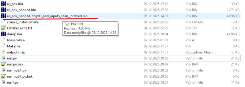

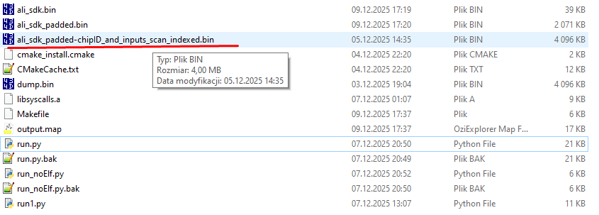

    The solution presented in the first post is uploaded to address 0x0 and replaces the entire factory flash, so we have yet to determine where after the bootloader the jump is made or if there is a command to make the jump to a given offset.
    I have one batch saved, it is completed with 0x00 to the size of the 4MB batch, but can be trimmed.
    Folder with BIN files and Python scripts, selected 4 MB BIN file highlighted
    This is the programme from the paragraph "Better button scan". I won't give 100% certainty that it's ok, but I've almost certainly saved it to myself as already tested.
    If you need to offload the tool to pure C then I can help, as long as I understand how it works in LabView.
    • ali_sdk_padded-chipID_and_inputs_scan_indexed.zip (18.94 KB) You must be logged in to download this attachment.

    I uploaded via UART and my program in LabVIEW your example. I shortened the file, of course, so as not to wait for more than 4 MB to be uploaded. Generally it works, but since the bootloader was overwritten, the command "reboot<CR>" somehow didn't work. A bit strange, actually, as everything was in RAM after all. So the power had to be switched off and then on again.
    When running this example, you can pick up something like this:
    Booting...
    Main function
    stack end: 82000000
    stack start: 82008000
    heap start: 8100093c
    heap end: 8100893c
    cause: 9000004c
    x: 1.230000 y: 1.250000
    result: 25.729999
    cause: 9000004c
    chip id raw: 3811
    UP
    Pin 9 is now UP!
    UP
    Pin 12 is now UP!
    UP
    Pin 13 is now UP!
    UP
    Pin 14 is now UP!
    UP
    Pin 21 is now UP!
    UP
    Pin 23 is now UP!
    UP
    Pin 24 is now UP!
    UP
    Pin 25 is now UP!
    UP
    Pin 26 is now UP!
    UP
    Pin 27 is now UP!
    UP
    Pin 28 is now UP!
    UP
    Pin 29 is now UP!
    UP
    Pin 31 is now UP!
    UP
    Pin 32 is now UP!
    UP
    Pin 33 is now UP!
    UP
    Pin 34 is now UP!
    UP
    Pin 35 is now UP!
    UP
    Pin 36 is now UP!
    UP
    Pin 37 is now UP!
    UP
    Pin 38 is now UP!
    UP
    Pin 39 is now UP!
    UP
    Pin 43 is now UP!
    UP
    Pin 44 is now UP!
    UP
    Pin 45 is now UP!
    UP
    Pin 46 is now UP!
    UP
    Pin 50 is now UP!
    UP
    Pin 51 is now UP!
    UP
    Pin 52 is now UP!
    UP
    Pin 53 is now UP!
    UP
    Pin 54 is now UP!
    UP
    Pin 56 is now UP!
    UP
    Pin 59 is now UP!
    UP
    Pin 60 is now UP!
    UP
    Pin 61 is now UP!
    UP
    Pin 62 is now UP!
    UP
    Pin 63 is now UP!
    UP
    Pin 64 is now UP!
    UP
    Pin 72 is now UP!
    UP
    Pin 73 is now UP!
    UP
    Pin 75 is now UP!
    UP
    Pin 76 is now UP!
    UP
    Pin 77 is now UP!
    UP
    Pin 92 is now UP!
    UP
    Pin 93 is now UP!
    No response to the keys on the board. Then the echo works (sometimes only after some time after start-up):

    However, you have to send characters very slowly, otherwise bushes come out and there are erroneous frames. So the problem with the stability of the UART operation is rather not on the converter side. I have an FTDI and it is not good either.
    In the attachment I insert the sources in LabVIEW (*.VI files) and the compiled program (builds directory). Pre-install the so called Runtime version 2015: Link and NI VISA (drivers for RS232, USB, ethernet, GPIB etc): Link (version 15.5). When you start the application, you select the COM port number, the image file and enter the address (offset). The address should be aligned to the flash sector size (4096 B). From the code, if this is not done, the bootloader will align it anyway. However, the code will then not be inserted where it needs to be. So, the address should be an integer multiple of 4096. Next, it is enough to have the tuner connected (running and with the application loaded) according to the scheme above. Finally click Run (single start, not continuous):
    How to compile and run custom firmware for ALI M3801 and other chips from tuners?
    Eventually you have to wait for the image to be uploaded and reboot.
    I don't know altogether if it's worth it. Now as if you already know exactly where the application is in flash and how to compress it before loading, this could also be added to LabVIEW.
    • ali_labview.rar (500.44 KB) You must be logged in to download this attachment.

    maciej_333 wrote:
    However, you have to send characters very slowly, otherwise bushes come out and there are erroneous frames. So the problem with the stability of the UART operation is not likely to lie with the converter.
    I wrote about this in the first post - the mini SDK I presented here has no UART interrupt support and the UART relies on polling. By the way, the author of the SDK also knows about the problems himself, I talked to him on GitHub. This means that embracing the factory bootloader and a workflow for uploading the batch conveniently would help a lot in further work.
    maciej_333 wrote:
    Generally works, but since the bootloader was overwritten, the command "reboot<CR>" somehow didn't work.
    Can you elaborate on this? I was thinking of trying to upload to some offset that the original bootloader jumps to, so that you can use the original bootloader to upload new programs. Did you just upload to 0x0?
  • Reboot command still works after bootloader overwrite

    maciej_333 wrote:
    Generally works, but since the bootloader was overwritten, the "reboot" command somehow didn't work.
    I have currently uploaded this to offset 0x00000000. The bootloader has of course been overwritten. However, even after writing to flash it was still working after all what was in the RAM loaded beforehand. Hence, it seems that the "reboot" command should work this one more time. Presumably it is just a reboot, not a simple CPU reset, and hence the effect.
    Ultimately, of course, the program would be loaded with some sort of offset so as not to overwrite the bootloader. For that, however, you need to keep the file format as it is in flash and there is still a lot to learn.
