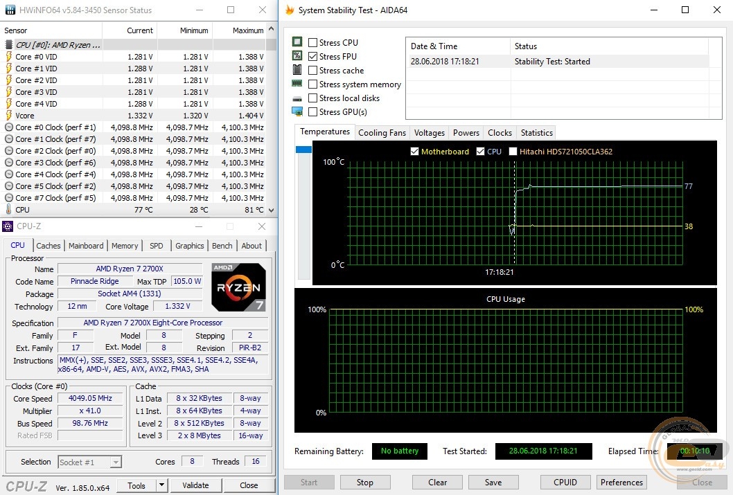

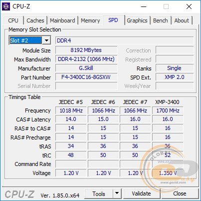

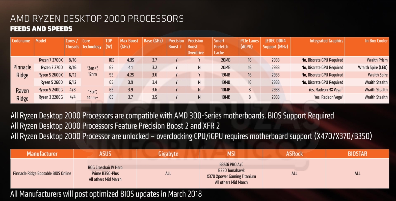

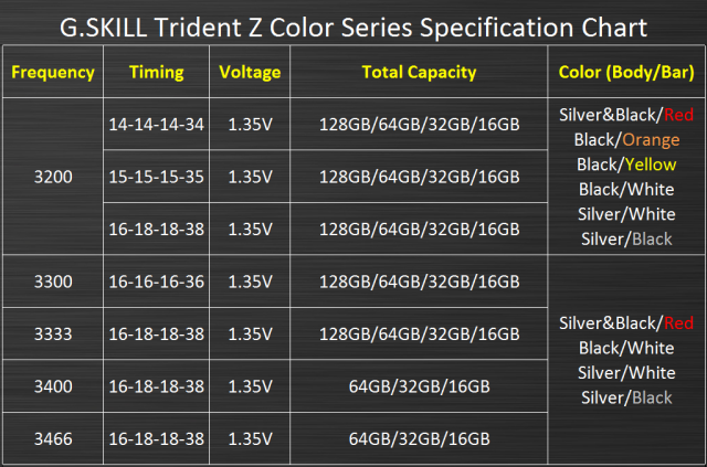

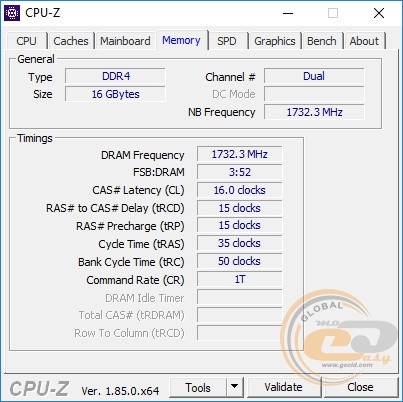

    This record
    - Aorus X470 Ultra Gaming - does not turn on, the CPU LED is blinking
    whether X470 AORUS GAMING / Gigabyte X470 Aorus Gaming 5 WiFi // * the cheaper and better X370 AORUS Gaming 5
    RAM in slots (dual channel): 1 and 3 / or 2 and 4 / or all
    - e.g. 2 x 8GB DDR4-2400 HyperX Fury model: HX424C15FBK2 / 16
    Works with Ryzen 7 2700x
    - Aorus X470 Ultra Gaming - does not turn on, the CPU LED is blinking - Aorus X470 Ultra Gaming - does not turn on, the CPU LED is blinking
    - Aorus X470 Ultra Gaming - does not turn on, the CPU LED is blinking - Aorus X470 Ultra Gaming - does not turn on, the CPU LED is blinking - Aorus X470 Ultra Gaming - does not turn on, the CPU LED is blinking
    with these RAM (DDR4-3200 G.SKILL Trident Z model: F4-3200C15D-16GTZKW)
    - manufacturer's website Link / or Link
