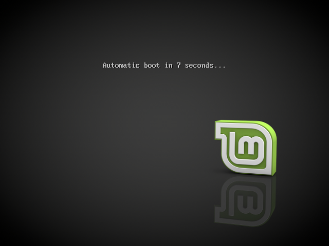

    From what you can see, you probably want to choose Windows and Mint 19 and Windows is installed in UEFI mode - a similar problem as here: https://www.elektroda.pl/rtvforum/topic3404462.html#16864421
    The Mint 19 64-bit installation media also needs to be started and installed in UEFI mode ...
    BTW:
    If such a window with a countdown appears just after starting, the Mint has been launched in Legacy mode (you need to press something to show the menu):
    GRUB Error: Fixing Linux Mint 19 Installation Issue on Multiple Partitions (Root, Home, Swap)

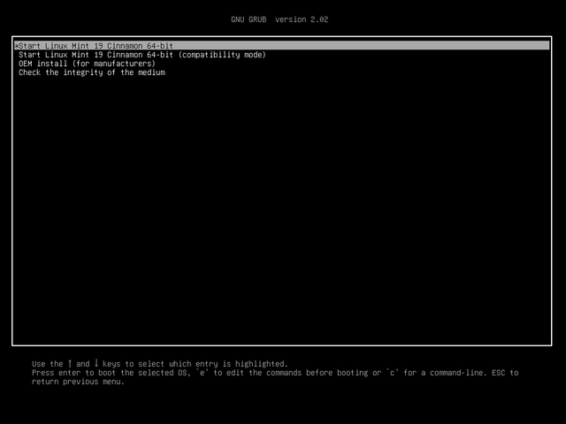

    and such is UEFI:
