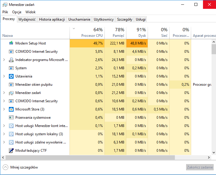

    Hello, I have a problem with my new laptop. Well, it is loud from the very beginning windmill cooling fan, it can be heard all the time. Checking in the task manager, it turned out that MODERN SETUP HOST is constantly eating resources p processor, disk and memory, for a change ... What is this whole modern host and how to get rid of it? Could there be another reason for this problem? Thanks for the answers

    This process is responsible for the "big" system update (coming out once every few months). Be patient and let your laptop install all updates (you can monitor the update progress by going to Settings -> Updates). Once the equipment has been updated, the process should no longer consume device resources.

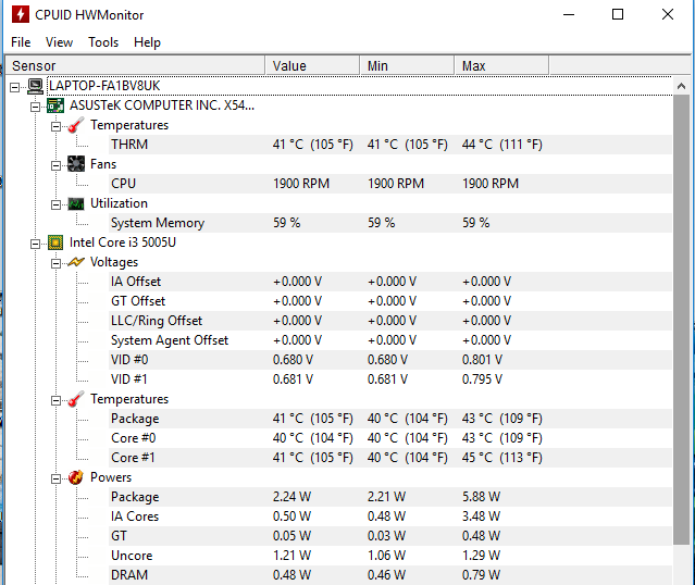

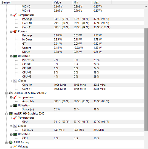

    Thank you very much for your answer. Everything has returned to normal, but only with these processes. Currently, the problem with the windmill (noisy and continuous operation occurs all the time. I do not know where it comes from, since the temperatures are normal (pictures). The latest version of the BIOS. The fan is still working at high speed, but blows cold air. Does it give something to do? maybe someone had a similar problem?

    If this is a new laptop, its self-demolition and attempt to program the BIOS bones will void the warranty.
    Use it - continuous fan operation at low temperatures is at least suspicious.
    Is the fan just as burdensome both on battery and mains operation?
    best regards

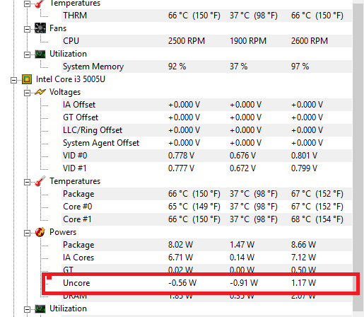

    Hello, the problem is solved? I have the same problem in this model, the laptop was under warranty, the fan was replaced but the fan is still loud.

    ... work under stress HWMonitor ASUS X540L: Loud Cooling Fan and High Resource Consumption by Modern Setup Host
