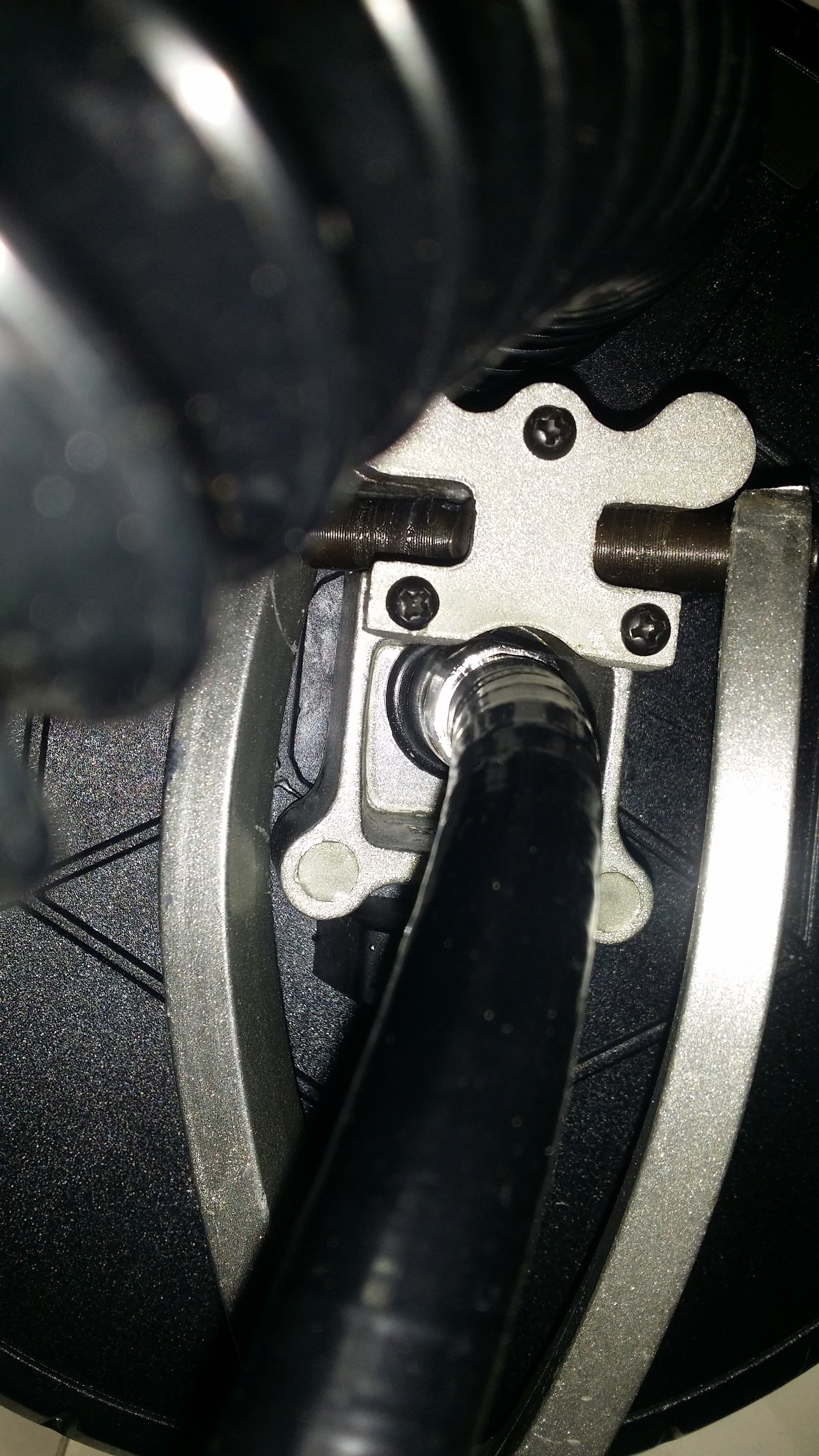

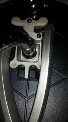

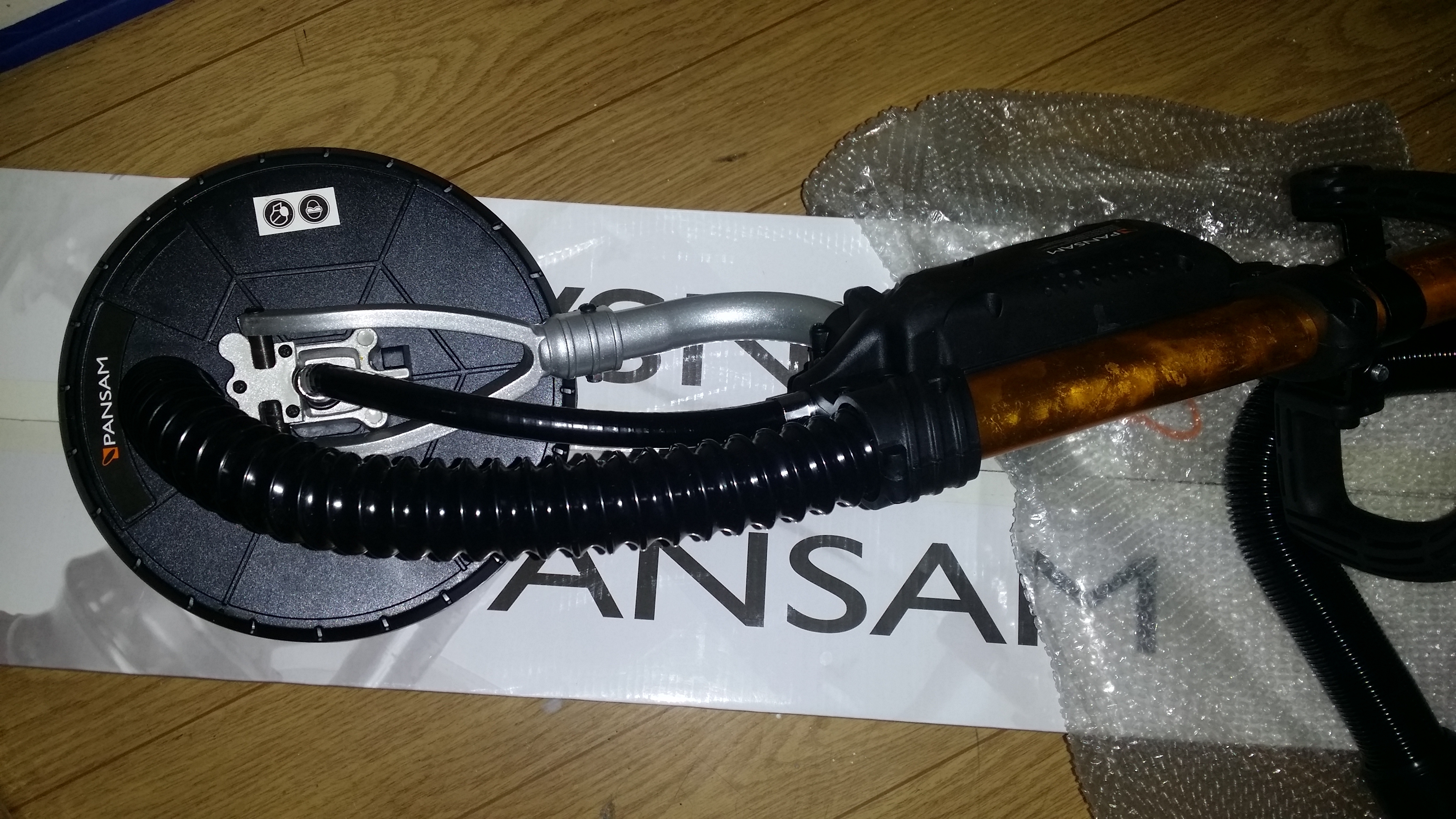

    I bought a second thought Pansam giraffe with a motor on a handle where the motor with a shield is connected with a roller. Therefore, I have a question about the seal that is on this shaft. The grinder came to me unfolded in a box, all parts must be put together and the instructions are practically illegible, tragically made with micro drawings of parts that cannot be recognized on the graphic. The Internet is the same, the same instruction, I did not find any other. The problem I have when folding is that I'm not sure where one of the seals on the drive shaft should be. The gasket was on the shaft, after assembly it is on the outside, which I will show in the attachments. It couldn't be mounted otherwise, but I wonder if it shouldn't be inside. If someone has such a grinder, please let me know if the gasket is in the right place. Choosing the Right Plaster Sander: Comparing Models, Brands & Features for 500m2 Project Choosing the Right Plaster Sander: Comparing Models, Brands & Features for 500m2 Project Choosing the Right Plaster Sander: Comparing Models, Brands & Features for 500m2 Project

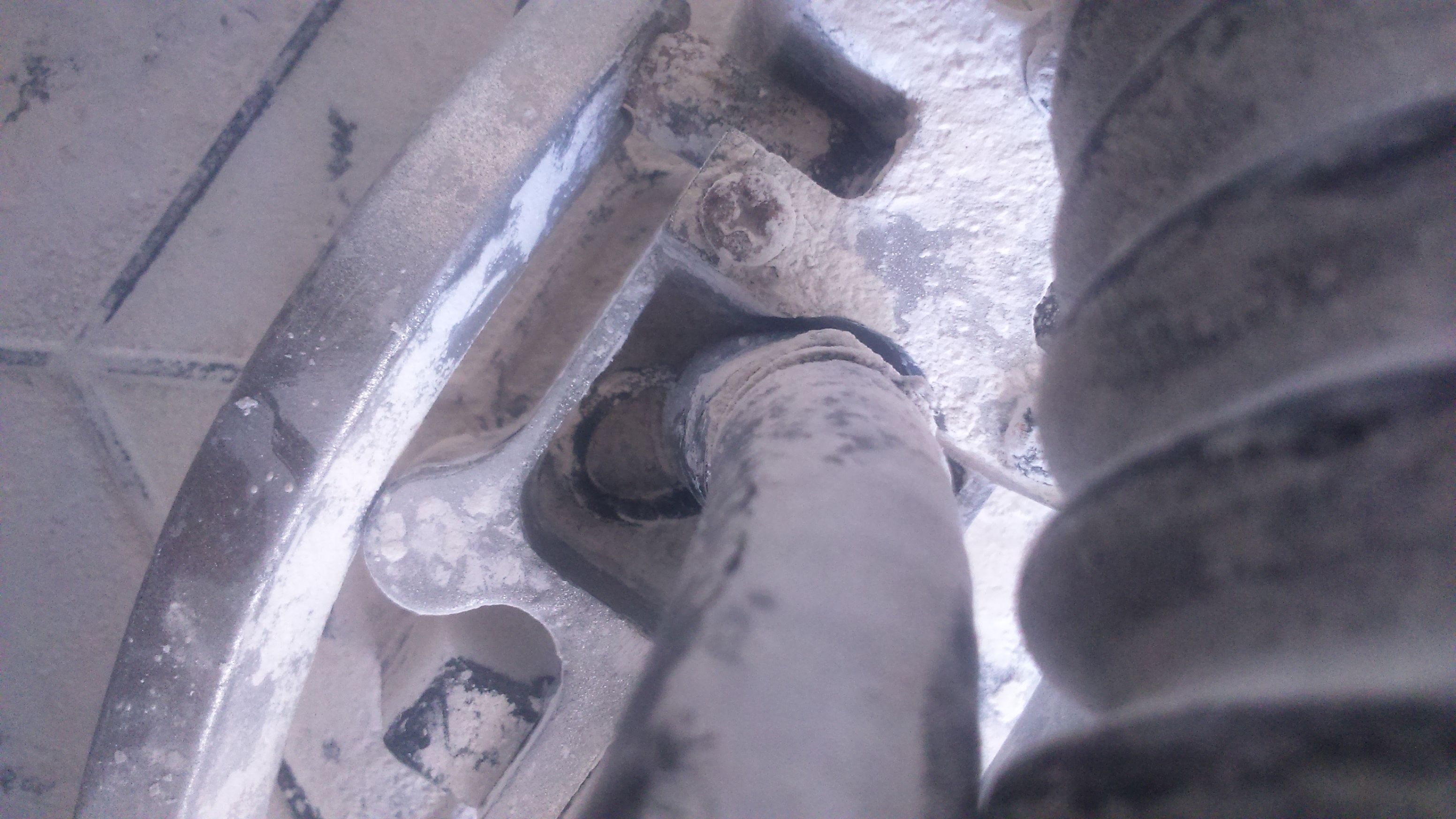

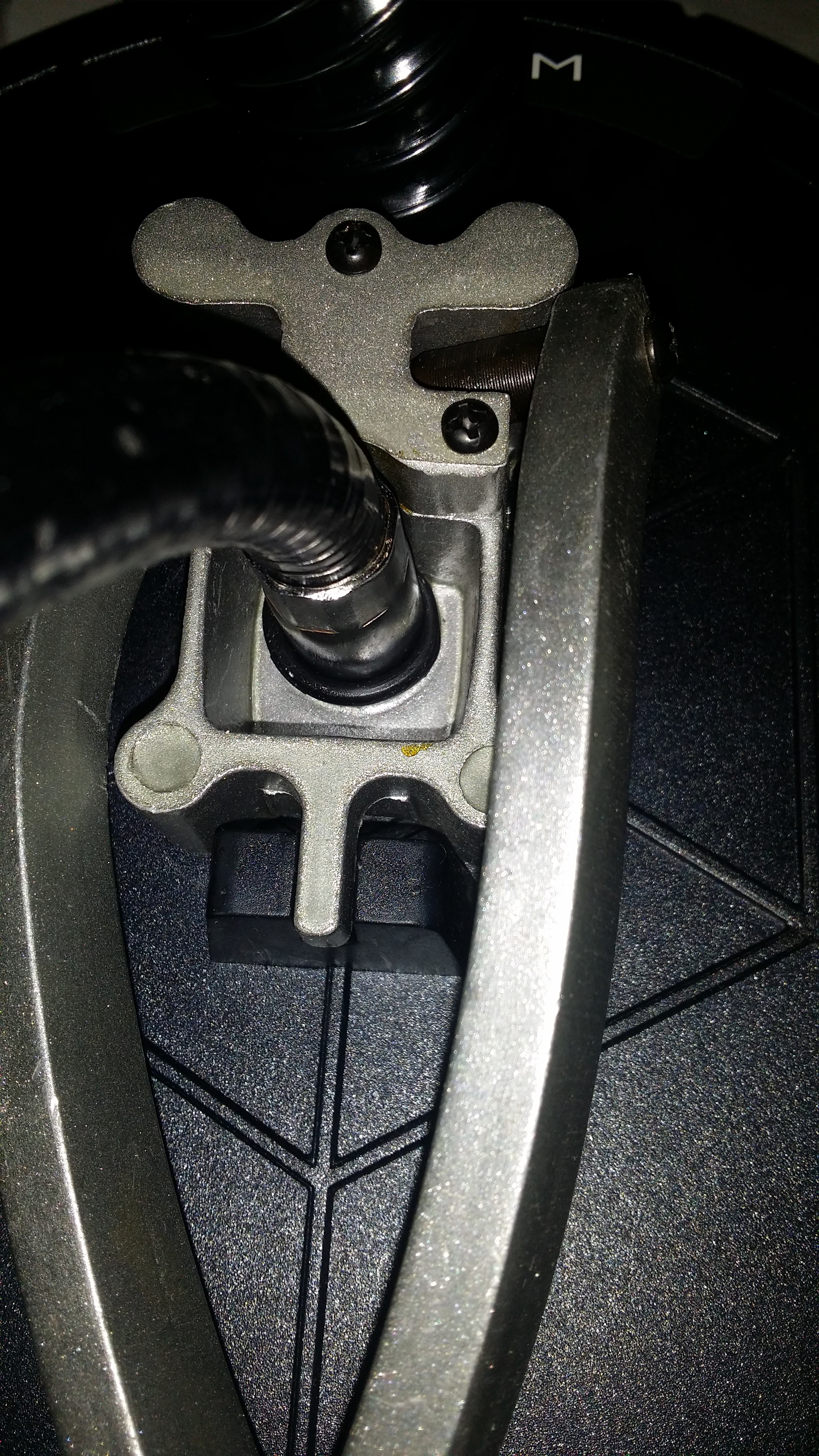

    I finally remembered this and looked at my machine today, saying gasket do you mean this black O-ring?
    For me it is outside but in the hole only half, the other half is squeezed out of the hole, probably due to an error in assembly, did I fold it? I do not remember :)
    Despite this, the bearings show no signs of wear due to the dust getting into them :)
    Tomorrow, if I don't forget, I'll take a picture.
    It's tomorrow, I have not forgotten :)
