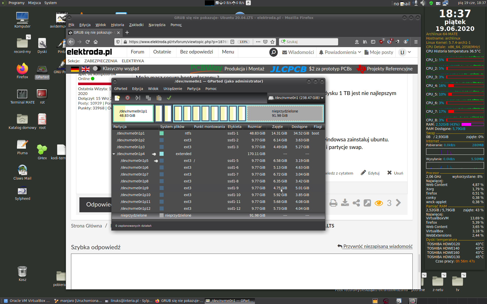

    Recently, Windows 10 has started to annoy me a lot. So I decided to install Ubuntu 20.04 LTS. (This post concerns the Acer Aspire F5-573g-762j laptop. I have a 1Tb disk with partitions - one about 600gb, and the other about 400gb - I keep various data on this one, etc. I would like Windows to work on dualboot with Linux after all. I installed everything according to the instructions - for dualboot to work, here are the links:
    https://www.benchmark.pl/testy_and_recenzje/u...next-windows-10-instalacja-krok-by-kroku.html
    https://www.youtube.com/watch?v=Zcn4pnSFq2E
    https://www.youtube.com/watch?v=n_FffFwqBLA
    I've done it several times.
    It says that linux has been installed correctly, but it does not work (The GNU GRUB menu with the choice of Windows or Linux does not start. MSconfig does not show up. I have fast startup disabled. I want to allocate about 90Gb for Ubuntu If it's not a problem, I would like you to exchange how much should I allocate for space and how to create a partition during installation, e.g. primary, ext4 filesystem with journaling, /root. Please help

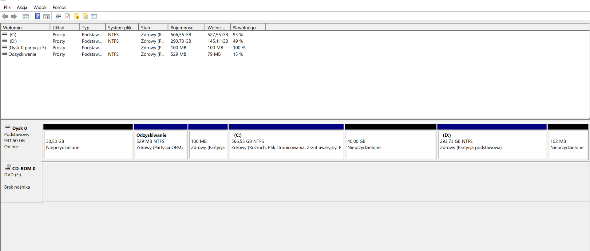

    I looked at these links and I am very surprised how such a simple matter as installing linux next to windows can be complicated.
    Show me what the partitions look like in disk management, I'll make a short instructional video and post it on the forum.
    It's best to do it on ubuntu with a partition of about 10 GB ext3 mount point / (and not as you wrote /root ) and a SWAP partition of about 1 GB. For data, it is best to use a common NTFS partition for windows and linux.
    Ubuntu installation takes about 10 minutes.
    You have a photo from my disk with windows 10 and a few linuxes to bring it closer.
    You won't need to make so many partitions because you're installing one linux

    linuks wrote:
    SWAP partition about 1 GB
    Well yes, but apparently it is 2 times the RAM (maximum 16). i have 12gb. I don't know much about it. Why are you using ext3 and not ext4? I'm not very familiar with Linux yet, but I'm very interested. As for the disk, for now I removed Ubuntu (which was there but did not work), formatted the 600gb partition, and reinstalled windows on it. Picture below. Unable to Launch GRUB Menu Post Ubuntu 20.04 LTS Installation on Acer Aspire F5-573g-762j Thank you for your answer. Regards.
    I mean, I would like to know something about SteamOS (this distro for gaming) and maybe Linux Mint 19.2 Cinnamon or Manjario Gaming
    Added after 11 [minutes]:

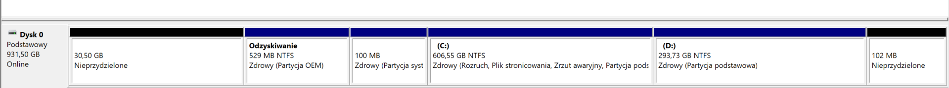

    Here I am sending a screenshot after reducing the C volume. And I want to allocate these 70gb to Ubuntu. Regards Unable to Launch GRUB Menu Post Ubuntu 20.04 LTS Installation on Acer Aspire F5-573g-762j
    Also, I'm afraid that GRUB still won't boot

    Your partitions are pretty messed up but I don't want to mess with your partitions anymore.
    Do a swap of 1024 MB on the first partition and, for example, two partitions of about 15 GB in case you want to install two distributions.

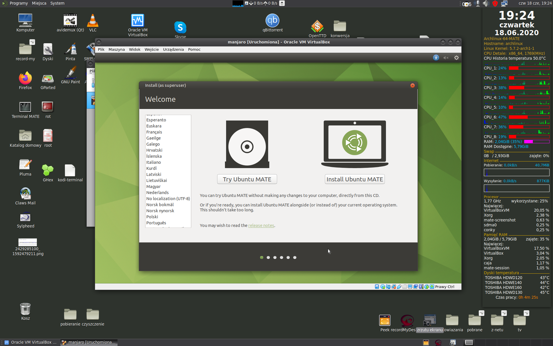

    The promised video of installing and updating ubuntu on the same partition layout as yours.

    Maybe you have secure boot enabled?
    In general, you have a lot of clutter on the partitions.
    Ideally, it would be best to create a new MBR partition table (now you have GPT which is not the best idea on a 1TB disk) and re-partition
    one for windows
    the other for data
    third on ubuntu
    and a fourth for swap
    Then install windows (because you don't have a recovery partition anyway) and after installing windows install ubuntu.
    It has to work. I have that with me. One partition for win10 several partitions for linux and swap partitions.
    I guess you are installing windows in UEFI mode (switch BIOS to legacy) because you have GPT and not MBR.
    Regards

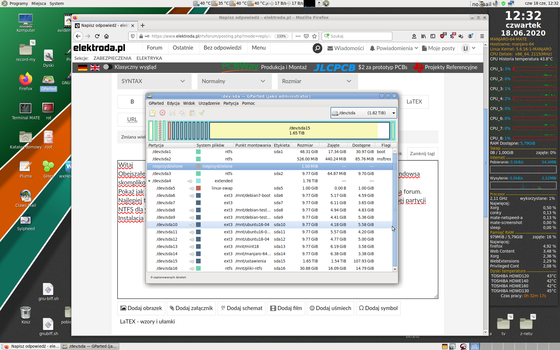

    Do you have a photo with partitions on my SSD drive.
    The first is windows 10, the rest are linux. I have data on another physical drive

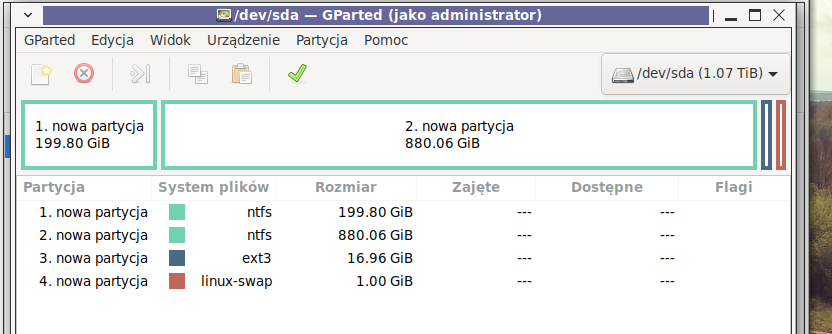

    I propose such a partition arrangement at the MBR table
    You can easily create partitions with gparted
    Gparted is in the ubuntu installer when you select try it in system tools.

  • #18 18769932
    SzymonKowalski64628
    Posts: 91
    Rate: 8
    Currently, all data from D is transferring to me. From the console in the Windows installer, I change GPT to MBR. I will install both windows and linux on legacy. As far as I know, UEFI doesn't speed up too much, and everything works the same as on legacy? Are there any differences? As for legacy, I was convinced once when I installed MINT, nothing worked on UEFI. When I changed to Legacy everything works and it will probably be similar here. I wonder about this MBR. In legacy, it does not allow you to install Windows on GPT, it tells you to change to MBR. Please reply and best regards.
