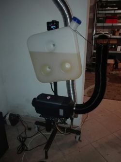

    I recently bought a 5 kW Chinese heating system with a view to using it for a workshop. It came 4 days ago and I prepared the rack quickly. I'm doing quite well and I'm happy. A colleague who uses similar, but Webasto also stated that it works as it should. There was only a problem with the silencer because it turned out to be leaky, but it was successfully repaired with a special paste for sealing and repairing ovens, which withstands 1200 degrees C. The remote control also does not work and I intend to advertise it. As for spare parts, unfortunately I will not help.

    Phone control added to cheap parking heater clone

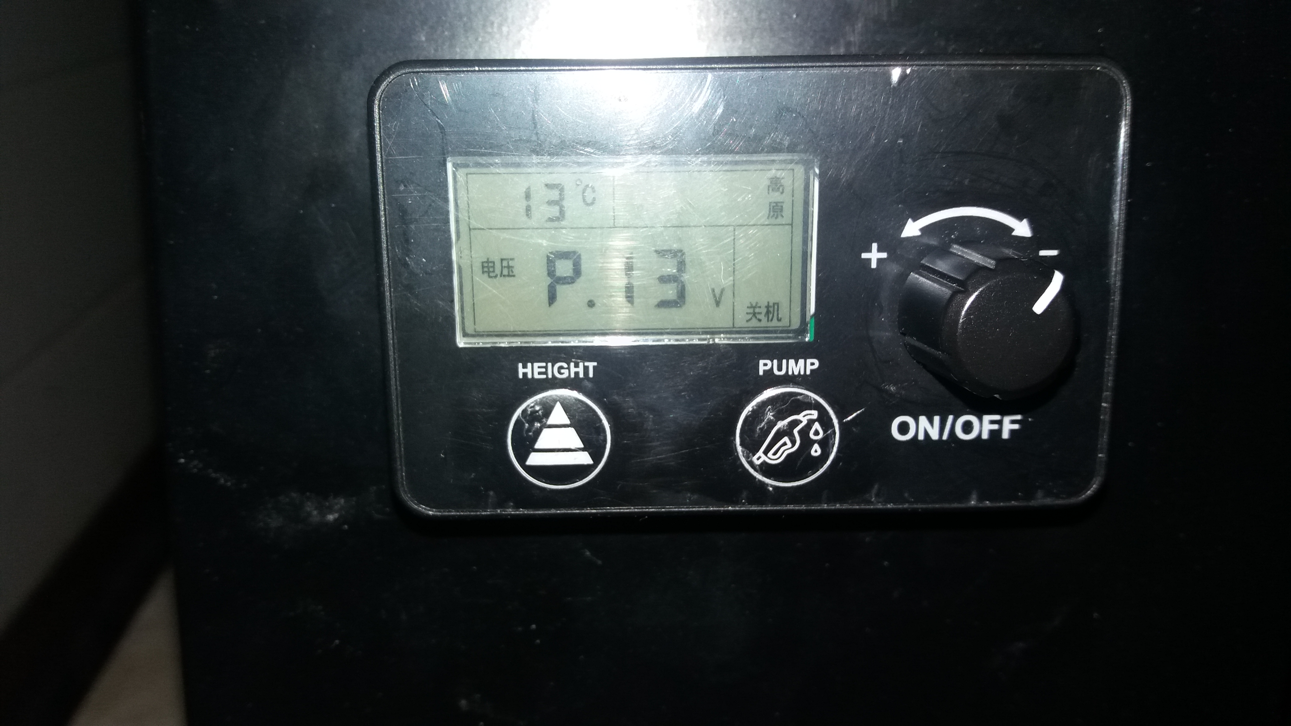

    Hello. Gentlemen, I bought this 2kw analog heating. It works only at full power, the temperature control knob does not work, which may be the reason for this phenomenon. Someone will help.
    Added after 1 [hours] 51 [minutes]:
    The matter was solved. In the set temperature controller there is a temperature sensor and it decides about the revolutions and feeding the fuel to the furnace.

    Hello. I myself have this Chinese webasto in a passenger car. As for the broken pilots, you need to code a new one. On the "computer" the arrow from the temperature should be increased until the knock does not appear. Then we press the button on the remote control and we already have it coded.

    I also have these ovens and thanks for the hint, because I couldn't pair the remote control.

    I have Chinese heating with such a programmer, this is a poorer prog. from the standard ones with five buttons and for China I can't play it to the end. I understand. that I am on time but I don't know how to do it. to turn off maybe someone has one and knows how to do it.
