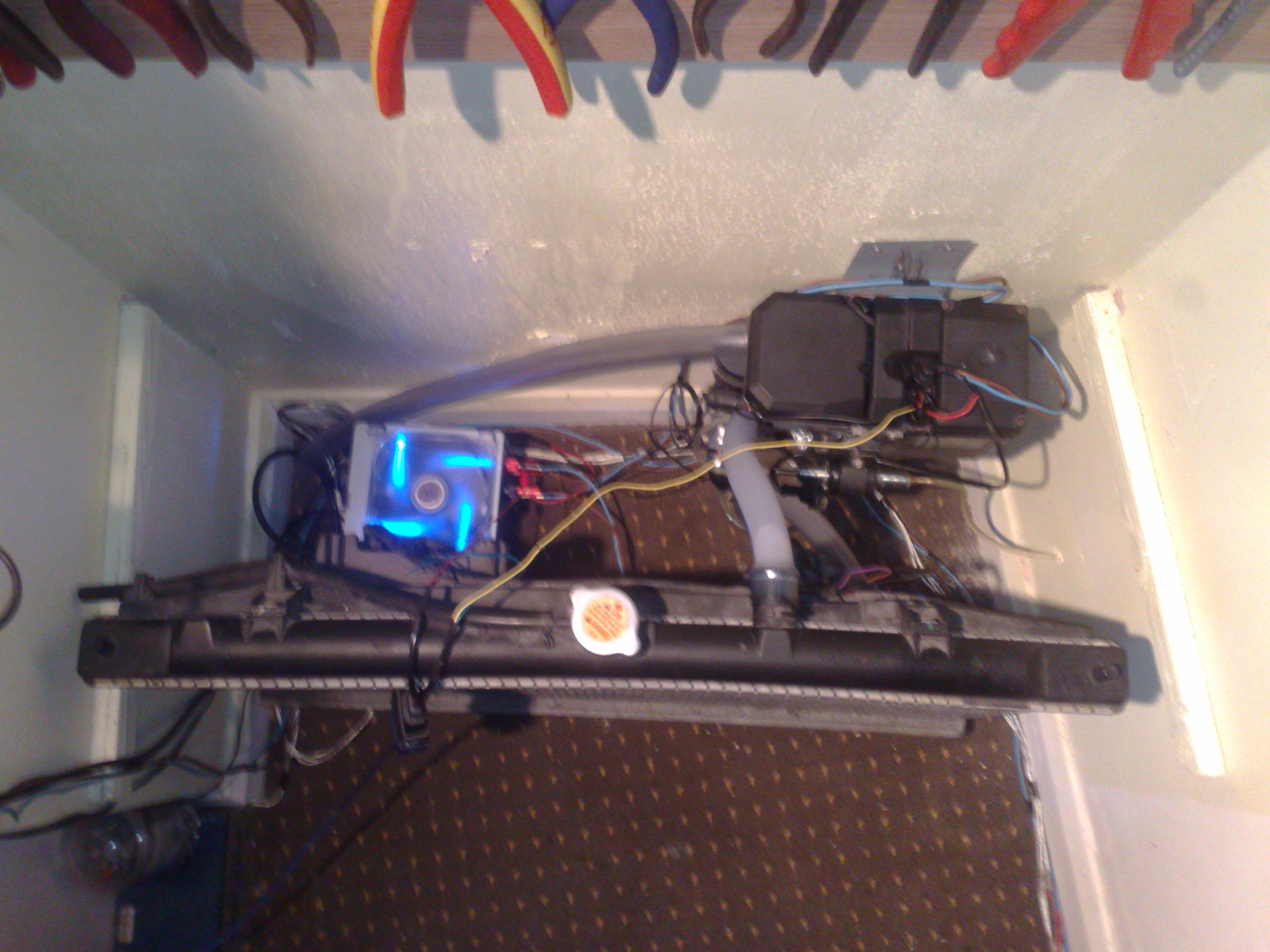

    Hello. Some time ago, I rented a small apartment. It had one major problem - heating. Electric or gas heaters were out of the question.
    After much searching, I found webasto on eBay. It comes from the Rover 75 car and is powered by diesel fuel.
    A dedicated fuel pump works with the webast, and the heat exchanger is a radiator from Nissan Almera.
    An interesting element is the power supply. After many attempts to create a suitable power supply (the Webasto turns off when the voltage drops to 10.5V), the choice fell on the PlayStation3 power supply. It works great in its new application. To prevent the radiator fans from running at full speed all the time, a simple PWM controller was installed. Thanks to this, I can smoothly adjust the speed. The heating is quite quiet, exhaust gases escape outside, and the fuel tank is located in another room. A small worktop is usually mounted above the entire heating system, so it is practically invisible.
    The stove itself also controls the radiator fans. The activation signal goes to the temperature sensor mounted in the T-connector at the Webast output. It turns on only after reaching 40*C. It, in turn, turns on the relay in the power supply and supplies current to the PWM controller that controls the fans. A very clever solution, the heating blows warm air, not cold.
    Prices:
    Webasto Thermo Top Z/C/D - PLN90
    Nissan Almera radiator - PLN5
    Fuel pump - PLN60
    Power supply - PLN7
    Thermostat - PLN5
    Hoses, cables, parts for the regulator, relays, clamps, etc. - PLN15
    The average fuel consumption, when heating 3-4 hours a day, is about 5-6 liters of diesel fuel per week. Average PLN7-8 :D
    The only plans are to make an external intake of air for combustion, and remote starting via SMS, but that will happen in the future :)

    Webasto consumes the most electricity when heating a candle, but this process burned my ATX power supply :D
    Is the control of the Webasto itself based on the original controller or is it solved in some other way? I mean additional heating with the light on in the absence of flame
    I`m also thinking about connecting it in the workshop.
    How much water is in the system? and how long does it take to heat it to 40*
    When heating, the candle consumes 17A :D
    For safety reasons, the original driver was retained. Not a photocell, but a glow plug that is also a flame sensor.
    3.5 liters and heats to 40*C in about 50 seconds.

    You can`t see it in the photos, but I would also install an expansion tank and maybe think about replacing the water with coolant. Coming back to the fact that a Pole is capable, others are simply jealous that he can do anything out of nothing. History has taught us this - it is one of the few advantages of communism, wars and partitions. And we should respect and cherish it, because the newest generation, which does not know communism, can no longer hold a hammer in its hand and thinks that everything will be done for it. Of course, this does not apply to everyone, but the group of such people is constantly growing.
    I decided on a radiator from Almera because it has a built-in reservoir and the system is filled with water with antifreeze added.

  • Questioning Webasto power rating and recommending a CO sensor

    Mine is a Webasto from Rover 75. Model: 98570B, it consumes about 0.3-0.4 liters per hour of operation. It has a power of 5KW. Yours is much stronger, but it also takes a much shorter time to maintain the temperature. And oil from trucks still costs 2.50/liter...
    Lansi wrote:
    and as someone already mentioned - it would be good to have a CO sensor - just in case something happens... the devil doesn`t sleep...
    At the beginning I had a small gas cartridge heater, so the sensor has been there for quite a long time ;)
