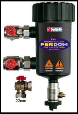

    I attach a picture:
    Magnetic filters in heating systems, opinions and experiences.

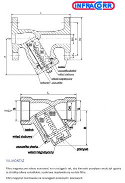

    This type of filters can be mounted with the longitudinal axis vertically or horizontally, but the most important thing is that the strainer housing and the outlet point downwards.
    I enclose a drawing and a quote from the DTR.

    I already have two magnetic filters installed: one Fernox, the other Ferdom ...
    soon I will start a new topic and share my impressions.

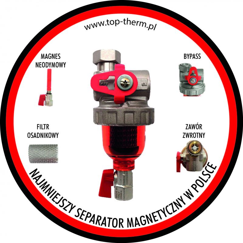

    Can you give photos of what these filters look like so that you can imagine their dimensions against the background of the boiler? I haven't seen these live filters yet, but they seem quite large, so I wonder how to squeeze them in in the apartment with the boiler hanging in the kitchen, close to the gas stove.
  • #8 17813300
    Mi-ka
    Posts: 6
    Sealing on the o-ring - a product of Top-therm Polska, a magnet with a power of 4 200 Gauss, diameters from 1/2 "to 2"
    This is exactly what it looks like
    Added after 5 [minutes]:
    And this is what the separator has - total height 13 cm, diameter 6 cm

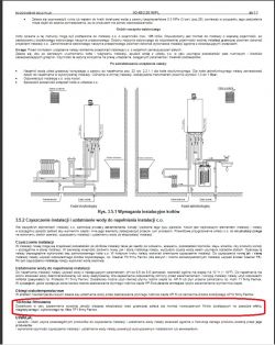

    Information included in my 2015 Ecokondens Gold boiler manual - In the central heating system it is allowed to use antifreeze fluids recommended for use as a heat carrier
    co. systems

    In the instruction IIO-663: 2016 / PL for INSTALLATION AND OPERATION, condensing gas central heating boilers for the ECOCONDENS Gold Plus stove, page 11, it is stated that the use of magnetic filters is recommended. In my opinion, the company and the manufacturer does not matter .. just adapt to your needs and recognize the effectiveness / ease of use.

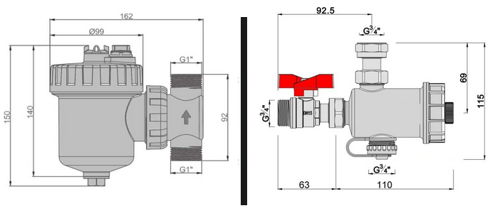

    Certainly, all products with integrated shut-off valves, such as Tiemme Order number: 3150039, Caleffi 545900, are out of the question. I don't know who designs these devices, but how can you assume the power supply from the top and the drain from the bottom part of the body? After all, what the magnet does not catch is at the bottom ...
    Another thing, elaborately arranged connections .. and yet there are a lot of pipes under the stove and no space. The most sensible type of connection is linear ... when the filter is installed on a cut, straight piece of installation and does not change the direction of its flow (no additional 4 elbows!) or such a system in which the filter is mounted where the installation changes the gear by 90 degrees - examples of two common versions:
    In many cases, it is surprising that there is no air vent!
    Thus, my types are:
    FERDOM FD 380 and FD110 the latter does not have a vent (PLN 250-300)
    CALEFFI Dirtmag (about PLN 445)
    FERNOX TF1 family (> 400 PLN, but how to disassemble it, a nice version of Omega ??), the downside is the lack of a filter mesh, and from what I can see in the TF1 Compact I have, the "cyclone" does not catch sludge or it is not in the installation ;)
