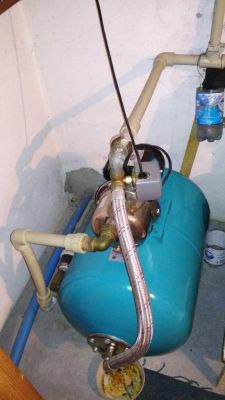

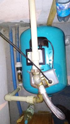

    I have an omnigena 100 L hydrophore with a JY1000 pump, mounted with a deep well, the water surface is probably about 8-10 m below the basement floor with the hydrophore. The water is quite irony, but the system lasts about 2-3 years.
    Well about 2-3 meters from the hydrophore. Outer diameter blue pipe on the suction about 4-6 cm, I will check again. There is a check valve in front of the hydrophore.
    After unscrewing the flange in the tank you can see quite a lot of gray / brown sludge. Some time ago I had to replace the knee "at the outlet" just above the pump because the iron deposited blocked the light of the internal section in about 50-60%.
    Does a possible sand filter make sense or is it better to add iron remover?
    Can be mounted directly on the blue feed pipes and possibly where is the best? Do I need to fix the cabinets to the wall?
    Or maybe not add a filter at all? From what I have checked it is for a single body
    https://www.ustm.pl/produkty/filtry-do-wody/korpusy-narurowe/korpusy-wfw-emi/
    and the contribution of e.g. 10 "
    https://www.ustm.pl/produkty/filtry-do-wody/wklady/wklady-odzelaziajace---ir/
    the flow will be very limited, to 5 L / min :(
    in turn, larger housings and inserts cost several hundred PLN.
    Typical sand filters have a black housing, so if I would like to buy a transparent one, so that I can assess the degree of contamination without disassembling ... great designers forgot about it :)
    The water is used to fill the toilet flush and water the garden.
    Thank you in advance !

    In my opinion, adding at least one filter system makes sense. In this case, I think a 10 "housing with a" 100 "filter with a low flow resistance is enough. For me, this arrangement works (string filter). I decided to filter through the tank mainly because it catches larger impurities before it goes to the system. I did not notice any reduction. Especially in the installation downstream of the tank, the pressure is controlled by the automatic unit with a switch, but I am not able to determine whether the pump operation time has been extended, or to determine the increase in resistance, but I think that with this performance it does not matter much.
    10 "housings are a cheap and practical solution. And if anything is wrong, you simply remove the cartridge and lose only about PLN 30 per housing. Of course, this type of filter will only help reduce solid contamination and catch some sludge. For this it works great, but of course it is not able to reduce the iron content of the water.
    I believe that the body must be attached to the wall. It's little work and minimal cost. A solid mounting works primarily when replacing a worn cartridge, when sometimes there are problems with opening the "sucked" housing - I recommend buying a special key.
    The place of installation does not matter much. I would be guided by easy access and convenience of subsequent use. The casing would probably be best placed on the blue pipe by cutting it and installing a filter with valves on this section. I also advise you to choose a housing with a transparent cap - it makes it very easy to quickly assess the degree of filter wear.
    As for the iron remover ... Small cartridges for the 10 "housing are practically useless, and their effectiveness is negligible. I tried and gave it a rest. Good results are achieved by using a large system with a salt bed and power supply, but it will be a much larger expense. 3,000 PLN It is worth considering the reasonableness of this purchase, since you use water for technical purposes.
