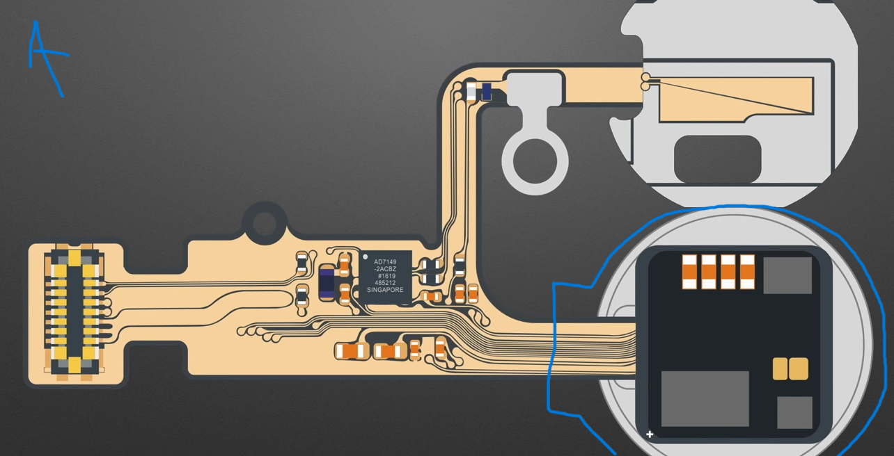

    Hey
    Where is the most important layout located where the touch ID is programmed?
    Centrally under glass or on tape (AD7149)?
    iPhone 7 Home Button Repair: Touch ID Programming, Layout Location & AD7149 Replacement
    I have a problem with iphone 7
    with the button pressed home can not start. He resets and fools when I hail him. The button is slightly damaged from the outside, which can be seen in the picture
    It seems to me that AD7149 is the most important one, and there is a sensor under the glass, which is damaged in my case and makes a short circuit.
    AD7149 looks healthy on me.
    So to make it work, all you need to do is buy an original, functional home and bust AD7149?

    AD7149's soldering will do you no good because it has nothing to do with touch id.
    This system is replaceable and it is replaced by min: if the return button does not work and the touch id works, or someone has damaged the system mechanically.
    The substitution of the new home tape can not help you either, because the virtual home AssistiveTouch will automatically start on the screen and the button will be a dummy.
    I have seen recently that the Chinese have invented a special flex thanks to which the new home button ($ 50) will work, but I have not tested it yet and I do not know if it works in general.

    For the sake of clarity Ladies/Gentlemen - that is, you can replace everything except...
    A: We throw out everything as long as there is a sensor that is functional and paired with the iPhone's board. [SOLUTION: cut off the button in the most convenient place on the tape and solder it with angelic patience to the original tape from some donor]
    B: We're throwing out everything, but the sensor and this system must remain functional. [SOLUTION: cut off the button in the most convenient place on the tape and solder it with angelic patience to the original tape from some donor, and also solder the circuit]

    version A is enough. The ad7149 chip is responsible for the pressure simulation, it is not identified.
