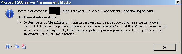

    archive file of the payer's database in the .bak format (a copy of the database in SQL Server Express 2017 14.0.1000.169 made at the xyz company does not know anything else) 64bit?

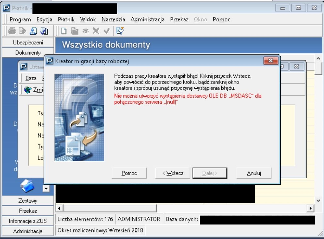

    1. Task to go through migration from sql to accesa database.
    Installing SQL Server Express 2017 approx
    Payer installation approx
    Restoring the database from the xyz.bak file to the sql database ok
    Linking the payer to the sql database approx
    Logging in to the payer about
    Optimization of the base approx
    Migration from 1 sql 2017 to another without any problems.
    However, when migrating from sql to access error as above.

    Because there is no MS JET driver for 64-bit applications, it is not possible to migrate the MS Access database to MS SQL Server or MS SQL Server to MS Access using the 64-bit version of MS SQL Server. To migrate between the base types listed above, use the 32-bit version of MS SQL Server with the MS JET driver for 32-bit applications.

    "The error is related to the fact that Microsoft has not prepared the appropriate protocol for migration from MS Access to MS SQL for 64-bit servers (and vice versa.) The solution is indirect migration in the Payer program to the MS SQL 32-bit database.
    In case of further problems, in order to analyze the problem in detail, please send the system status from the Płatnik program (Administration - Program settings - System status - Save) and from the screenshot with the error message. "
    the only problem is that the archive is in the .bak format made on the 2017 express server and only on it can be recreated on other versions of sql express 2008 2012 2014 2016 screams with a message about incompatibility of the archive version and can not be restored. On 2017 express without problems are reproduced.

    Problem solved,
    without technical assistance
    Everything on Windows 10 (1809):
    We install Management Studio 2018 + all update.
    We install SQL Server 2017 Express + all update.
    We install Payer 10.01.001.
    With the help of Management Studio 2018, we restore the database to the server with archivum * .bak.
    We fire the Payer 10.01.001 log in, we connect the sql database to the program, we do
    to optimize the base:
    Start the Payer program and log in as the program administrator.
    From the Administration menu, choose Database Settings.
    The Database Settings window will be displayed on the screen, select Optimize Database from the Base menu.
    The optimization process may take some time, depending on the size of the database. After completing the optimization process, click OK to close the message window.
    We leave the program.
    We go back and update the Payer components.
    We are closing the program.
    We use any program such as * BC ***** t for MS Access and MS SQL or any similar program to export from sql to the accesa file. (completely without the participation of Płatnik i Management Studio 2018).
    We pin the database file to the payer and we enjoy the utility.
