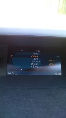

    I haven`t been able to deal with the radio in Laguna 2 ph2 (2007) for two weeks.
    Case regarding cabasse auditorium tronic. In mid-September, problems with the LCD display began. The "radio" (the entire audio system) after a long rest, turned on normally, played for 5-10 minutes and stripes appeared on the LCD, the system hung up - no possibility of control from the joystick, steering wheel or CD panel. Damage was suspected to the navigation reader - CCA 2251R. I bought an identical reader from the same series, the same type, on a well-known auction website. After connecting, the system started working, although the image displayed on the LCD is upside down, but it is not a problem. I thought that was the end of the surprises, unfortunately. The system works properly when stationary, and when the engine is started, a message appears asking for the code to be entered - (Diagnosemenu des systems). a few photos attached. I am asking for help regarding the possibility of starting the radio.
    You can`t drive peacefully without a radio. :-)
    For completeness - After reconnecting the damaged nawi reader, the system works properly, but only for a few minutes. On the one I bought, only with the ignition off.
    The system consists of:
    Navigation reader -CCA 2251R
    6CD changer - PN 2648WC
    Tuner - EN 1225W
    There is no securite code on the tuner sticker . There is only the serial number - photo
    Thank you very much for your help in the above-mentioned topic.

    it is true that the displayed image on the LCD "is upside down"
    Because it is from the scenario.
    RTVAS wrote:
    a message about the need to enter the code
    Connect the car to the clip - read the code (letter and three digits) and convert it into the code for the reader.

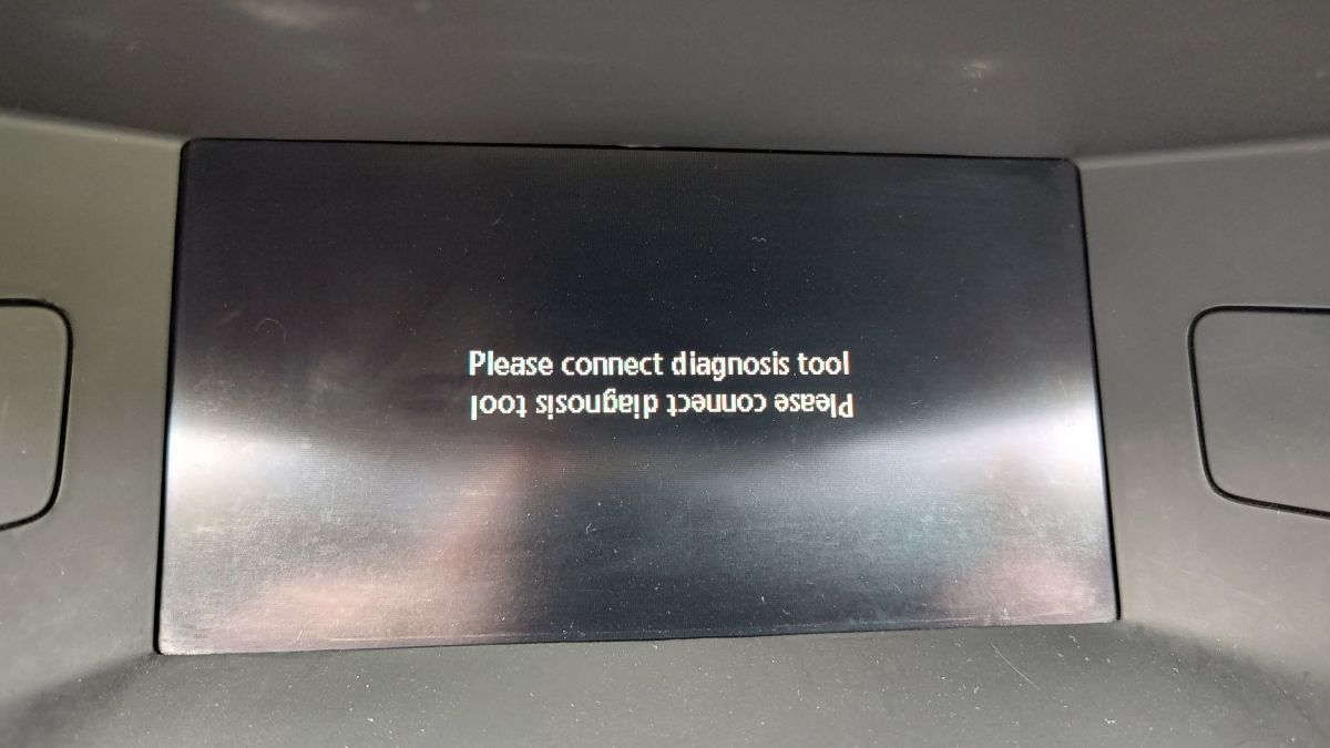

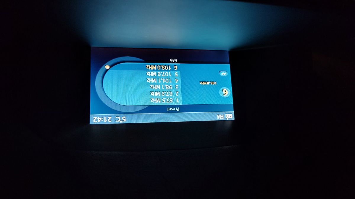

    Hi everyone. Now, in 2024, I have a similar problem with my Laguna 2, Initiale Paris, after a reading of error codes, and erasing them, with a China tester, a copy of Launch, my nav display went upside down, and I hear a beep sound every 2 seconds, for about 2-3 minutes, after that, the screen goes black with the message "please connect diagnosis tool." Only until it goes black I can use buttons, after that I can't turn on/off, use buttons.
    Anyone solved this problem? Thx Car display screen with an upside-down message Please connect diagnosis tool. Car navigation screen displaying information upside down.
