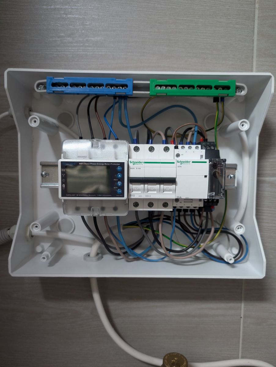

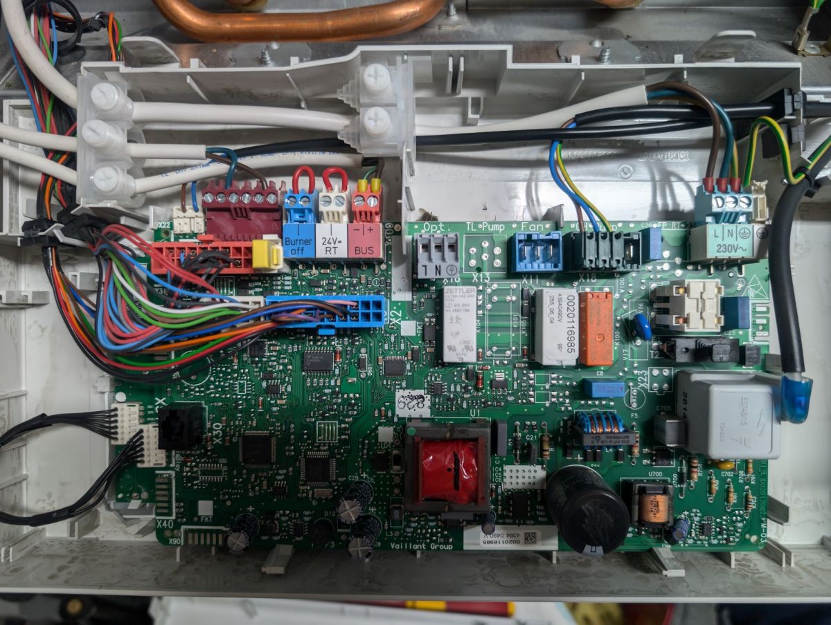

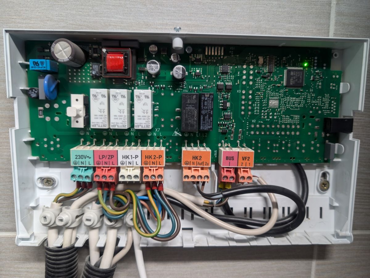

    #43 21221556
    mrgibbs
    Posts: 6
    >>17500798 .
    Welcome,
    Further to the hints, I am looking for an option to pull a signal from the boiler or the VR61 mixer module that the Vaillant boiler "burner" is working or not, in order to appropriately override a 4.5kW 3F electric heater (Sagittarius central heating system reheater) plugged into the central heating system in series:
    1. the boiler burner and the circulation pump are working, then switch the heater on,
    2. the boiler burner is not working and the circulation pump is not working, then switch the heater off,
    Is there a signal on the boiler board or the VR61 (voltage or no voltage) which I can add in series to control the final contactor of the heater, because so far I only have control via the contactor, but from the circulation pump, but even though the burner is off, the pump is running (it has a freewheel). It is known that in winter the WILO pump will be working practically non-stop, and this is not a correct solution, because then the heater will also be working.
    Thanks for any hints on where to get such a signal - VC 206/5-5 boiler, Calormatic 470, VR61 mixer module
    Currently, the circuit is connected to the connector on the VR61 (HK 2-P as shown in the photo below) and turns on the coil of the RE17RAMU timer relay with a 5 minute delay and then turns on the 3F iCTK50-25-40-230 module contactor.
    VR61 mixer module
    View of VR61 control board with connected wires. .
    Boiler control board
    Control board of a gas boiler with visible electrical connections.
    Physically connected heater in the system
    View of a heating system with an electric heater and control box.
    Heater control box
    Control box with Schneider Electric modules and wiring.
  • #44 21221863
    ls_77
    Posts: 2441
    Help: 500
    Rate: 947
    Unfortunately - there is no signal in either the boiler or the VR61 when the burner and pump are running.

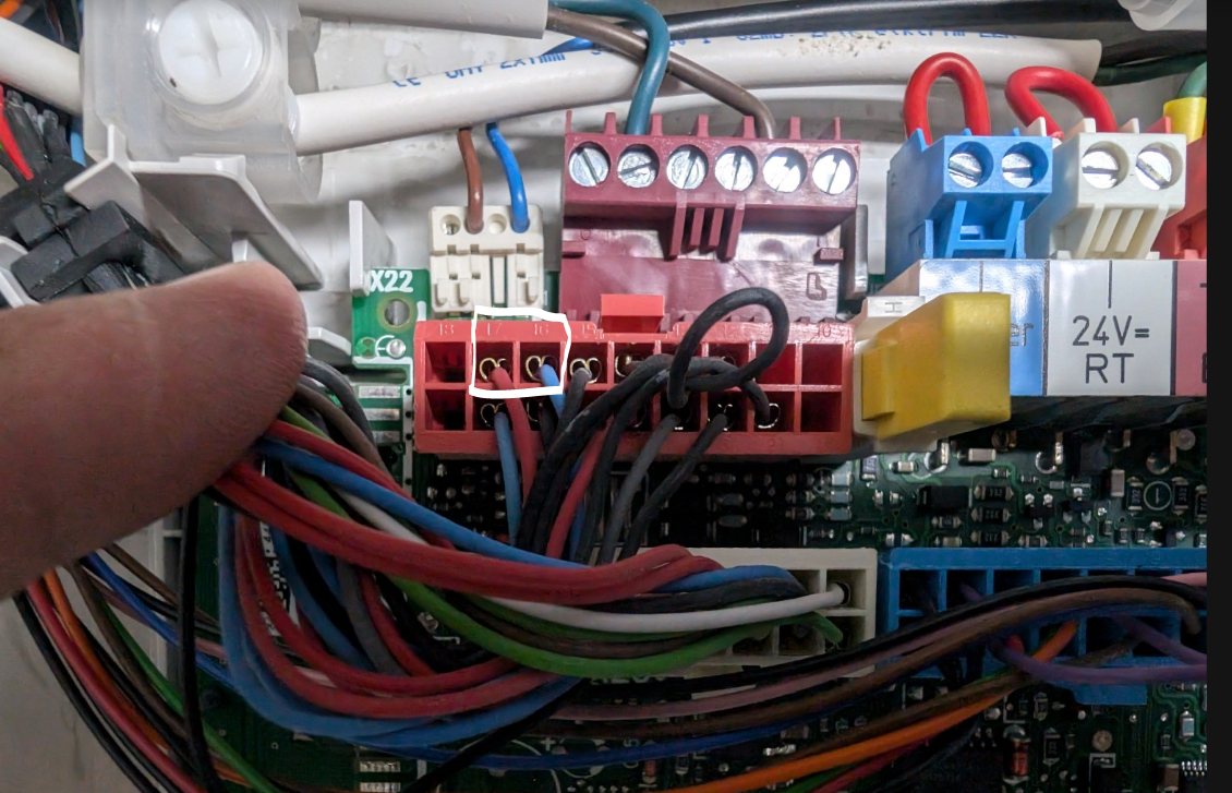

  • #45 21221917
    mrgibbs
    Posts: 6
    Well how about a different one, where is the voltage at the green marked connectors, e.g. 12V or 24V, when the boiler burner is switched on.
    I know this can be measured empirically, but perhaps someone knows, in which case I would connect in parallel via a relay and to the contactor supplying the heater.
    Close-up of an electronic board with multiple wires and connectors marked in green. .
  • #46 21221933
    ls_77
    Posts: 2441
    Help: 500
    Rate: 947
    But the burner operation can also be for DHW heating - then you want to heat with the heater too?
    See on the plug from the fan what kind of wires it is and try it.

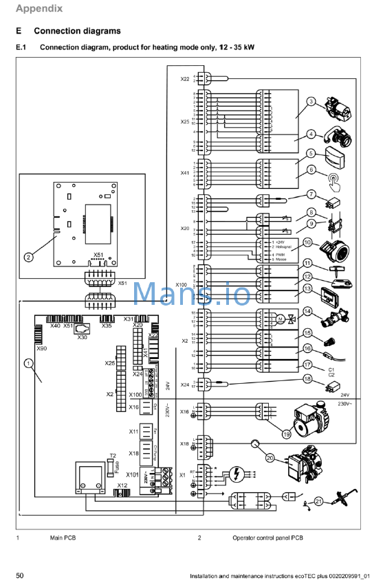

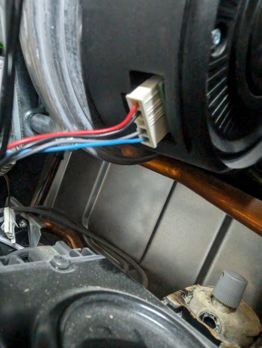

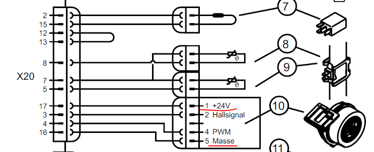

  • Measured fan supply and proposed delayed relay interlock
    #47 21222280
    mrgibbs
    Posts: 6
    A little summary:
    1. first of all, thank you for the hint from colleague Is_77 - that I also did not immediately come across this :) .
    2. good point about the fan running when the DHW is in play mode, but:
    (a) my DHW is mainly catered for by a 1F 3kW heater built into a 300l DHW tank, the boiler is of course set to a lower DHW task value of 43st. C (in the case of a large consumption, the boiler will switch on, but this is quite a rare situation)
    b) I already have an idea how to exclude the operation of the 4.5kW CH heater when the DHW boiler is in heating mode (fan operation), but that will be below.
    3 So I measured and checked a bit at the main board
    a) the fan is powered from connector X20 - PIN 16 (blue) and 17 (red) - when the fan is running there is about 24V DC (photo below), I am wondering how to "nicely" connect to these cables, maybe there are some connectors that slightly cut the insulation and make as a "T" connector
    Electrical schematic of X20 connector connections.
    Close-up of a motherboard with visible power cables and connectors.
    b) in addition there are two more wires to the fan, i.e. black (3) and grey (4), according to me 3 is the speed measurement (Hall sensor) and 4 is the PWM frequency control of the fan motor - there is about 4V there (photo below)
    Close-up of the fan wire connector in a heating device. .
    The whole schematic below:
    Connection diagram for heating mode 12–35 kW radiators.
