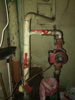

    Desperation prompted me to write the topic, I have no idea what to do. The problem started about 6 years ago, when the old five were replaced and we set up a thermo-boiler, the electricity bill for 2 months came on average for PLN 1150-1300, which is a huge expense. This week, I set up a sub-meter in my apartment and indicated the daily consumption at the level of 34kwh, it turned out that most of it, because as much as 28kW, is consumed by the boiler (the device is new, not yet a year old, 1500W heater with a ++ designation). Yesterday, a plumber came and said that the boiler heats the entire heating system, he set up a check valve (five stopped heating the water in the boiler) and consumption from 18:30 156kWh to 6:22, the meter reading 169 kWh, so it still remains at the level of more than 1 kWh. What else can I do? I would like to add that there are 3 adult people living in the house and these bills are exhausting us.

    Pictures of the installation would also help.

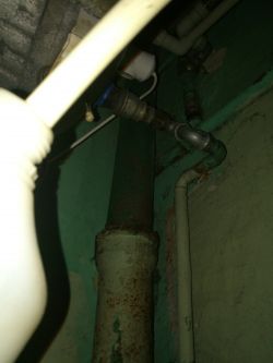

    Please show the connection between the boiler and the central heating boiler (pipes / valves etc.).
    What is the temperature setting of the thermostat?
    Is the boiler plugged in all the time?

    I would like photos of the central heating and hot water installations.

    I'm trying to add photos.
    4kw was consumed when the washing machine, fridge, electric kettle were running and the boiler was turned off.

    Can I see well? Boiler power connected to the blue coil connection?

    But the boiler turns off, does it mean that the valve is installed incorrectly? On the first day, the stove did not heat up the boiler for sure because it was connected to electricity and the water was cold

    If the CO worked like this, or the wrong type of valve, in addition, if the coil power terminals are changed, it will also heat badly.
