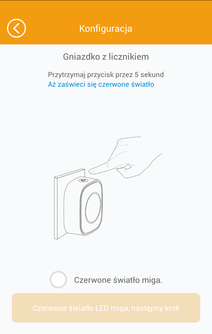

    We can control the device connected to the socket:
    - manually with a button on the socket housing,
    - from anywhere in the world where we have access to the Internet, using the application on a smartphone,
    -using schedules of switching on and off, as well as a timer configured by the application.
    The schedules set in the application are launched in the operator's cloud and the socket will be switched regardless of whether our smartphone and application have an internet connection. The condition for remote control of the socket is its continuous connection to the Internet.
    OPERATION AND CONSTRUCTION OF THE NEST:
    The application is convenient to use, but minor adjustments would be needed, e.g. polonization of messages in the operation log and increasing the resolution of measurement points on the time axis.

10. How do I pair the socket to Wi-Fi?
  1. Hold the housing button 5 s until LED flashes fast.
  2. Open the Piri Smart Home app, enter SSID and password.
  3. Wait ≤30 s for confirmation and name the device [Elektroda, TechEkspert, post #17511331]
