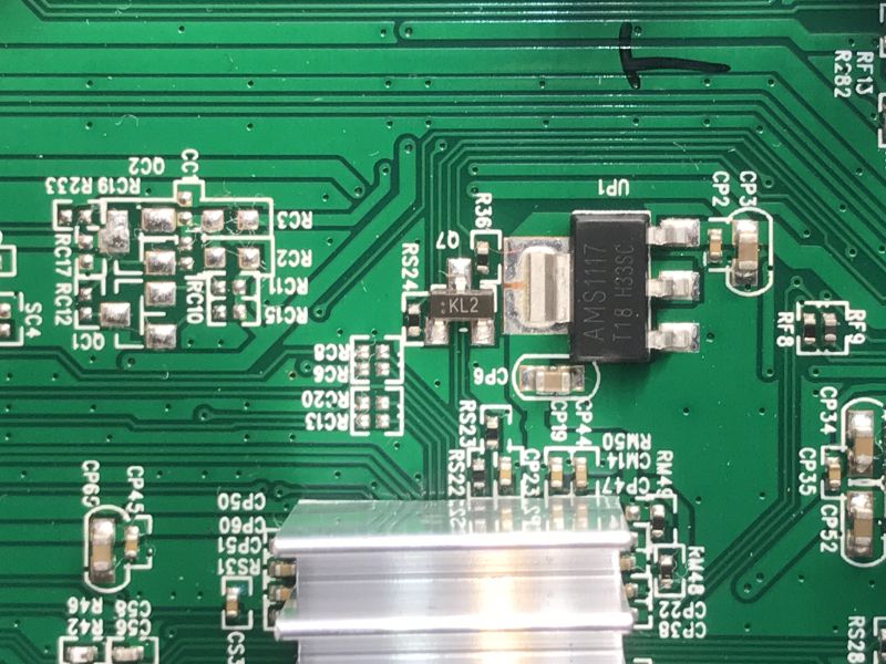

  • The board includes 4MB of Flash, an AMS1117 1.8V LDO, a CON7 connector that looks like Ethernet, and HDMI filtering components marked UH.

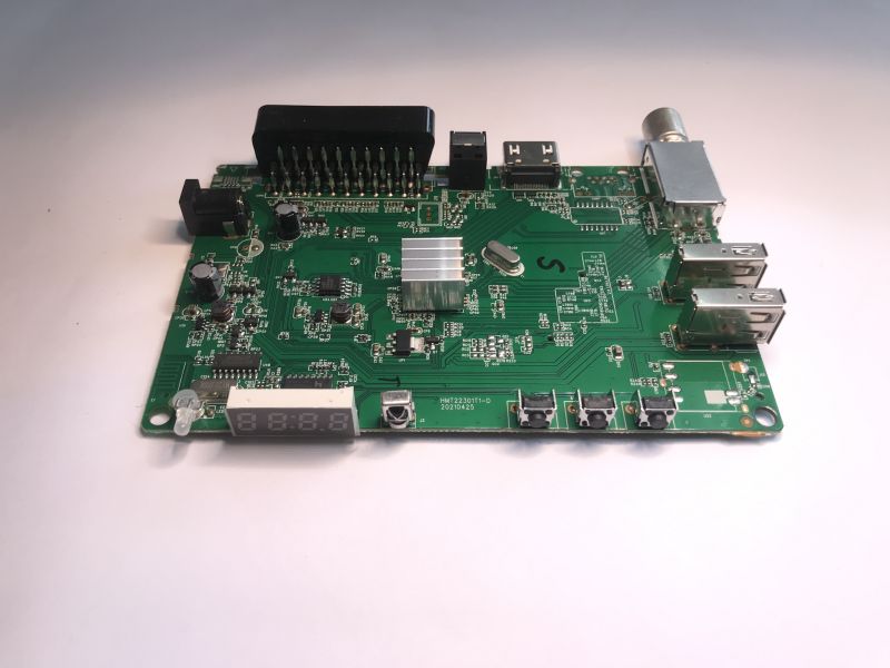

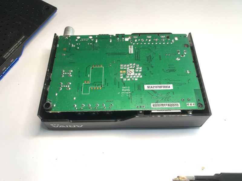

    I'd like to invite you to a brief analysis of another piece of television equipment. This time I received a slightly newer, but again decomposed device. Ariva T75 without power supply and remote control - this decoder has already been shown on our forum . From the outside, the whole thing appears quite minimalist, but what else besides HDMI does a typical user need?
    The interior of the DVB-T2 Ferguson Ariva T75 receiver, DIY potential The interior of the DVB-T2 Ferguson Ariva T75 receiver, DIY potential The interior of the DVB-T2 Ferguson Ariva T75 receiver, DIY potential .
    Virtually no one uses such USB ports for storage devices in my area. Time to look inside - the screws are under the feet:
    The PCB is one - the power supply is external. I was interested in this footprint of some module on the bottom, anyone know what it is from?

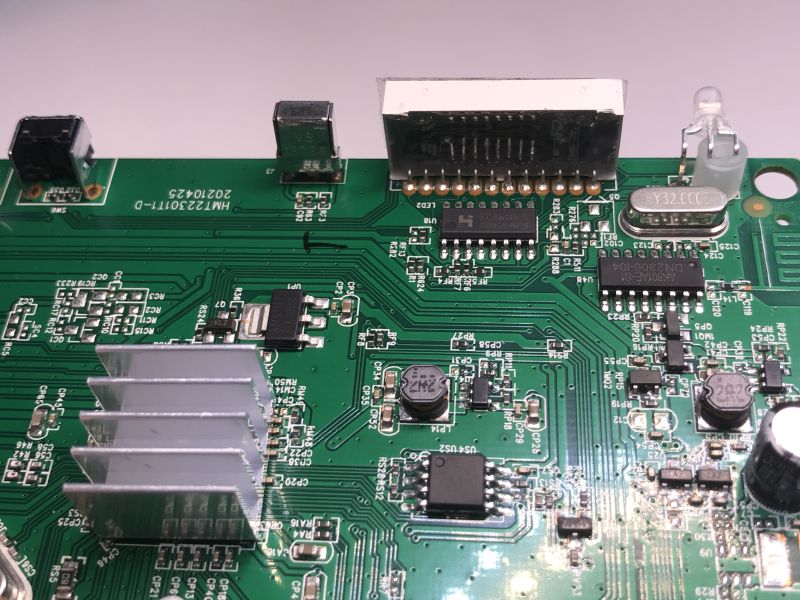

    The PCB designation is HMT22301T1-D 20210425 Four year old hardware. Apart from this you can already see the standard sections:
    - inverters (voltages for memory and processor)
    - processor and next to it the Flash memory
    - display, buttons and their controller, probably with SPI or I2C interface
    - RF tuner

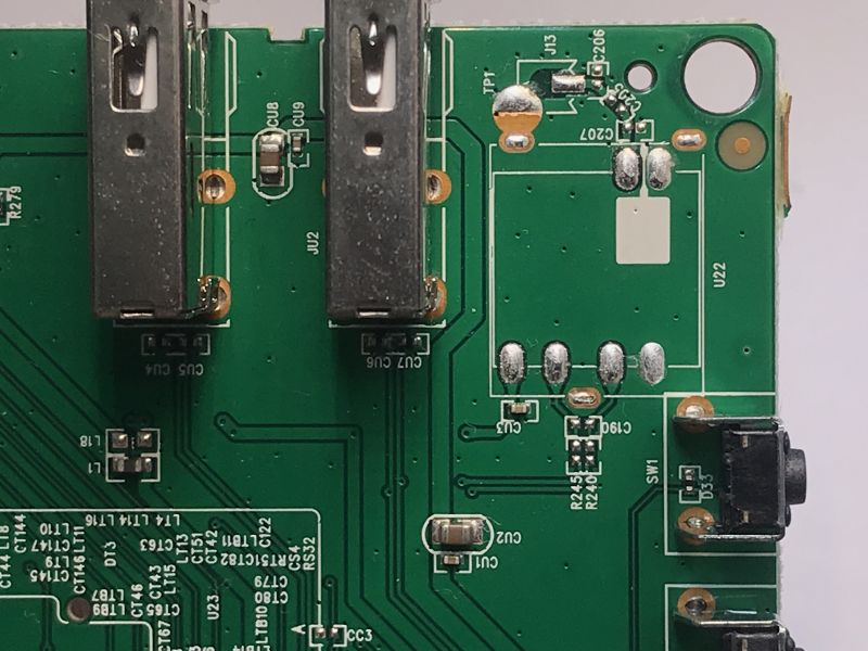

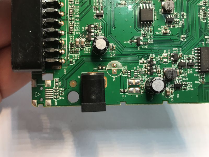

    In the power section I see traces of an option with a Micro USB connector. Interesting that there is no reverse polarity protection diode, in older equipment I sometimes see it.

    With the display it is fairly typical. The controller is an FD650B. From what I recall it is the same as the HD2015, so I have already discussed it:
    We are running the HD2015 display/button controller after reverse engineering, comparison with TM1637itd .

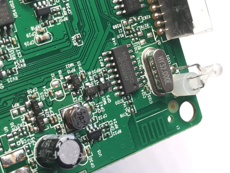

    Next to it is more interesting - an AK801AE-S1 DN2306-104 with an antenna. It looks like an RF circuit. I haven't seen this one before.
    I didn't have to look long for the explanation to this puzzle - it's a Bluetooth chip:

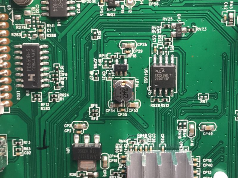

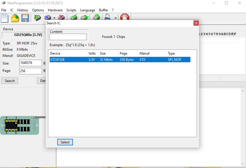

    Next we have the aforementioned Flash memory, here as much as 4MB. This could come in handy and after scrapping the tuner:
    Additional Flash memory for measurements for free? Communication protocol, write, read, erase .

    Next up is an element I often see in tuners like this, but it always puzzles me - if we have step down converters, why the extra 1.8V LDO AMS1117?

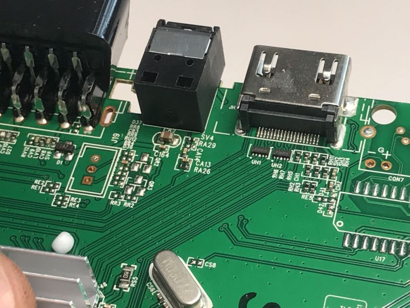

    A view of the board - who recognises the CON7 connector? You can also see a potential three-pin connector on the UART in the background.
    That CON7 looks like an Ethernet connector to me, those LEDs give that away too, and U17 looks like a signal transformer.
    HDMI is only connected to the CPU via the components marked UH - probably some sort of filters.

    There is one interesting spot left:
    Here, in turn, was probably meant to be a WiFi module - probably like the one in my colleague's topic:

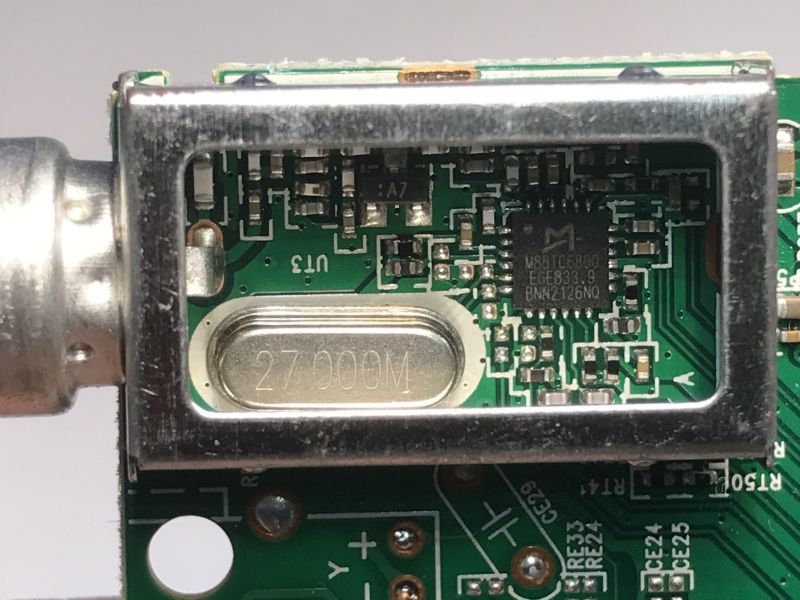

    The signal reception is implemented here on, as far as I can see, an M88TC68000:

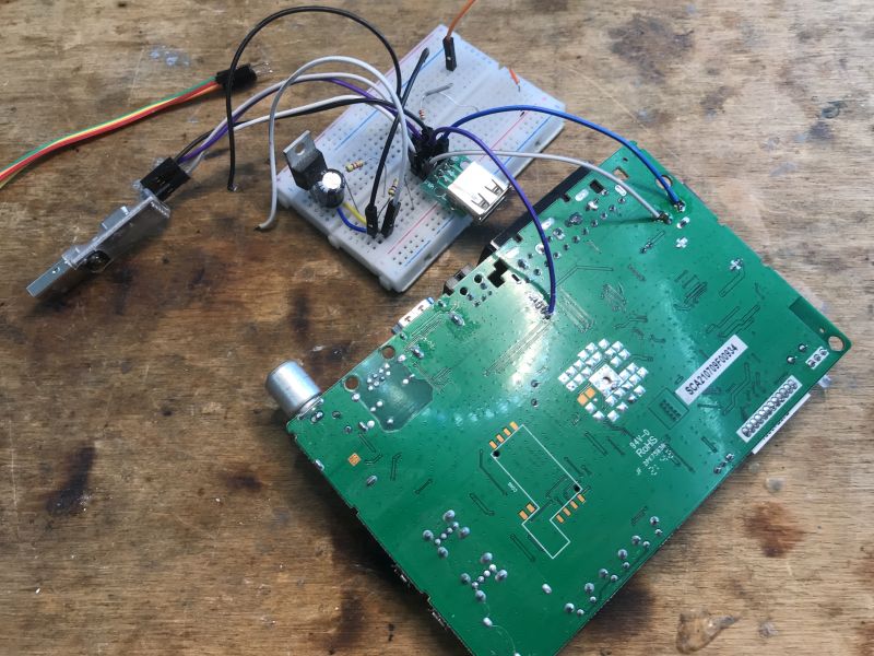

    Finally, I tried tapping the UART, but the device is silent:

    I also dumped the device memory using the CH341 programmer:
    Unfortunately the internet hasn't heard of this circuit, but maybe some of you have an idea what the output signal of such a circuit is? The main CPU does the HDMI onwards, but there you can only see 6 signals, one probably clock (goes around the quartz in the middle) and one differential bus.
  • M88TC6800 hybrid tuner identified in Ariva T75
    #5 21608373
    Posts: 14767
    Rate: 12906
    Some traces of it can be found in a search engine, but no specifics, at least not yet.
    Here it is:
    https://www.montage-lz.com/index.php/Index/Product/productInfo?product_id=14
    A hybrid tuner for cable and terrestrial TV receptions, the M88TC6800 is fully compliant with DVB-C, DVB-T/T2, DTMB, ATSC & ISDB-T digital TV standards.
    Wide RF frequency range
    6 MHz, 7 MHz or 8 MHz bandwidth
    Programmable IF output
    On-chip VCO with AFC
    16 MHz - 27 MHz crystal oscillator with clock-out function
    High accuracy RSSI
    Integrated voltage regulators
    Here someone wrote about it : https://reprapy.pl/viewtopic.php?t=6980 I think it was @@GUTEK@'s colleague

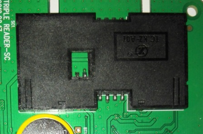

    This footprint is probably for the smardcard reader

    PCB board with three heatsinks mounted and several connected cables.
    So far everything is working, even after closing the case.

    ams8 wrote:
    The mini heatsink on the processor gets very hot. Power supply OK.
    Are you sure it's ok? Meaning is there 5V, is there a stable 5V. See on an oscilloscope as maybe the power supply is chopping. At my place, the power supply for the Arriva gave up the ghost a year ago (and it wasn't 0-1 either, just weird disturbances and shutdowns). And you're still loading the USB at the end of the day, so it might be at the edge of its capacity.
