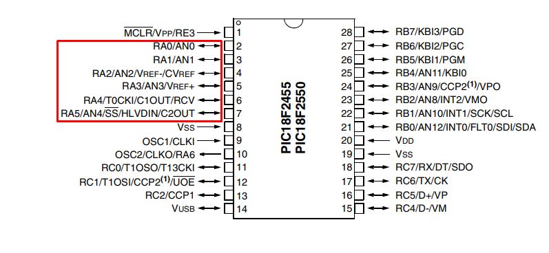

    Running the ADC .
    The next step was to run the ADC. I decided to use the A port pins as I already have segments on B:
    Excerpt of PIC18F2550 datasheet showing analog pins RA0–RA5 highlighted .

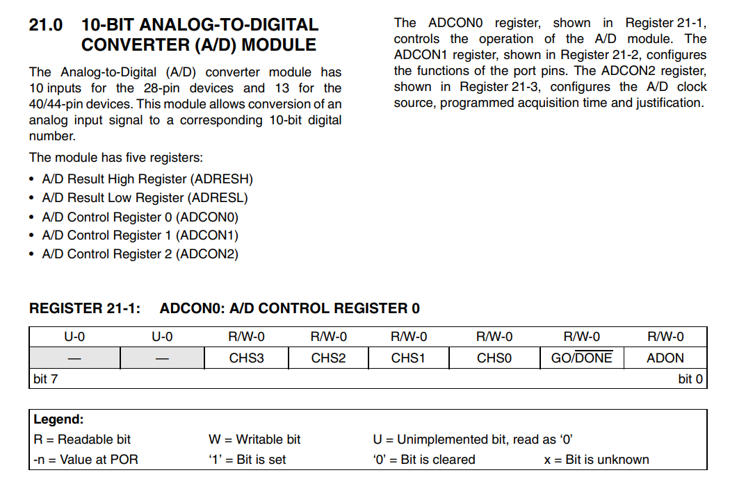

    The PIC18F2550 has a 10-bit ADC. We read a 10-bit value from it, that is, in the range 0-1023. The results of the reading are in ADRESH and ADRESL, and it is configured in the ADCON0, ADCON1, ADCON2 registers:

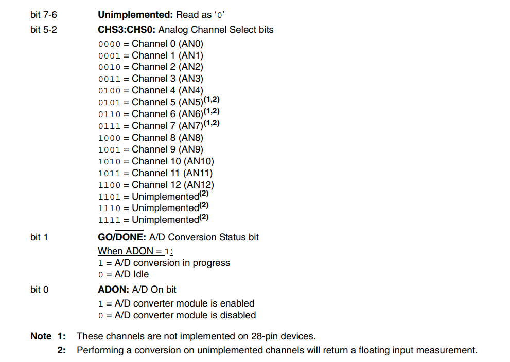

    Excerpt from PIC18F2550 ADC module documentation showing ADCON0 register .
    In ADCON0 we enable ADC and select the current channel, you can also check there if the reading has been completed:
    Bit table for the ADCON0 register controlling A/D converter in PIC18F2550 .

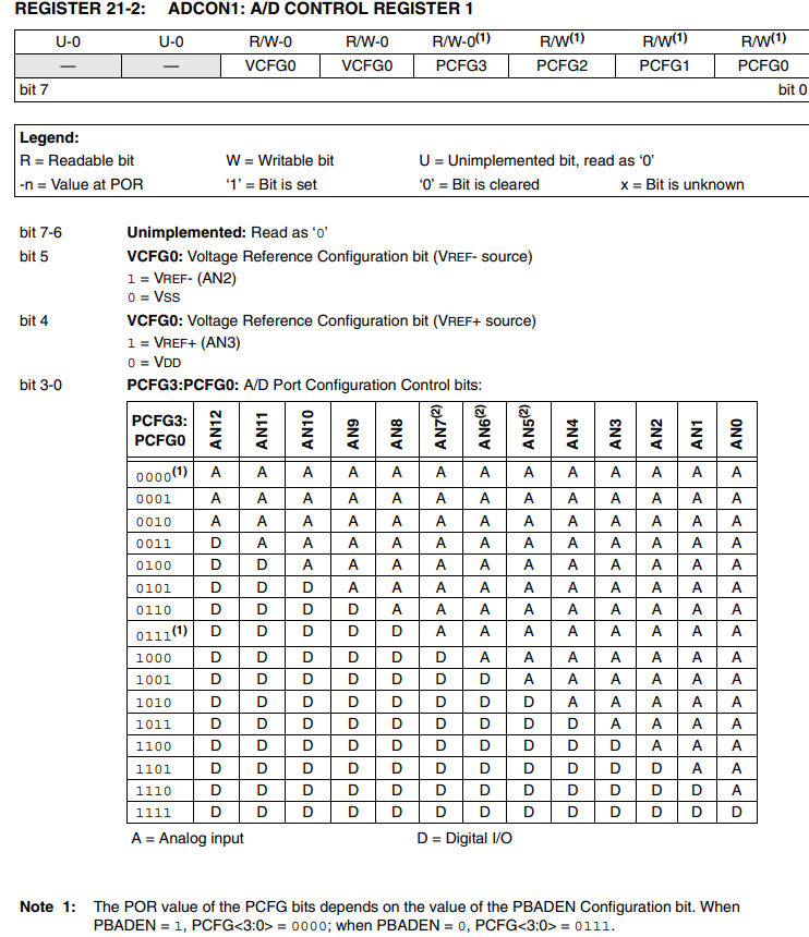

    In ADCON1 we select the reference voltages and which AN pins are digital and which are analogue:
    ADCON1 register table showing AN pin configuration as analog or digital inputs .

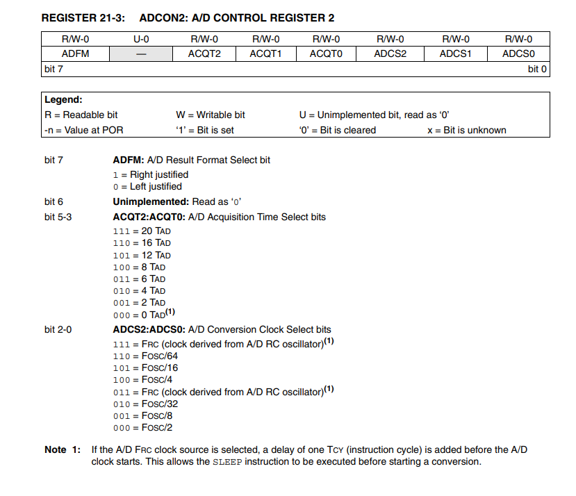

    In ADCON2 we set the conversion time and clock, as well as the format of the result:
    ADCON2 register table from PIC18F2550 showing ADC format, acquisition time, and clock settings .
    At this stage I can already see one small problem. In the project I used AN0 and AN1 as digital pins for I2C, and I don't want to re-solder the wires. However, from the PCFG3:P CFG0 table, it appears that it is not possible to set AN0 and AN1 to digital mode and, for example, AN2 to analogue mode. I will have to change the ADCON1 value after conversion so that I can use I2C again.
    Ok, now it's time to write the values into the code:

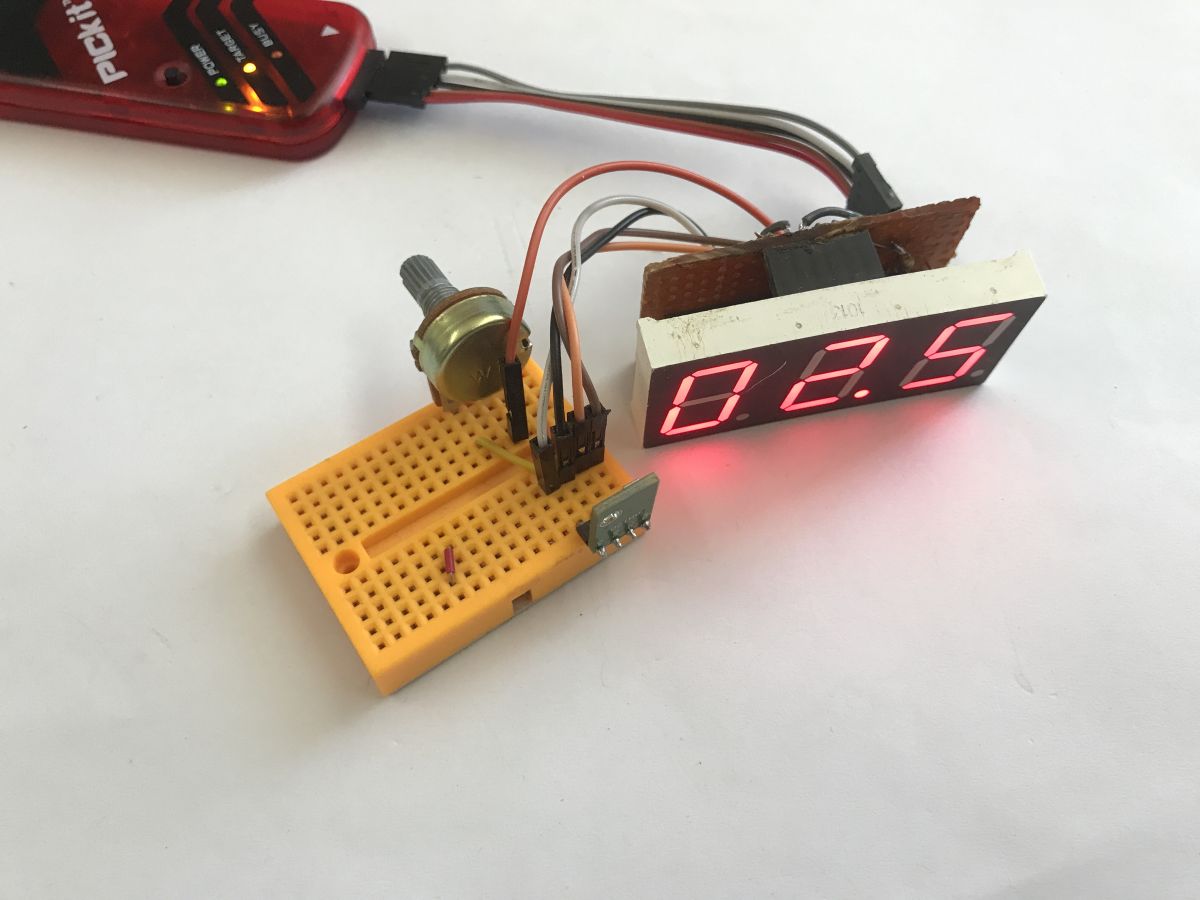

    Now this needs to be tested. From a software angle, just use our display:
    Code: C / C++

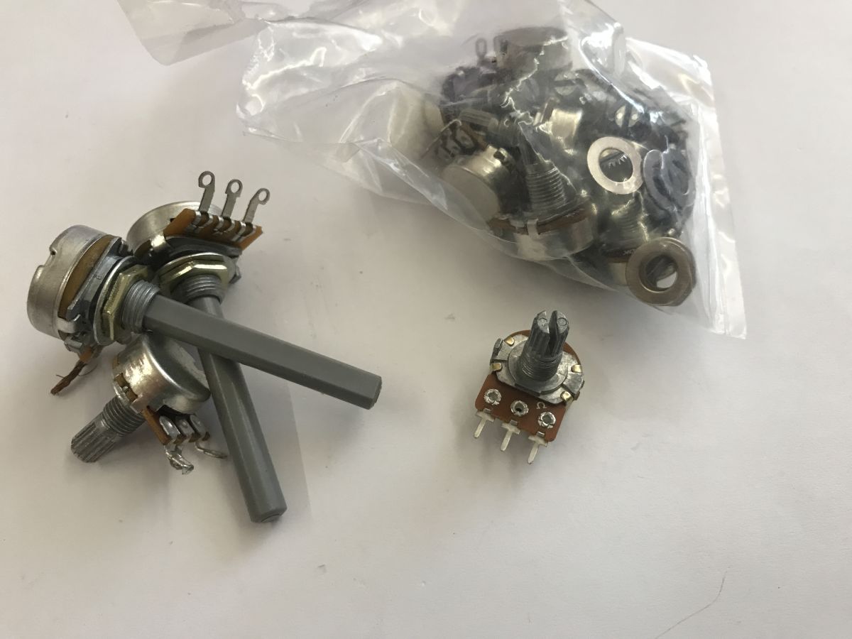

    Hardware-wise, it's no more difficult - just apply a voltage from 0 to 5V to the pin of my choice, a potentiometer will do. Such a potentiometer has a tapping inside and is a voltage divider. I connected it between VDD and GND and the tapping to the PIC's leg.
    Several rotary potentiometers on a white surface, some inside a transparent plastic bag .
    Done:
    Thermometer prototype with potentiometer and 7-segment display on a breadboard .
    Time to check the operation:

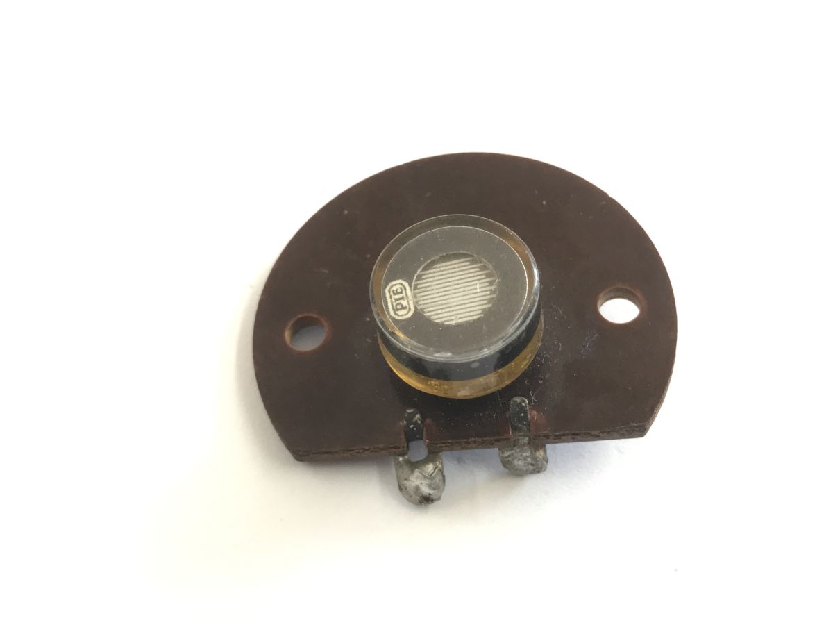

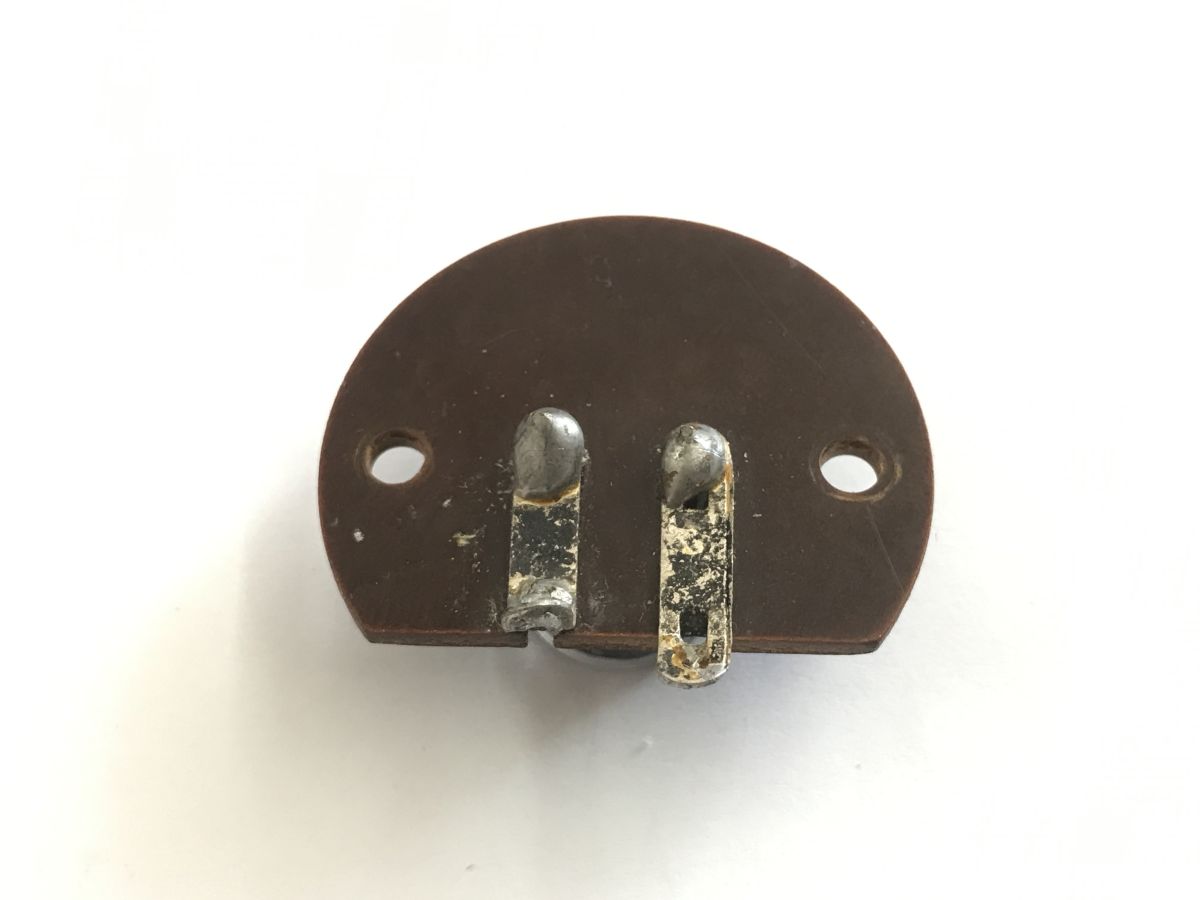

    A photoresistor can help with this - its resistance changes with the light level. I have one myself dating back to a very old time, anyone know what device it might be from?
    Old brown photoresistor with two metal leads and mounting holes .
    Round photoresistor soldered onto a dark board with two mounting holes .
    I also had newer ones, but they were lost somewhere during the refurbishment.

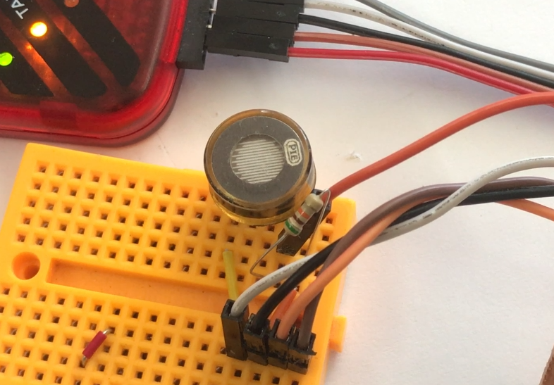

    I removed the potentiometer and replaced it with a photoresistor and a regular resistor. I selected the ordinary resistor so that the different light levels covered almost the entire ADC range nicely.
    Close-up of a photoresistor mounted on a yellow breadboard with connected wires .
    In the end it came out that 0V on the ADC was a very dark environment, 3.8V was a typical bright room, and 5V was a torch light beam directed at the sensor.

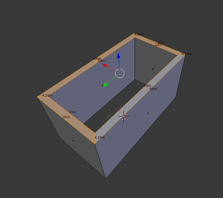

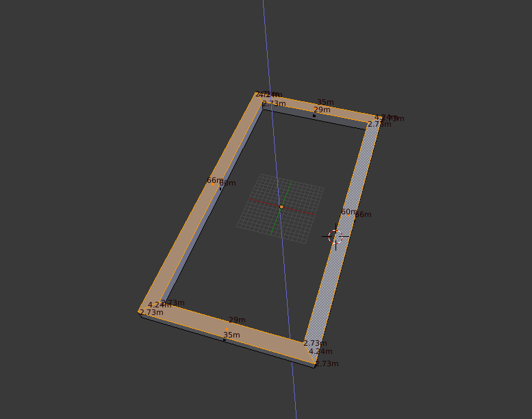

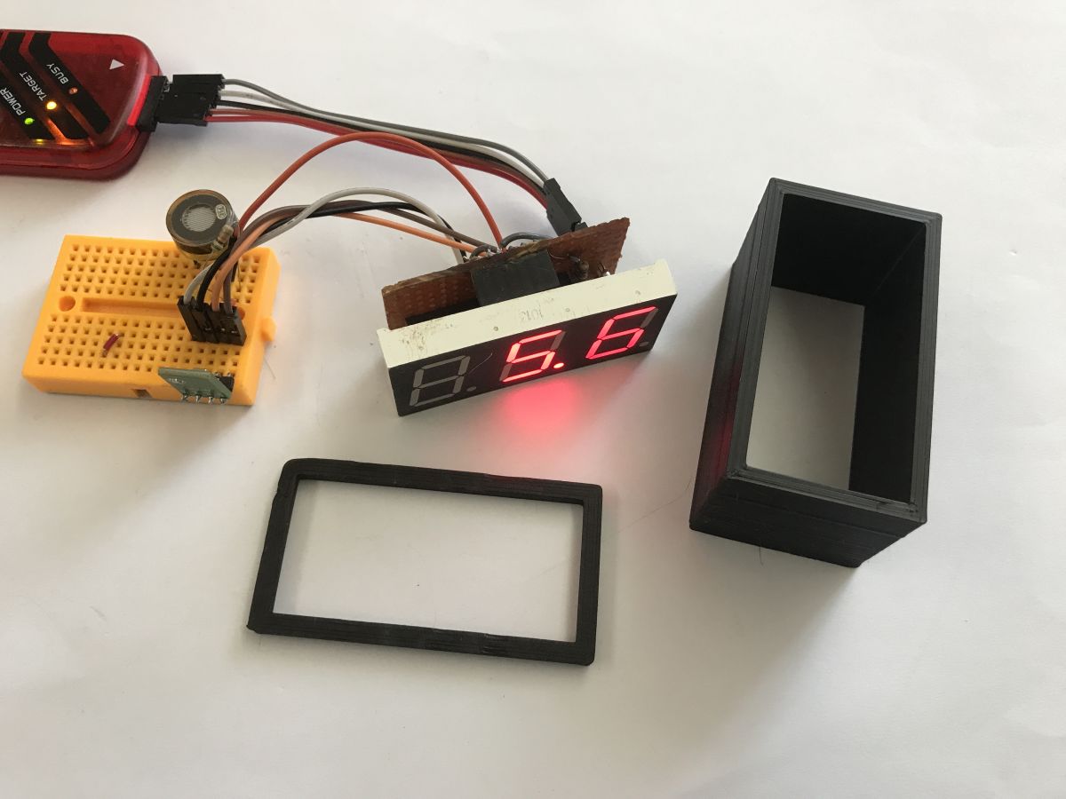

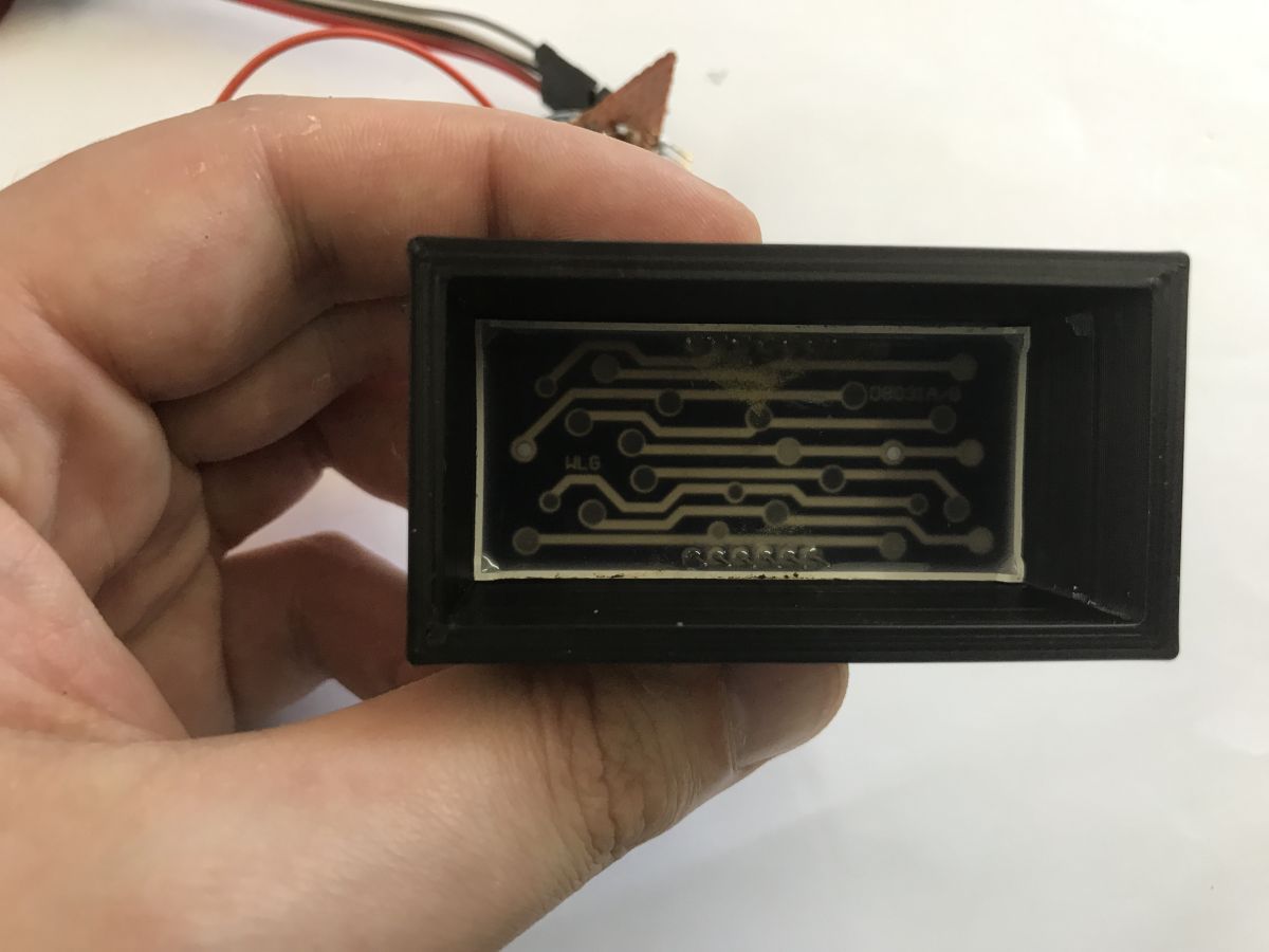

    Case concept .

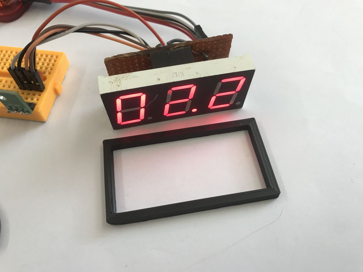

    I wanted to make the enclosure using 3D printing. My first idea was to make the enclosure adjacent to the display. I started by sizing the display and preparing a test print:
    3D model of a frame with dimensions shown in a design software .
    It went smoothly and the shape overlapped the display just right:
    Red 7-segment display with mounting frame on white background .
    It was therefore possible to go one step further.
    3D model of a rectangular enclosure with ventilation slot and dimension labels .

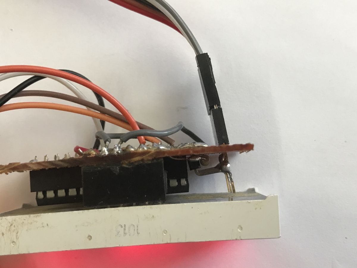

    I sanded down the sides of the board so that it did not protrude beyond the display frame and prepared a deeper prototype:
    7-segment display with microcontroller, photoresistor, and 3D-printed case parts .

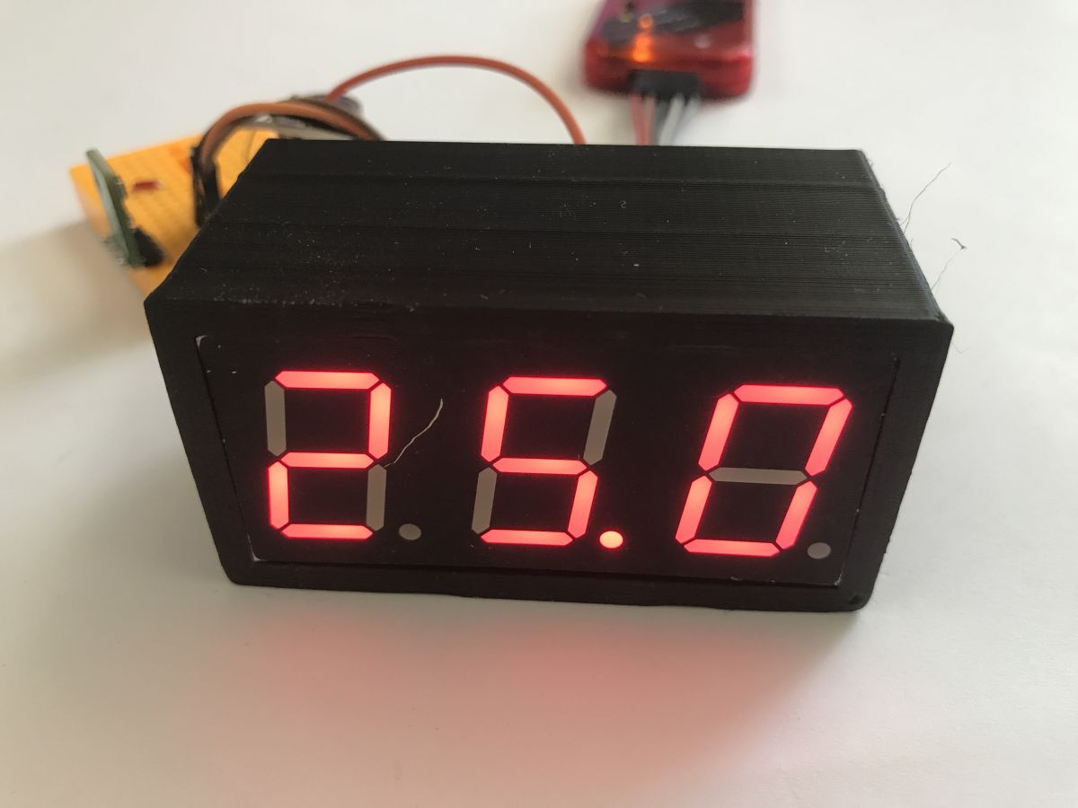

    It fits nicely:
    PCB with 7-segment display in 3D-printed enclosure held in a hand .

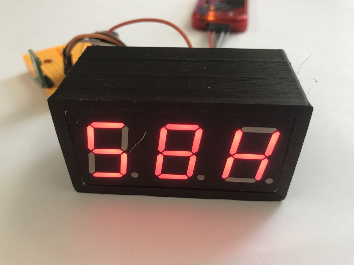

    Initial effect:
    7-segment display in black 3D-printed case showing value 8.8H 7-segment display in 3D-printed case showing value 23.0 .

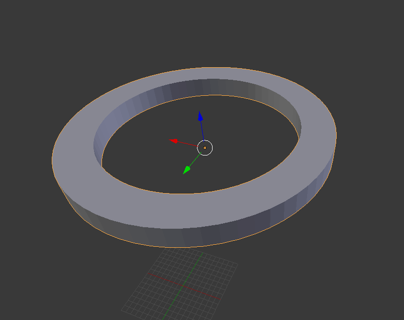

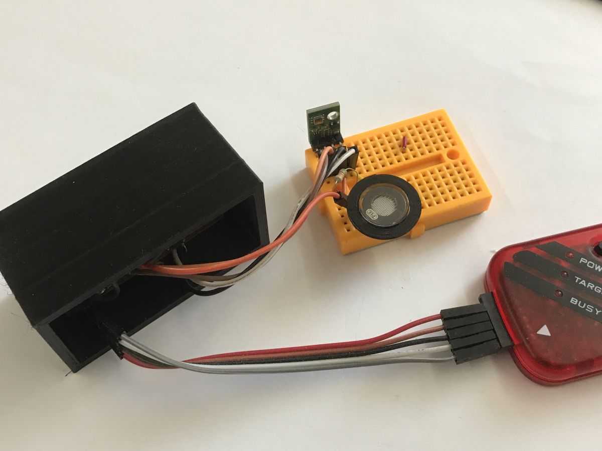

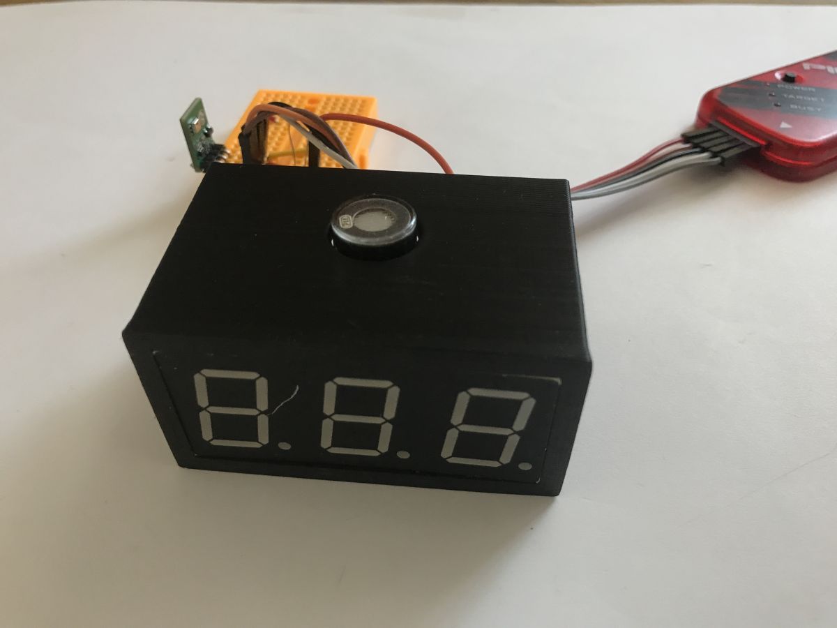

    Worse that such an enclosure does not provide for a photoresistor at all... Time to size it up and do something about it. Test print:
    3D gray ring model with inner hole in perspective view in modeling software .
    Fits:
    Light sensor with photoresistor connected to a breadboard and a 3D-printed enclosure .
    To test the whole thing:
    Black sensor device with LED display and photoresistor on top .
    I'm not sure this is such a good idea....

  • #2 21615205
    efi222
    Level 22  
    Posts: 779
    Help: 12
    Rate: 1219
    With the photoresistor 'on the roof' quite an innovative solution. In the end we will probably end up redesigning the housing and the photoresistor (newer, smaller) will end up on the front.
  • #3 21615362
    Posts: 14763
    Rate: 12893
    Yes, worse, I liked the concept of the display close to the edge of the case. I think I would even reduce the thickness of its walls.... depends where it will stand.
  • #4 21615609
    efi222
    Level 22  
    Posts: 779
    Help: 12
    Rate: 1219
    Maybe give a tinted glass on the front. It would mask the photoresistor and improve the contrast of the displays.

    Such PIE (I think from the National Institute of Electronics) photoresistors were mounted in TVs from the 1970s for automatic contrast adjustment, the so-called "electric eye". I have the same one from a "Coral" TV.
