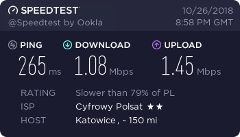

    Hello, for some time I have internet in Plus (Cyfrowy Polsat) once it walked beautifully, but for a few months it started to slow down (the speedtest.net test result below (if I can paste it)), besides, the 32 mb file is downloaded about 25 minutes. I have the impression that maybe it's not the operator's fault, but, for example, the router, maybe something else can be done, somehow check it ...
    Thank you in advance for your response :D

    And on what basis do you think that it is not the fault of the worst mobile operator but the router? What equipment do you have, what is the location?

    How do you think he has a problem like you? So far, it was shown by the speedtest from Plus, where DL is lower than UL, so it indicates that BTS is overloaded. In addition, a low UL level indicates poor signal performance. We do not know if this connection is LTE or 3G, in addition to which LTE / 3G band. on the basis of speedtest there are no grounds for replacing the router yet. You should perform professional signal diagnostics, find out the location of the nearby Plus BTSs, and the bands on which they operate. check which one it connects to. the type of equipment it has is important, the CP offer included several LTE and LTE-A routers, stationary and mobile, router + LTE modem sets and additionally 3 more IDU-ODU versions.

    Hello, I have a DWR-116 router, and I did not mean that it was our fault, not the operator, but I wrote that it was possible and asked if it could be checked somehow. I can not substitute another router. And as for BTS, I'll find out later.

    The modem is responsible for the LTE connection, not the router, this weak set from Plus? If so, the E3372s-153 should be in the HiLink version, i.e. after switching to the USB of the computer, it is managed via the 192.168.8.1 page. Do you have one? You don't learn anything because it won't do anything anyway. Give me the locations better. And of course, don't look for any other router, don't take such advice seriously. Answer the questions about your modem and location. Necessary to perform the appropriate tests.

    Katowice Szymanowskiego Street, yes it's a Hi-link modem and I manage it through this website. Speedtest below, slightly better, as you can see, but not much.

    This is a drama, but in Plus it's easy to predict. Now it's time to test, download http://www.lte-anbieter.info/ltewatch/count_huawei.php?Datei=ltewatch_h or http://www.mediafire.com/file/1yz26m6u8gfl16n/E5186_Toolbox_latest_v0.9.zip/file Connect in them with E3372 at 192.168.8.1 (just like in the browser) and the screen show. They will show the CID of the BTS you are using and the signal parameters. you can force LTE1800, LTE900 and LTE800 in the programs one by one. force one by one, show screenshots of them. on every speedtest. The closest BTS Plus with LTE1800, LTE900aero2 and LTE800Sferi (2 more months) is Kościuszki 289, on BTS at Jankego 123 only LTE1800. other BTSs are Boya 34 (LTE1800) and Kaczeńców 8 (LTE1800, LTE900). The screen shown is proof that you have a weak signal and the BTS may be overloaded DL

    BTS on Kościuszko 289 PSP, LTE1800 aero2 from it, signal sufficient but very low SINR which proves that the BTS is overloaded. What does speedtest look like now because there is a tragedy in the evening, you showed it earlier. As predicted, Plus / CP in Katowice is the bottom, the worst mobile operator has been doing nothing with the network for years. On BTS, he only added LTE900 with 5MHz band, but this is an apparent modernization because it replaces LTE800Sferii, LTE900 works usually slowly but check this band. Click Frequenzband + and from the expanded bands select LTE900 and then LTE800 and check DL / UL and LTEWatchH show for them. Do not count on much, in Plus this operation of the Internet is the norm. it is possible that other LTE1800aero2 BTSs are less clogged, but this will have to be checked.

    Thanks to that, I was able to solve the problem myself.
