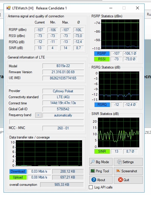

    Parents have bought Cyfrowy Polsat and there are problems.
    Router huawei B315 + AKC 2 uni
    Strzyżów and Frysztak transmitters.
    Place of receipt of Strzyżów or Oparówka.
    From what I see 1800 or 2100
    Usually 2 out of 3 lines.
    The router was to be moved from time to time between Strzyżów and Oparówka, but there are huge speed spikes during the day. The antenna basically gives nothing.
    As for example, at 1am speed reaches 60 80Mbit.
    It doesn't exceed 10 Mbit for the rest of the day. And often it is
    Can anyone tell me whether this region has it or something is wrong.
    If you tell me what to give outside LTEWatchH, I will connect my sentence to my home and check.
    Thank you for your help

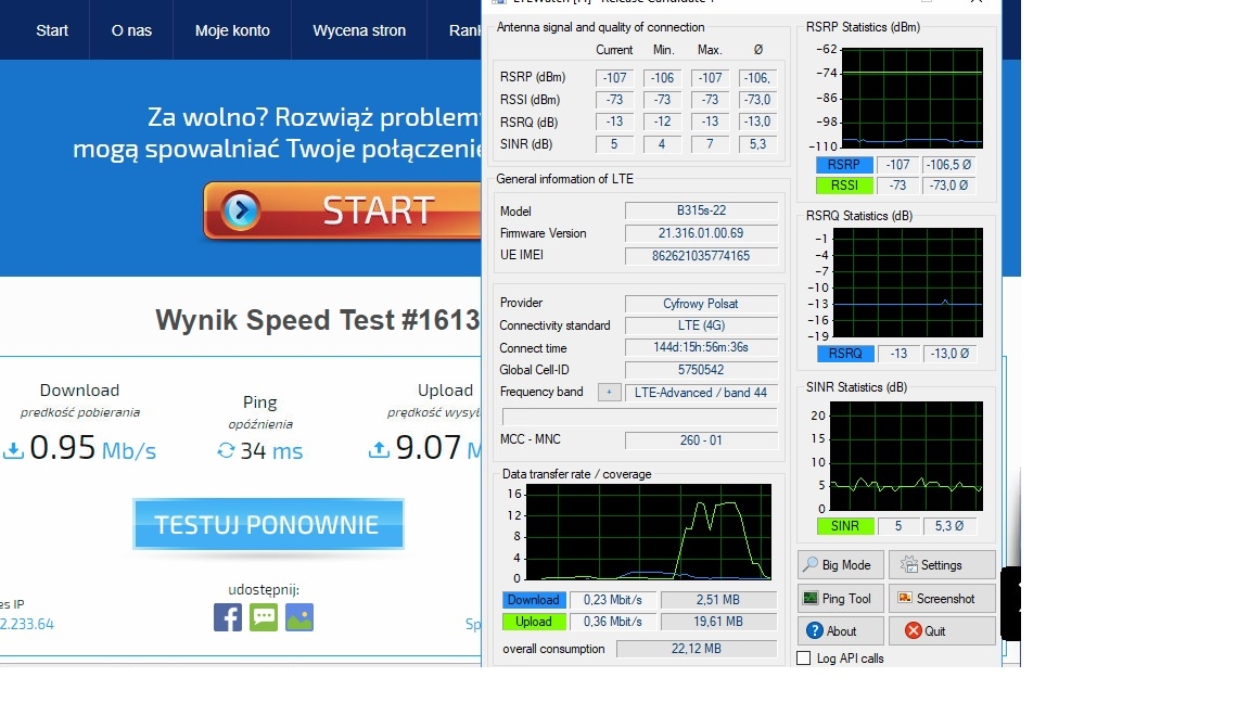

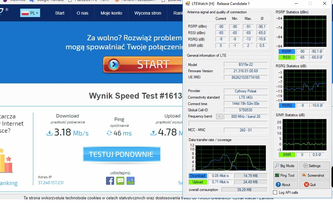

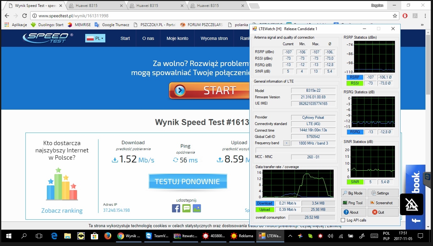

    My results at home (Strzyżów) at the current heavy load. B315 router on the window towards the Strzyżów transmitter. No external antenna:
    800 MHz 2 -4 Mbit connected to BTS 5750530
    900MHz - does not connect
    1800Mhz 2 Mbit connected to BTS 5750542
    2100Mhz - not working
    2600Mhz - not working
    Automatic 2 - 4 Mbit connected to BTS 5750542
    LTE advanced about 4 Mbit with BTS 5750542
    I can't find both BTSs 541 shears and 542?
    So the best would be at home or 800Mhz or LTE advanced. Only what are these transmitters?

    BTS LTE800Sferii is confirmed in Strzyżów, at ul. Departments 33, it also has 3G on UMTS900Aero2. Permits for LTE1800Aero2 but it is not known whether they work, no 3G with UMTS2100. In Frysztak certainly 3G works with UMTS900Aero2 and LTE1800Aero2, no LTE2600. http://www.plusforum.pl/viewtopic.php?f=100&t=7787&p=211131&hilit=Frysztak#p211131 Ustrobna, Czarnorzeki too far the more that forests and hills and it is not known whether LTE1800Aero2 works there, because LTE2600 on the bank does not work . Similarly in the case of Lutcza. BTSearch only shows permits, in the case of Plus these stations and bands exist only on paper. This is the worst mobile operator. Besides, http://www.lte-anbieter.info/ltewatch/count_huawei.php?Datei=ltewatch_h works on the B315. This program allows you to force the B315 LTE band and shows the parameters of the BTS LTE and CID signal. You can force LTE800, LTE2100 and LTE2600 in turn and show screenshots of them. For this speed test. Router is best outside. Without it, it's difficult to know which BTS you are using in the LTE bands, what the signal is and what antenna to buy. In the case of NetWorks, i.e. T-Mobile and Orange, as I wrote LTE1800 NetWorks in Strzyżów and Frysztak, but better coverage from the LTE800 BTS in Żyznów or Cieszyna / Szufnarowa. for these operators also necessary test with forcing LTE bands on B315. Distances from the BTS are large, difficult conditions and the purchase of logarithmic antennas does not make sense. In such conditions, only effective antennas with high gain for a specific band but first a test. And contrary to what you think, the BTSs from the Plus group are overloaded. Networks has better infrastructure based on the operating LTE1800Networks and LTE800 T-Mobile and LTE800 Orange BTSs. In addition, these operators also have unlimited 3G internet with UMTS900NetWorks and everyone on their UMTS2100.
