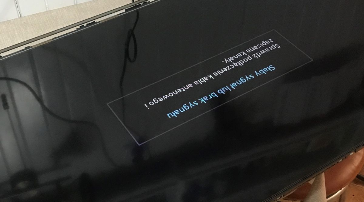

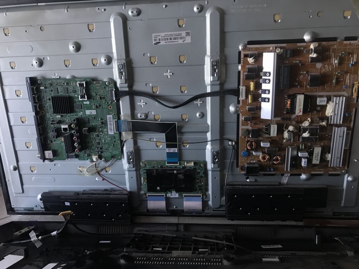

    Today, a 40-inch TV from my extended family comes to the table. The family first tried to have the TV serviced, but the service said it was uneconomical to repair and would cost a few hundred zloty, so we have the opportunity to experiment. The symptom of the fault is simple - the picture is very dark, especially on one side of the screen. Definitely the backlight is damaged. The equipment itself is quite old, from what I can see the 6400 series started coming out in 2013.... so some 10 years old already, but maybe there is something to fight for?
    Label with information about Samsung UE40F6400AW TV. .

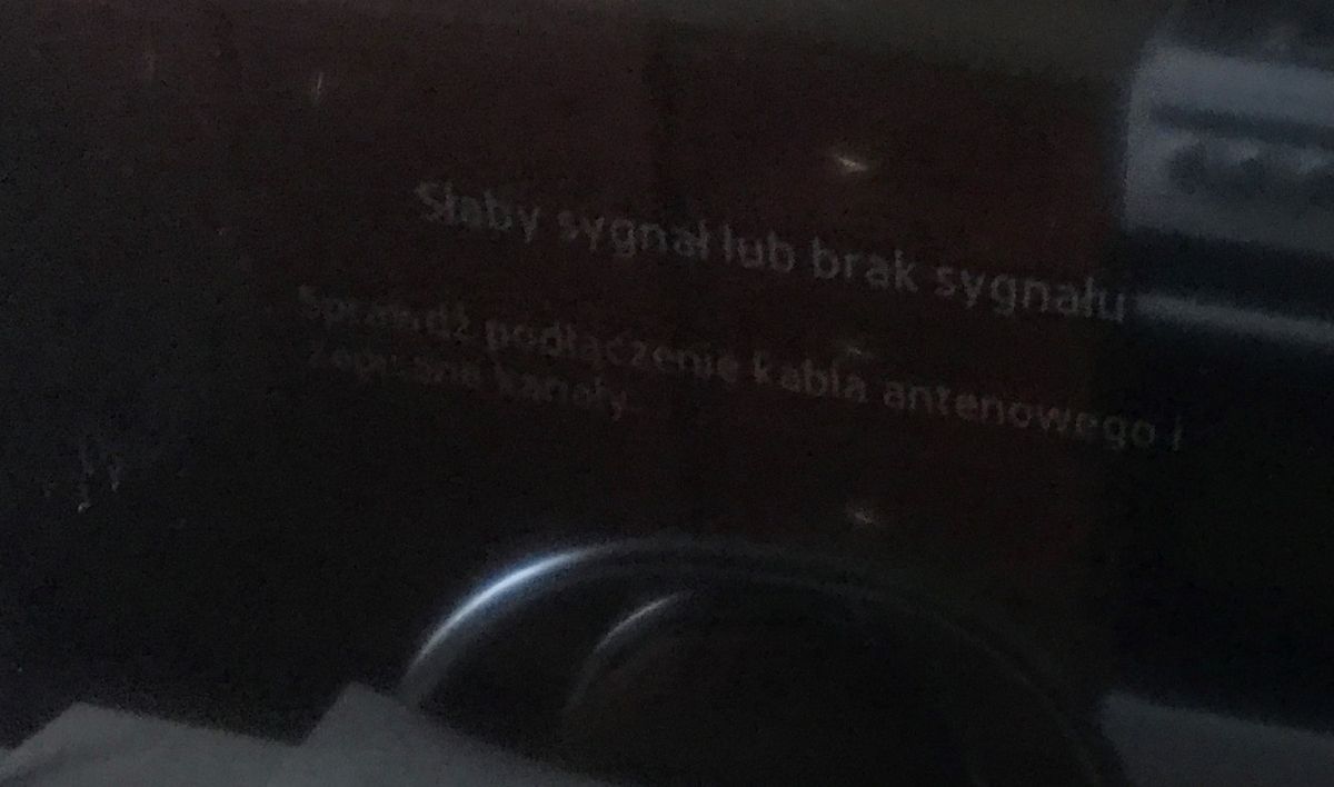

    It's hard for me to show in a photo what the image looks like, but simply the brightness level is very low, although something of the backlight is still glowing:
    TV screen with very dark image and barely visible message. .

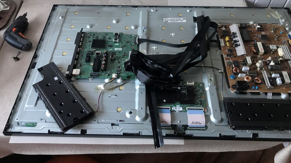

    We take a look inside. First the screws.
    Interior of an open television showing circuit boards and electronic components. .
    Interior of a disassembled TV with visible circuit boards and wires. .
    I don't think I need to check the power supply from the LEDs, as it's almost certainly some LEDs from the backlight strips that are burnt out. It would be different if the backlighting was not there at all. Then one might wonder if it is indeed the power supply or maybe the strips.... you could then use an LED backlight tester:

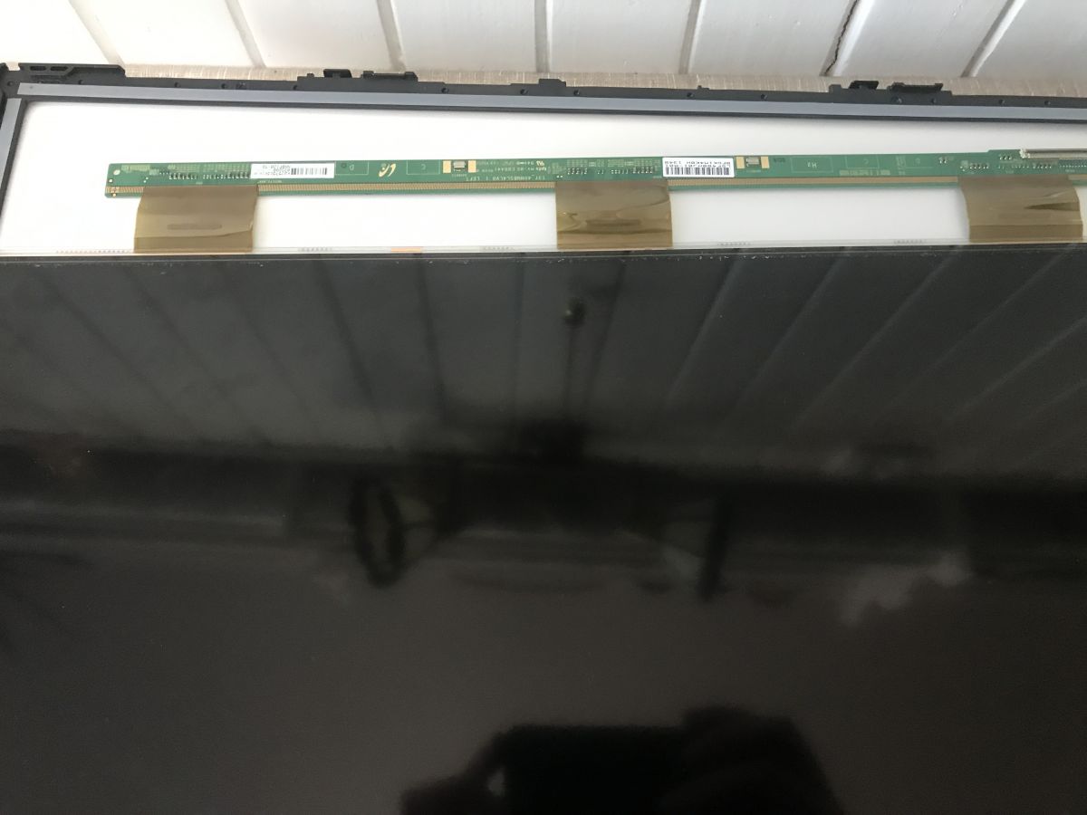

    So you have to get under the screen. The matrix has to be removed, unfortunately. First I remove the tape and metal rails protecting the board from the matrix:
    Disassembled TV with visible internal boards and wiring. .

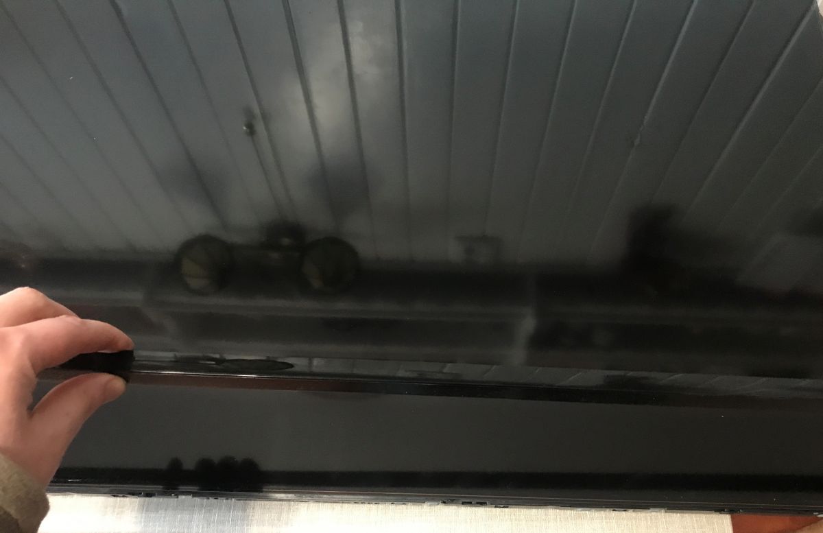

    I remove the plastic bezel:
    A hand holding a partially opened TV screen, revealing dark areas on the screen.
    TV with open casing, partially disassembled screen. .
    You have to be careful with the matrix, because one wrong move and the repair will be totally unprofitable.
    Then I removed the plastic border, it is only on the hooks. I did not take a picture of them this time. I also removed those white diffusion films. This is how I got to the backlighting. You still have to expose the LED strips, because they are covered by a white film that reflects light. It is held in place by plastic parts that you simply twist 90 degrees and pull out - it doesn't break!

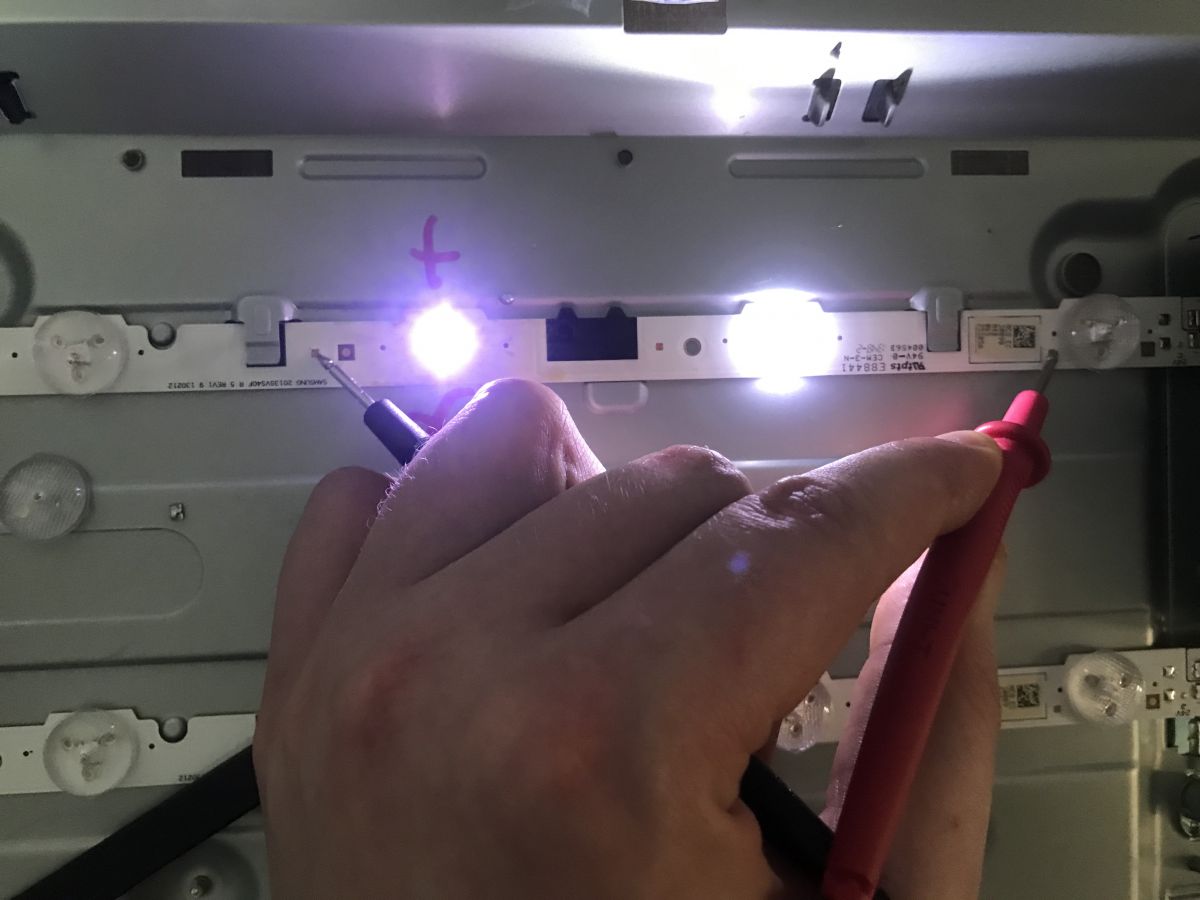

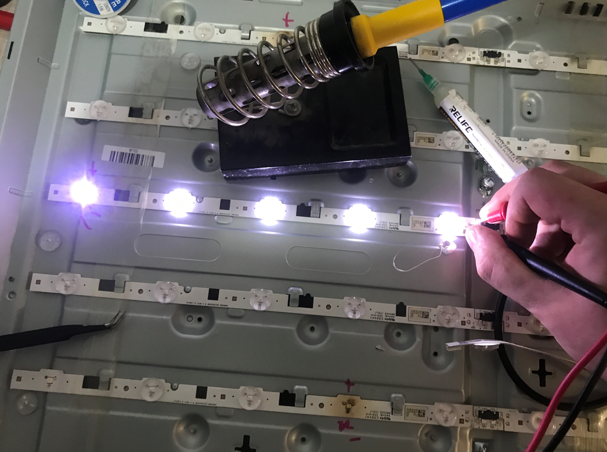

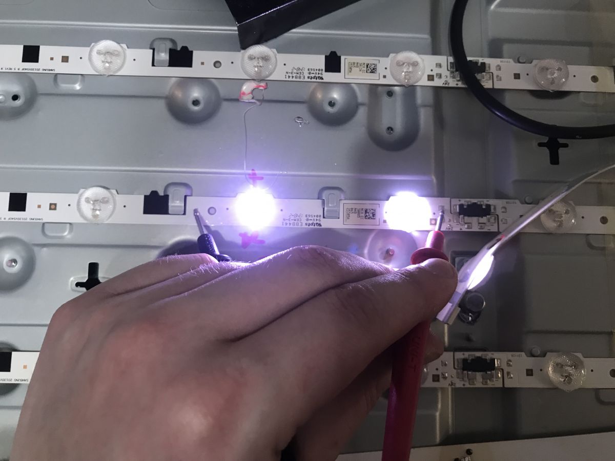

    So let's try this more difficult way. We need to determine which LEDs are damaged. .

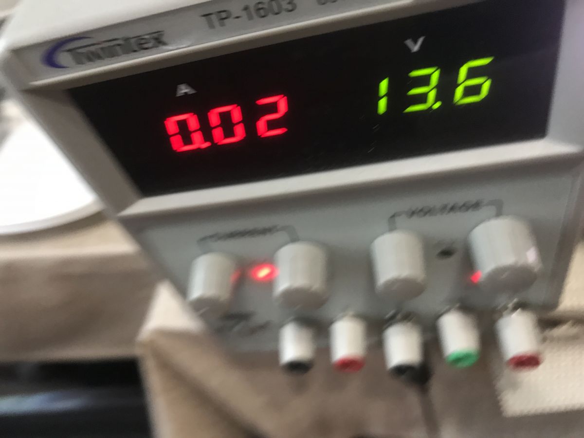

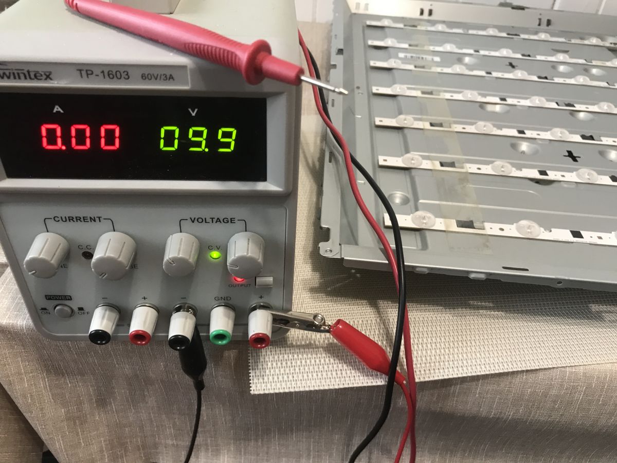

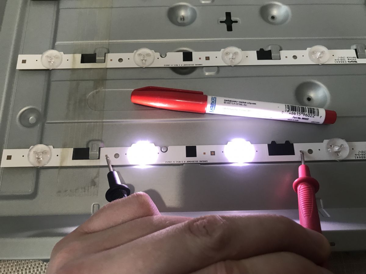

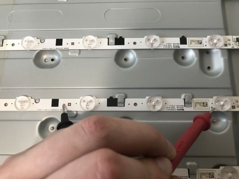

    You can use a laboratory power supply in current limiting mode. This is because the diodes are current controlled. Here there is no calculated resistor to limit the current, moreover there would be losses on it.
    This must be a current-limited power supply, connecting a normal power supply will not work, too much current will flow and we may damage more diodes.
    So, I set the current limit on my power supply as low as possible (only gradually increasing it as needed), connected the probes and started testing:
    Wintex TP-1603 power supply and TV LED panels during repair .
    Two LED strips, with one being tested using power supply probes. .

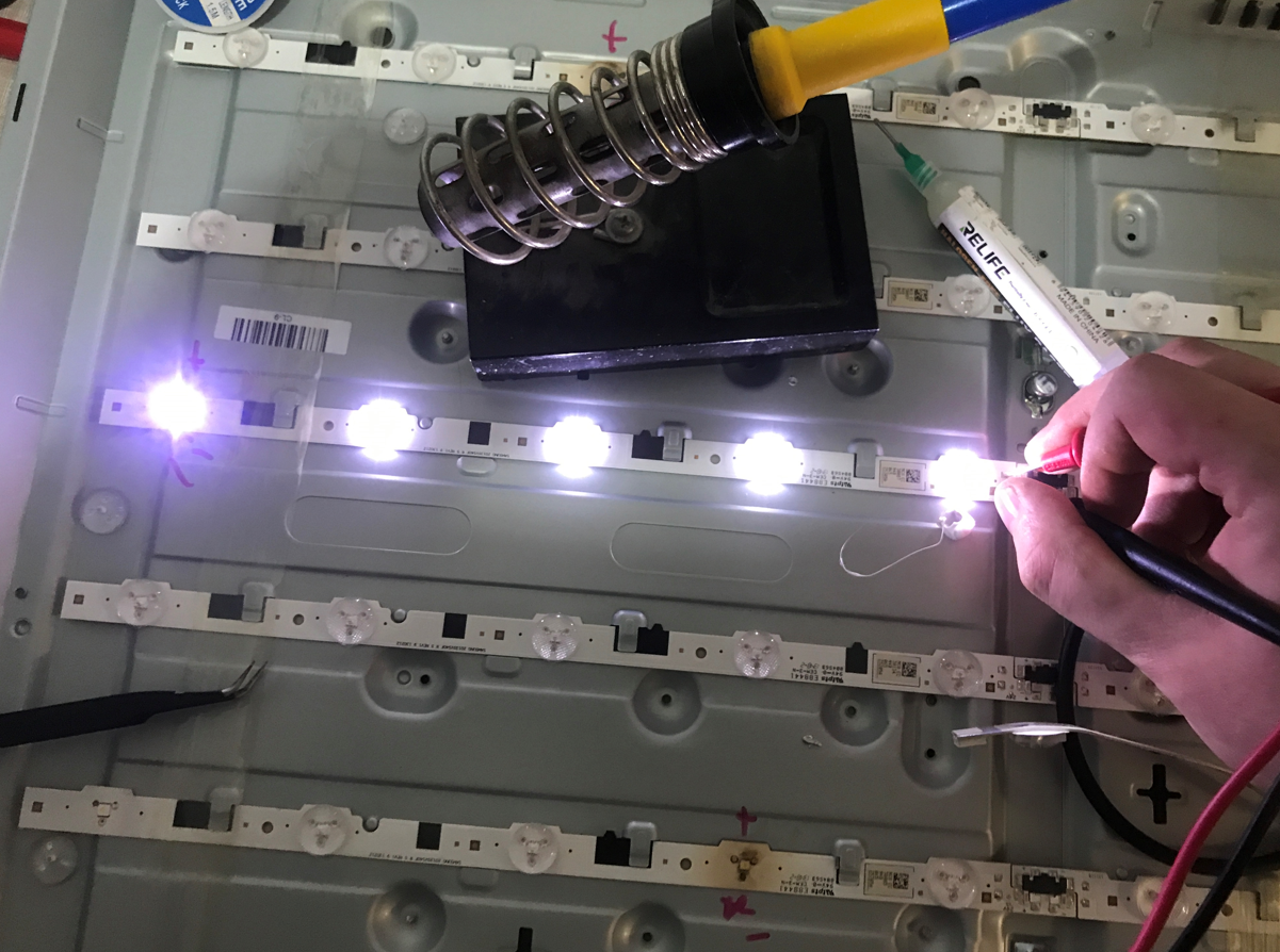

    Indeed, most LEDs light up, but we have to work by elimination.

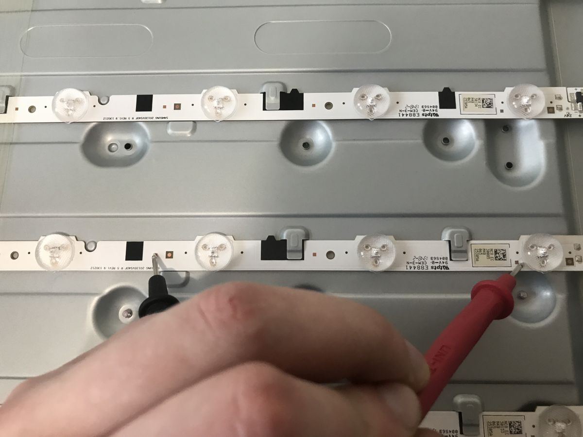

    Measuring TV LED strips with a multimeter. .

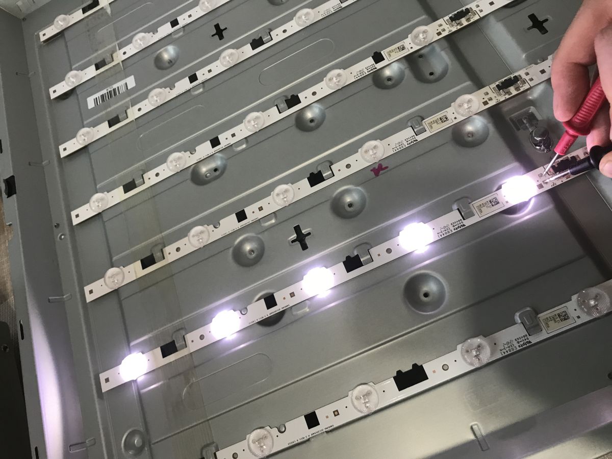

    It's not that difficult, my power supply manages to light up to 5 connected in series:
    Inside of a TV with exposed LED backlight strips, connected to a power supply for testing the diodes. .
    TWIN TEX TP-1603 laboratory power supply set to 0.02 A and 13.6 V. .

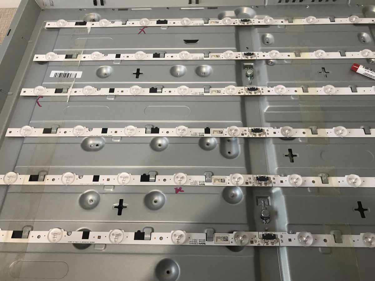

    I put crosses next to damaged LEDs:
    Interior of a TV with visible LED backlight strips .

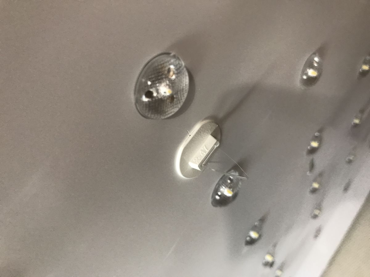

    After removing the glass/diffusers you can see the damage to the LED with the naked eye:
    Close-up of a damaged LED on a TV backlight strip .

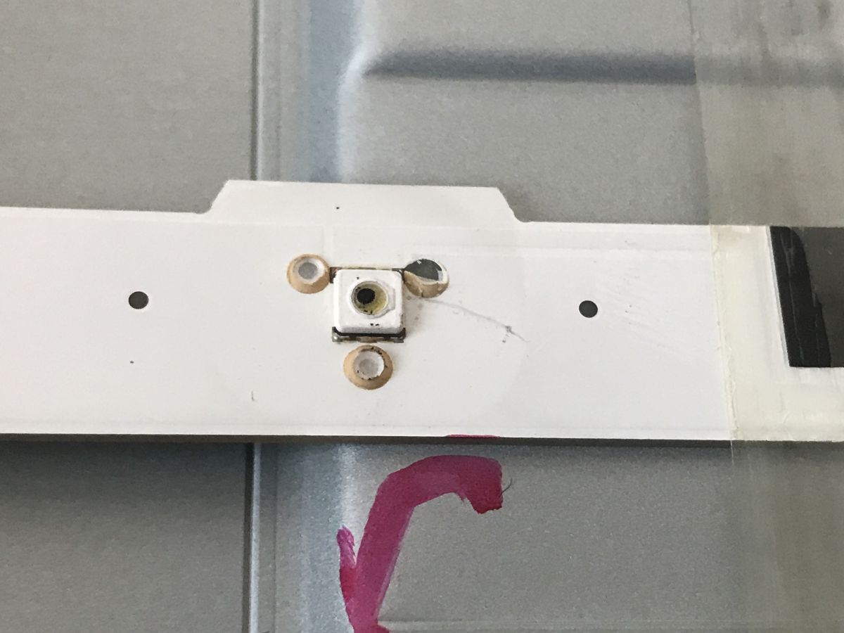

    In addition, I also marked the polarity of the diodes , because here you can't solder them the other way round - fortunately I can trace with the paths where I connected the plus and where the minus so that the others light up.
    The diode now needs to be removed. The diodes hold very firmly, and if you don't remove the strips then the sheet metal also acts as a heat sink. I help myself with flux and sometimes also add lead binder to the solder. It takes a bit of effort, the hot air station has to have the heating power to be able to cope, I have tested some of these stations and not all are as good as they seem:

    With the power supply ready, I tried to select something matching in voltage and brightness from my set of LED strips. Eventually I soldered the new LEDs, with the pads from the LEDs previously cleaned of lead-free binder with braid and applied my own, classic Cynel, as lead binder has a lower melting point and solders better.
    In the photos you can see the 'new' LEDs already soldered in. I have to admit that I blew one of them out on occasion, so it is better not to count "on contact" how many we need.
    A hand holding wires connected to an LED tester examining TV backlighting. .
    A hand holding power supply probes tests the LED backlight in a TV. .
    Testing and repairing LED backlighting in a television. .

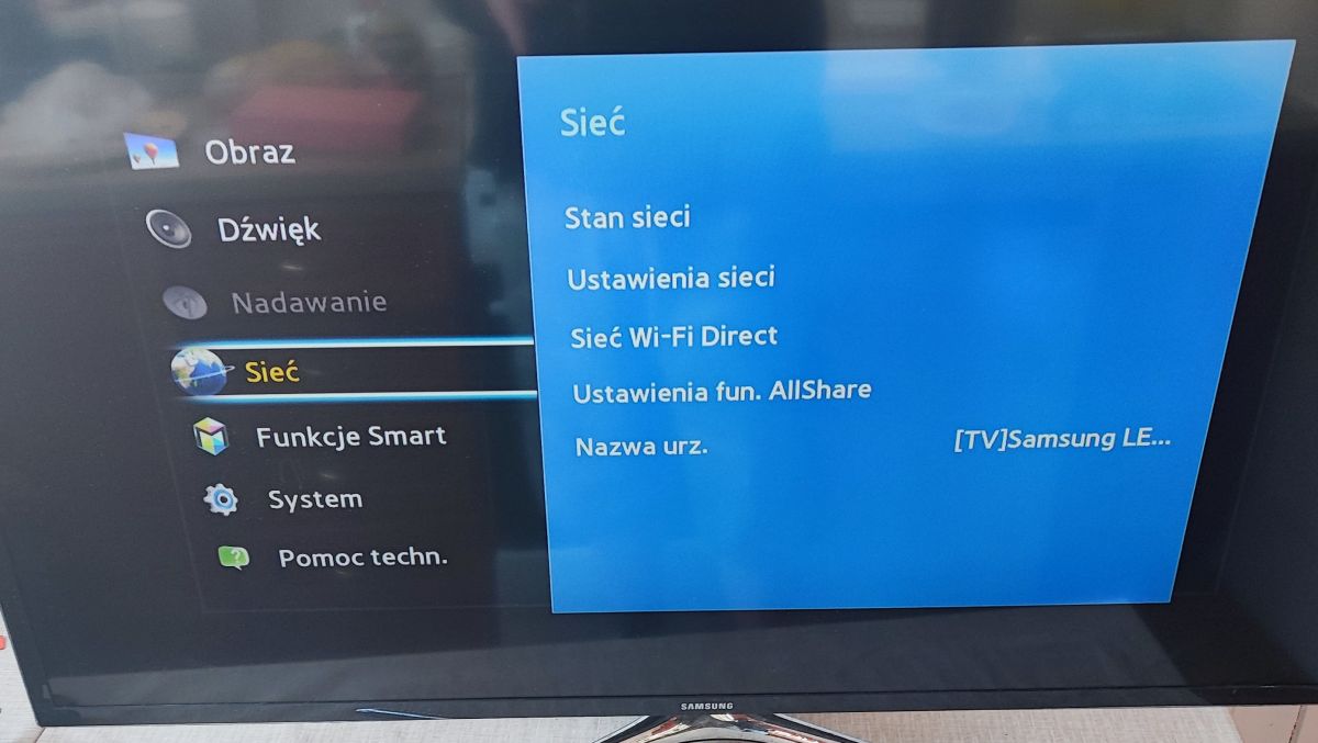

    Assembled:

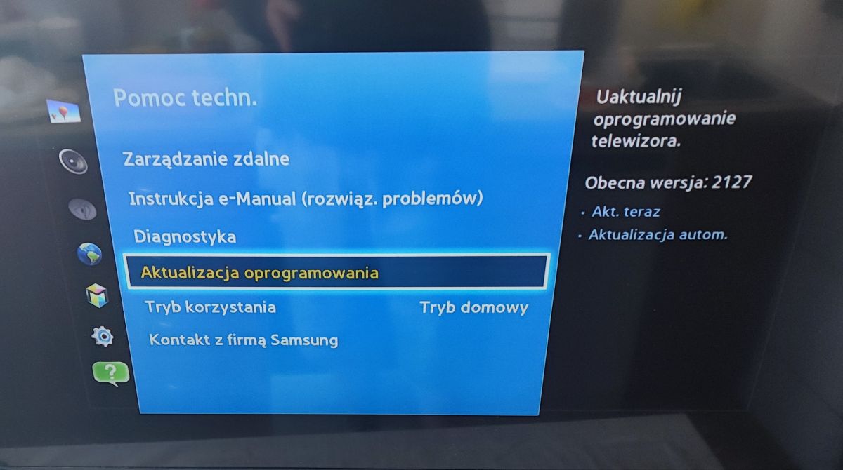

    Technical support menu on a TV screen with a software update option. .
    Samsung TV displaying network settings menu on the screen .
    It seems that everything is working.

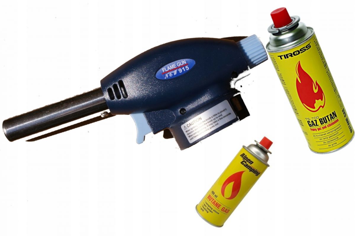

  • Torch heating made LED strip desoldering easier
    #8 21445174
    bulek01
    Posts: 338
    Help: 12
    Rate: 297
    Cool that you were able to fix it. I was working with a similar backlight, but I didn't have the leds to replace them, and exactly the strips I needed are hard to buy(there are newer versions for a different voltage), manta TV.
    I tried leds from led strips (they just had similar conduction voltage), but they are much weaker (footprint was a perfect fit) and have a slightly different voltage and do not hold as much current and burn out. The single led original at my place has a conduction voltage of about 3V.
    I tried unsoldering with a soldering station but it was difficult, the heating was very long. I used a torch and heated the metal part of the strip from underneath and it soldered and unsoldered beautifully, staying with lead-free tin.
    The heat capacity was so high that I had to heat from 30 seconds to get the solder to flow.
