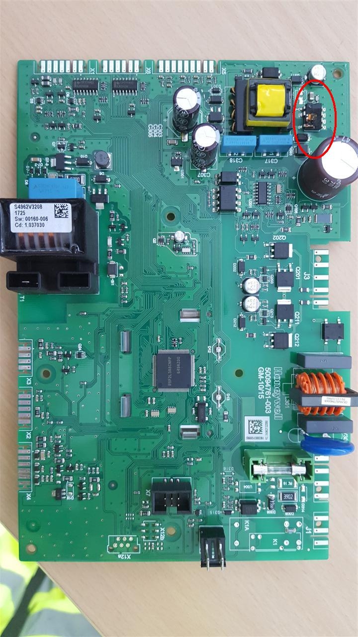

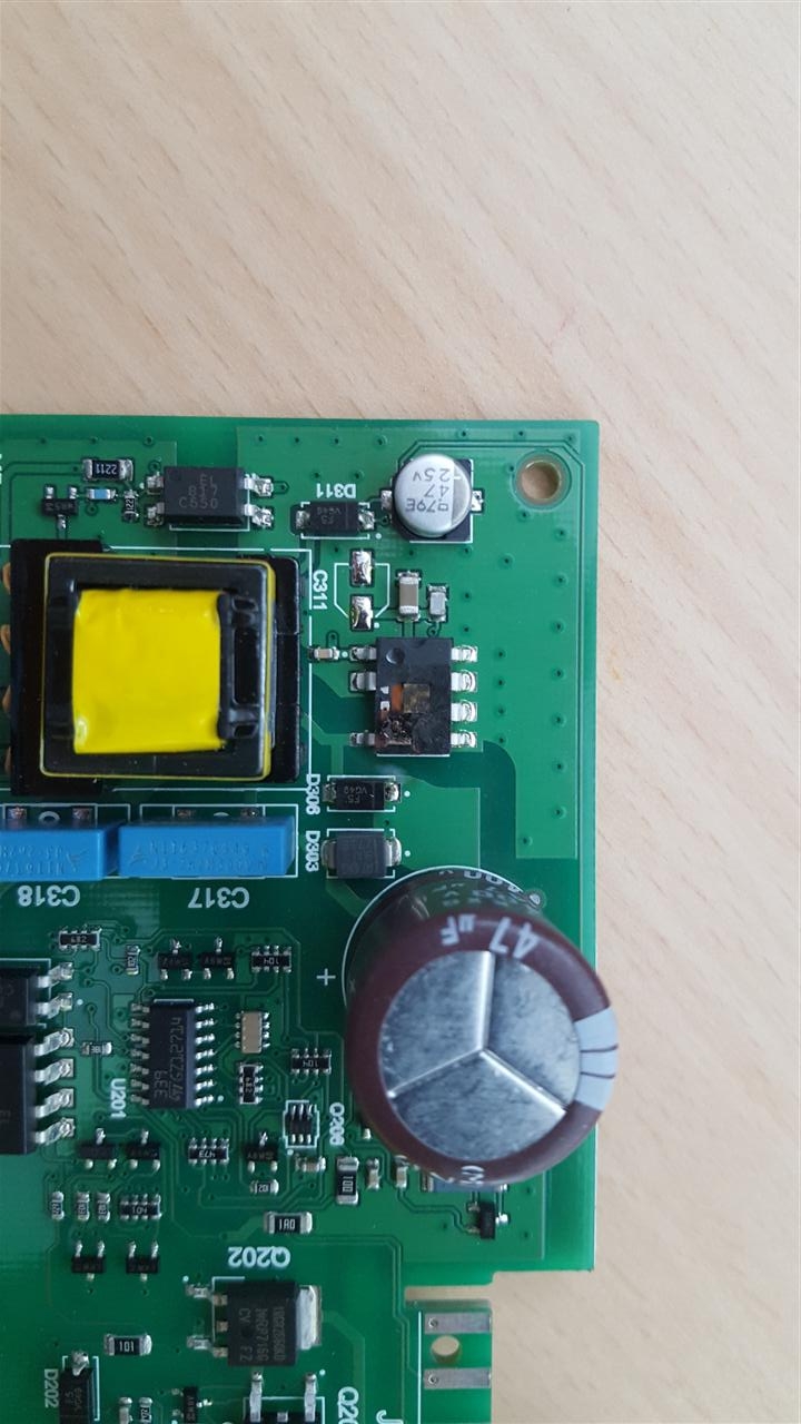

    Good morning, today I am asking for help in finding the designation of the element marked in the pictures below. The photos show the control board used in the Victrix Tera 24 Plus furnace, and the damaged component. Unfortunately, I have not found information about the driver itself (diagram or photos).
    Regards, Czarek.

    A bit late but maybe it will help.

    Thank you for posting the photo. If I read correctly, the damaged chip is marked TNY277GN.
    Regards, Czarek.
    #4 17619488
    pawel3110
    Posts: 351
    Rate: 25
    That's right.
