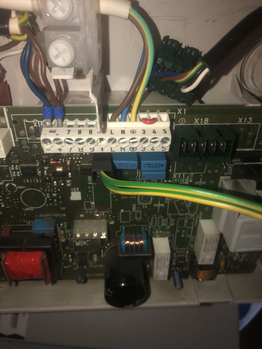

    toretto25
    Pepe, can you mark on the drawing which capacitors you replaced? I have the same problem.
  • #20 19303404
    toretto25
    Thank you very much, I will delegate it to someone else. I'll let you know how the replacement went. For now, I have a new one from a service friend.
    So blue and the two black ones?

    Pepe or start with two twins and possibly the big one? I am a complete layman
  • #21 19304123
    pepe__75
    Posts: 19
    Rate: 49
    Yes, two black 470uF and a blue 100uF.
    I don't know which one was faulty because I replaced all three at once. I recommend you too, the cost is small, and they get damaged over time, so there is a probability that even if you hit the one that was damaged, the next ones will be damaged in a moment.
  • #22 19306272

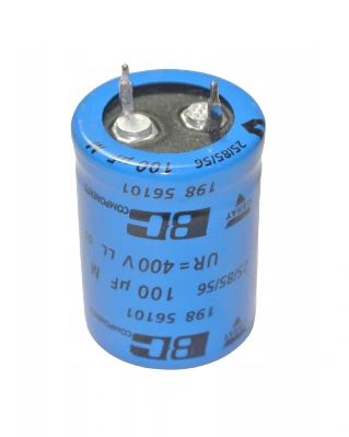

    mmaciaszek
    Does anyone know the dimensions of this large 100uF 400V capacitor? Does it have long thin pins to solder or short thick ones?
  • #25 19699977
    rnb_bolii
    Posts: 4167
    Help: 634
    Rate: 1172
    Each new capacitor has long "legs. So what's the problem ... I can put it in.
  • #26 19700169
    mmaciaszek
    Some have these short and thick legs Vaillant EcoTEC Plus F27 Error: Flame Sensor Issues & Troubleshooting (VC PL306/3-5). They also have different diameters and heights. I would like to have this data to buy the right one without disassembling the board first.
  • #27 19701029
    pepe__75
    Posts: 19
    Rate: 49
    If I remember correctly they were thin long
