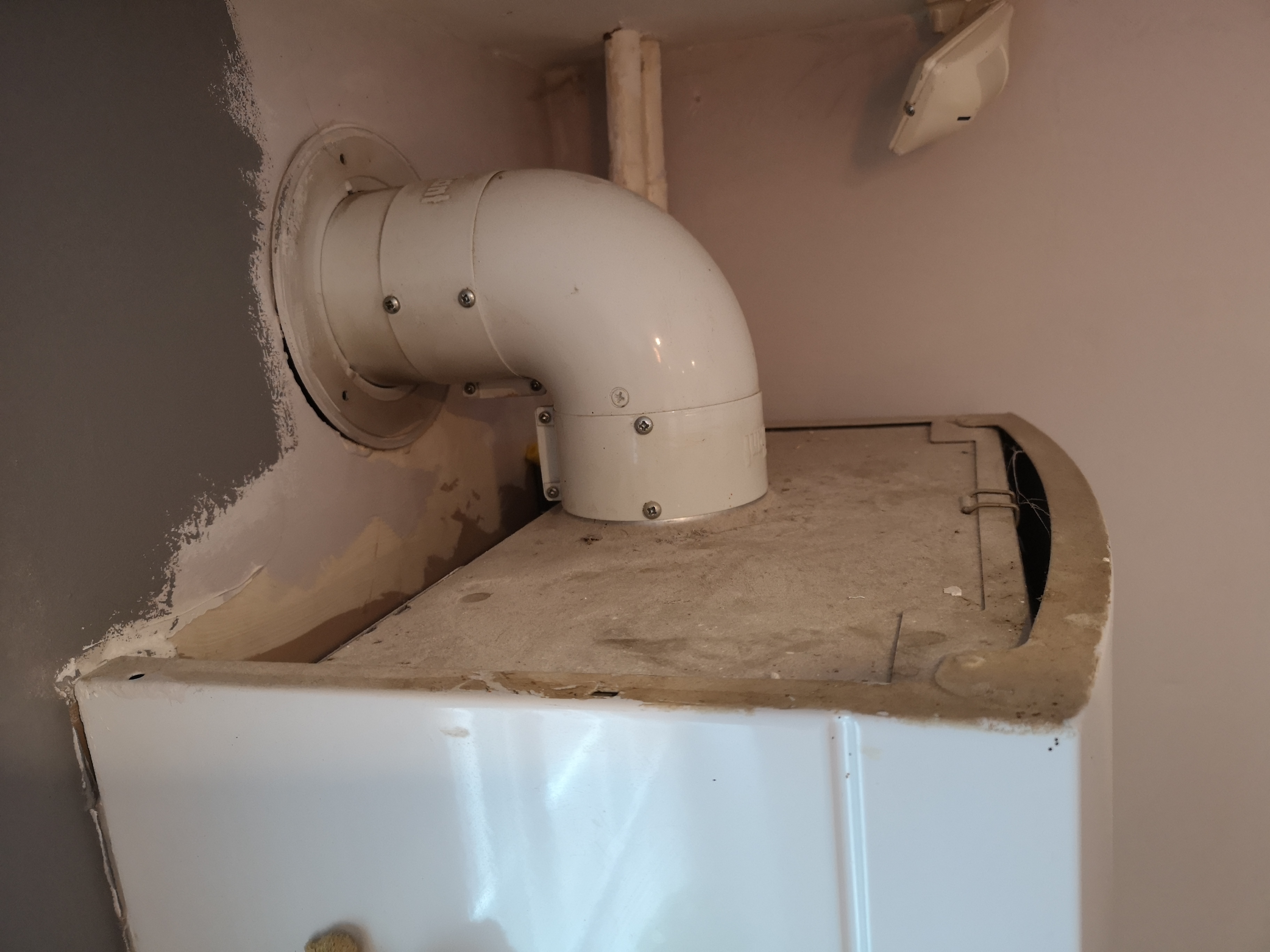

    today my central heating furnace started to roar horribly while heating.
    It is a British Vaillant stove, about 13 years old. The stove heats one circuit - hot water in a 150l tank and heating the house (radiators). The water/heat changeover is done by a valve.
    I hear the roar coming from the upper part of the stove, where the fire is. It's definitely not the pump, because after turning off the heating (reduced to a minimum), the pump still runs a little and does not make such a sound.
    The roaring is so loud that it can be heard loudly 2 floors above.
    I recorded it but be careful with your ears:
    As you can see, the water pressure is correct, I recently bled the radiators and poured anti-corrosion agent into the circuit.
    I am asking for advice, whether I need to replace the furnace, whether a visit to the gas fitter is enough, or is it some trifle that I could deal with myself.
    Thanks in advance for your help.

    #4 17556342
    eljarkos
    Level 21  
    Posts: 462
    Help: 46
    Rate: 104
    Blower to be checked. In a worse scenario, a flue gas installation.

    is it atmospheric or turbo? how to check the turbo fan :) you can also listen to the coil of the gas fittings, but when it hums, it makes a sound of a slightly different frequency.

    I don't know if it's a turbo but it says "fan assisted system boiler", it's a THERMOcompact model but the instructions are the same for the TURBOcompact.
    Indeed, the sound matches the fan, a few days later it already sounds different:
    The instructions are in the attachment.
    From what I can see there is a fan on top of the stove.
    Advice on how to take it apart? You will need to remove the entire furnace casing and disconnect the exhaust pipe:
    Vaillant CO Gas Stove: Loud Buzzing/Humming from Upper Part (13yr old) - Repair or Replace?
    Are there any sensitive components and it's better to have a gasser do it? (I seriously doubt). Will it be a matter of cleaning the fan or are any bearings failing there?

    As far as I remember disassembly was not a problem. I do not know your manual skills, so if you have any doubts, ask for a visit from a service technician. Something could have just fallen into the fan, and if not, the service technician should diagnose faster if the fan is suitable for replacement.

    Thanks. I have abilities, it gets worse with time, but I'll take care of it.
