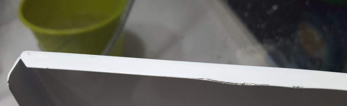

    A licensed fitter installed a gas stove in my bathroom today.
    The effect below.
    He wrote down PLN 150.
    He installed the same model of the furnace in place of the old, damaged one. For the PLN 150, he screwed in two water hoses and a gas pipe, plus its mounting to the wall with a clamp.
    In order not to disassemble the stove in order to tighten the hooks, the poxilina went in motion. Maybe it sounds weak, but in this way I eliminated the gap between the wall and the stove housing.
    It's just blowing.
    The stove fires up after a few seconds.
    Previously, I had the same stove and after 7 years it did not blow, and it fired very quickly after 1.5 seconds.
    I omit the fact that he probably inserted the casing with his foot.
    In six months it will rust.
    "Installer" installed a gas stove - years, it blows.
    In my opinion, this is a badly adjusted stove. What's next? Call a service technician is it under warranty or what's next, etc.? Maybe just some professional fitter? (this one was also professional)

  • #8 16839073
    marek.nosal
    Level 4  
    Posts: 54
    I am after a visit from a service technician from Vaillant.
    It describes:
    The service technician enters the room, measures the sensor to see if there is any gas leakage from the valve to the stove.
    After a while I release the hot water tap in the sink.
    Same effect as in the video above.
    The service technician takes out a screwdriver and bends the ignition electrodes hard.
    I fire up again. Same effect.
    The service technician puts the screwdriver in an unspecified place and after a while says that it should be like this and that it is correct.
    I explain that sometimes the flame escapes behind the furnace casing. My translations for nothing.
    I ask why did he bend the electrodes if now he says everything is fine? It is a roundabout route from Krakow to Warsaw via Budapest.
    I see an "olewka" of a service technician here. ... "because this stove has that and it doesn't start for a long time".
    What do you advise?
