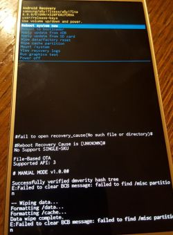

    I was able to go to Recovery:
    Samsung SM-A520F Firmware Upload Issues: param.bin.lz4 Timeout Error with Odin and Z3X
    Continued: data wipe/recovery was throwing an error.
    I ran ''reboot to bootloader.''
    And the phone booted up, sort of okay. Like because frp is still there. Will it be possible to get through it somehow. Regards
