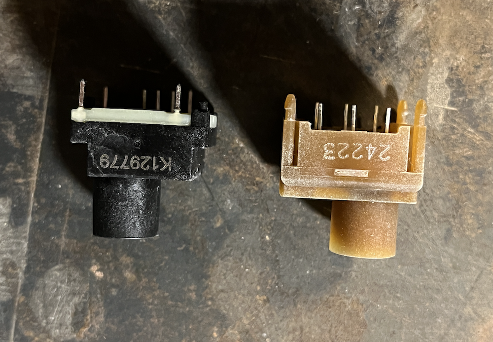

Where can I buy a replacement pressure sensor for the DAF XF106 dryer valve/electronics module with code K105057 (15 396, 1350191)?
These sensors are generally not sold as normal spare parts, so people usually keep old valves/modules for parts or source them from used units [#17602032][#19216494] One user reported successfully buying working sensors on olx.ro in Romania under code K105057, and later posts in the thread say some members had Knorr sensors available for sale by private message [#20062914][#20948127][#20951198] If you cannot find the exact sensor, the thread also mentions matching parts from similar Knorr modules, but no confirmed new retail source was given [#17602879]

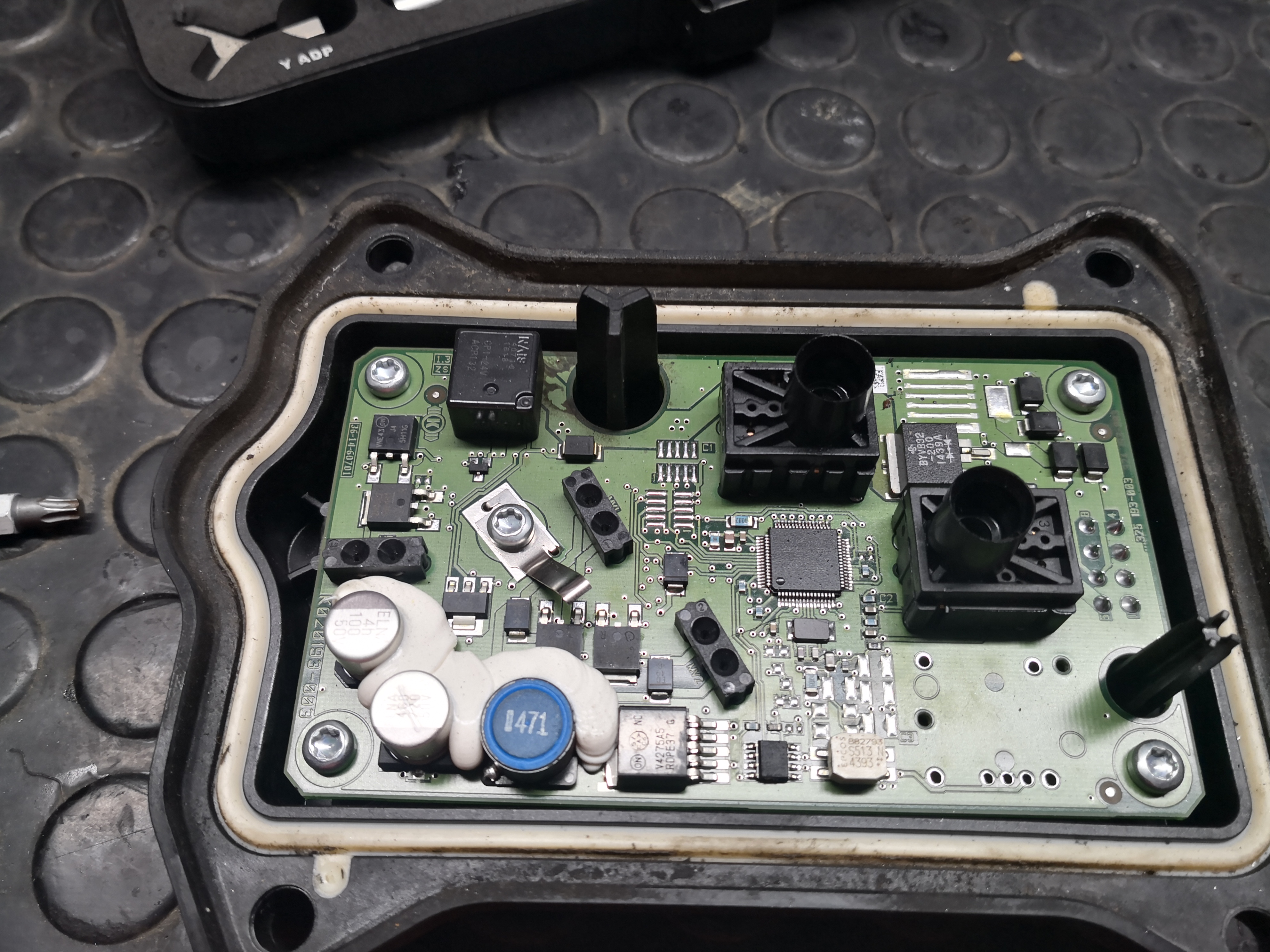

    Offers the repair of the dehumidifier electronics
  • #45 19814315
    Kuba47321
    Posts: 10
    TruckElectronica wrote:
    Price ?
    700 for two circuits is 900

  • #50 20062914
    popaadrian02
    Hi guys, I bought these sensors from a site in Romania and I installed them and they work, is olx ro and I was looking for this code K105057

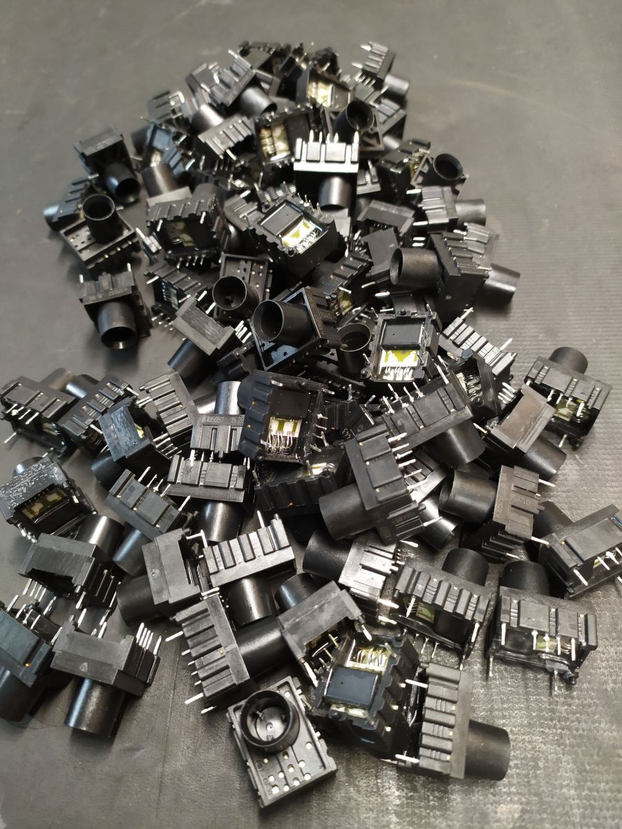

    Hey guys,
    I have Knorr sensors available for sale if anyone's interested. Please message me here.
    Two Knorr sensors placed on a dark background.

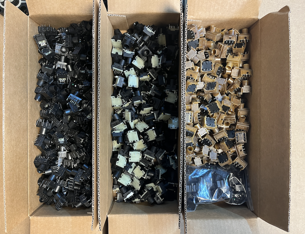

    cardswithmusic
    I have sensors available if anyone still needs them. Please send your email in a message, I'll get back to you. Three boxes filled with different electronic sensors of various colors and shapes.

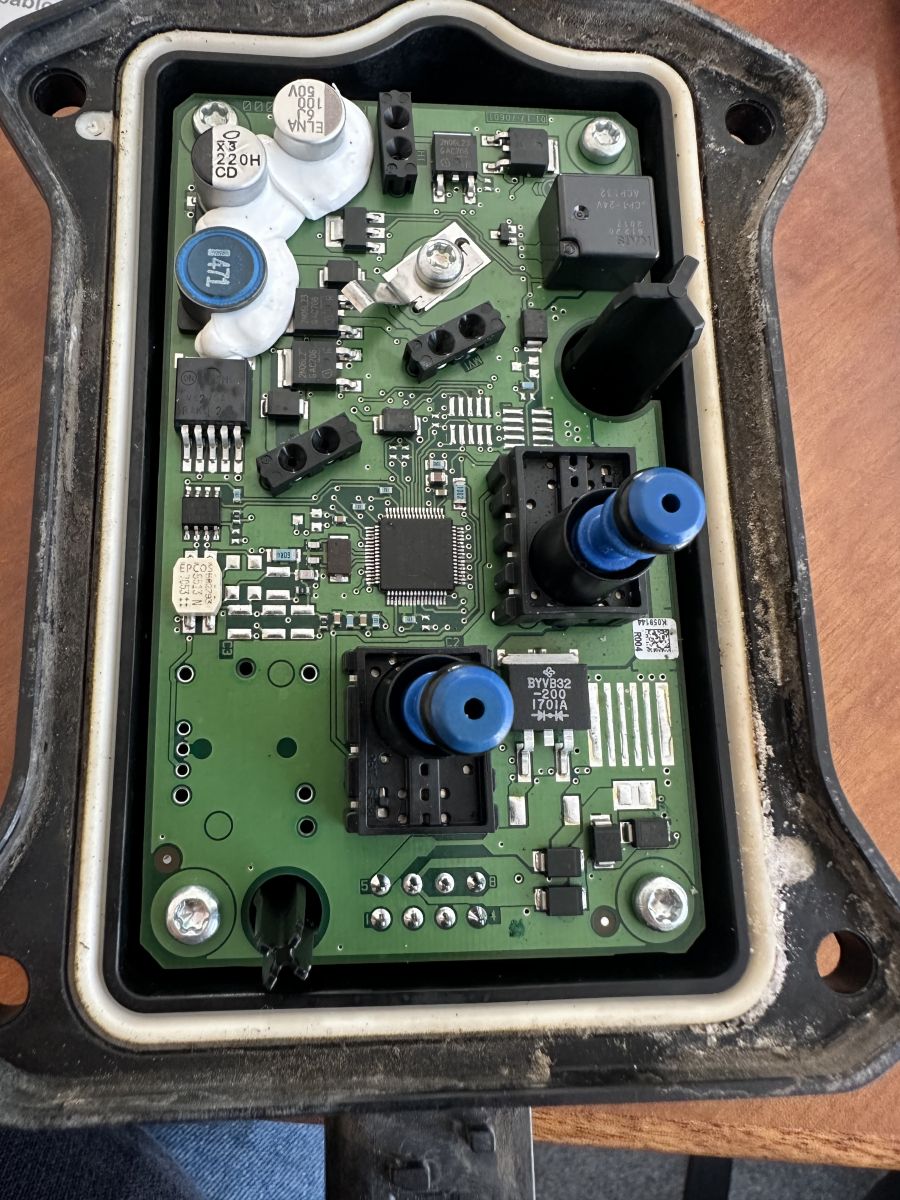

    Need help with re-soldering to new sensors and of course buying sensors, please contact me if you are familiar with the subject
    Circuit board with electronic components inside a housing.

    Do you know for sure if the sensors are faulty? Sensors are quite expensive at the moment because of the high demand for them.
  • #57 21381750
    PawelMajdaf
    I don't know, can they be checked to see if they are good or 'burnt' / damaged?
