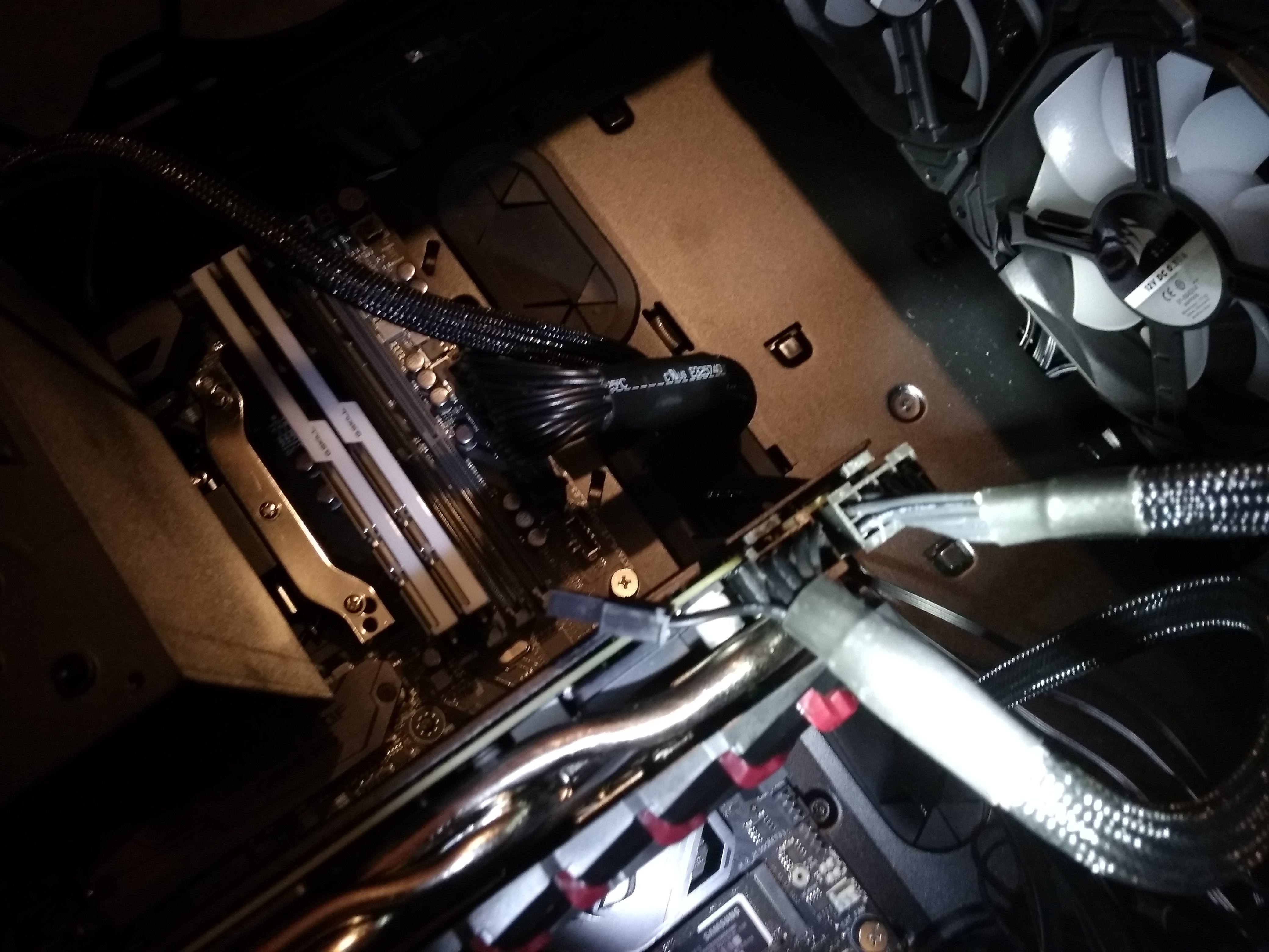

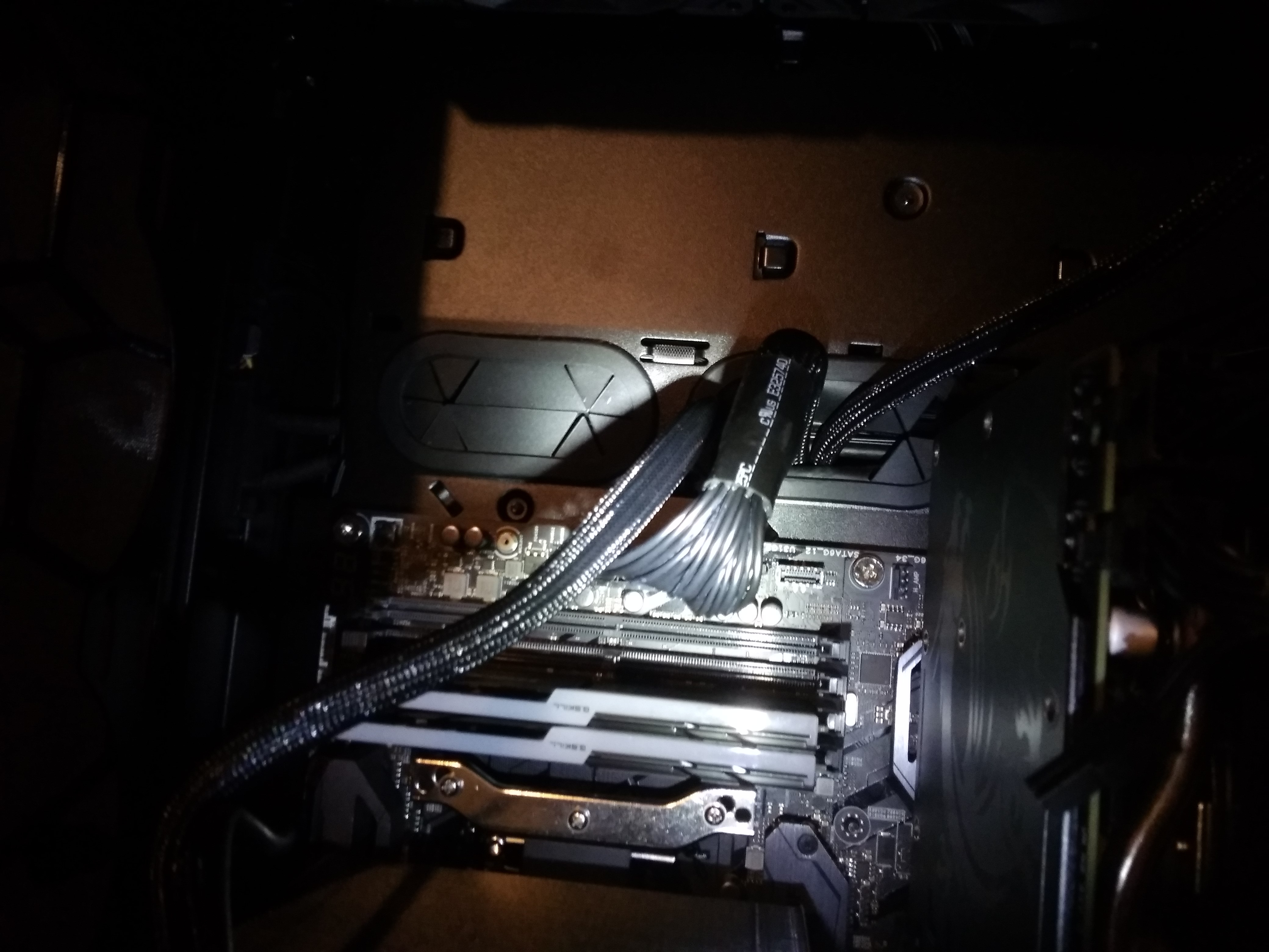

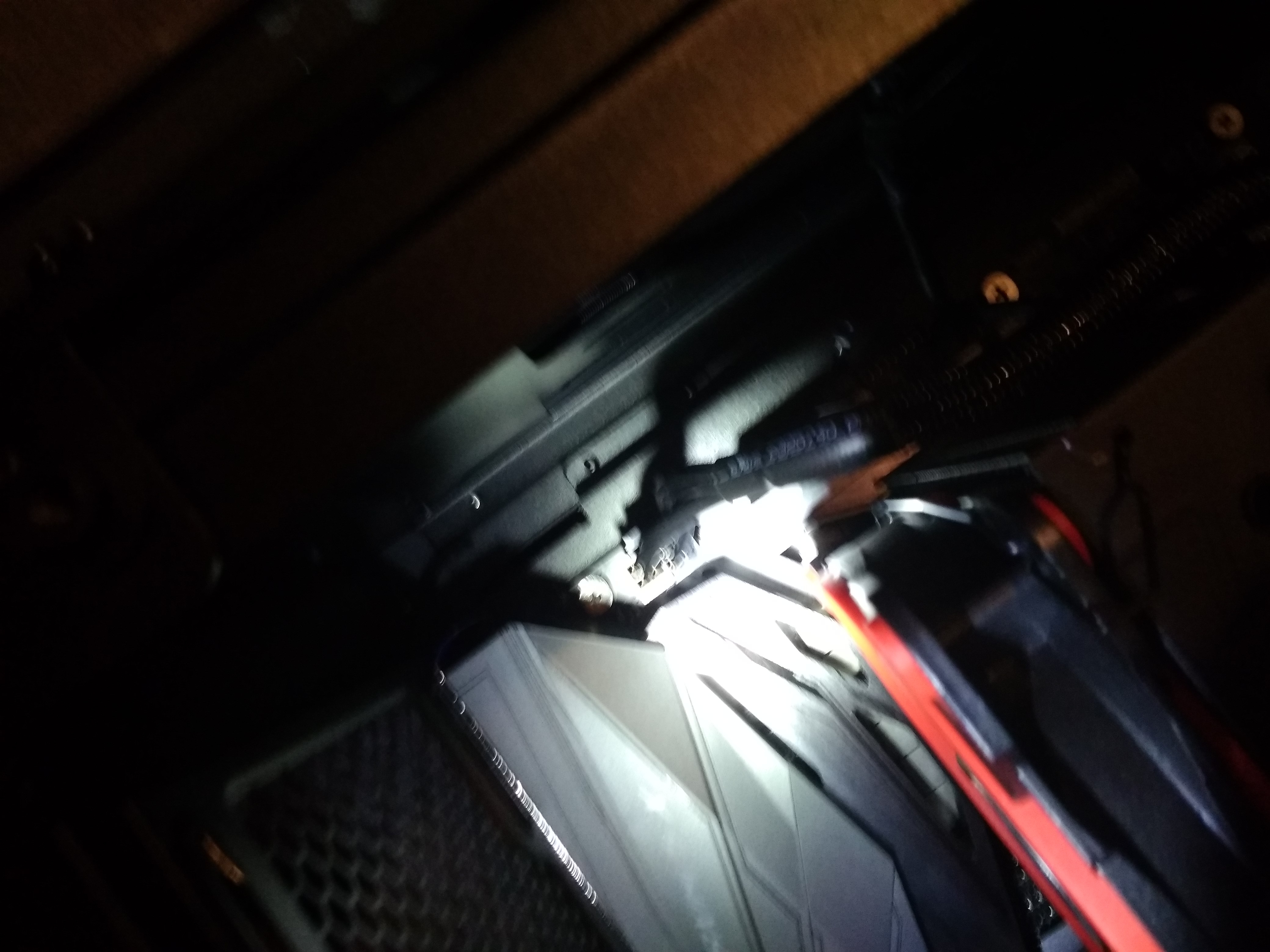

    A day ago I bought parts for a new computer, the whole computer assembled by myself.

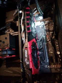

    The problem is as in the title, after turning on the computer everything works as it should, but after 10-30s the GTX 1070ti Gaming graphics card from MSI stops working and the message * Please power down and connect the PCIe power cables for this graphics appears on a black background card *

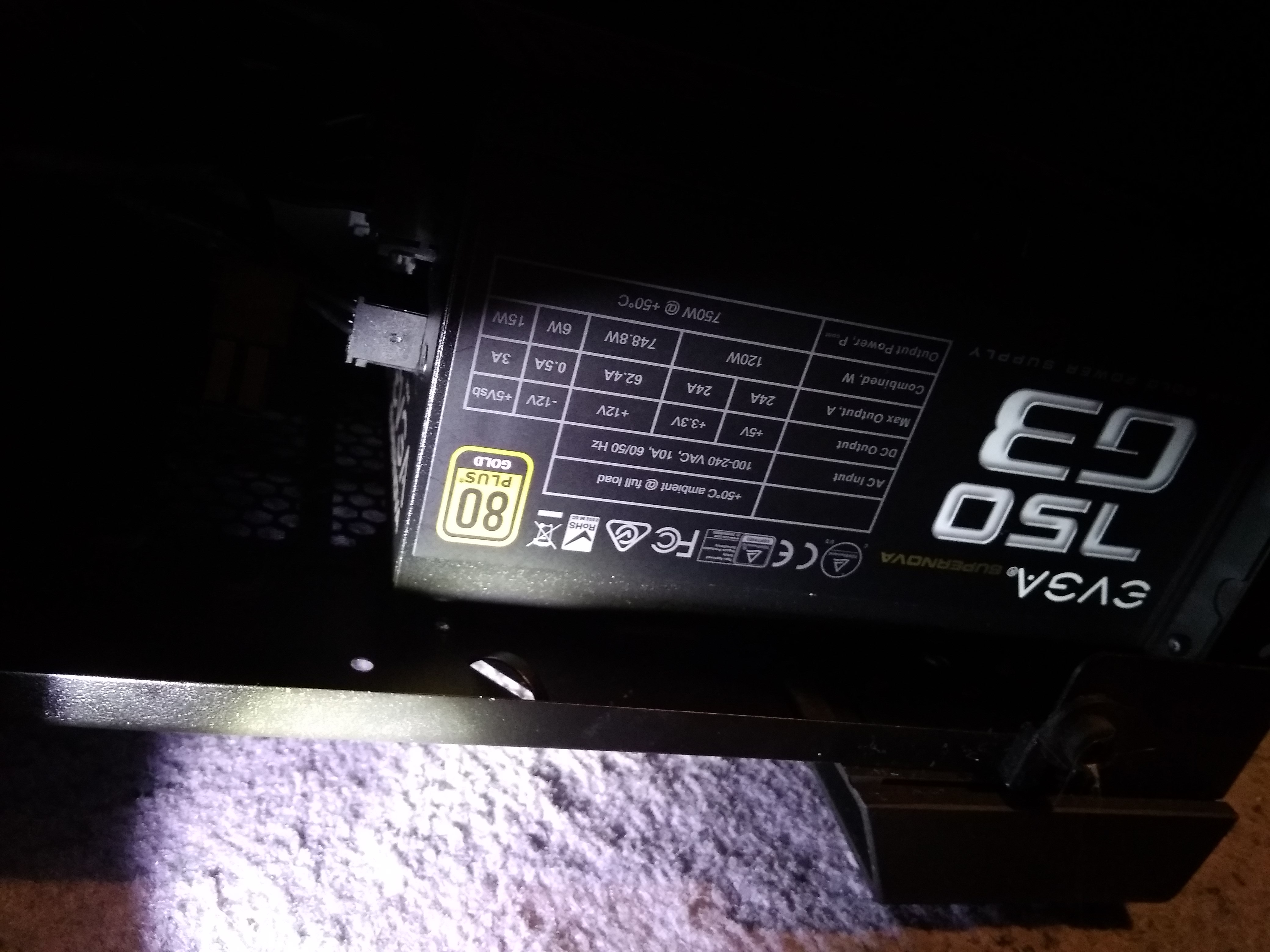

    Both inputs on the graphics card are connected, I checked various cables from the EVGA g3 series 750W 80+ gold power supply kit.
    After connecting the older gtx 1060ti Gaming card, the computer works, the bios starts. The new gtx 1070ti card works on the old computer also without any problems.
    What could be wrong, I've been sitting there for hours, browsed forums, can there be a problem with the cabling?
    The card is 100% functional, the bios on the second card also worked on the motherboard, and the processor also flashes. The graphics card is connected to VGA, I also checked the second card slot, the same problem.

    What power supply in the old computer? Did you connect it to your current computer?

    Unconnected cable, checked a million times if everything is well connected, it turned out that it was not ...
