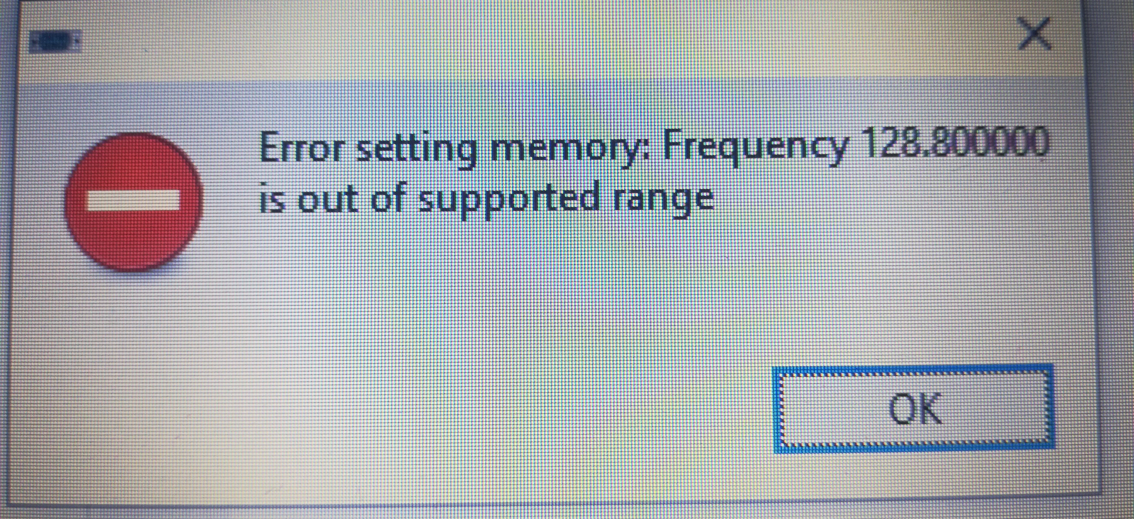

    Thank you :) I have only one but I can't enter any of these frequencies, e.g. 128.800 why ?? Too low bandwidth ??? I get this message :( Error setting memory: Frequency 128.800000 is out of supported range. Or maybe you have to enter it differently so that it would be ok ?? Please give me a hint. I remind you that I have the Baofeng UV-82 radio

    Below 130MHz you won't go down, I checked UV5R.
    Try it, type 130MHz on the keyboard and start scanning down, TRX will fly at 176.987MHz.

    It's not like you write. It all depends on how you defined the tuning ranges.
    Read:
    https://www.elektroda.pl/rtvforum/topic2415290.html#11495860

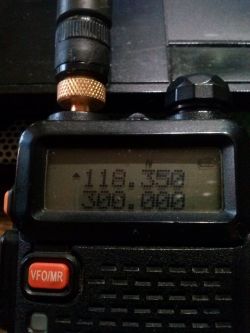

    Below photos taken a moment ago:
    Guidance on Frequency Input for Baofeng UV-82 Radio Phone for Scanner Use

    In a word, you have to forget about this band and that's about it :( It is a pity because I was always interested in what is going on there ... Or maybe someone has a link to a page with some other bands, e.g. Services? only more current.

    @Marcin_O DJ from what I know, the air band is AM modulation and these Baofeng_i do not support it. :cry:
