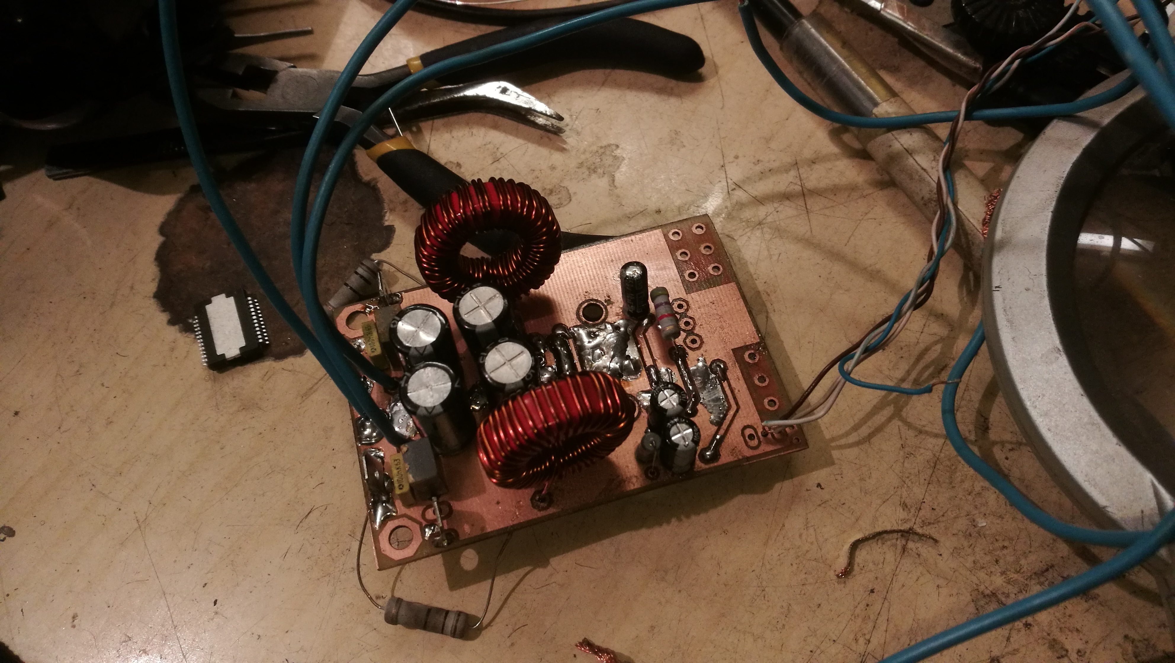

    I have a problem with the TDA8954TH amplifier, after connecting the power supply, the R2 resistor immediately burns and DC appears on both outputs. The amplifier doesn't even start the oscillator.
    I tested on 7 chips and 3 plates. Pcb checked several times for assembly errors and I did not find any. Capacitors, resistors measured before each replacement of the power amplifier and before starting, checked for short circuits.

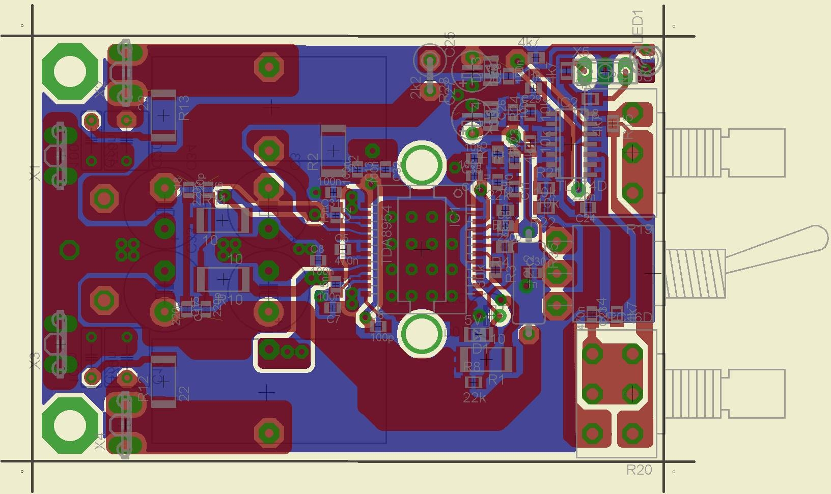

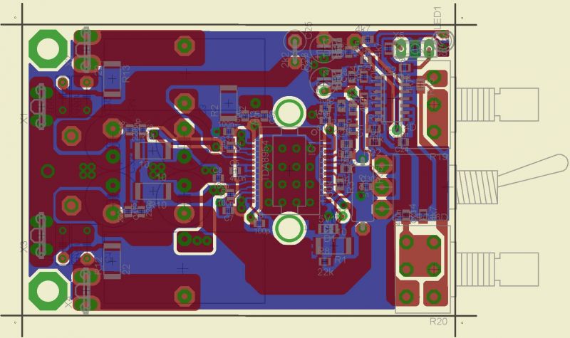

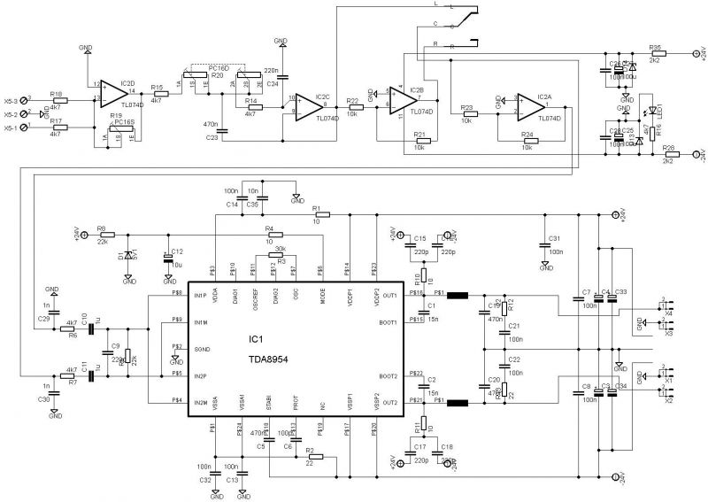

    In the attachment there is a schematic diagram, a pcb diagram and a photo from the auction with tda8954.
    Please check the correctness of pcb paths, maybe I made a design mistake and I can't see it. Tomorrow I will have chips from a Polish store and I do not want to fast with smoke again.

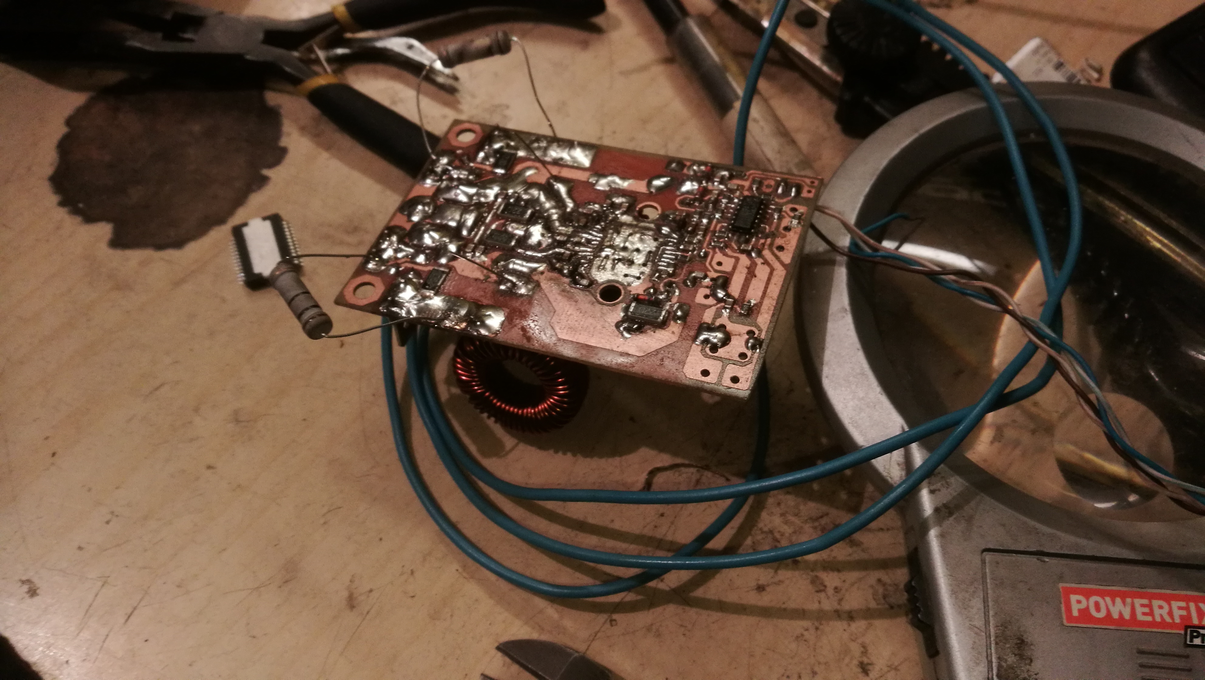

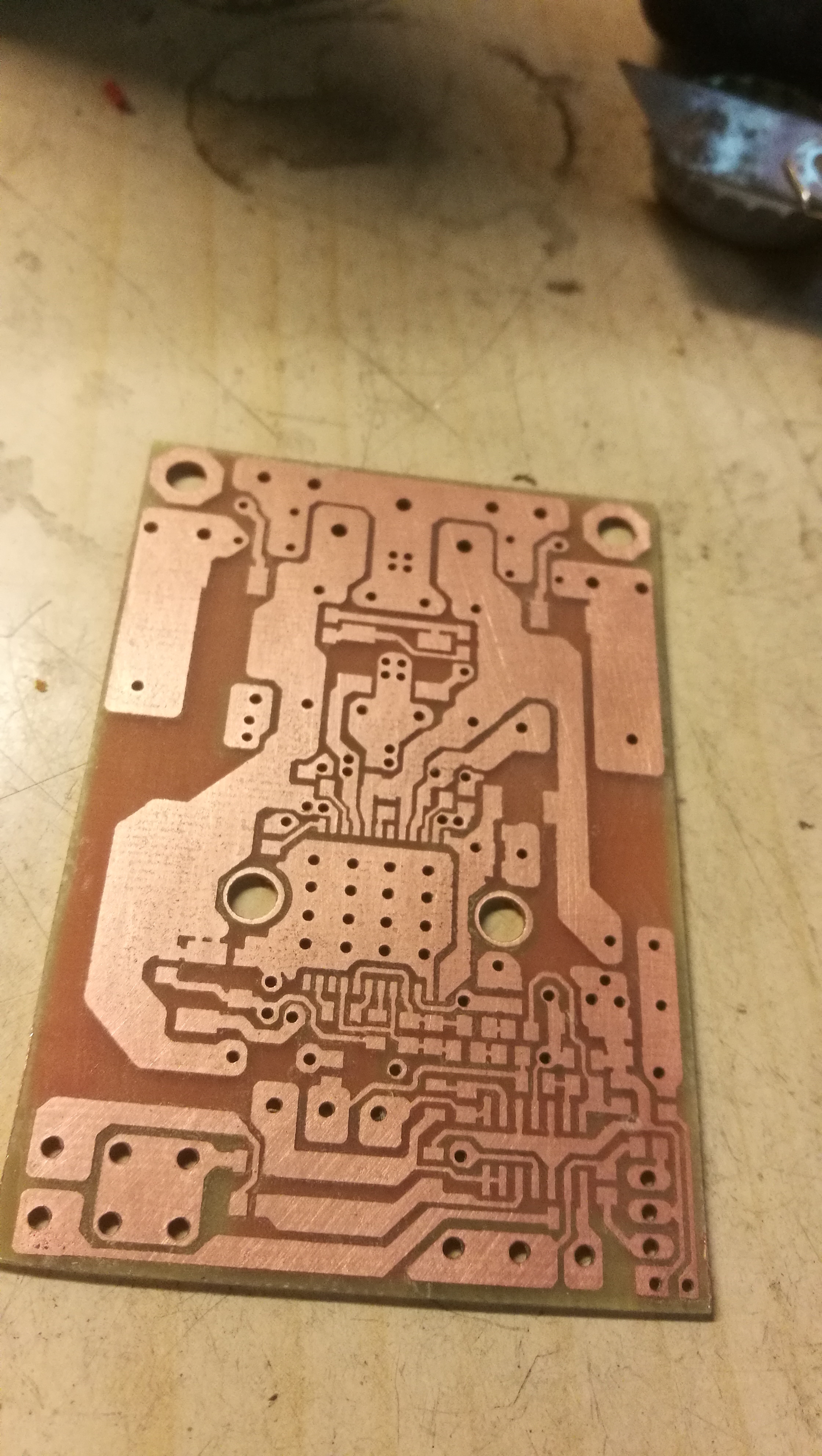

    Give a photo of the finished PCB on which you are soldering the layout. Both sides.
  • #3 17684731
    gawron
    Posts: 32
    The tile is already tired, replacing the chip several times
    TDA8954TH Amplifier Issue: Resistor R2 Burns, DC on Outputs, Oscillator Not Starting

    In the datasheet of TDA8954 there is no 22 Ohm resistor between Cprot and Vss. Why did you put it?
