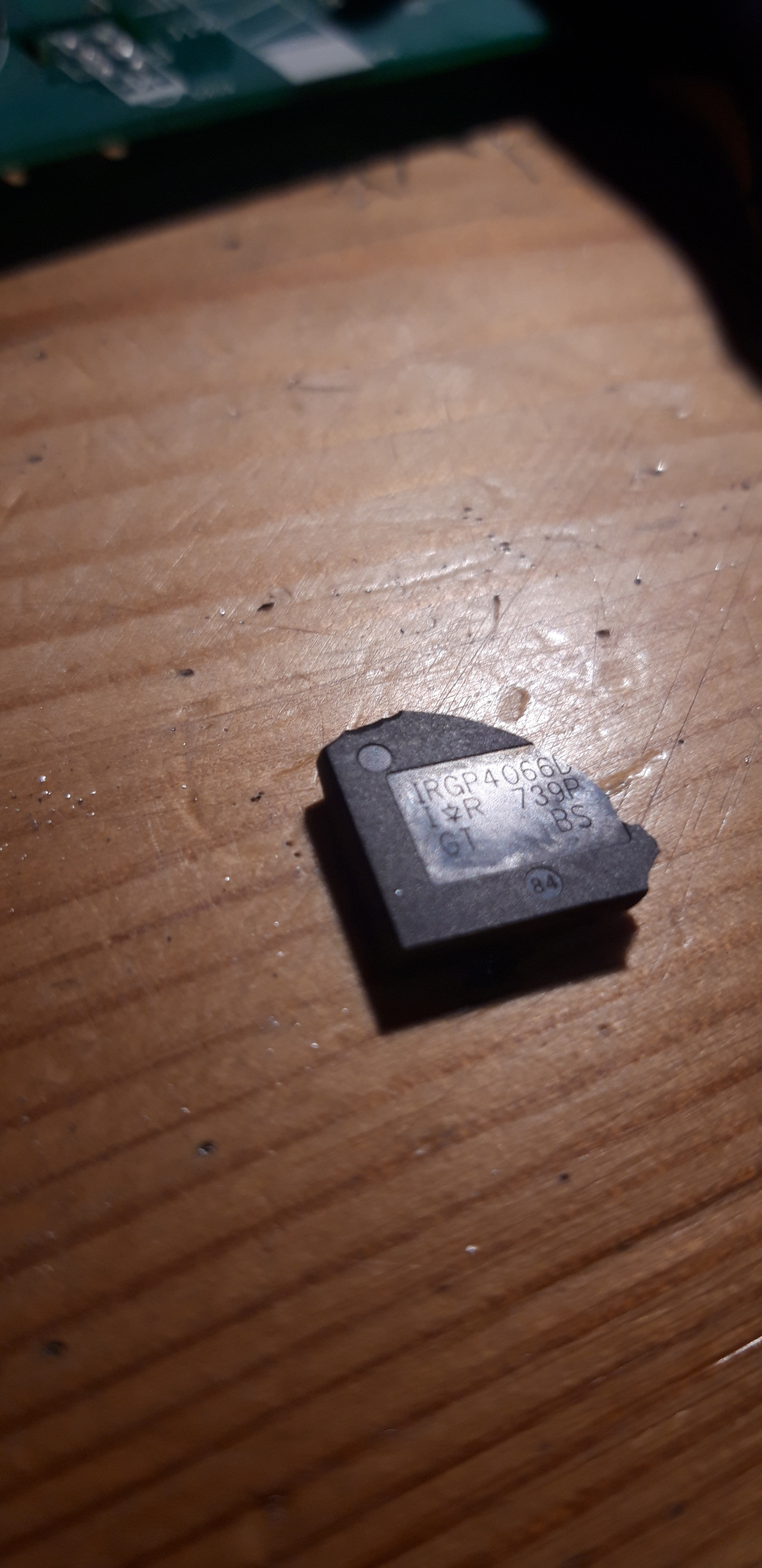

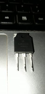

    I pulled out the entire motherboard, the IRGP 4066D transistors literally fired

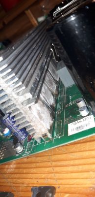

  • #6 18263901
    Matek920605
    Posts: 54
    Rate: 12

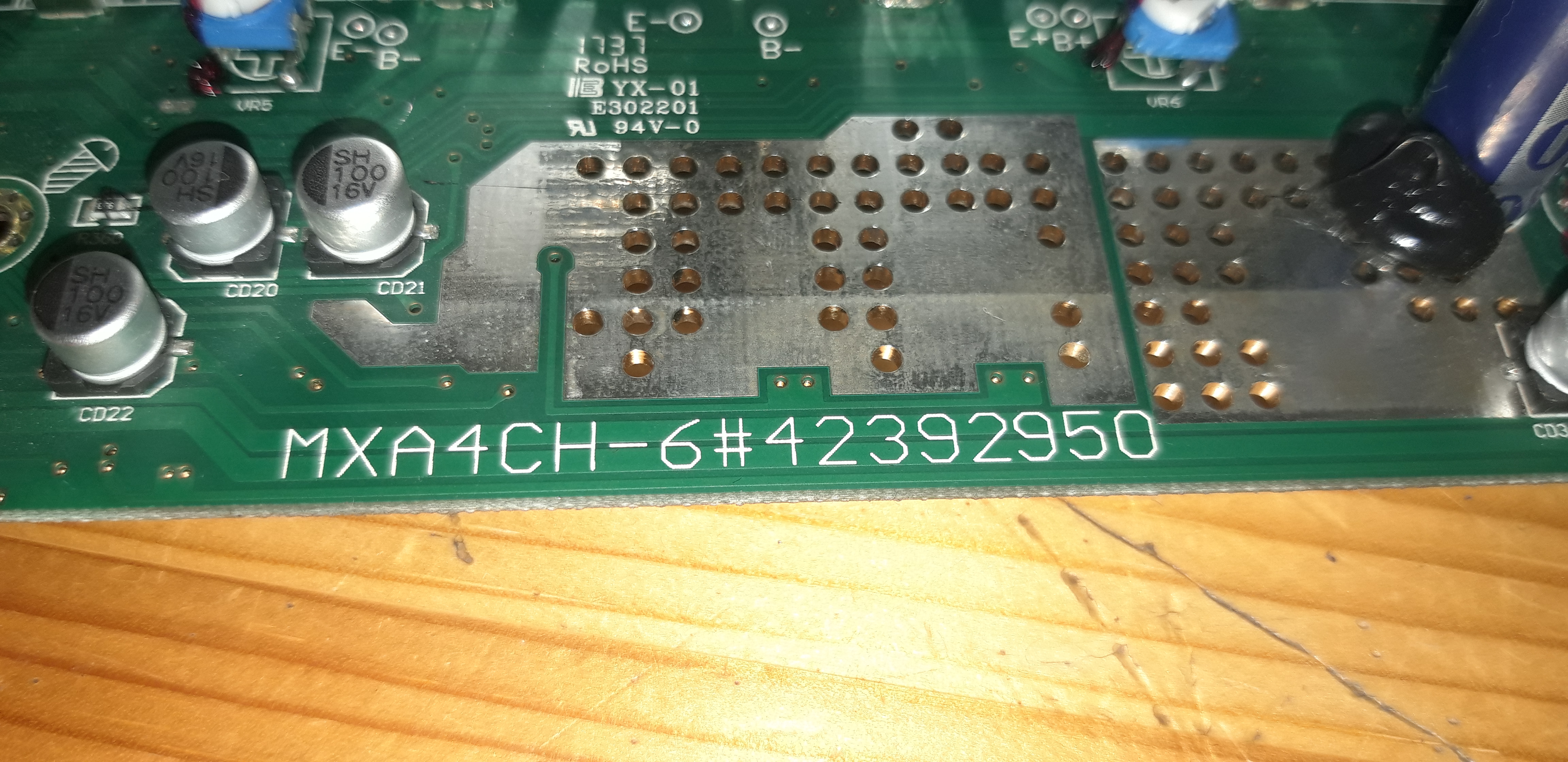

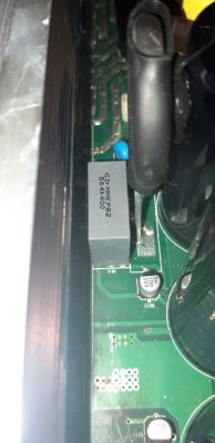

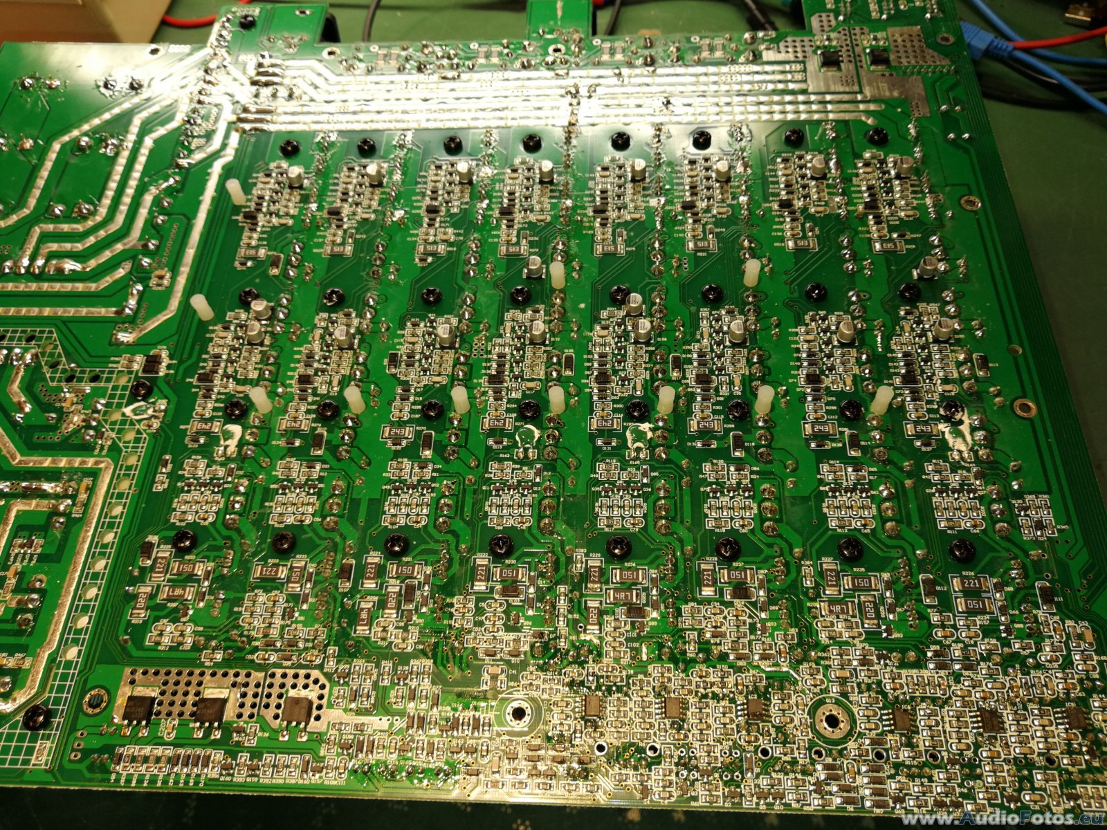

    Exactly, I looked at the entire board carefully, only these transistors are damaged, the capacitors are complete, all paths are ok. The power amplifiers on each of the 4 channels are also functional. I can send photos of the whole album if I can
    Added after 8 [minutes]:
    T.amp TSA 4-1300 Power Amplifier Issue: Not Turning On, Red Diode Flashing, No Visible Damage
    In the evening I will send more detailed ones

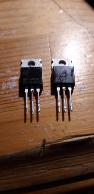

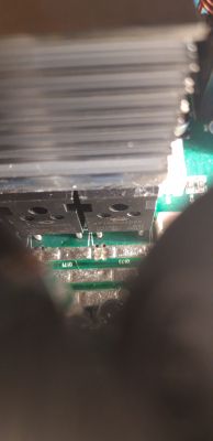

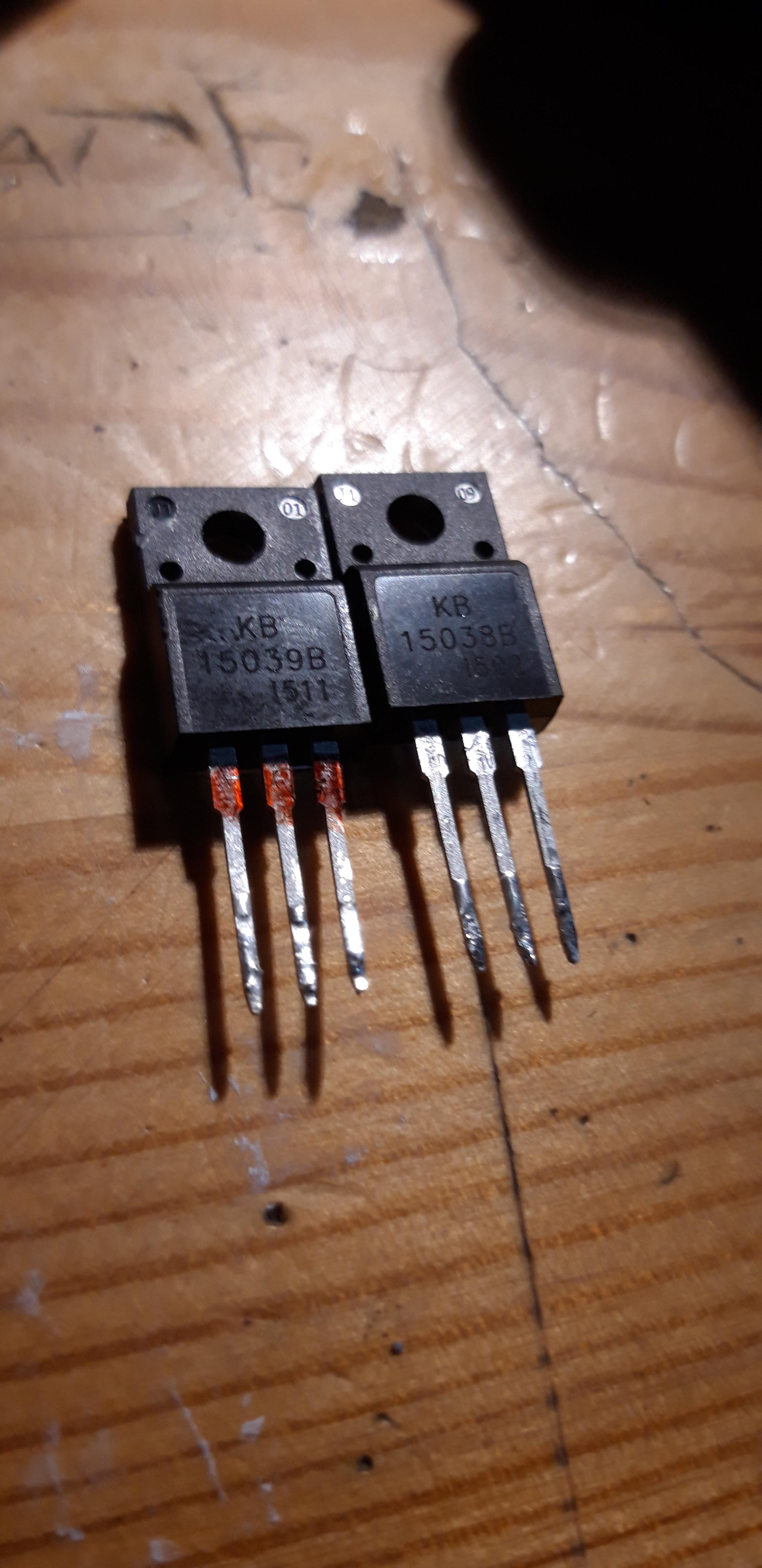

    Added after 30 [minutes]:
    photos before removing the heatsink with IRGP transistors removed T.amp TSA 4-1300 Power Amplifier Issue: Not Turning On, Red Diode Flashing, No Visible Damage T.amp TSA 4-1300 Power Amplifier Issue: Not Turning On, Red Diode Flashing, No Visible Damage T.amp TSA 4-1300 Power Amplifier Issue: Not Turning On, Red Diode Flashing, No Visible Damage T.amp TSA 4-1300 Power Amplifier Issue: Not Turning On, Red Diode Flashing, No Visible Damage T.amp TSA 4-1300 Power Amplifier Issue: Not Turning On, Red Diode Flashing, No Visible Damage T.amp TSA 4-1300 Power Amplifier Issue: Not Turning On, Red Diode Flashing, No Visible Damage
    Added after 4 [minutes]:
    removed heat sink and transistors that are in the same row as the damaged IRGP are mounted on the same heat sink
    T.amp TSA 4-1300 Power Amplifier Issue: Not Turning On, Red Diode Flashing, No Visible Damage T.amp TSA 4-1300 Power Amplifier Issue: Not Turning On, Red Diode Flashing, No Visible Damage [img-2] T.amp TSA 4-1300 Power Amplifier Issue: Not Turning On, Red Diode Flashing, No Visible Damage
    Added after 10 [minutes]:
    additionally, photos in the attachment

    Transistor data
    • irgp4066dpbf-1227897.pdf (329.86 KB) You must be logged in to download this attachment.

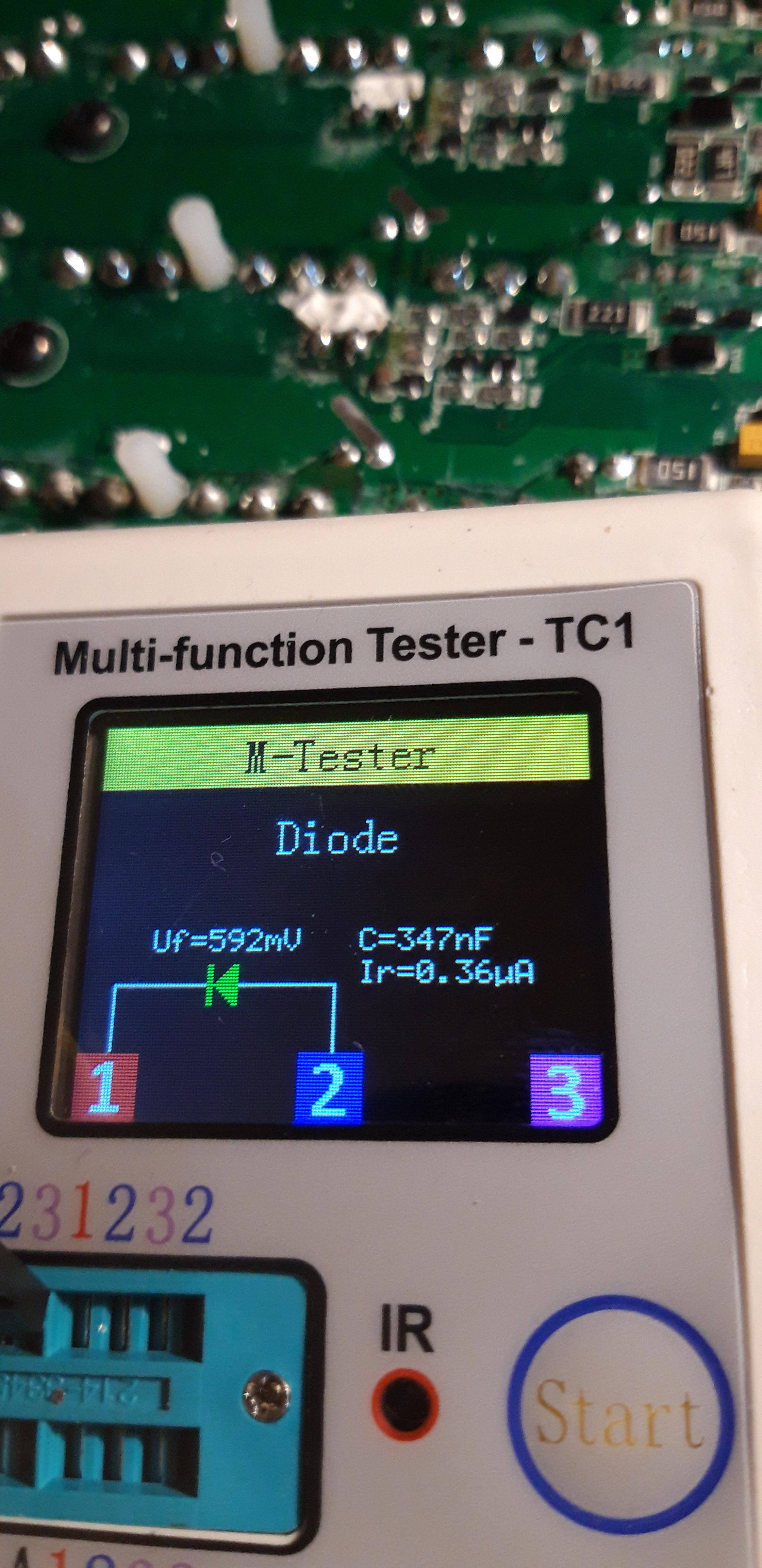

    Matek920605
    Posts: 54
    Rate: 12
    the entire board has been checked for damaged diodes with the designation EF8 and transistors (because IR2100S, IRGP is known :D ) on the whole board, diodes marked EF8 - damaged 3 pieces (the rest showed only one way about 500 OHM. Power transistors marked: NJW0302GC - damaged pieces 10 (one whole channel, transistors punctured). On the line of damaged power transistors there were also 2 pieces of damaged transistors (mosfets) GP105N15M - damaged 2 pieces. I found another damaged "transistor", I had no pleasure, with the designation KB15038B, which was located next to the damaged power transistors. I have not checked the capacitors yet, only for damage that are visible without measurements :)
    attached photos of the elements
    Added after 5 [minutes]:
    photos in better quality

  • #29 18276766
    Matek920605
    Posts: 54
    Rate: 12
    in the attachment there is a measured diode marked EF8 with a tester
