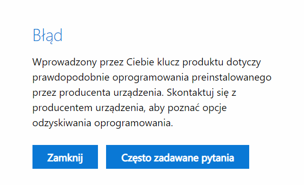

    By the way, I will ask where can I download the original system? I do not want to use microsoft.
    This is Windows 7 Pro OA Dell.
    I understand that this is the Professional version and I tried to download it

  • #21 17726638
    carlosg
    But this program already makes a botable flash drive itself, so why this link?

    Why is Legacy the most appropriate for 8 wines?
    I downloaded the original version of oem from Dell's website and followed their instructions and installed it on UEFI. Everything flashes as it should
    Added after 10 [minutes]:
    By the way, I downloaded Dell Support Assist and it downloaded almost all the drivers for me. I also made automatic system updates. I had to look for one driver myself on Dell's website. However, I am wondering whether or not to install all the complete software from the site for this paw
