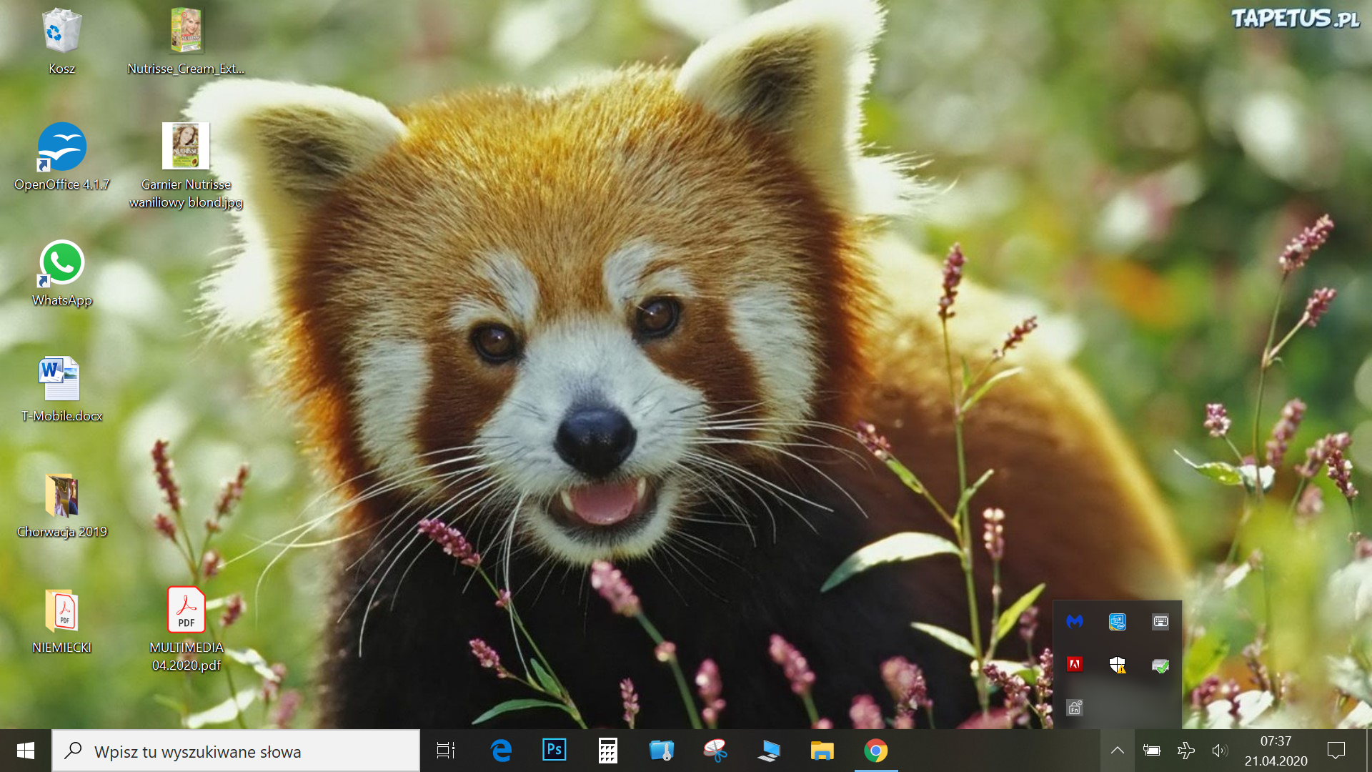

  • #7 18635099
    B_e_t_i
    Posts: 18
    I don't have such an icon. I am enclosing a screen. In the drop-down taskbar at the very bottom there is some icon that is inactive. Maybe that's the problem?

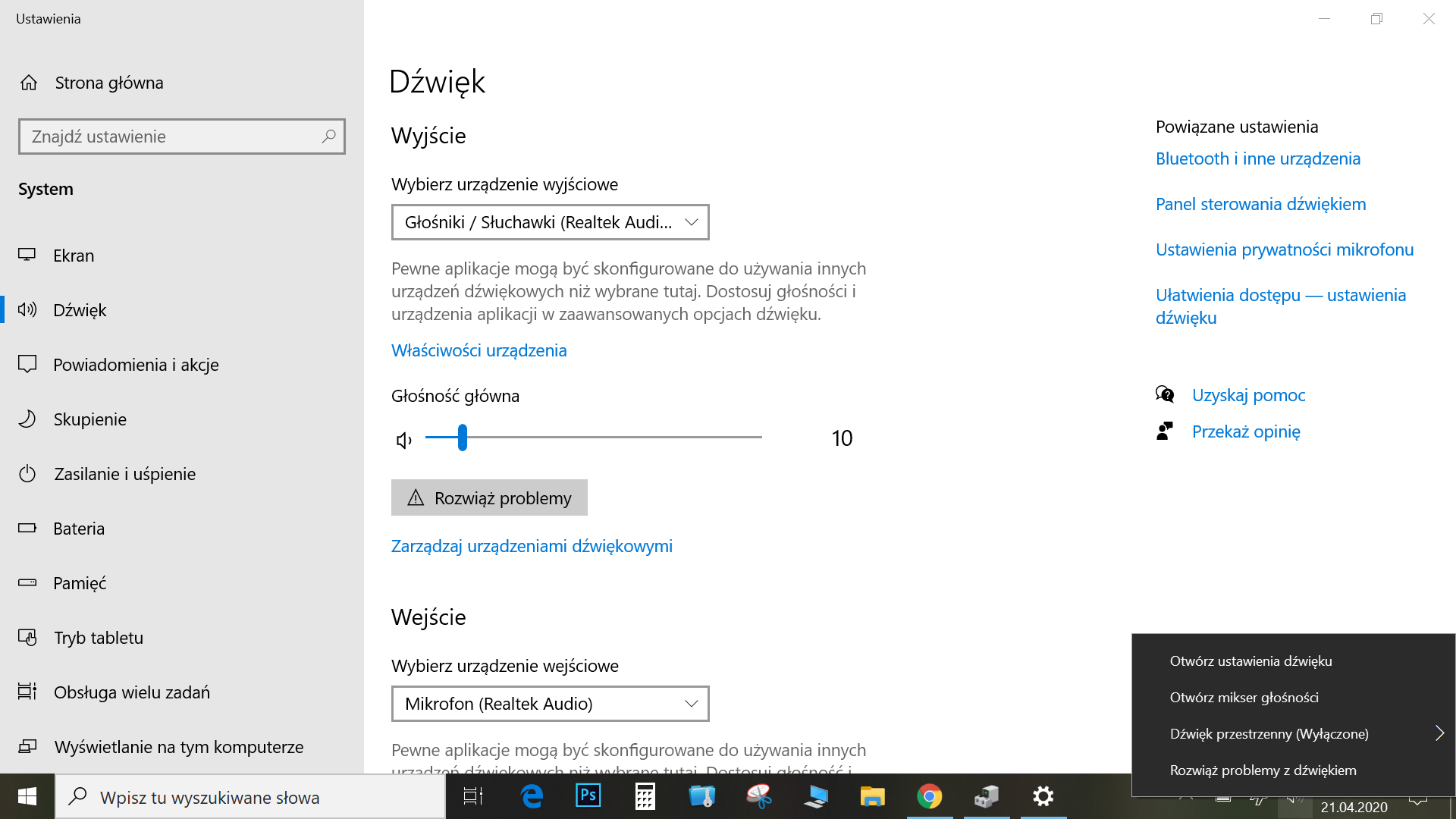

  • #8 18635256
    B_e_t_i
    Posts: 18
    As for the sound icon, when you right-click it, something like the one shown in the attached screen develops. The manager isn't there, or at least I can't see it.
