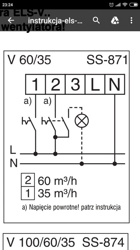

    Hi. I have a problem with the noise of the Helios ELS-V 60/35 fan. I would like to turn off the first gear and control the exhaust myself. Is it possible? Please advise.
    Helios ELS-V 60/35 Fan Noise Issue: Can I Deactivate the First Gear Manually?
    I am sending a diagram of the system in the attachment.

    pomidoreq82
    So what about unplugging the cable from position no. 1 (see diagram)? The manual says something about return voltage. Does this affect the system?

    Rate: 9285
    Try to bypass (disconnect) the pin 1 switch and check if the fan will then be on "two". If so, you can do as I wrote - connect the power supply to start the fan immediately "on two" (this switch should be used to turn on the supply voltage and the contacts it shorted should be bridged).

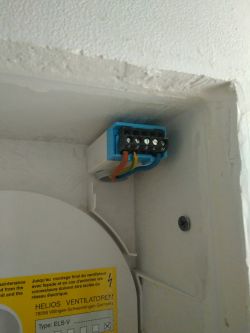

    I have this connection. When it comes to electricity, I only know how to change a socket or connect a lamp in series. I haven`t had any experience with bridging. If you could help me a little more, I would be very grateful. Regards
    Added after 41 [minutes]:
    It worked, thanks for your help!!!
  • #8 17772612
    pomidoreq82
    Added after 1 [minute]:
    I disconnected the brown cable as in the photo. The fan does not have 1st gear and when I want, I only turn on 2nd gear with the switch. This is what I ment :)
