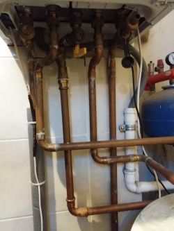

  • #10 17751525
    Drututu
    Posts: 21
    Rate: 23
    Sorry for the previous post fatigue. I send a photo from the bottom of the boiler. Boiler TYPE VITODENS 100. and pruba I will do tonight we will see what pressure the boiler will show. Understanding System Pressure for Viessmann Furnace in a Cottage Without Manual Understanding System Pressure for Viessmann Furnace in a Cottage Without Manual .

    I have an atmospheric boiler it has a slightly different design and I have a separate safety valve, similar to what you see at the blue diaphragm vessel from the hot water between the automatic vent and the pressure gauge. This valve has a red knob and an outlet for water on the side.
    Just in case, connect this outlet to the sewer, because if ever in the future this valve fires, it will flood your boiler room.
    You see from the instructions that the condensate drain is integrated into the safety valve built into the boiler, that is, you have a water outlet to the sewer from the central heating system.
    When it comes to connections, according to the instructions, from the left you have:
    - central heating supply with a shut-off valve
    - supply to the hot water cylinder
    - gas connection with a yellow tap
    - return from the hot water cylinder
    - central heating return with a shut-off valve and a drain valve for topping up water in the central heating system. after connecting an additional hose in tap water.
    It follows that the problem of the valve allowing tap water does not apply to you.
    First check the diaphragm vessel and make sure that the central heating system is vented.
    If this does not help, then you can look further.
    Added after 3 [minutes]:
    Please download the service manual and print it out for yourself, it will come in handy when you want to do anything, because you can verify the manual on the fly with what you will see in person.
    Read the entire manual from cover to cover. Even if you don't understand everything, at least you will associate where to look for what more or less.

    The problem for today solved it turned out that there was no pressure in the diaphragm vessel. Acquired 1 bar the safety valve is repealed at 2.5bar at 3.6bar it is pouring in a trickle. [img-0]
