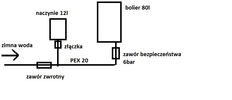

  • #28 17781505
    alienone
    Posts: 164
    Rate: 73
    I simplified it to such a solution. They don't have flow-through vessels in the store,
    cold water supply - check valve - triangle with 12 l vessel - 6Bar safety valve - 80 L bolster plus PEX 20 connection
    It'll be all right ? Correct installation of the expansion vessel in the DHW installation

    #29 17781515
    emigrant
    Posts: 1605
    Help: 107
    Rate: 326
    The diagram is correct for a non-flow vessel. Remember that the ZB should be in a vertical position (they are not through). Pass-through are the so-called combined with the non-return valve, but you cannot use it in this situation as shown in the diagram, because you will cut off the expansion vessel from the boiler. Also remember that the vessel is not mounted "spicy". It must be on the so-called quick-release coupler, so that the vessel can be disconnected from the system at any time, e.g. to periodically check the initial pressure. The initial pressure is checked with the vessel disconnected from the system. No closing of valves and no depressurization of the boiler through the hot water tap.
